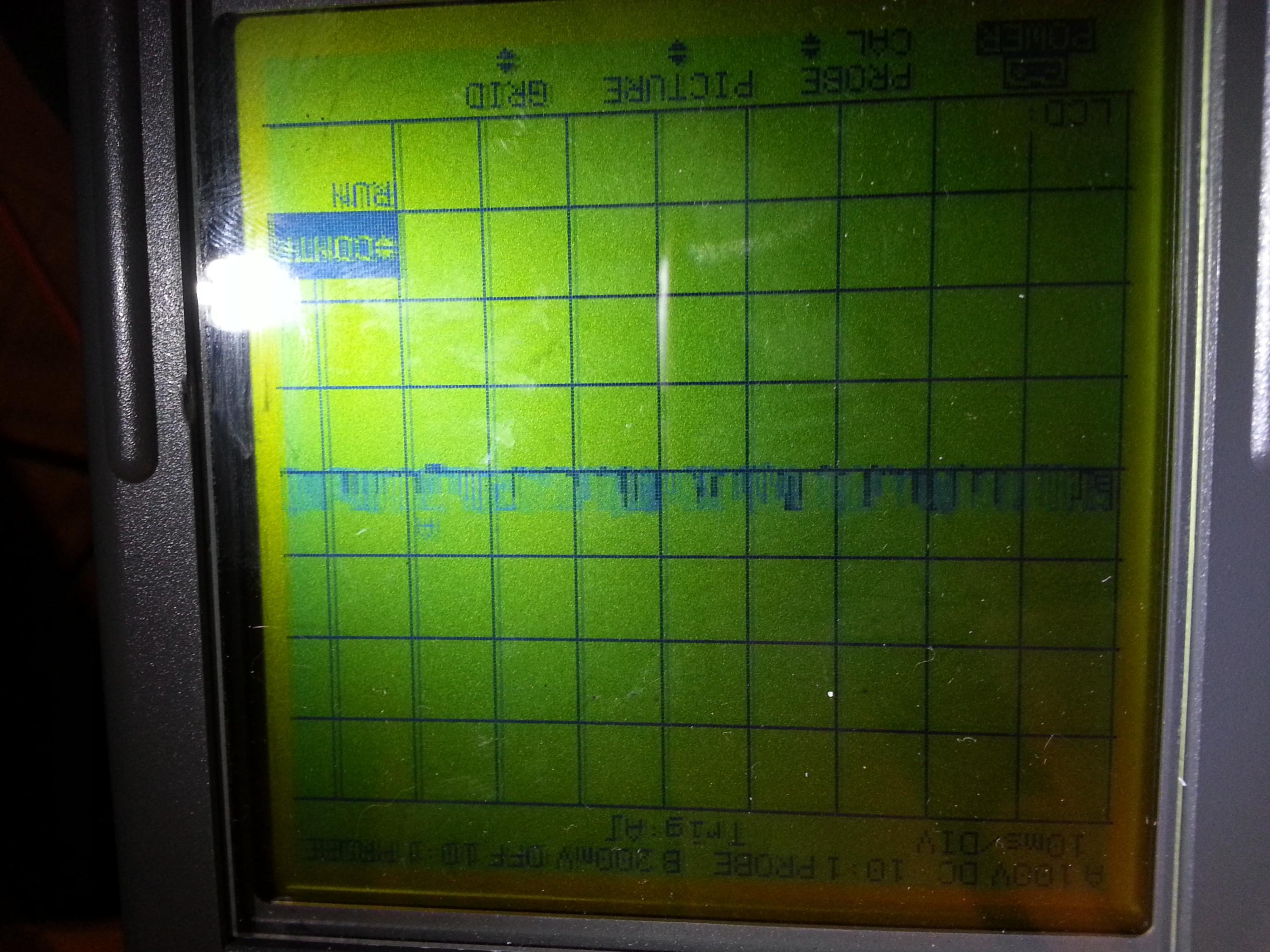

                    Hi mate just tried it on the same blue thing on the x main and got a much better reading

                        Re: samsung 58 inch plasma
                        Could you show X-main waveform.

                          #152
                          Here It goes up and down a bit though

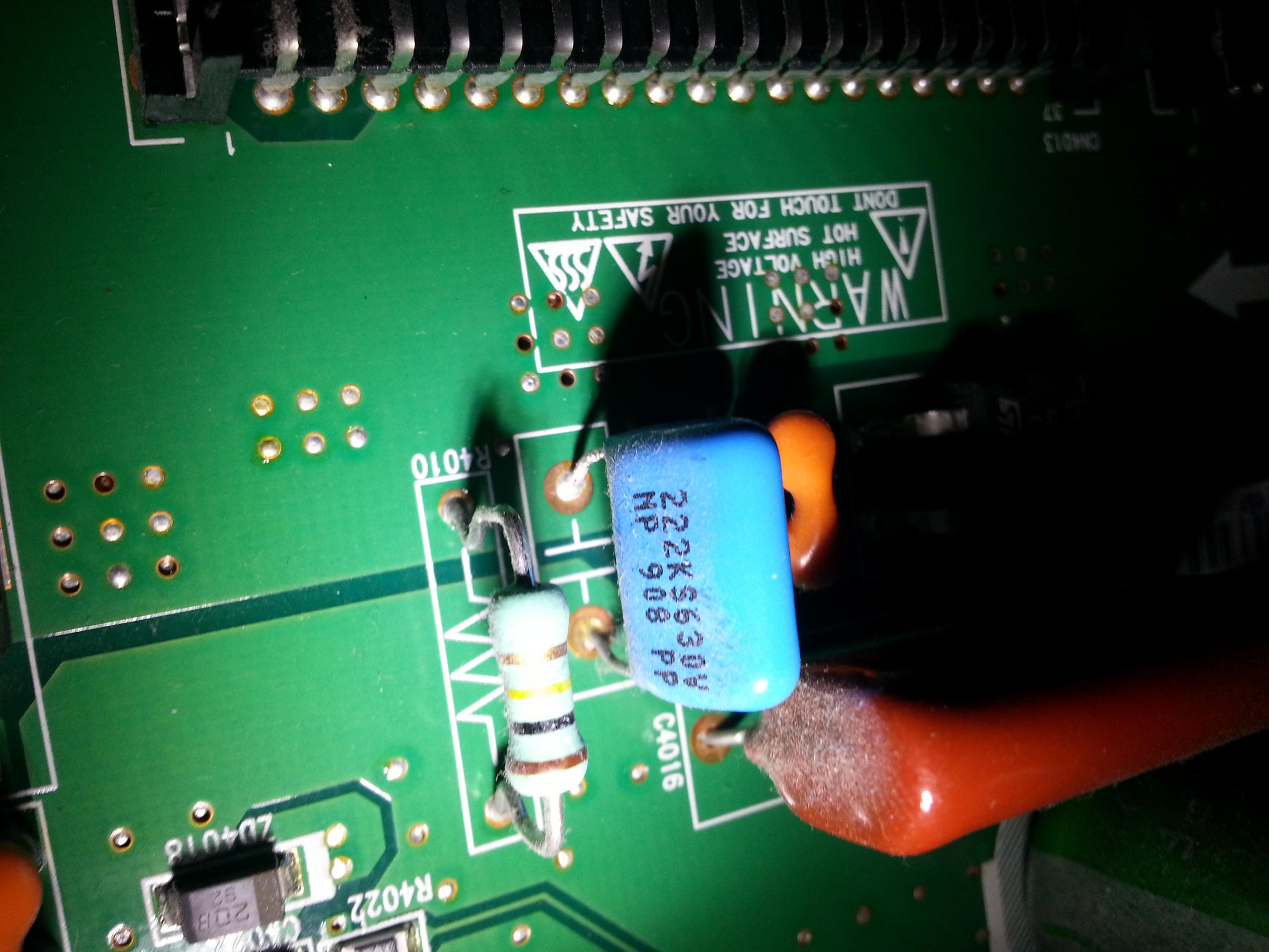

                            #153
                            Still doesn't look right - show me where you're probing please.

                              #154
                              The blue one like the other side
                                #155
                                Which lead of that; top or bottom?

                                  #156
                                  top

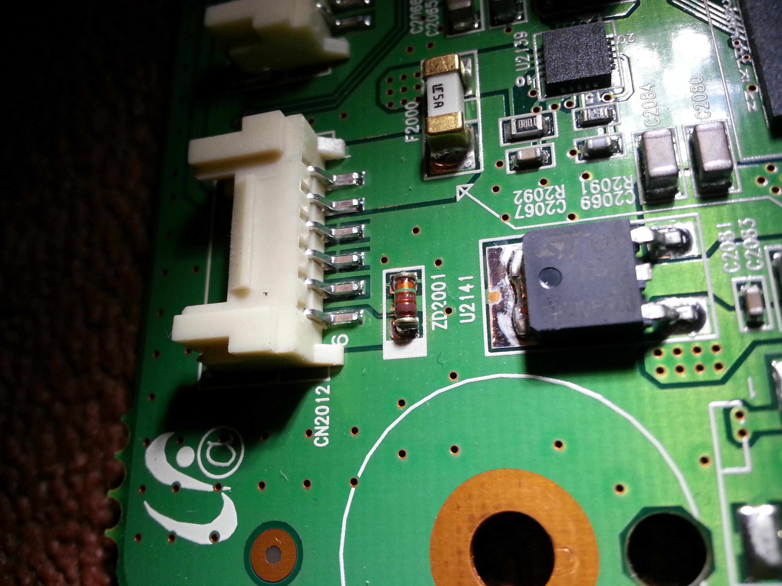

                                      #158
                                      i think it might be the control board too there is a glass fuse on it thats only got power to one side nothing at all to the other just where the power comes into it i was just going round it before just checking everything if that makes any sense ??
                                        #159
                                        Where is this fuse?

                                          #160
                                          Here I just took it off to have a look at the back
