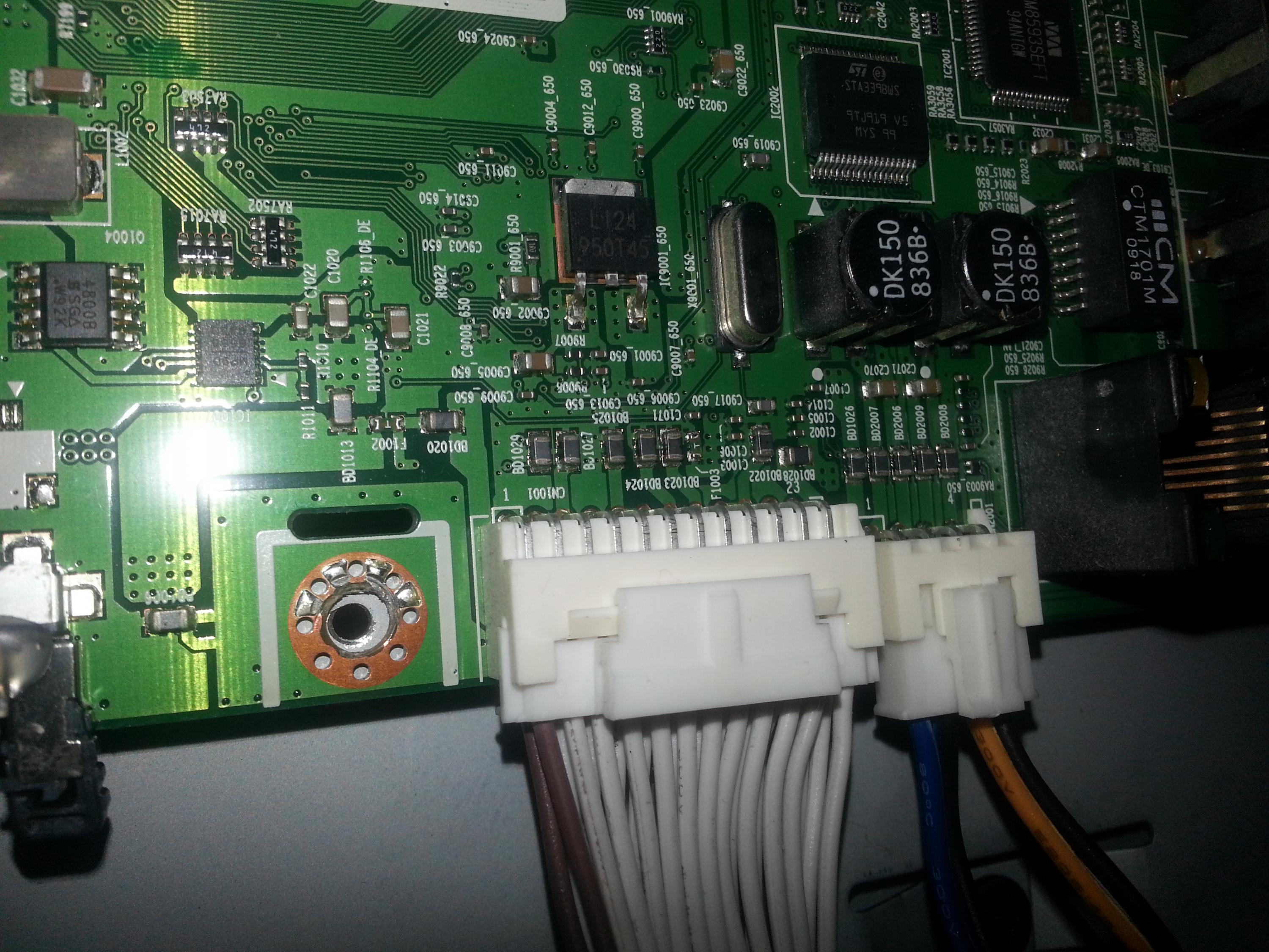

            Re: samsung 58 inch plasma
            no nothing i have measured the power coming from the power board to the a board it has 2 sets of 12 wires one sat over each other i will add pic in a mo but i get as follows
            the top outer wires starting from the brown wire down
            1-3.19v
            2-0v
            3-0v
            4-18.03v
            5-0v
            6-0v
            7-5.1v
            8-5.1v
            9-0v
            10-0v
            11-15.13v
            12-0v
            and the inner starting from brown again
            1-0.12v
            2-5.14v
            3-0v
            4-18.02v
            5-0v
            6-0v
            7-5.1v
            8-5.1v
            9-0v
            10-15.01v
            11-15.01v
            12-4.35v
            does this sound correct 18v seems a bit high ?

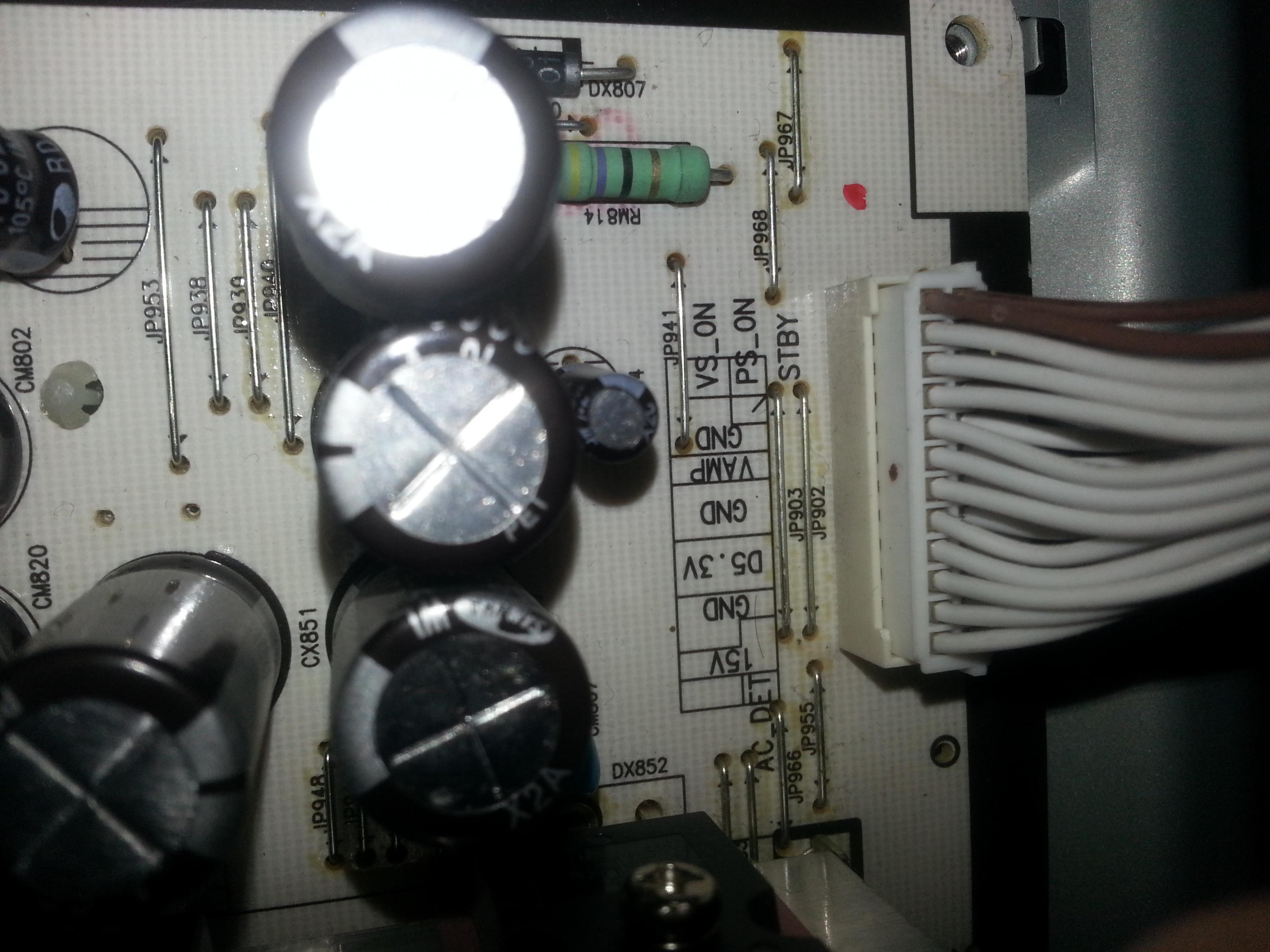

              Need to locate the legend block usually on the PSU.
              • adamp91gvm
                • Jan 2014
                • 706
                • uk
                This it ?
                  Yes, so you want to connect PS_ON to the GND pins but using a resistor to limit any current flowing.

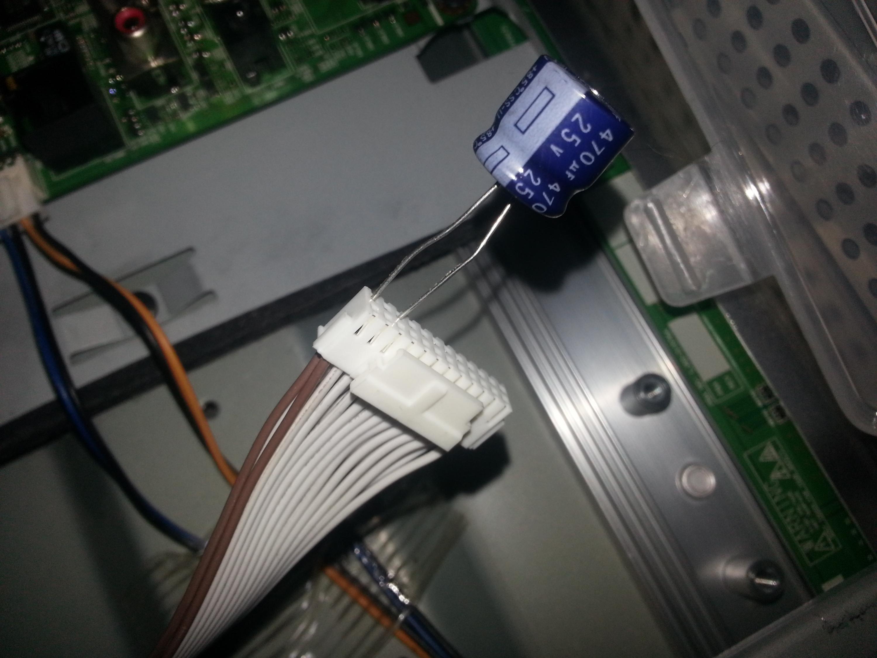

                    #29
                    What size cap ?
                    • adamp91gvm
                      • Jan 2014
                      • 706
                      • uk
                      #30
                      Like this ?
                      • vinceroger69
                        • Mar 2012
                        • 6714
                        • uk
                        #31
                        tom means a resistor
                          #32
                          Yes, a resistor... that is a capacitor.

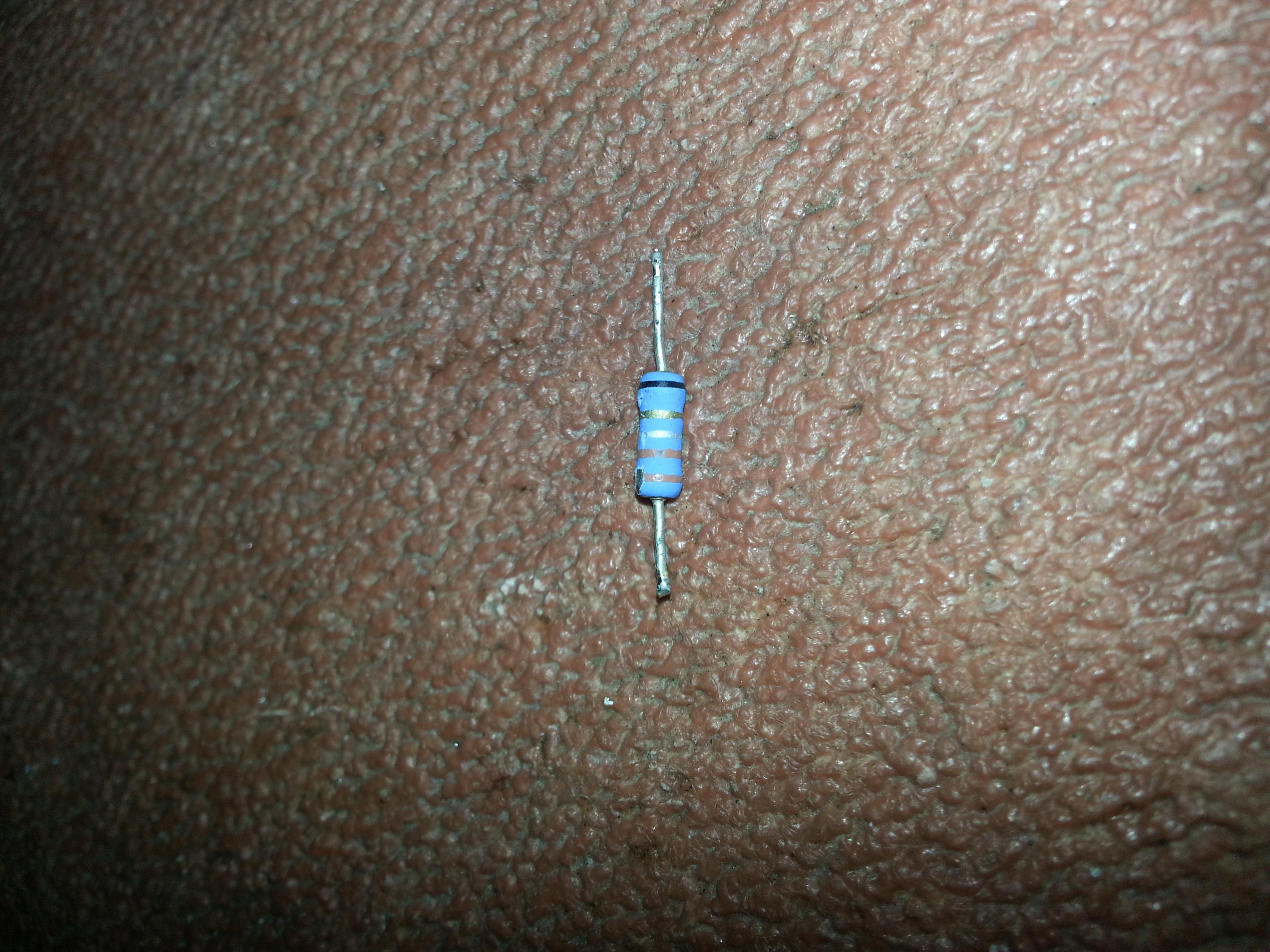

                              Will this be ok
                                #35
                                That is a 200 kohm resistor, so it would not work.
                                Colour code, some examples:-
                                - brown, black, brown (ignore gold/silver at end) is 100 ohm.
                                - red, red, brown is 220 ohm
                                - orange, orange, brown is 330 ohm.
                                - yellow, violet, brown is 470 ohm.
                                You can also test on meter to see resistance.

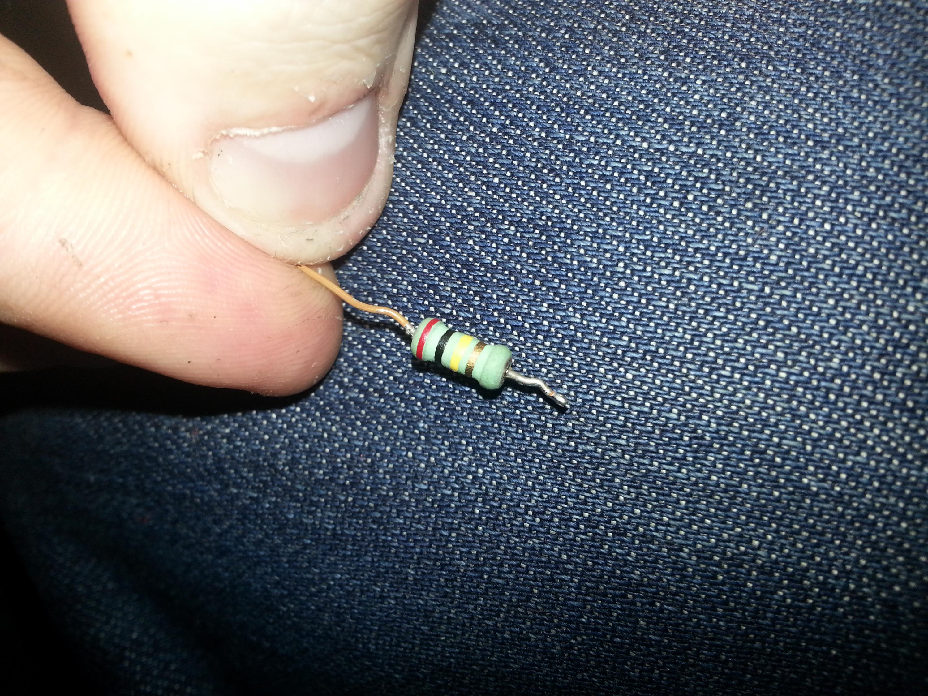

                                    #37
                                    Only other ones I got is
                                      #38
                                      You might have to buy one then. You can get them from maplins. Just ask for a pack of 100 ohm, 1/4W 5% metal (or) carbon film through hole resistors.

                                        #39
                                        Right found one that works nothing from screen but no clicking just clicks once and stays on
                                          #40
                                          It's important to use the right value or the TV will not work properly, what value did you use?
