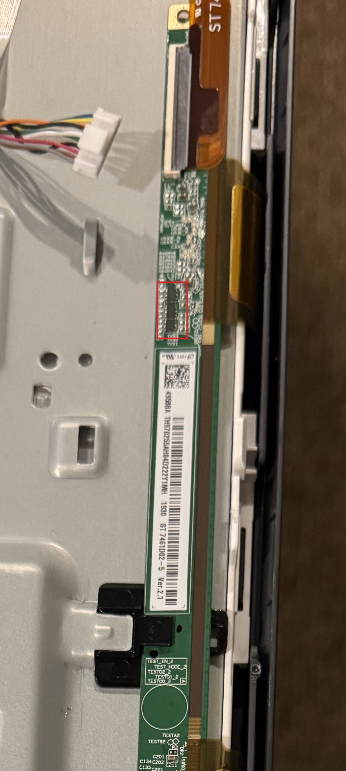

    Looking for some help please. Samsung UN75RU800DFXZA rebooting, no picture, clicks
    TV was working fine and then just shutdown one day. It will not turn back on. I get a backlight for a little while, then it just clicks and won't fully boot.
    I took off the back panel and did the basic troubleshooting and it seems like it's a panel issue.
    The backlight will stay on if I disconnect either of the ribbon cables going to the panel. I've watched this video (https://www.youtube.com/watch?v=77tymvTJDxo) and am wondering if this could be the issue, just a bad cap on the panel.
    Any assistance is appreciated.

    • EazyBone
      • Jun 2023
      • 1353
      • United states
      Solder the 2 pts in the picture and then remove the speakers and metal guards protecting the buffer boards on the bottom of the TV. There will be a yellowish U ribbon on the left and right side. Unplug one at a time (don't short it so disc it from the closest to the middle). And plug in the tv. If you get 3/4 a pic you know that buffer boards is where it's disconnected is where the short is. If not, reconnect the cable and do it to opposite side and see if 3/4 picture. This will isolate the short on the screen. But

              • joel warren
                • Jan 2025
                • 32
                I unplugged the U shaped gold cable on the far left when looking at the back of the tv and got 3/4 of a picture.. so it’s the left buffer board that has the short..
                any advice on how I can locate the component with the short??
                • EazyBone
                  • Jun 2023
                  • 1353
                  • United states
                  Make sure you test right side also (just to make sure I'm sure you did)
                  Basically you can compare caps from each side of buffer boards, check them using beep beep mode and maybe you will get lucky. If you can't find a short.. well probably internal issue.
                  Don't forget to unsolder that bridge you made.
                  And yes in the end, your screen is dead correct.. small chance something else tho! I've never been lucky on it.

                          • Diah
                            • Feb 2013
                            • 6435
                            i remember RU series Panel they have at the far end of the panel buffer boards 3 ESD diode... show us .. if there are ESD then one shorted
                            • EazyBone
                              • Jun 2023
                              • 1353
                              • United states
                              I knew I recalled something like that, I was unsure to say something. Pics of buffer boards!

                                • Storyteller12
                                  • Jun 2020
                                  • 625
                                  Don’t see any on that side. Need close up pics of the other side of buffer board.

                                    • Diah
                                      • Feb 2013
                                      • 6435
                                      is this site when you disconnect the U ribbon you got 3/4 screen ? if yes close up clear photo on these 3 sets
