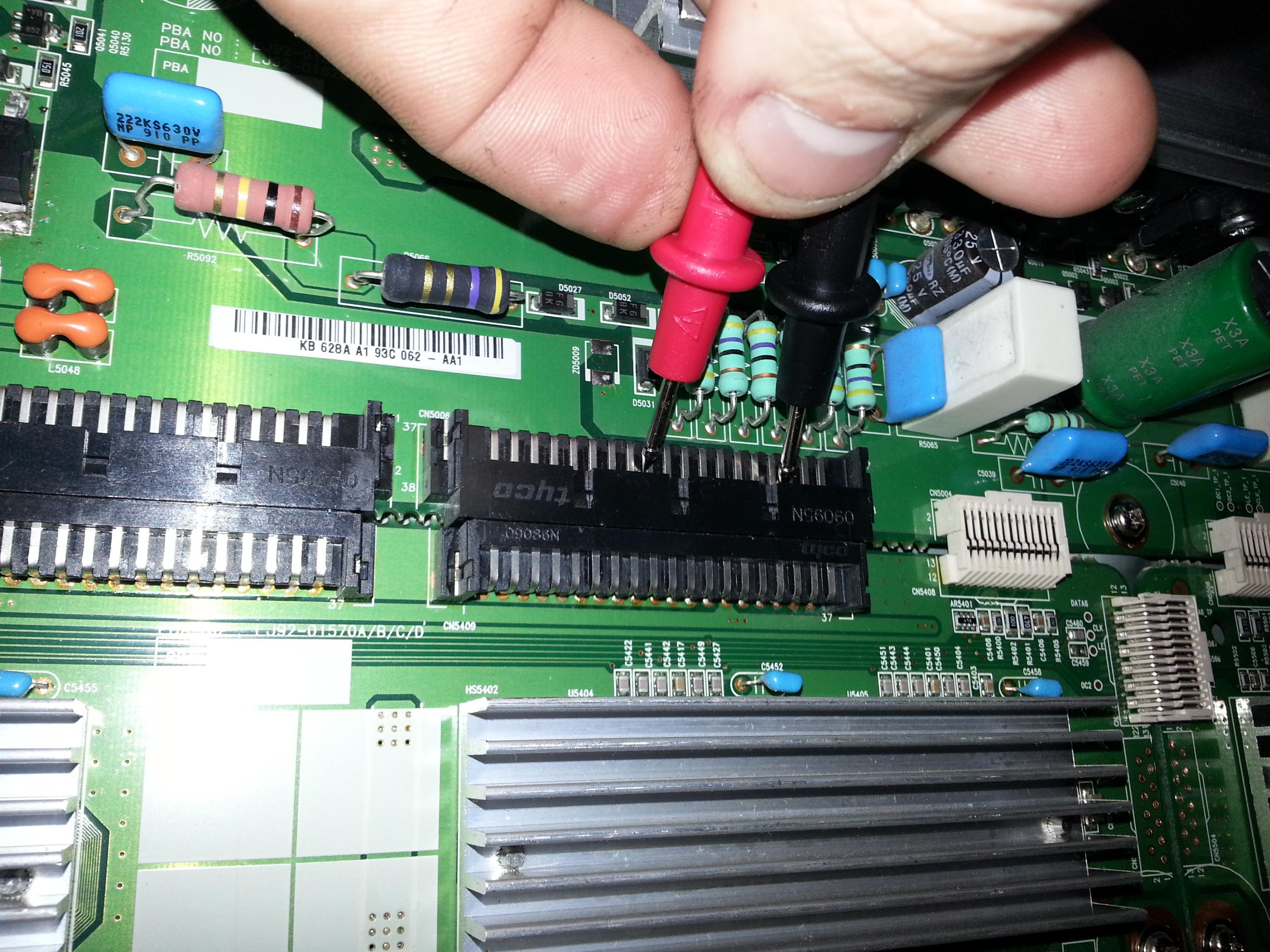

    also with the 3-4 jumper on or off ?
      #82
      Re: samsung 58 inch plasma
      BETWEEN pins, black on black highlighted, red on red highlighted on the buffer board connector.
      3-4 jumper, take it off for now.

        #83
        -61v I get if like this ?
          #84
          Yes, that's what I meant. Now, try with buffer connectors removed.

            #85
            -22.2v
              #86
              That reading is unexpected, and very odd. Not sure what to make of it.
              Please check the voltage across those red capacitors I highlighted previously.

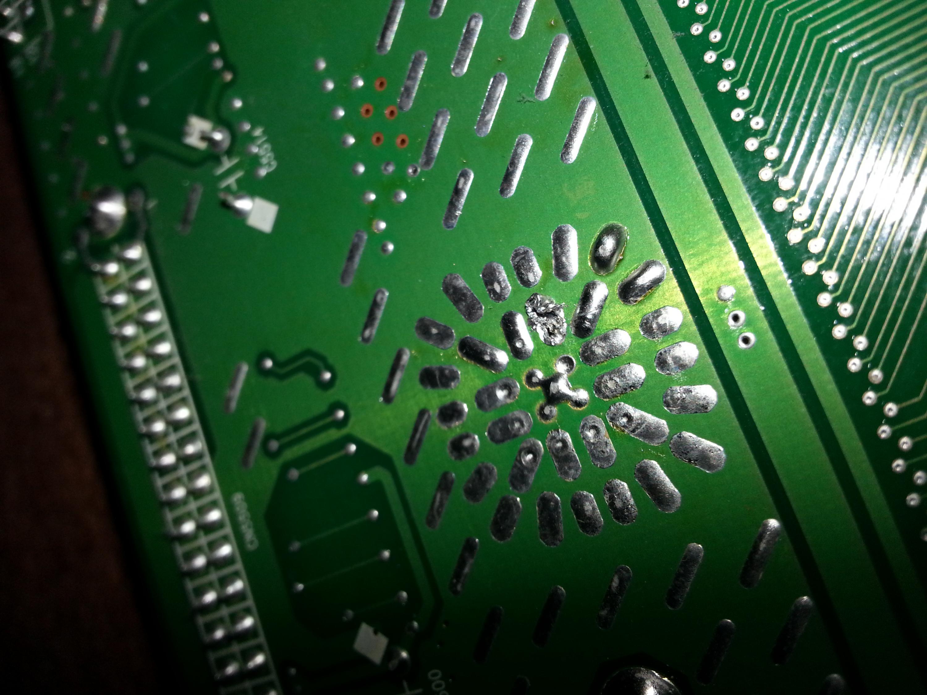

                #87
                Just seen this on the back of a buffer

                  #88
                  -110v of the red cap
                    #89
                    That's OK...
                    I think part of your Y-Main is defective, can you see any point for testing voltages at -Vscan/-Vsc or Vsch? I cannot see them on photos.

                      #90
                      yer at the top of the board vsch
                        #91
                        What do you measure on that point? Black probe on ground this time.

                          #92
                          vsch -31.2v vsacn -189.4v
                            #93
                            Hmm, both VSCAN and VSCH are OK. I could not see those on pictures before, makes it much easier!
                            With those voltages you SHOULD have screen glow, even if it's really faint.
                            This leads to only a few possibilities:
                            - bad panel (cracked glass on outer edge or middle; check carefully)
                            - bad buffer board
                            - partially functional control board (unlikely)
                            You would need an oscilloscope to see if the Y-main waveforms are all correct. But so far, it appears Y-main is working.
