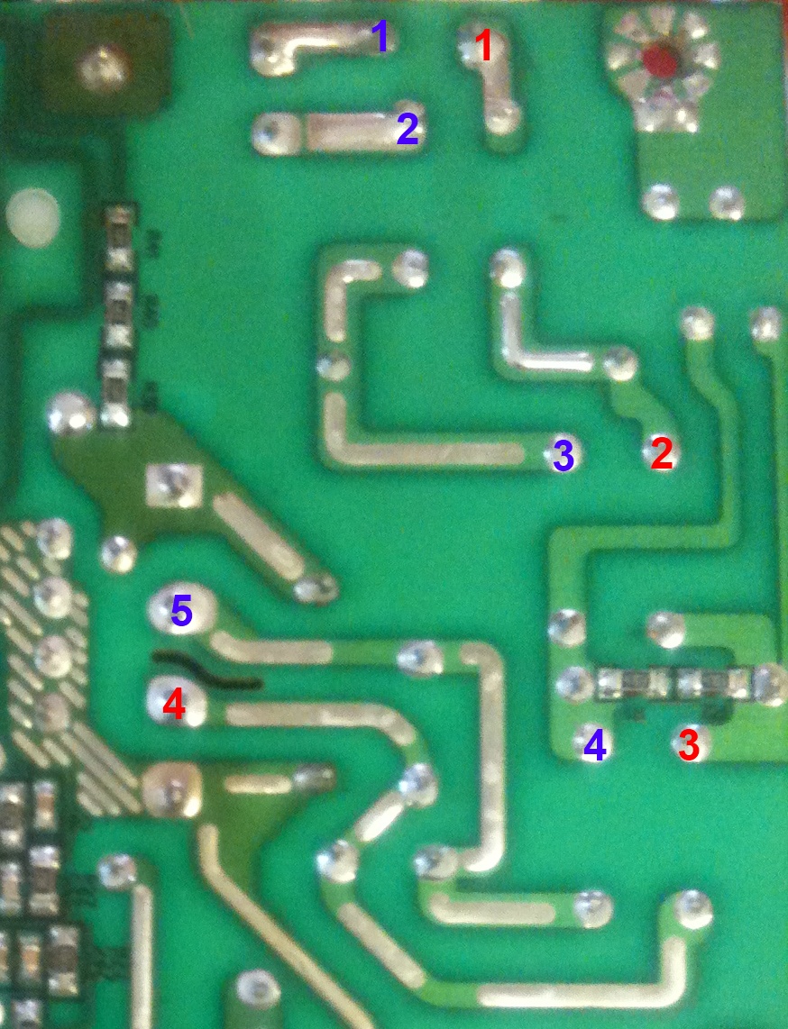

          Hmmm...that doesn't seem right.
          On the attached photo I have put red & blue numbers. With your meter on the 200 Ohm range place the probes between blue 1 - 2, then 2 - 3, then 3 - 4, then 4 - 5. There should be almost zero Ohms between each.
          Do the same for the red numbers.
          ________________________________________________
          Invisible airwaves crackle with life
          Bright antennae bristle with the energy
            #85
            Re: Bush LCD37TV016HD
            blue 1+2 00.4
            2+3 00.5
            3+4 00.8
            4+5 00.5
            red 1+2 00.4
            2+3 00.5
            3+4 00.4
              #86
              Check the solder on Pin1 (Blue) I suspect the connector is not soldered correctly.

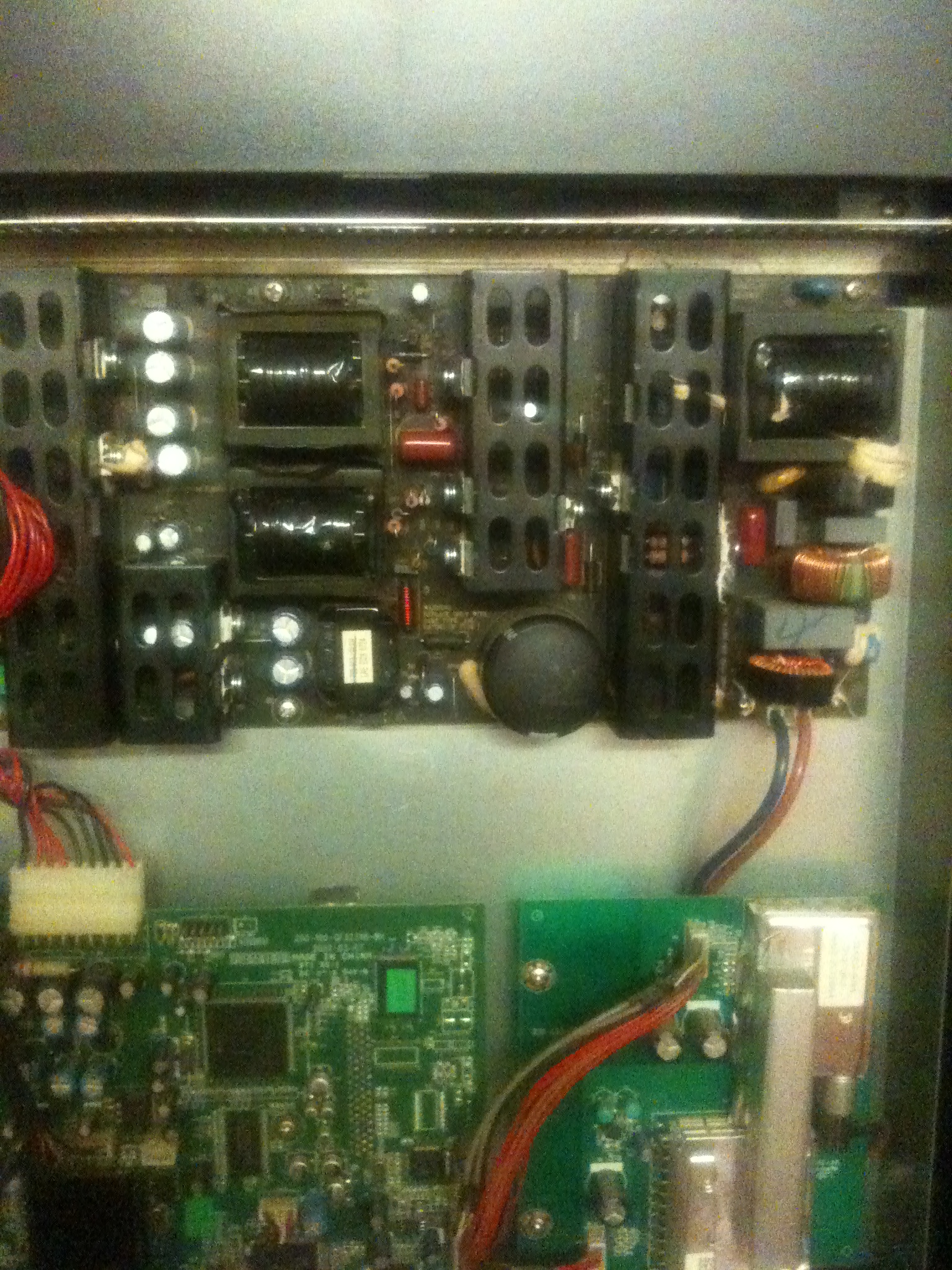

                  So the open circuit is not on the actual PSU board (assuming there are no intermittent dry joints).
                  Does the mains lead go to another board before going to the PSU board? Is there a mains ON/OFF switch on the TV?
                  I know you have said that you have tried different mains leads, but could you test the fuse in the one you are using at the moment with your meter.
                  If you could attach a photo of the route that the mains lead takes, between the kettle socket and the input to the PSU board, that would help.

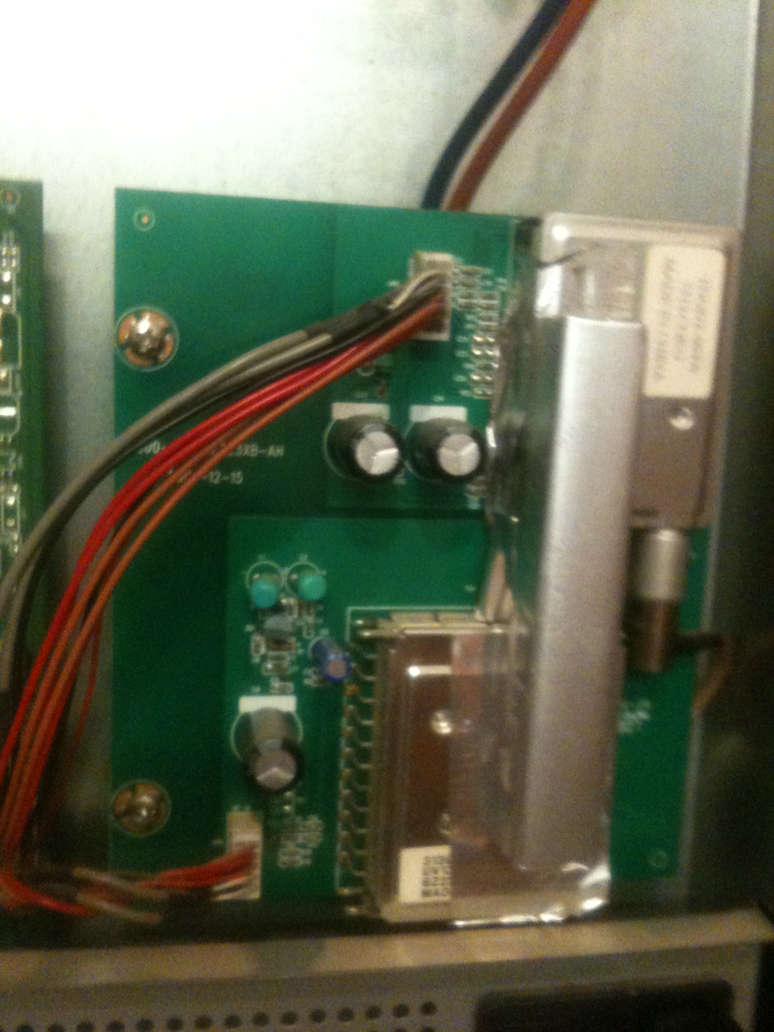

                    #89
                    Ok the kettle lead socket lead (blue and brown) runs under (pic 2) then straight in to pic 1 ( the psu )
                    what shall i test the fuse on ?
                      #90
                      no does not go to another board before the psu
