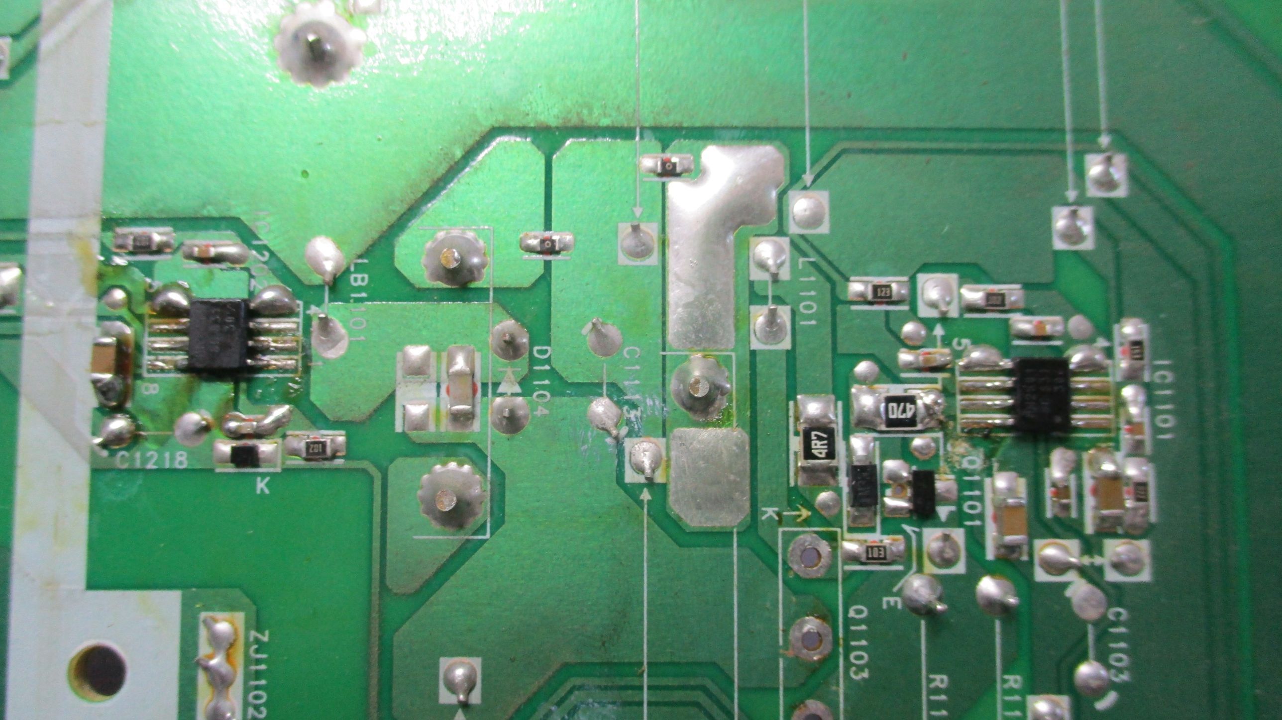

    Hello everyone. πŸ˜€
    As per thread title, this unit has a serious SMPSU fault. It blows F1001, which is a 10A M205 in the phase from the mains input.
    Very first thing I tried, was simply replacing the fuse, but the replacement ceramic fuse blew immediately.
    Looking at the schematic for this PSU, I then removed what I thought was the next likely candidate: D1001 - the HV main bridge rectifier.
    This isolated the fault(no longer blows the main fuse), but does not point me to the actual fault.
    There are no devices that have exploded or otherwise show signs of having their magic smoke gotten out - all devices look visually intact.
    IC1402 is intact also.
    I have printed out the schematic from the service manual, and am just following through it now, but I wonder if anyone else has seen this issue, and can perhaps help me home-in on the likely cause of the problem?
    It would APPEAR to be a serious short-circuit somewhere on the hot DC side of things, cos with the main bridge in place, it is instantly blowing 10A fuses @ 230v!!!!
    That's around 2300W or more(due to overload surge) - I would have expected a more violent and visual destruction of one or more of the devices on this board, but nope - they all look intact.
    Measuring voltages etc is basically impossible, cos the main input fuse blows the instant you connect the juice, so there simply is no time to probe anything! 😁
    Does anyone have any pointers?
    EDIT: Oh, BTW - this fault remains even with the PSU board out of the chassis, and just on the workbench, so it is something in the PSU board, and not deeper into the unit, such as the amplifier board etc. Thought I should mention that.

    You gotta have a short somewhere. Measure the bridge rectifier again. Also measure between the two outer pins (inner pins are AC, outer pins are one for positive and negative DC. Do another measurement with the bridge rectifier out and go were the positive and negative (outer pins) DC is. If you still got a short there, follow line 4 (positive) there is a transistor and other PWMs on that line. You may have to split the lines here and there to rule out stuff or take components out. If in doubt, take it out! Good luck!

      Measuring across the bridge with it out of the board across + and - pins shows no short - it measures open circuit.
      Measuring across the PCB where the bridge normally sits, across + and - tracks shows dead-short(zero ohms!)
      That's not good..... 😁
      I'll proceed along the lines you suggest, which was pretty much what I was going to do anyway, but I posted the thread, in case someone else had seen this fault before, and might have been able to tell me what they found as the cause. I just continue tracing. I will let the thread know, if I find the problem at what it was, for anyone else reading in the future. At least it's a single-sided PCB, so component removal is really easy. (compared to double-sided with PTH etc)

        Likely Q1103 or Q1204, (35W60C3 ?) the smps page 2 has two lines marked 4, The RED 4 is low voltage vcc line the #4 B+ line near the top of the page connects to the two mosfets via there transformers
        If the mosfets are ok it may be one of 3 disc caps, C1115, C1221, C1113

          Excellent, thank you. I was sniffing around the area of Q1103 and Q1204 when you posted, as those are obviously high-power MOSFETS, so.... I will pull both of those out later, and see if the short has gone, if not, will do the caps next.
          I love a good mystery! 😁
          EDIT: I will pull one MOSFET at a time, and test to see if the short has gone. If either MOSFET is dead, I think it would be wise to replace BOTH of them at the same time, with new ones.

            Q1204 short-circuit across ALL THREE PINS. With Q1103 removed, short still present on PCB, with Q1204 removed, short is GONE from the PCB.
            Testing the legs of Q1204 reveals the dead-short across the device. Progress! I will replace BOTH of these MOSFETS, unless someone thinks it's OK to reuse Q1103, but IMHO, that device was probably stressed and has had a service life also, so I am of the mind to replace them both, so both sides of the SMPSU driver are then new devices. Members please let me know your thoughts.

              Not so fast! Since you figured out a mosfet is shorted on all three pins, you need to inspect the whole gate drive circuit, since it got full power dumped on it! If it looks o.k, and nothing blew up or changed value on the gate drive, you should be all right.

                Also check R1112, R1116 and R1227 hopefully they are not open

                      I'll just continue to look around at the components as listed, and check that they are all within what they should be.
                      One thing about the schematic from the Panasonic service manual that baffles me a little, is that caps and resistors have their values stated, but the semi's don't.
                      The codes listed on the schematic, are nothing to do with the part number at all. I wonder why Panasonic did the schematic like that?
                      Both PFC IC's IC1101 and IC1202(MH2501SC and MH2511SC) master and slave IC's seem perfectly intact - no sign of any burning, cracking or other.
                      None of the resistors, diodes or caps associated with these chips appear to be compromised, burnt out, cracked or otherwise showing signs of damage.
                      Both Q1101 and Q1203 gate-drive transistors fed from the PFC chips don't show any signs of damage, cracking, burning etc.
