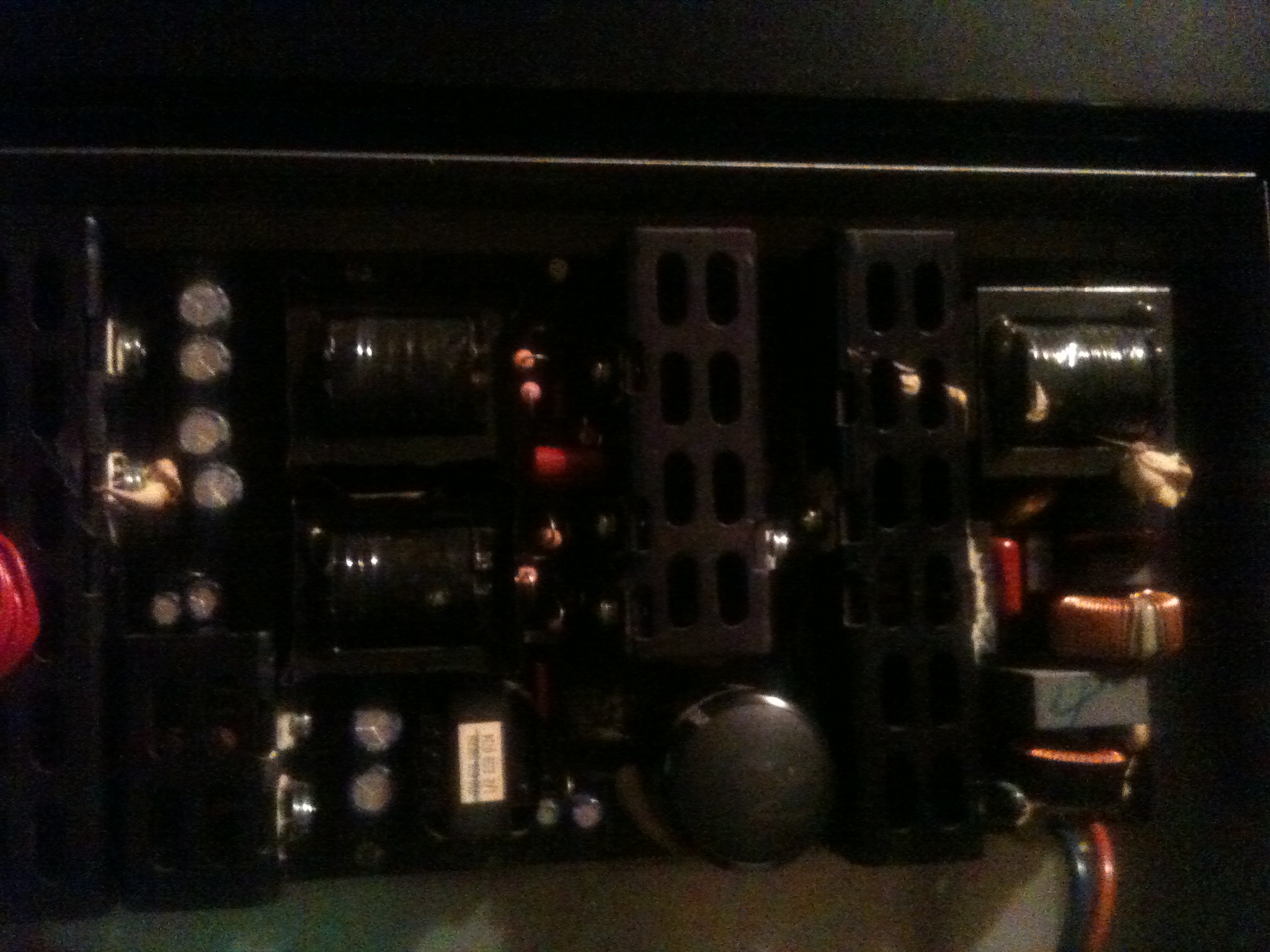

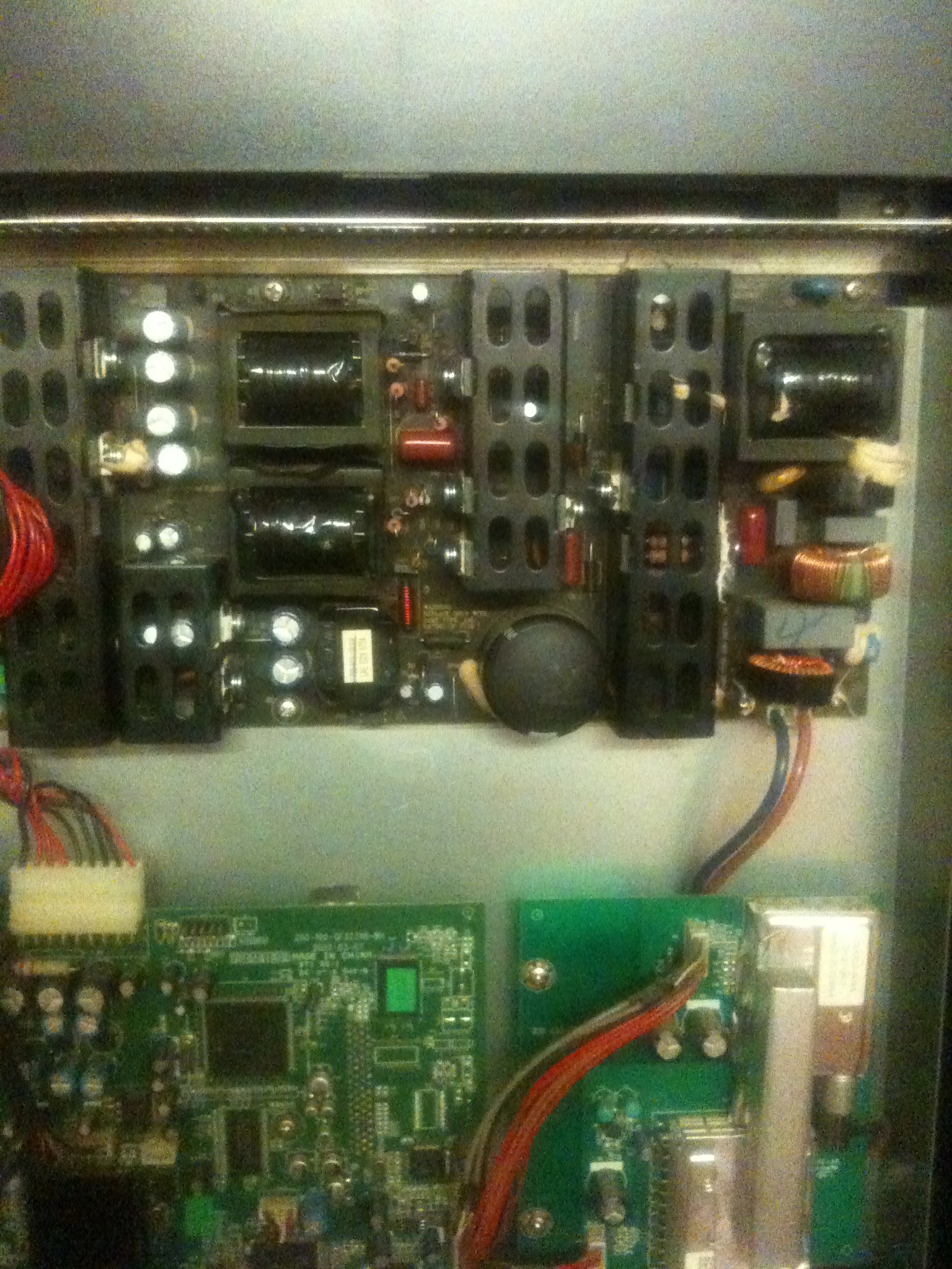

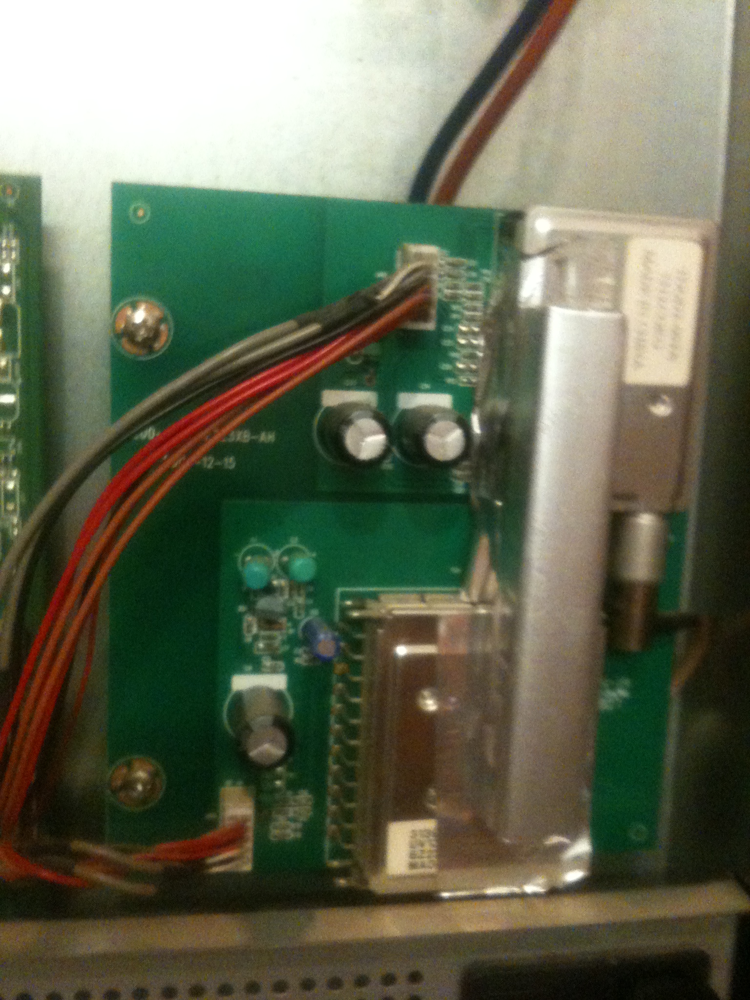

    Hi i have been given one of these lcd sets,it has a fault it wont switch on ? any ideas for a start off.
    Re: Bush LCD37TV016HD
    Pictures will help us see what you have and what we are dealing with.
    • LEEDASH
      • Dec 2012
      • 481
      • Bedfordshire
        Virtually unusable pictures, you will need to get better pictures. Common fault on this set is two bad caps.

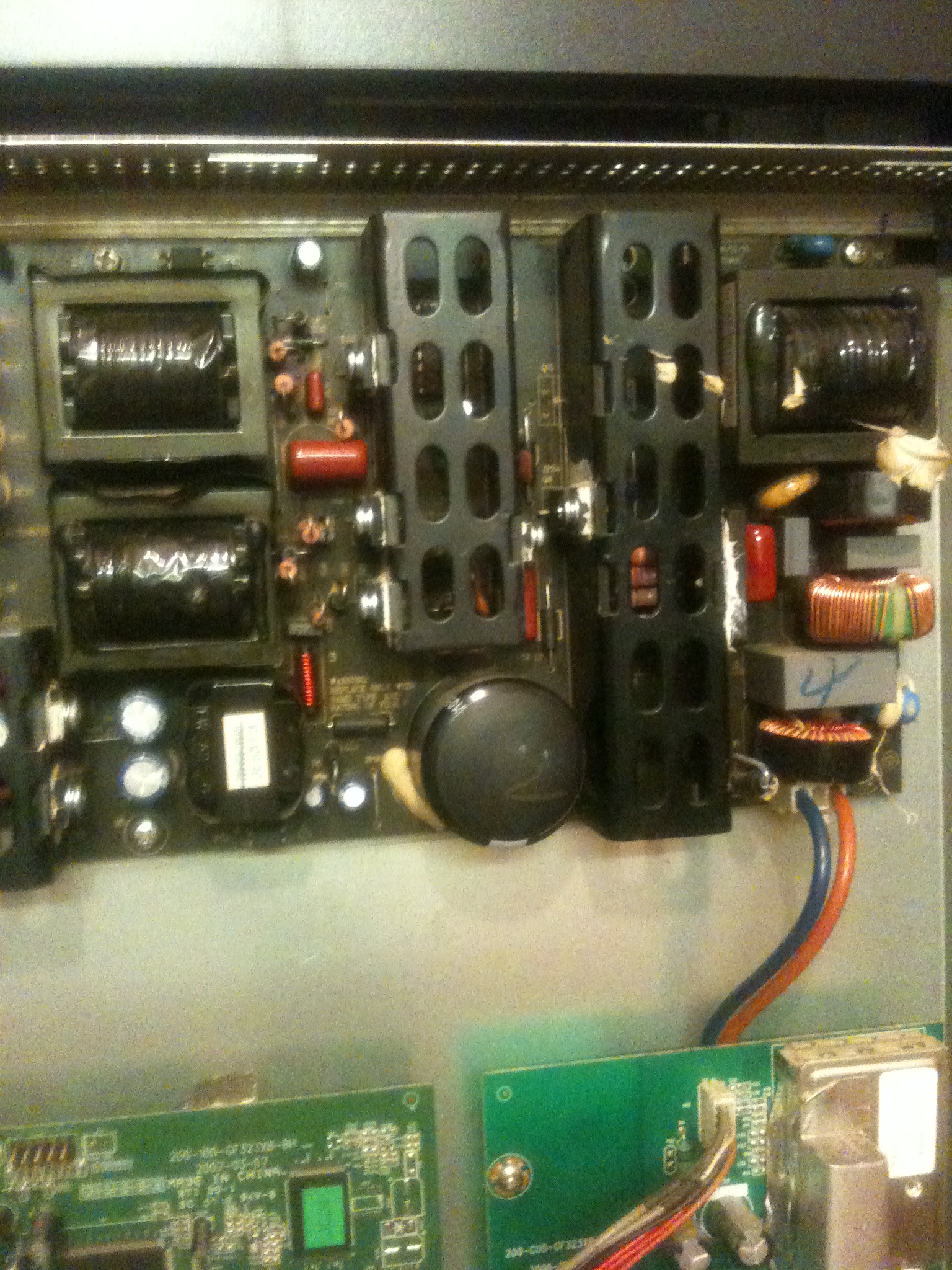

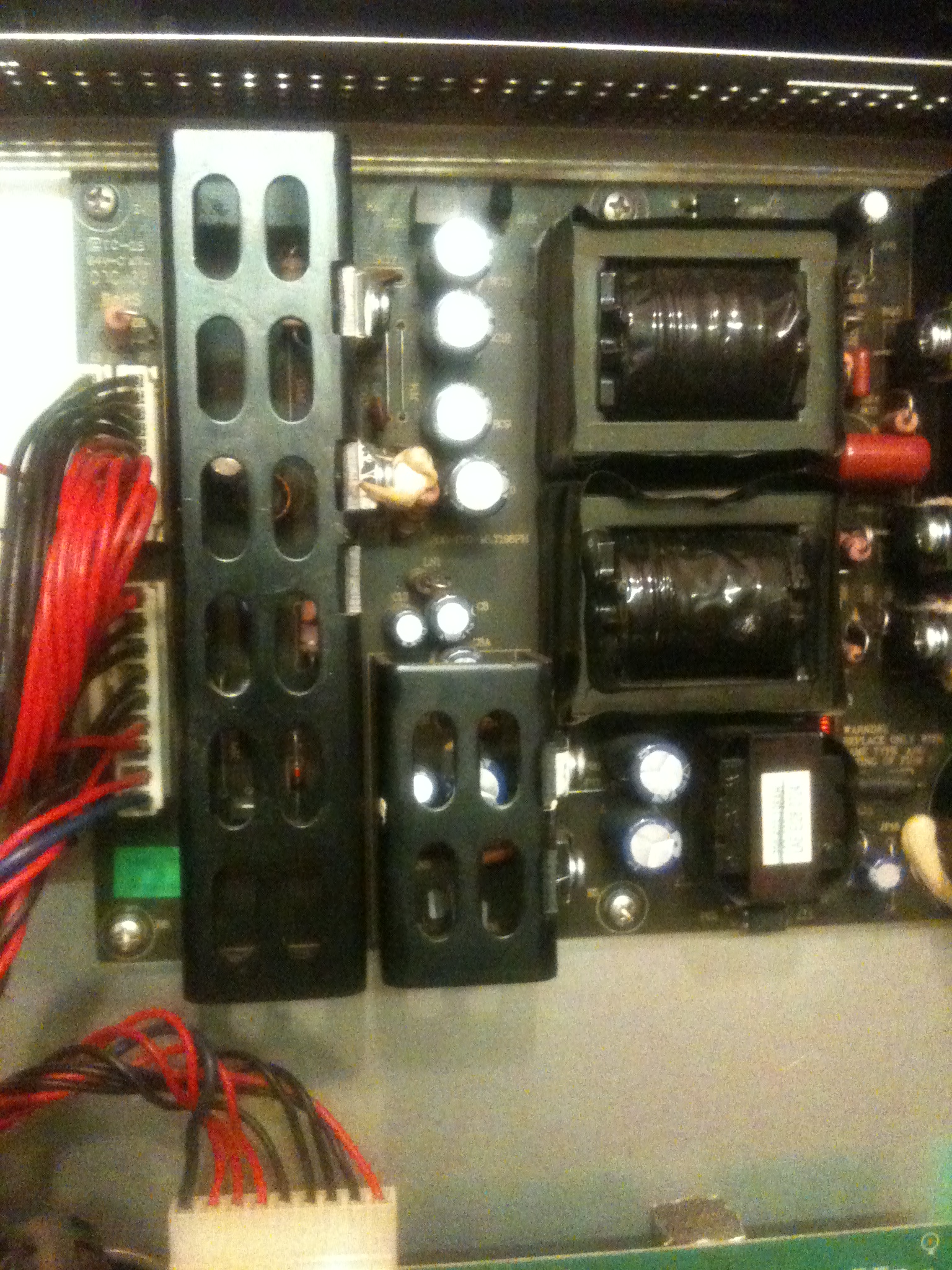

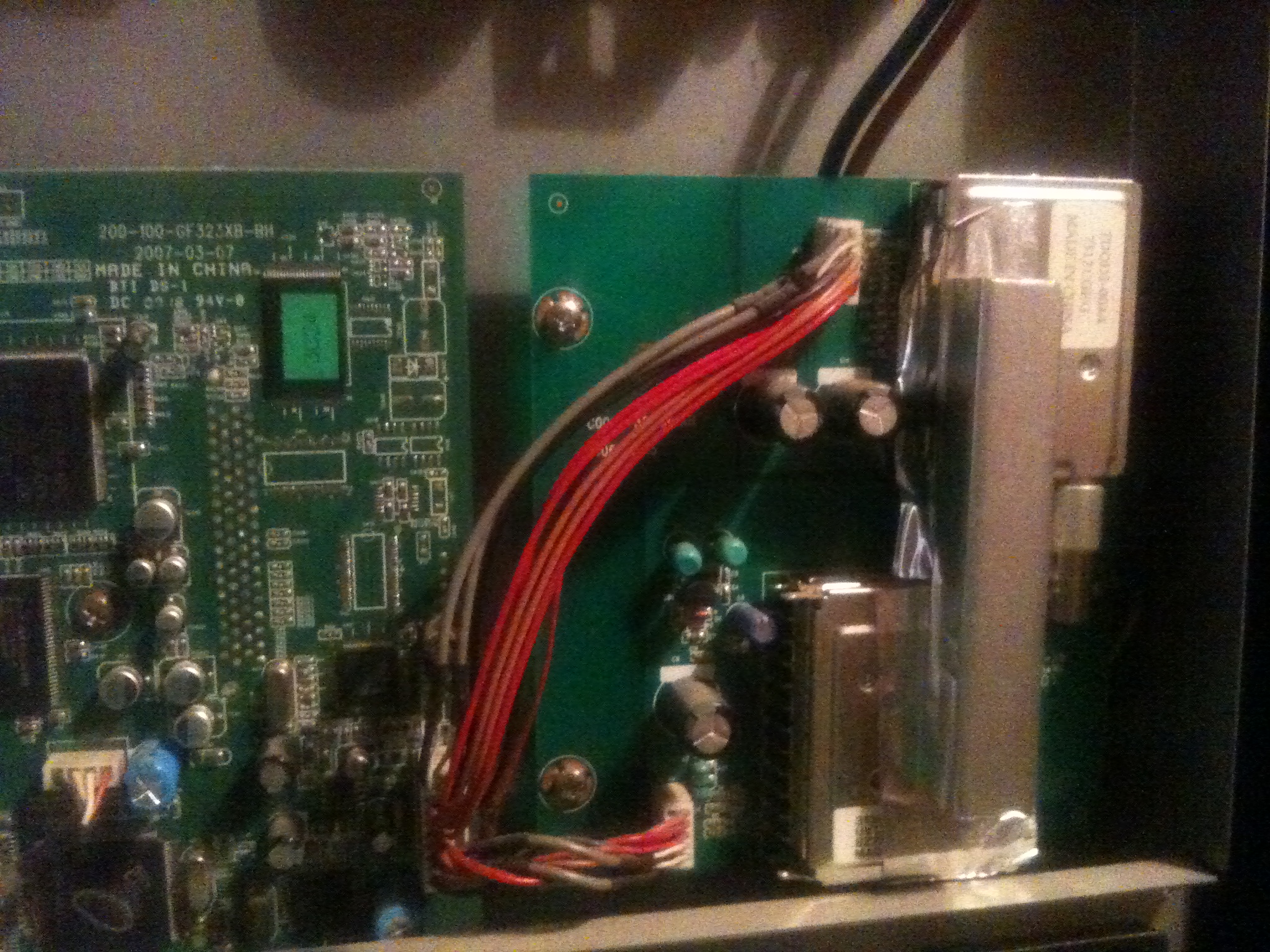

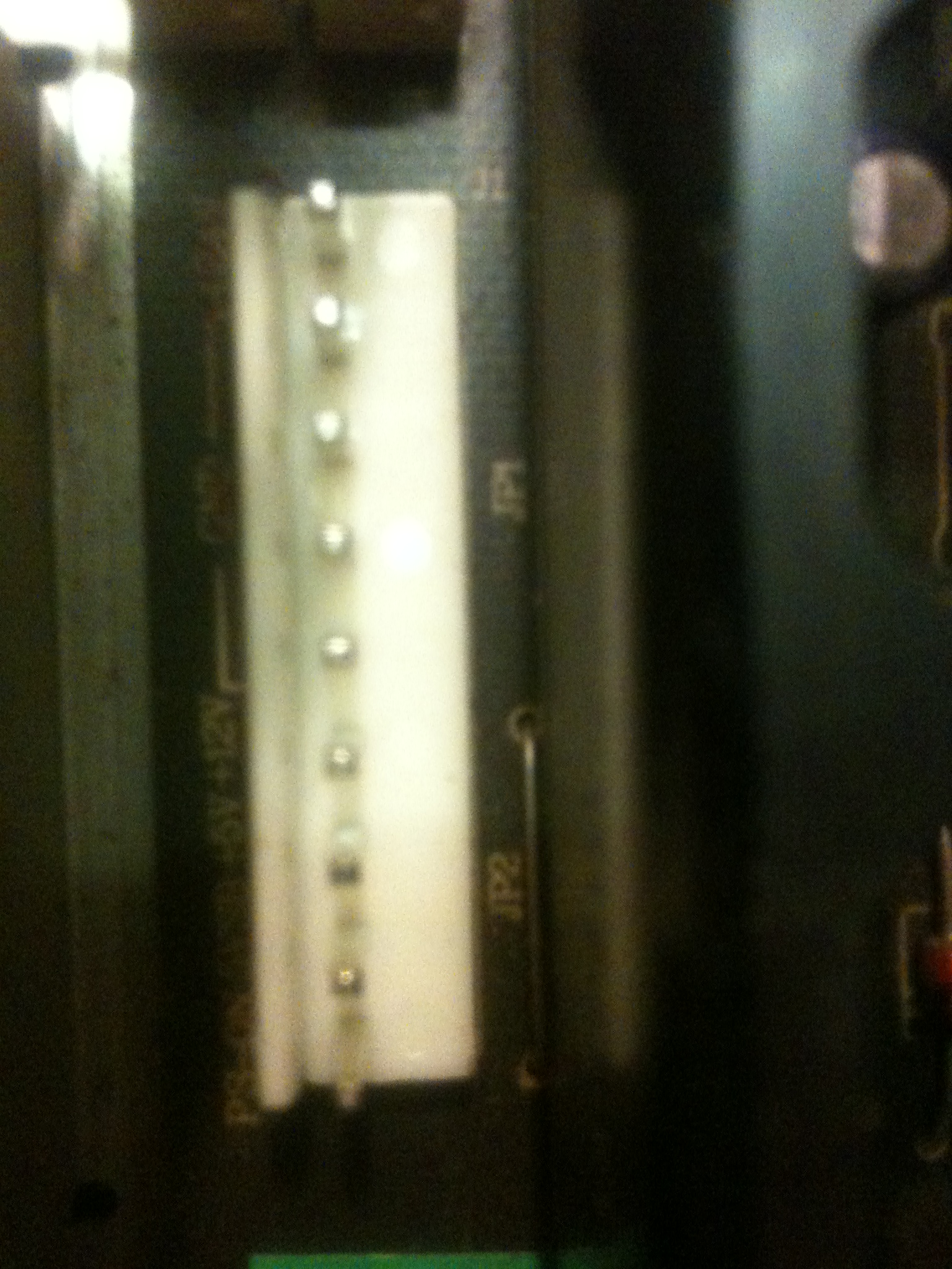

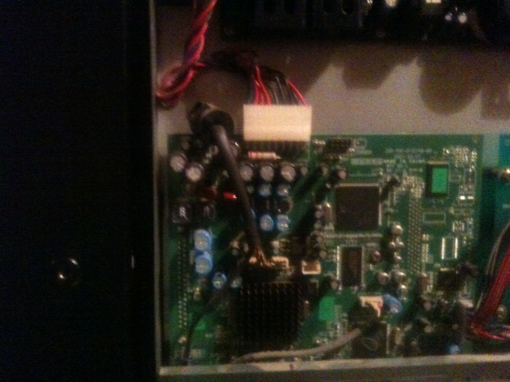

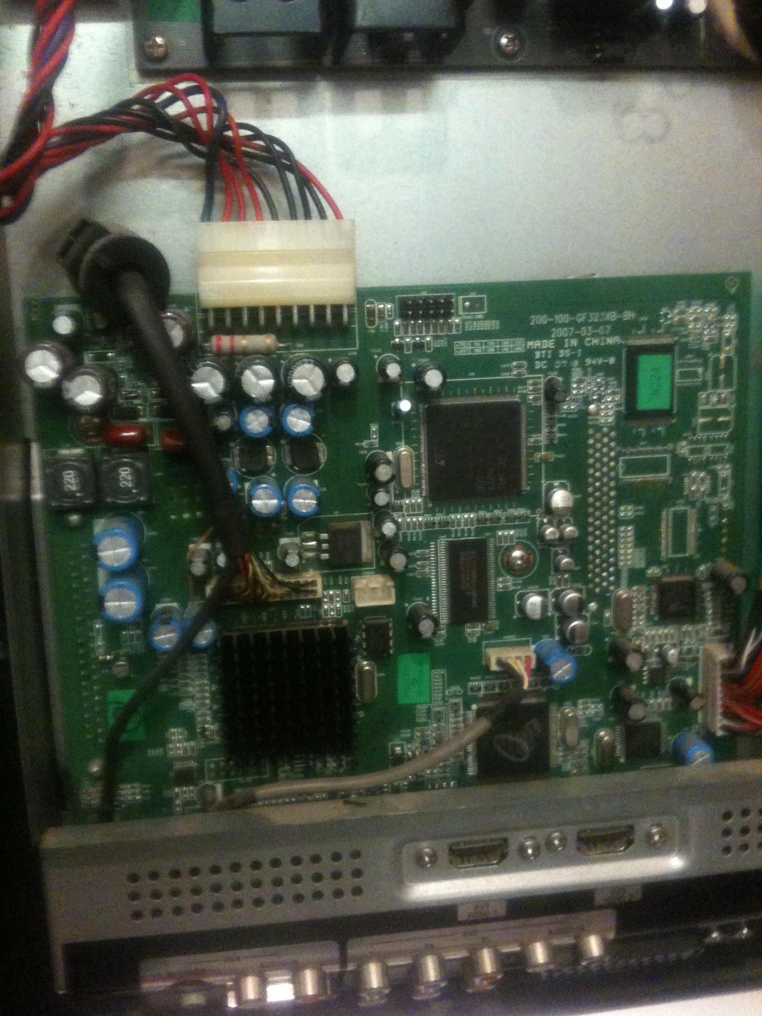

                          If ive tested it right there is not voltage running through the 5v,the board is a MLT198H,Ive uploaded maybe some clearer pictures.
                            Test each pin on this block connector on main board (top of image):
                            https://www.badcaps.net/forum/attach...2&d=1362770893
                            Voltage should be measured from each pin to the chassis ground.
                                  cant get any reading,did check the fuse next to the where the power socket goes in,(clear fuse has small blob in middle of it ?
                                    Please post your readings. Use DC20V. Saying you have "no reading" doesn't tell me enough.
