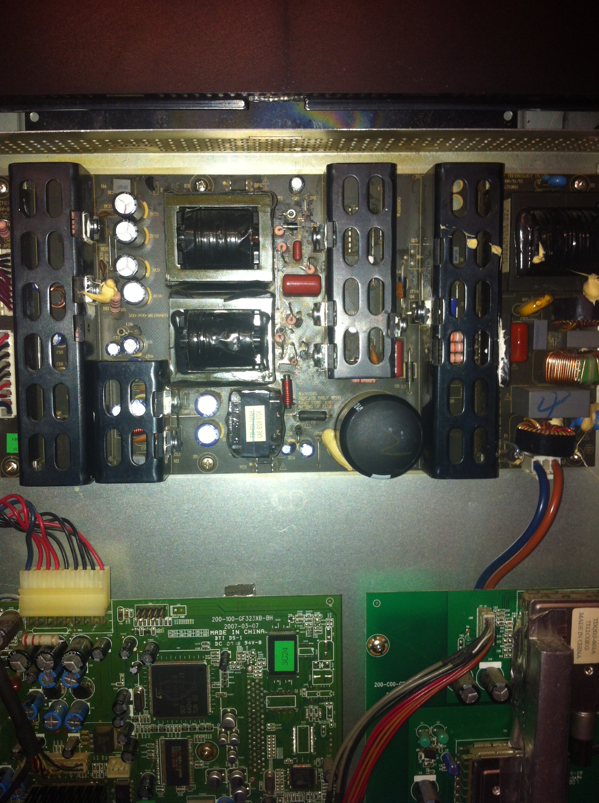

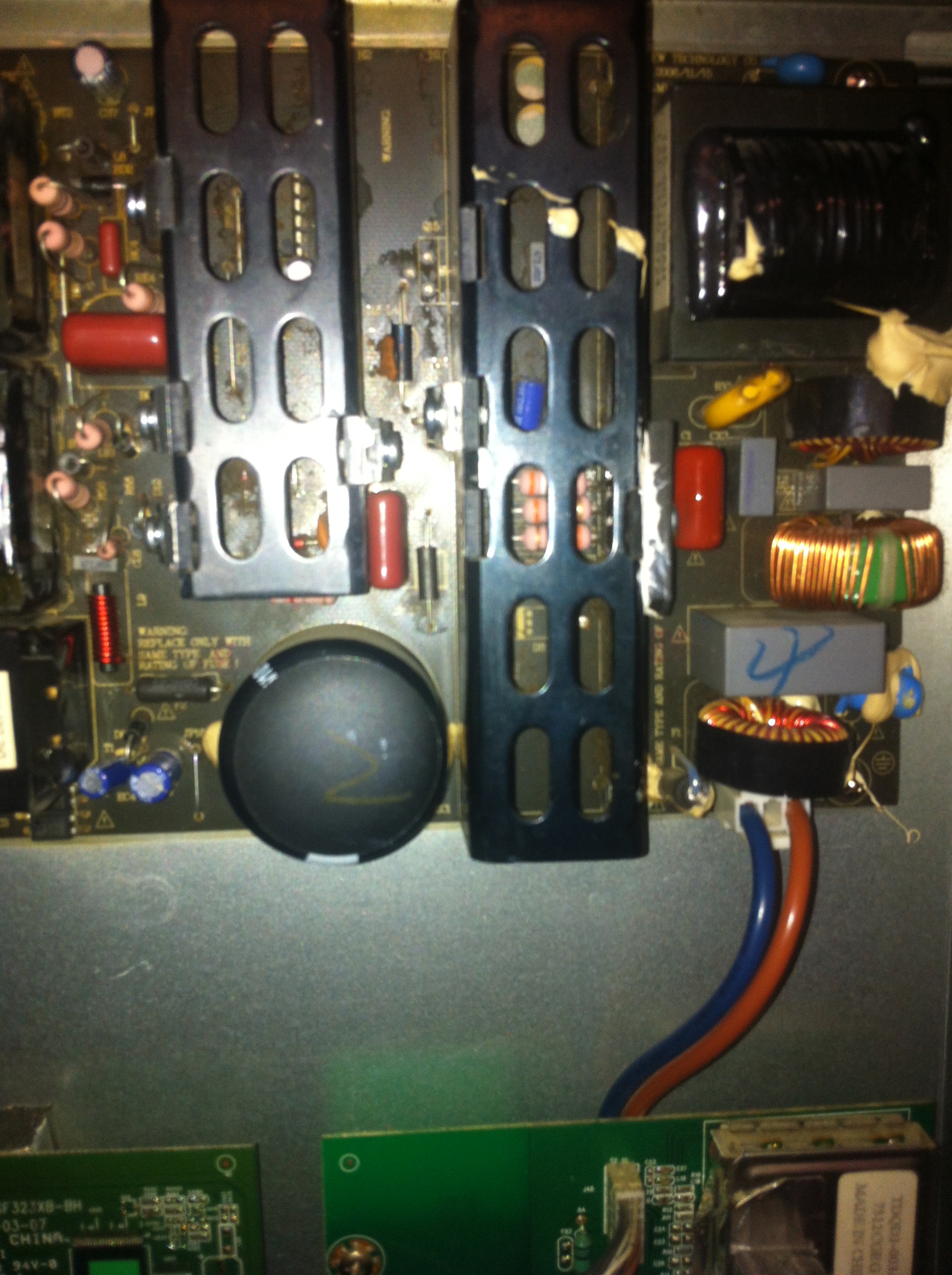

    It's good, then. Reinstall the PSU, and provide clearer pictures for me to work from please, as I cannot suggest any more without those.

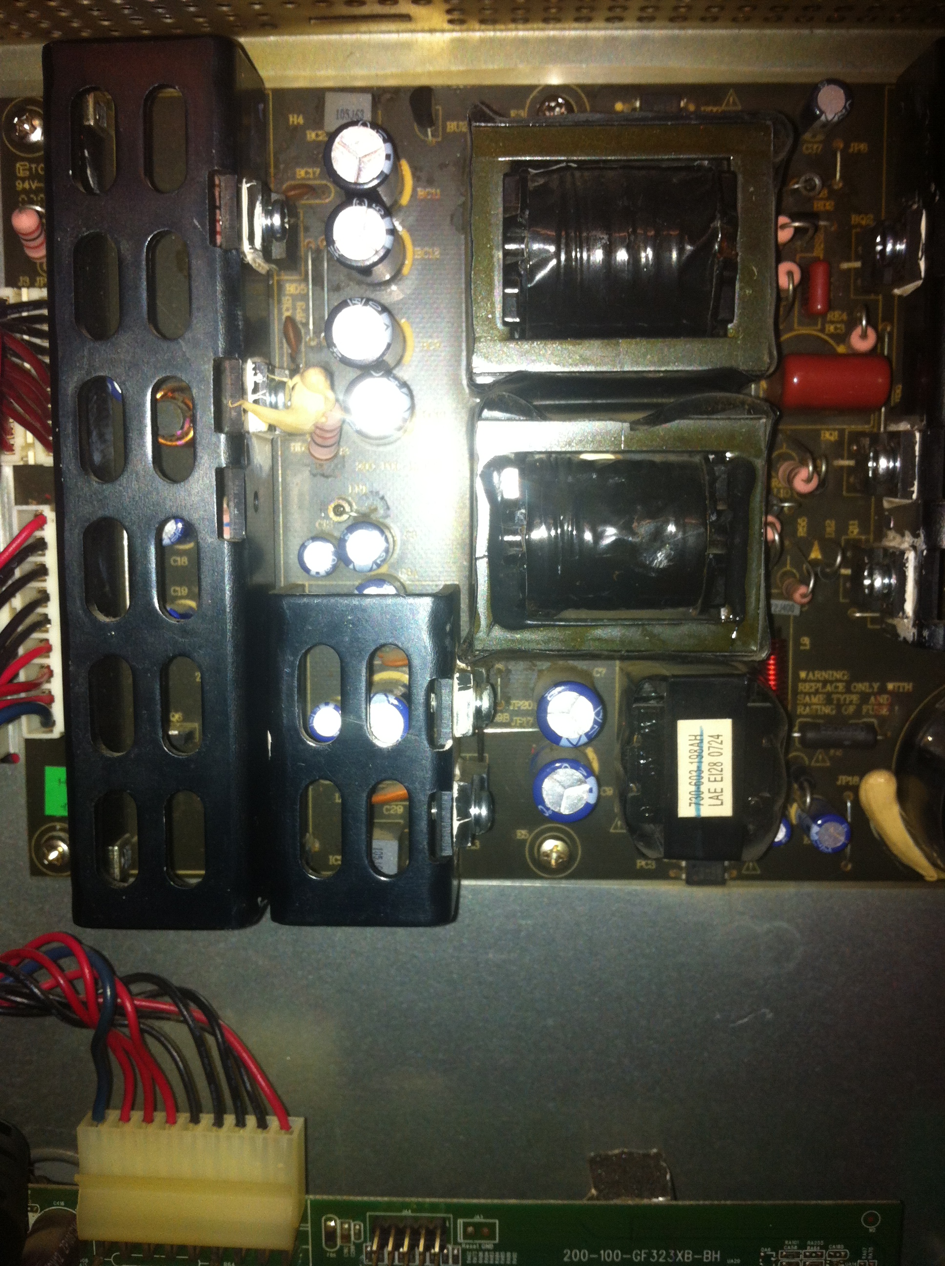

      #42
      Re: Bush LCD37TV016HD
      Can you work from these.
        #43
        No. I can't. The pictures are blurry and there's flash glare. I don't have the PSU in front of me, so I can't see potential faults or the design of the PSU, without good pics.

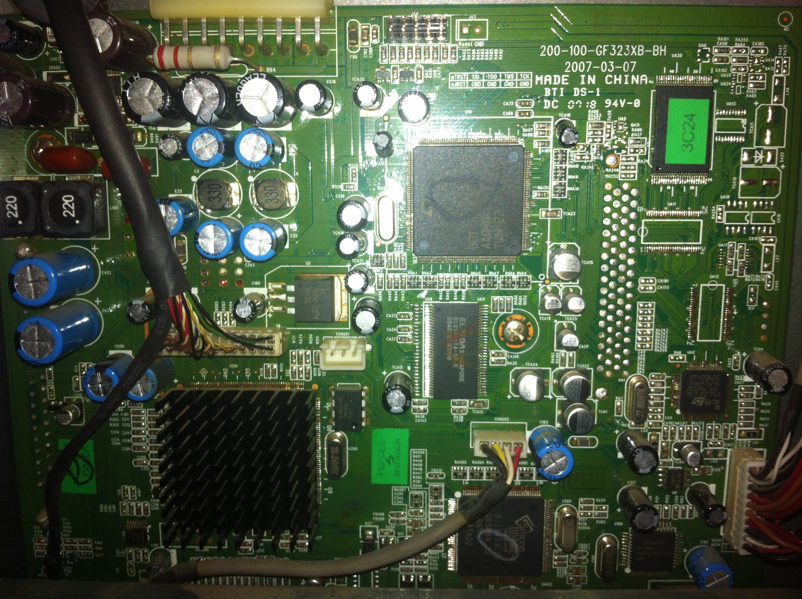

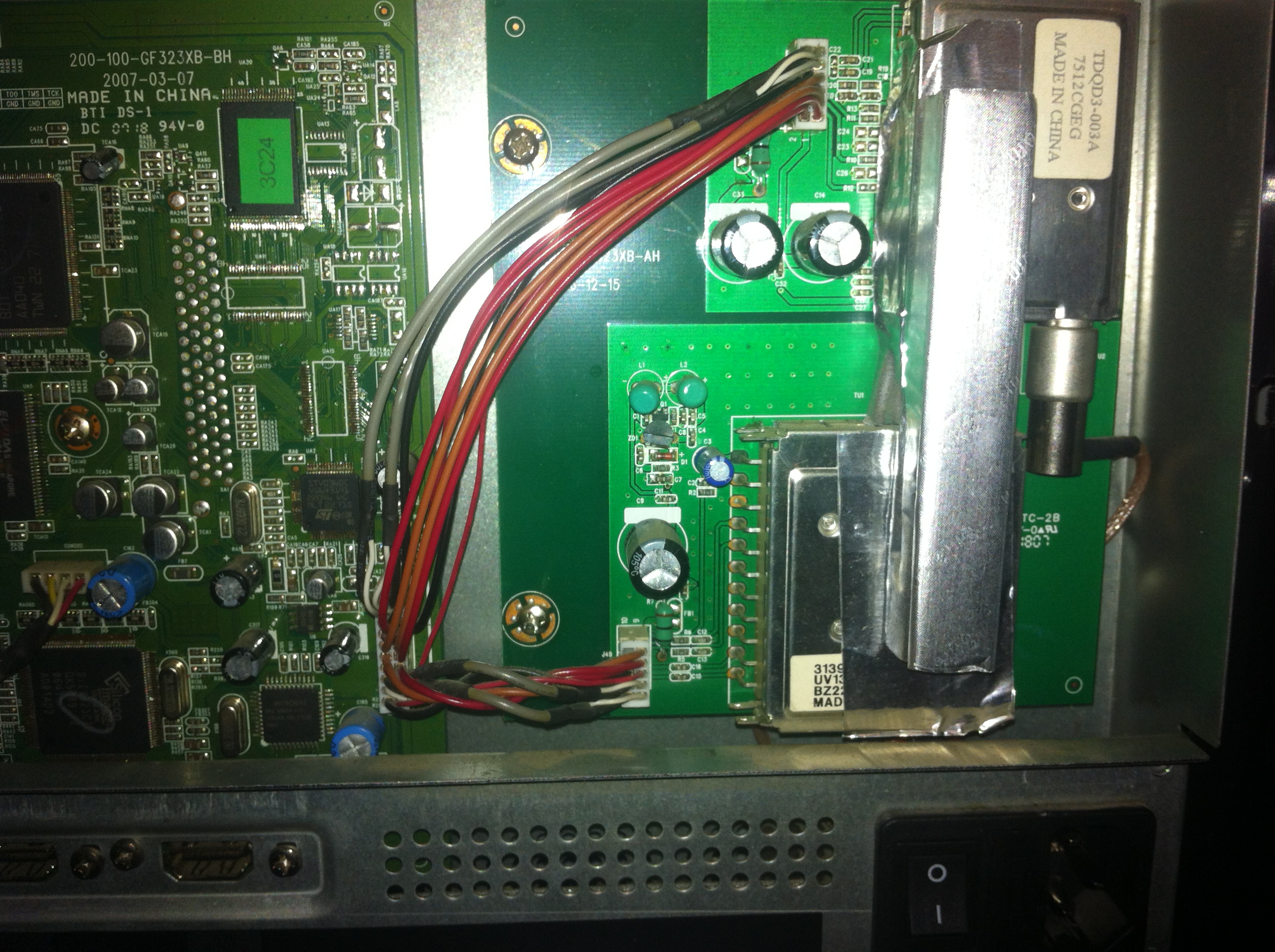

          #44
          do you want more sided pics than straight on
            #45
            I think you need to buy or borrow a better camera.

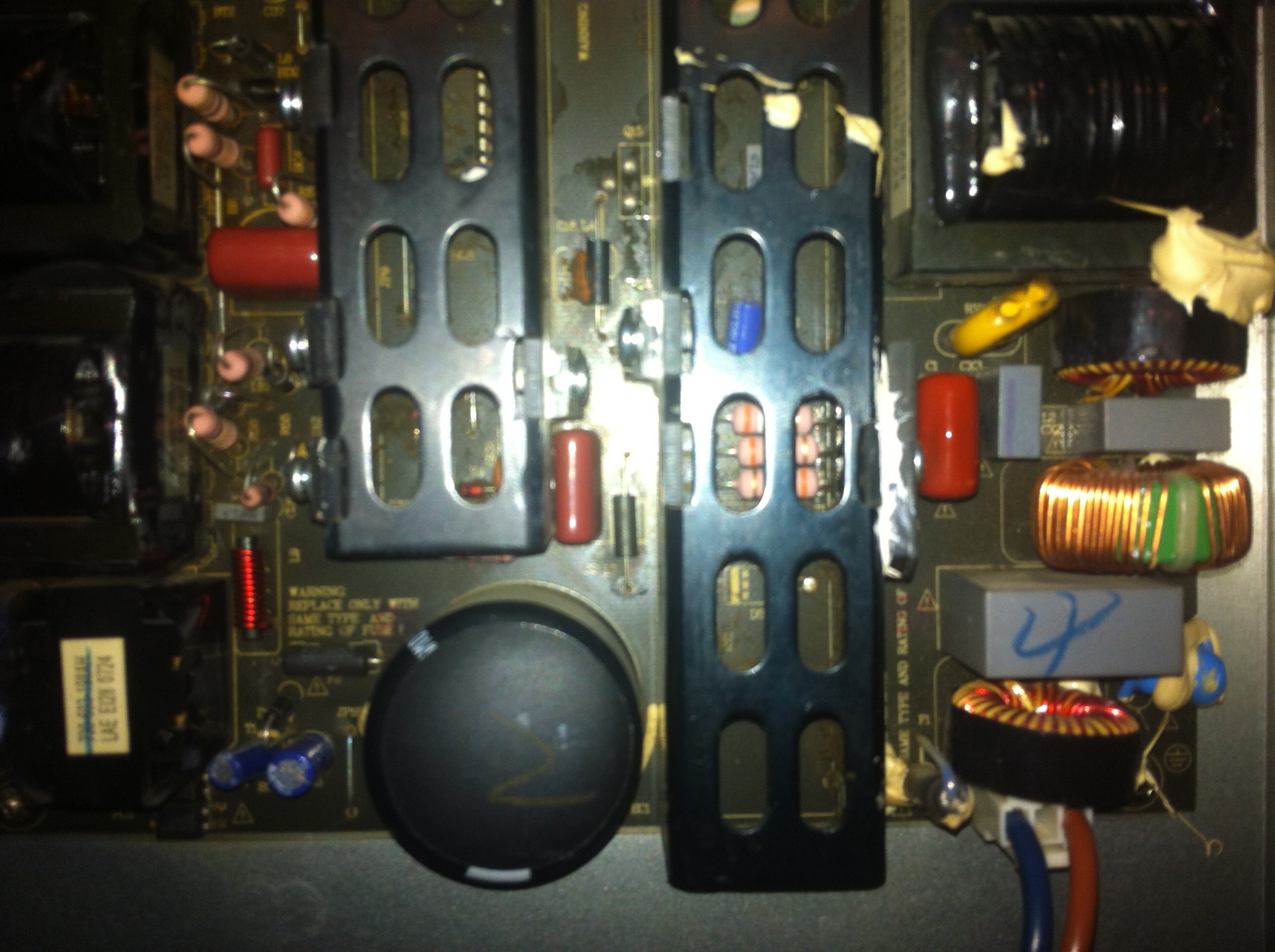

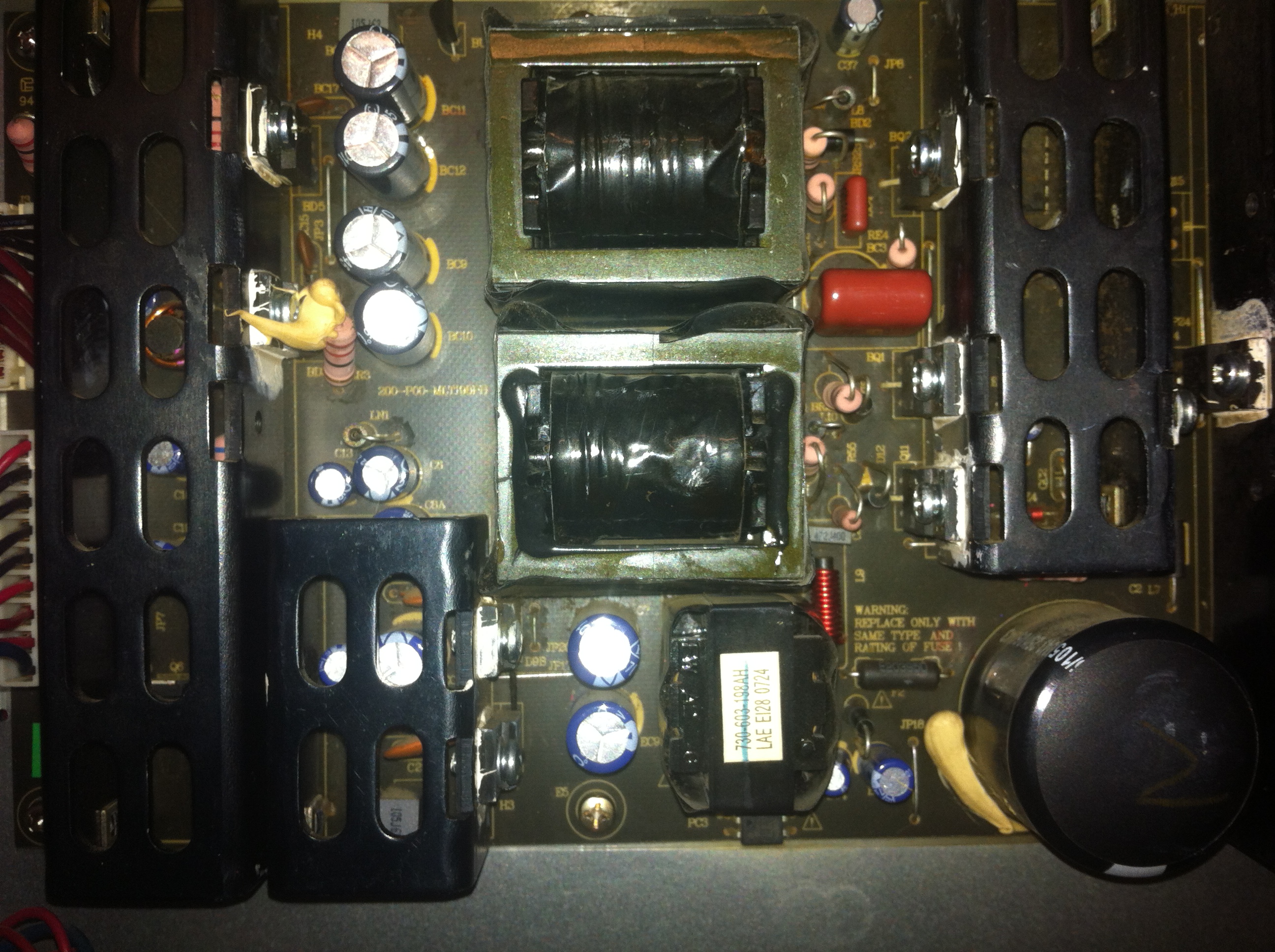

                  #48
                  there is one thing i did notice,it might be something or nothing on one of my picture there is a big cap (black on top) and that seems slight raised.
                  picture 6 below heatsink and next to other heatsink,this looks like it might do a big job on this pcb.
                    #49
                    Would be unlikely for that to cause no power issues.
                    • flocko
                      • Nov 2012
                      • 1121
                      • uk
                      #50
                      Look to the left of the big cap were it says replace with same size fuse, thing that looks like a resistor marked F2 that would be fuse.
                      • LEEDASH
                        • Dec 2012
                        • 481
                        • Bedfordshire
                        #51
                        that fuse ! this fuse has no markinsg on it so would not know what to replace it with
                          has it blown ? have you checked
                            no i have not,i checked the clear one next to where the power socket goes ? would this be a common fault flocko
                              test the fuse, set off same as Tom told you on the other fuse, if its bad we can help find a replacement
                                    Just tested the fuse we talked about reading 0.32
                                      The fuse had number 'e203950'
                                        UL safety number.
                                        http://database.ul.com/cgi-bin/XYV/c...E/srchres.html
                                        Probably for the tubing...
                                          yes i search and the E203950 is for the heat shrink,still none the wiser what to replace or even know if that fuse was putting out the right reading tom.
