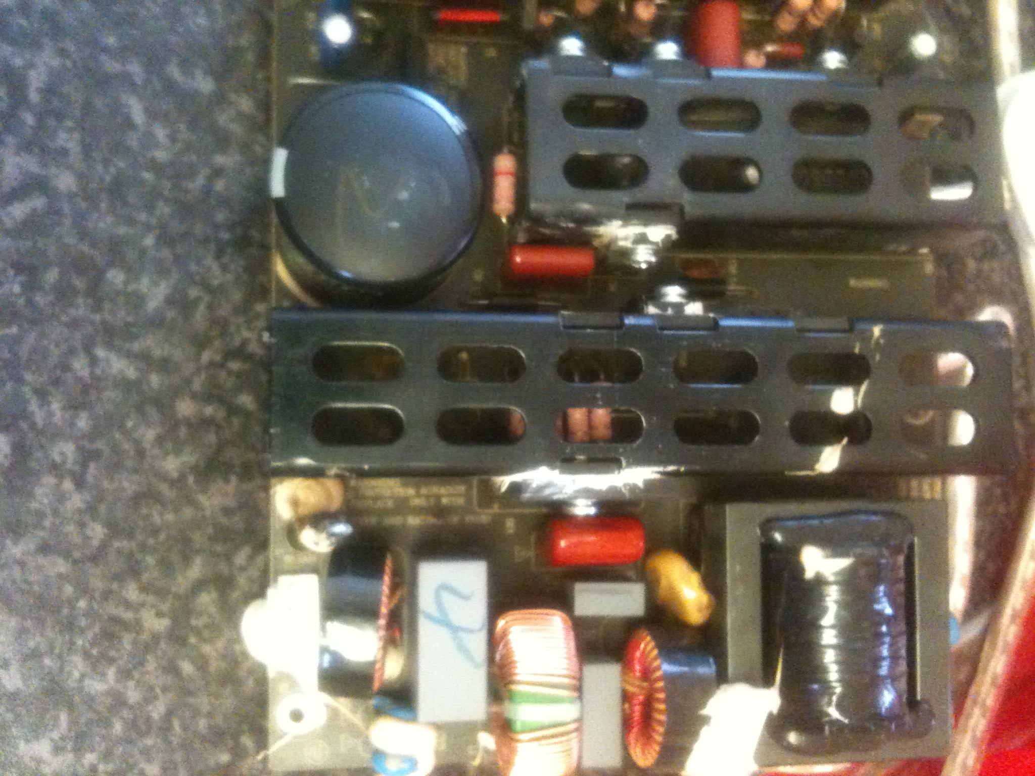

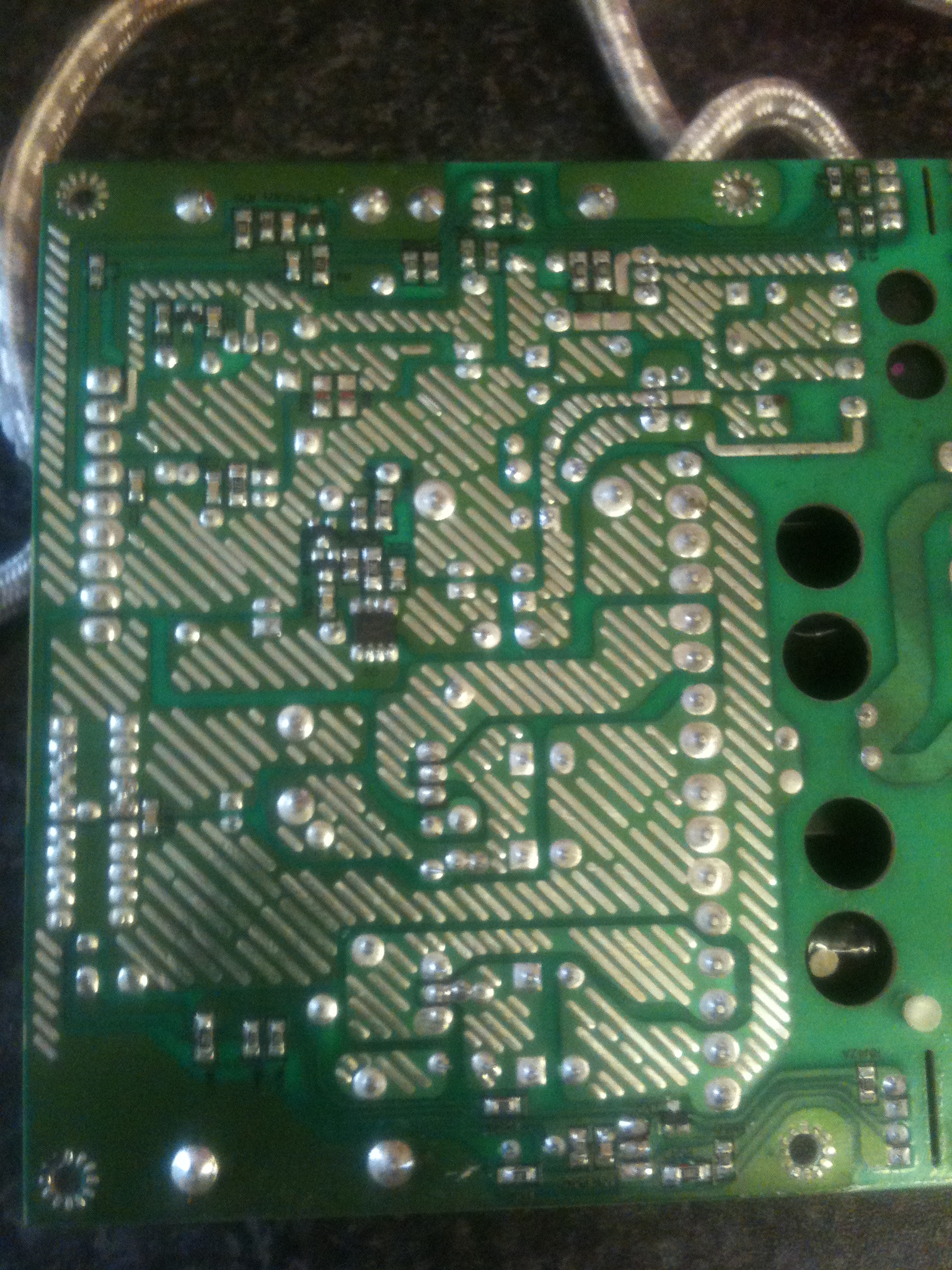

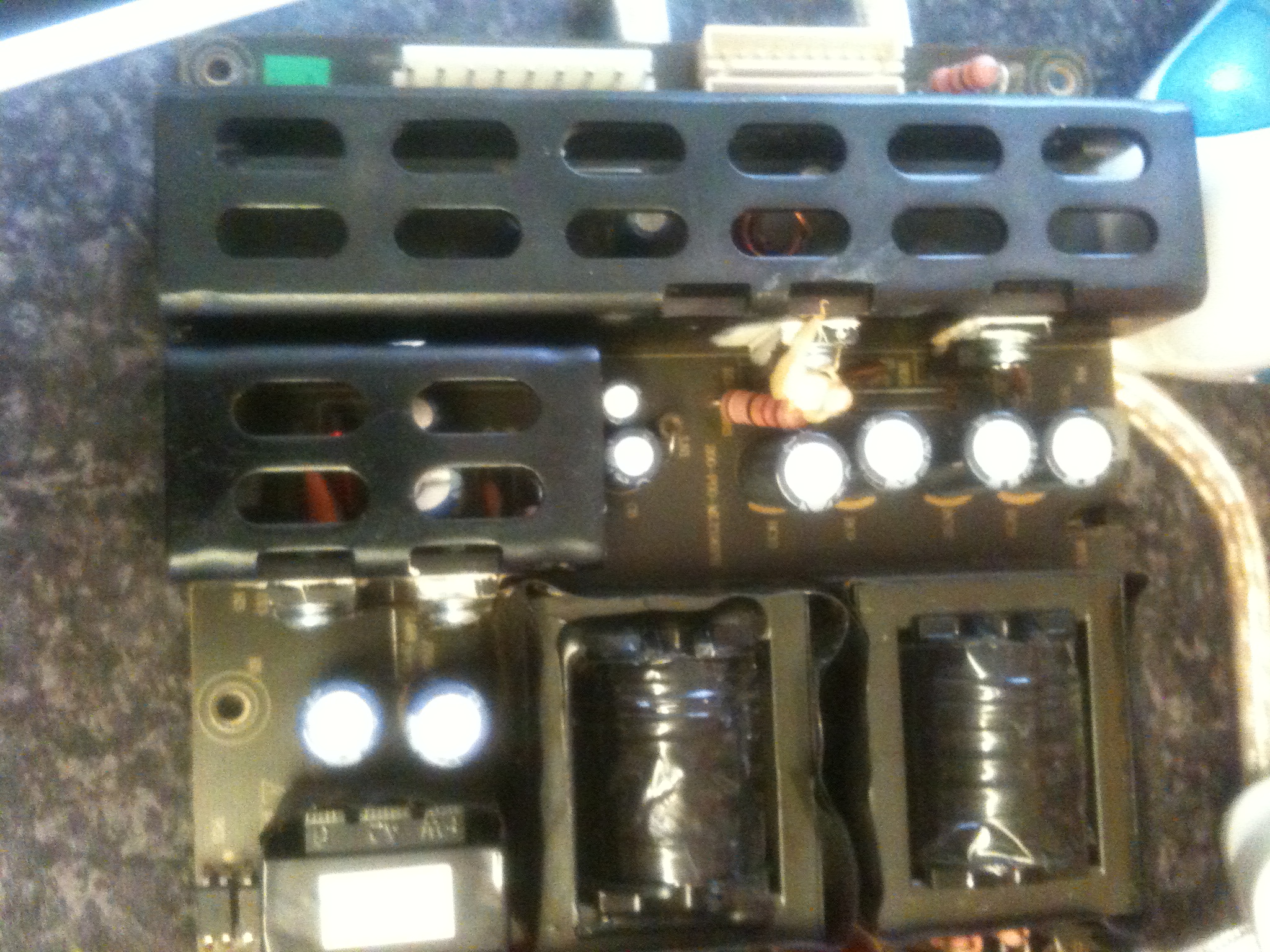

        Re: Bush LCD37TV016HD
          OK, so now we are getting somewhere. Please remove the power board and take clear photos of the top and bottom sides.
          • LEEDASH
            • Dec 2012
            • 481
            • Bedfordshire

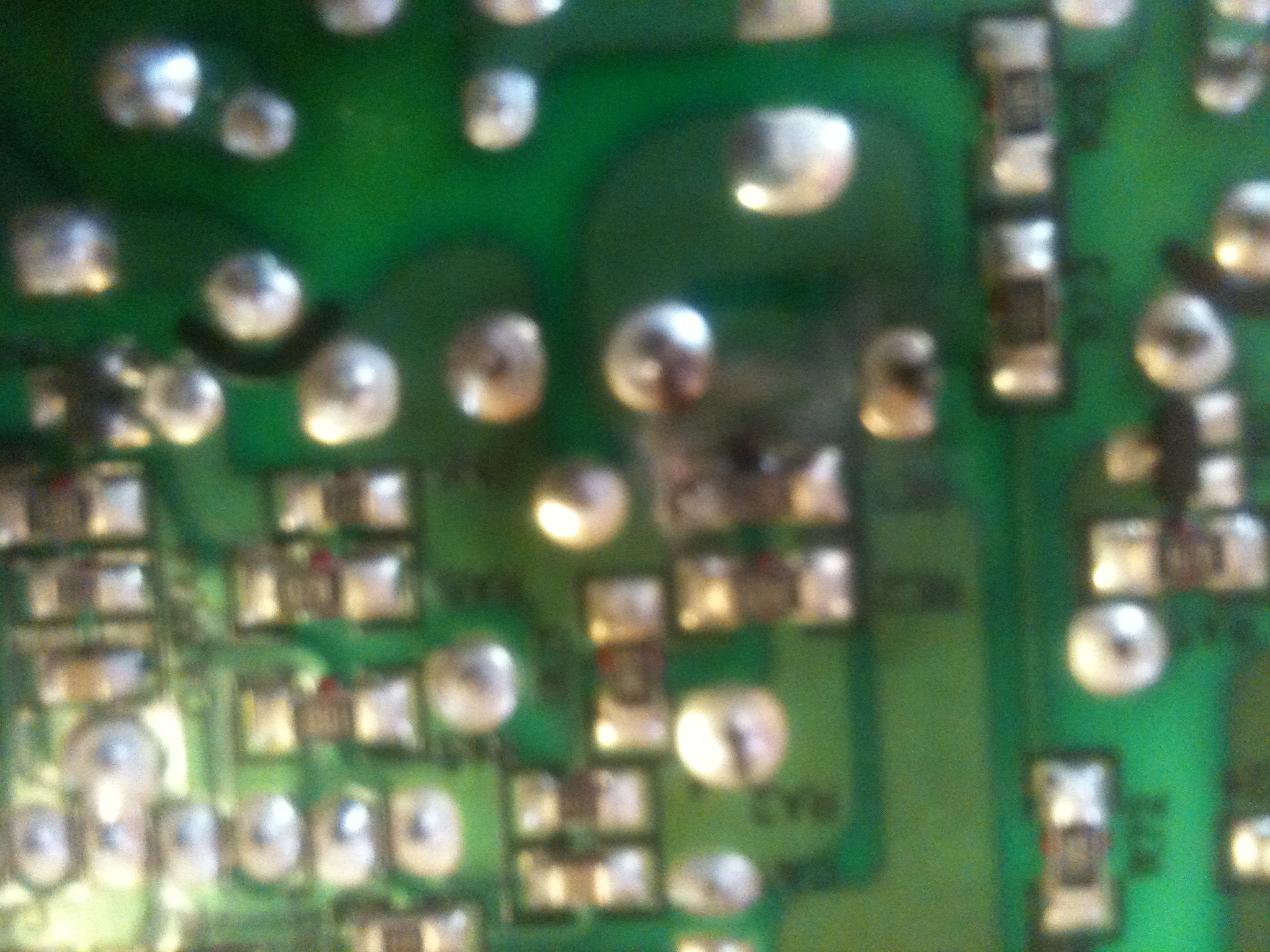

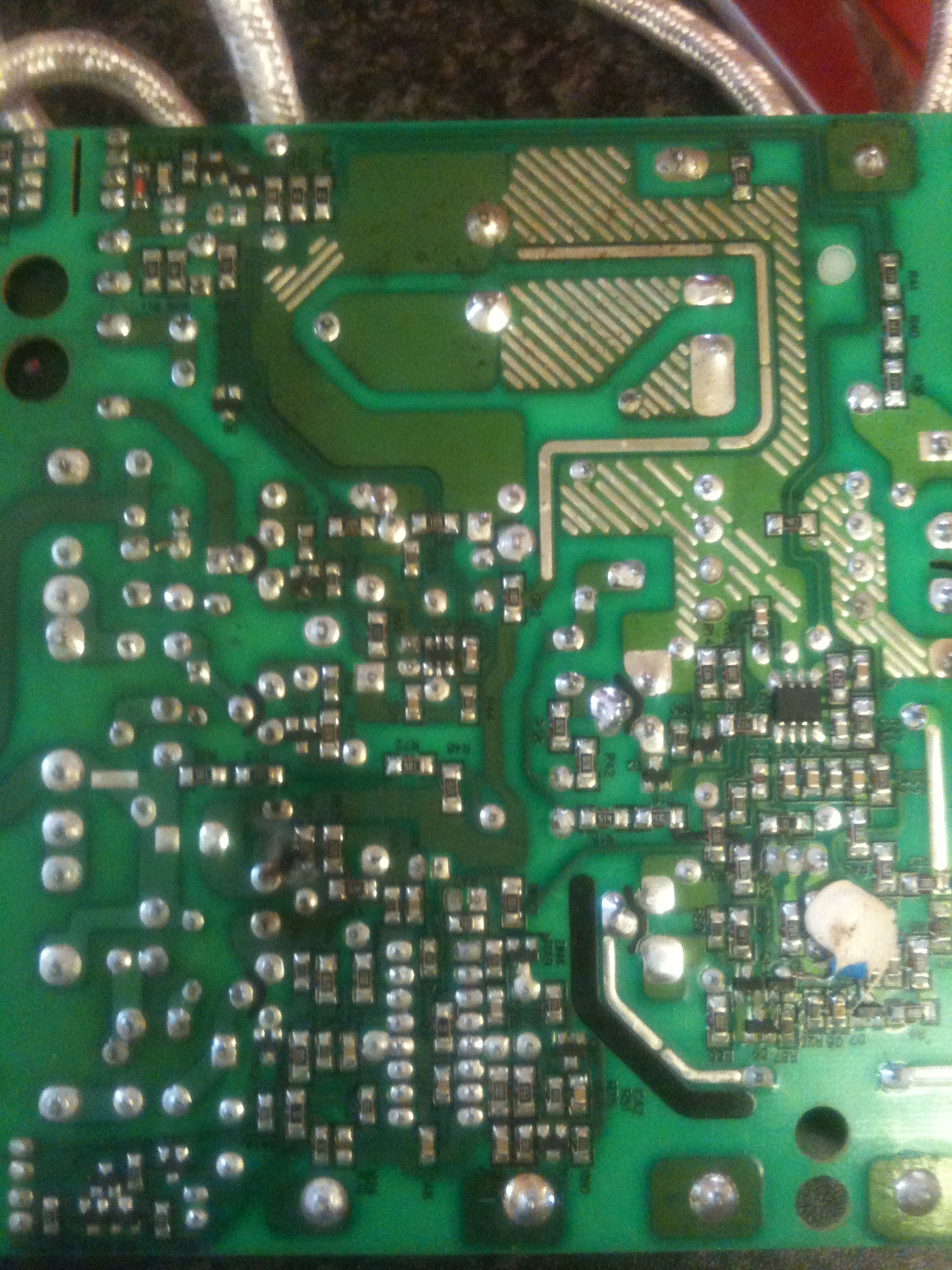

            In the last pic there seems to be a bit of diy soldering (re1) postition it is
              Pictures are fuzzy -- hard to see.
              Have you checked the fuse on PSU?

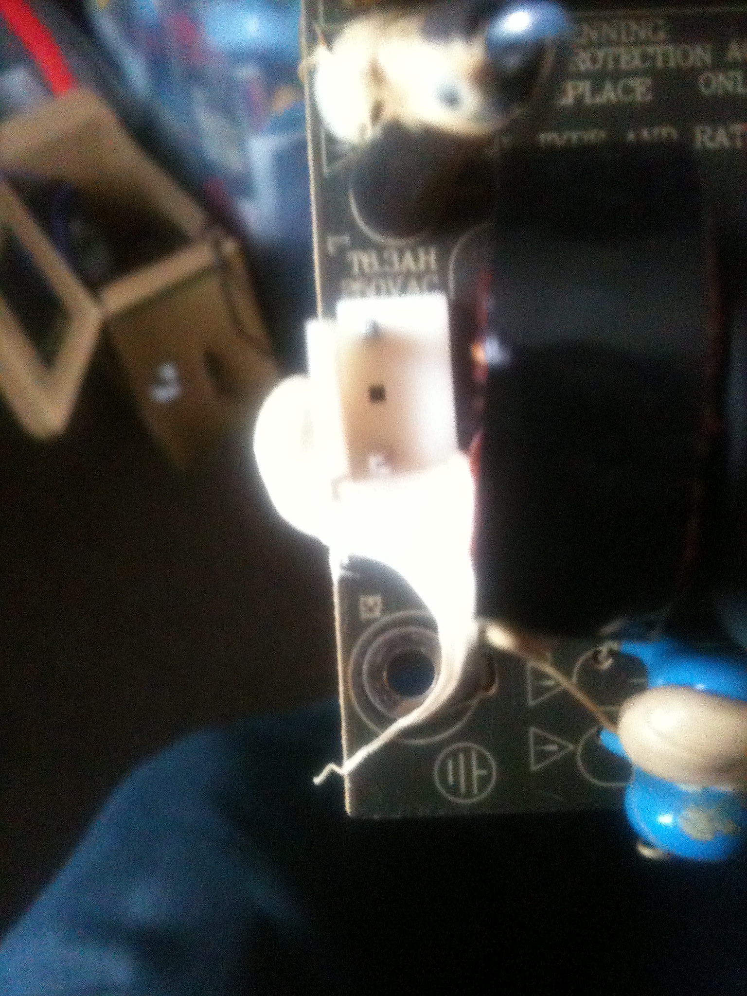

                    MLT198H Is the pcb,ive even googled and cant see one on there pics.
                      #30
                      There's definitely a fuse on there. Look for "AH 250VAC".
                      • LEEDASH
                        • Dec 2012
                        • 481
                        • Bedfordshire
                        #31
                        T6.3ah 250vac ?
                          #32
                          Possibly. Probably. Check the terminals on the bottom for continuity.
                              so have i got to test this in which voltage ? with the set on ?
                              • kevinm34232
                                • May 2012
                                • 1884
                                #35
                                That fuse may be on the back cover where the power cord gets plugged in like the Polaroids..
                                • LEEDASH
                                  • Dec 2012
                                  • 481
                                  • Bedfordshire
                                  #36
                                  yes i have noticed a fuse clear one ? next to where the power lead goes in to.
                                    #37
                                    No, set OFF, test continuity.
                                    • LEEDASH
                                      • Dec 2012
                                      • 481
                                      • Bedfordshire
                                      #38
                                      so tom,can you explain more of a dummies way as you know im thick
                                        #39
                                        Meter on 200 ohms, across the fuse, report what reading you get, and refrain from using "no reading".
                                        • LEEDASH
                                          • Dec 2012
                                          • 481
                                          • Bedfordshire
                                          #40
                                          right just testing this clear fuse which has on it 6.3al 250v,is 00.4
