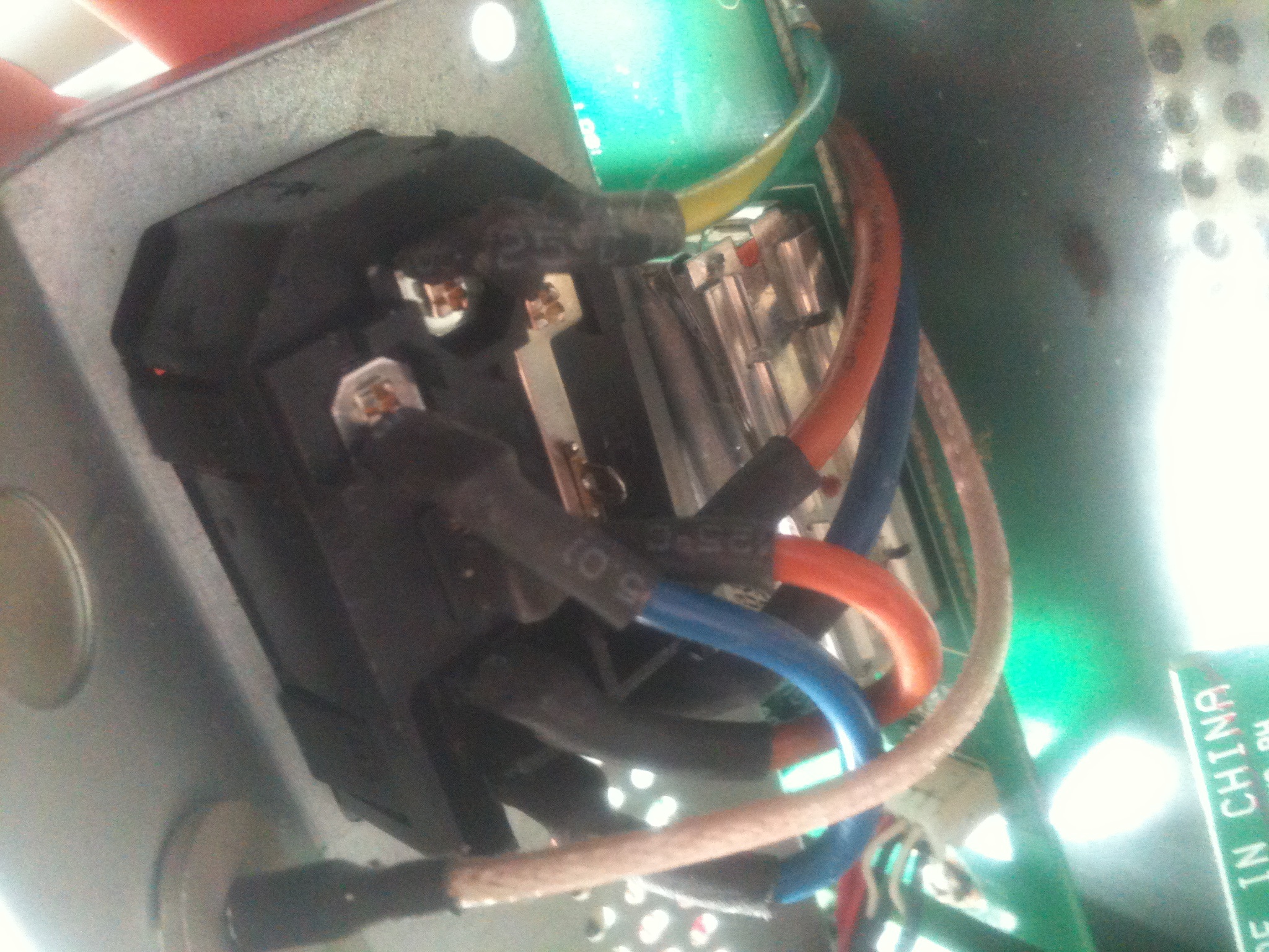

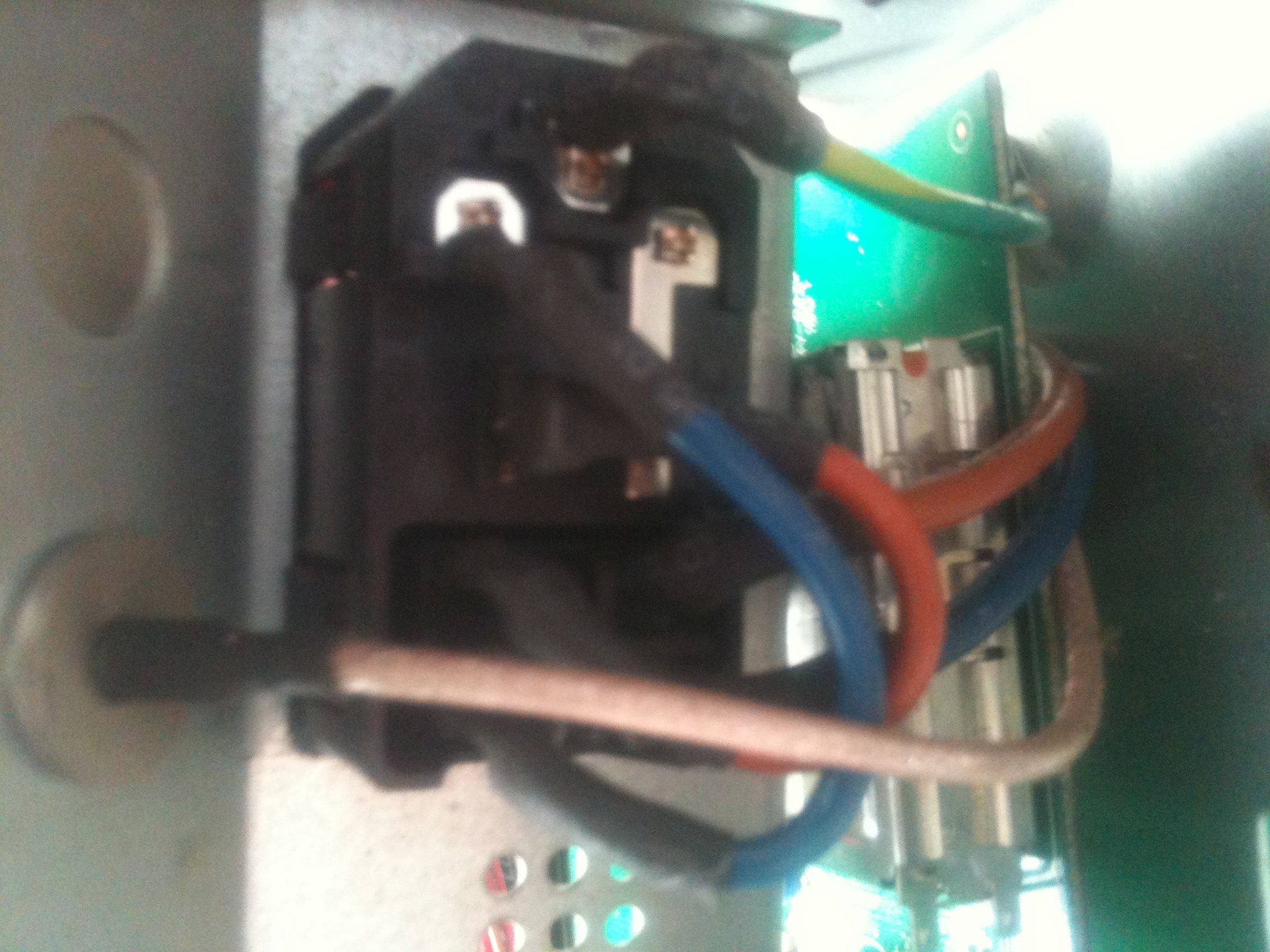

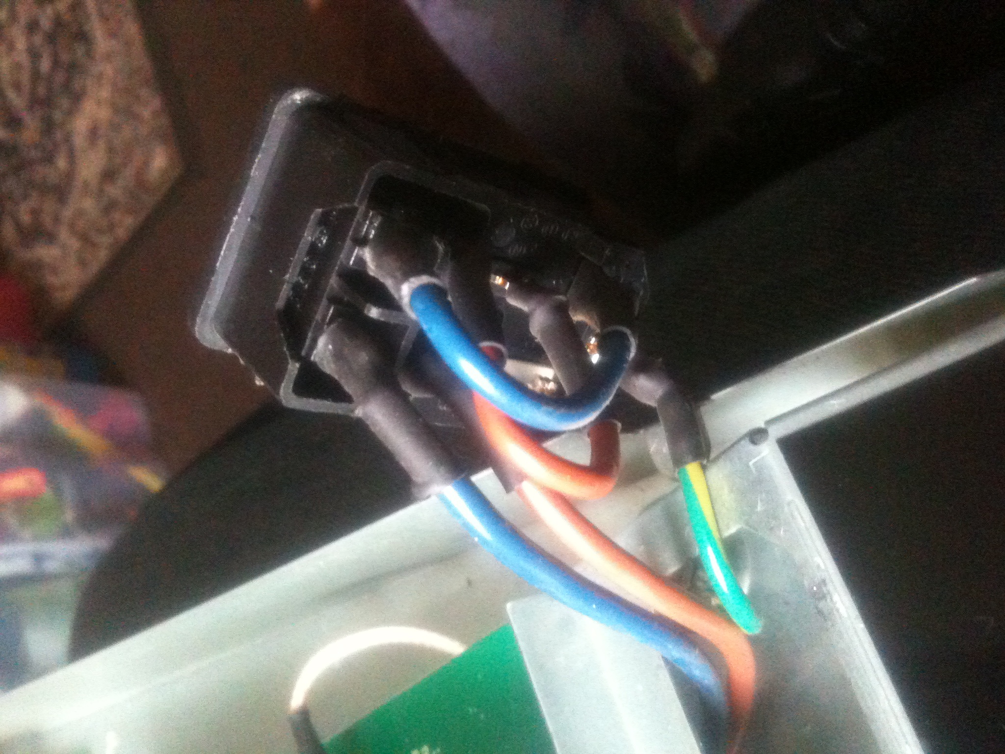

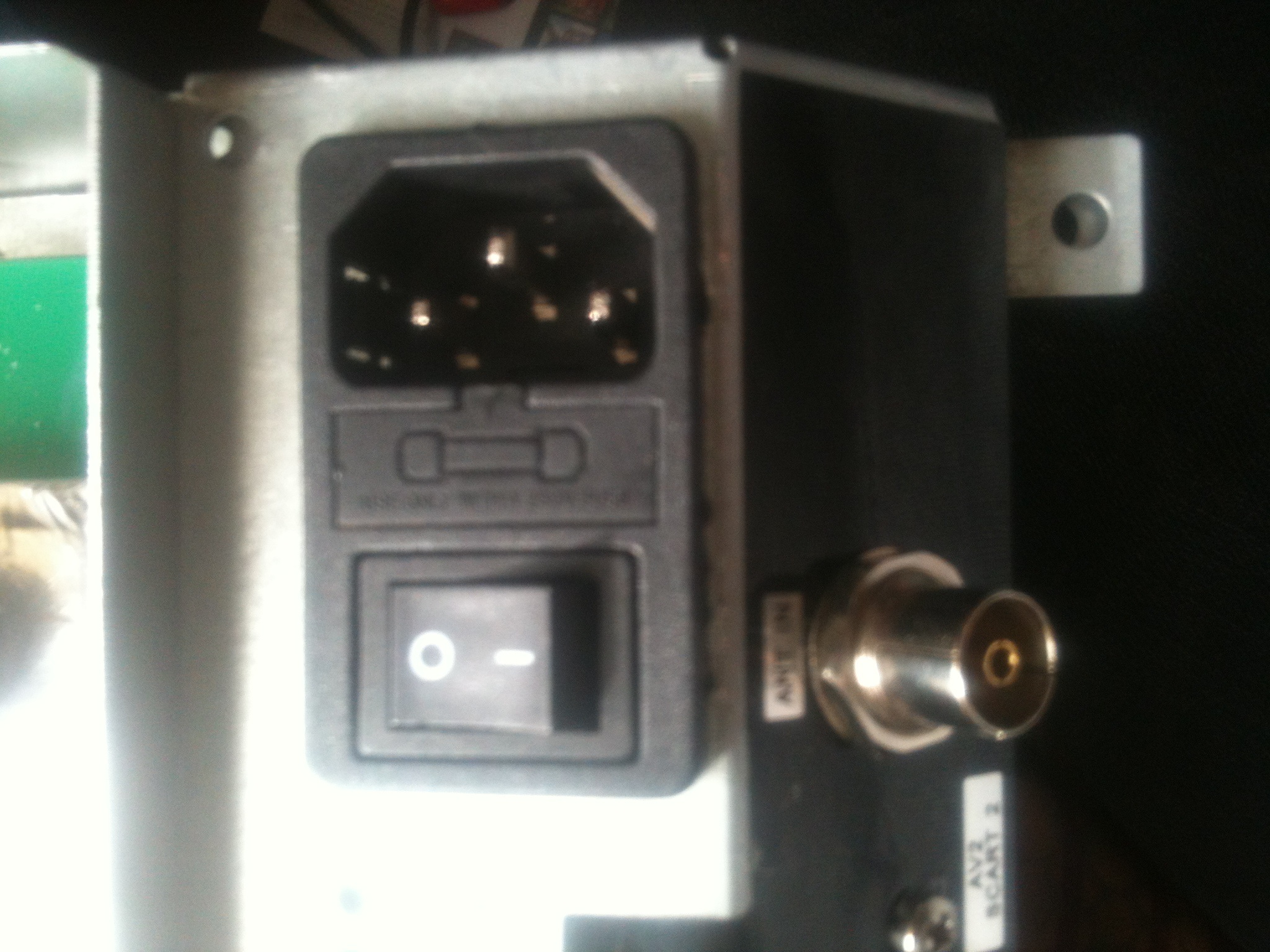

                        Pictures are getting better - can you show the other side of the switch in the last pic.
                        Is the rocker switch and the kettle socket together in the same unit?
                        • LEEDASH
                          • Dec 2012
                          • 481
                          • Bedfordshire
                          #112
                          Re: Bush LCD37TV016HD
                          You have the rocker switch then the fuse (glass) then the kettle lead

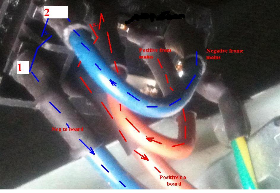

                                      Ok - Think I have got it now
                                      In the picture it looks like you can get to metal connectors at the base of each wire by pulling back the shrink a little.
                                      Working only on the switch - no kettle lead and not plugged into the board. Meter on ohms can you get at the metal under 1 and 2 on the pic test with switch one way then the other. This should bottom out if the neg side of the switch is working.
                                      EDIT should perhaps have said put one probe from the meter on 1 and the other on 2

                                        Ok,if the switch is in the on position it is fluctuating between 0.12 0.14 when it is off nothing.
                                        • selldoor
                                          Slow Learner
                                          • Dec 2010
                                          • 7870
                                          #120
                                          This really doesnt seem to be making much sense. It is almost the same test as in 106/107
                                          Put the switch in what you believe is the ON position and do the ohms test from the
                                          neg pin in the kettle socket to the first the blue position marked 1 then the blue position marked 2
                                          I am still wndering about your meter Hold the probes together (in one hand cross them and hold between thumb and forefinger)) and it should go almost to 0.00 then gently tug the probes and see if it goes to 1 on the left side or OL or whatever it shows when
                                          the probes are apart.
