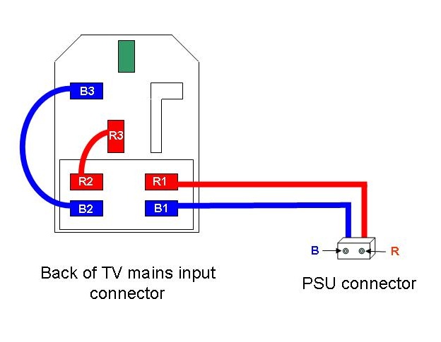

                    ...but from previous tests we have established more than once that there is no continuity between the mains plug & the white mains connector block to the PSU board.
                    I have attached a diagram. Could you unplug the kettle lead from the TV. Unplug the white block connector from the PSU board. Switch the ON/OFF switch on the TV to ON. Then connect your meter to points B & B1, then B & B2, then B & B3. Could you then connect the meter to R & R1, then R & R2, then R & R3. Let us know the results.
                    The connectors on the white block connector that go to the PSU board are sockets, so make sure your probe actually touches the metal part.
                    I think it is worth another attempt at continuity before getting mains voltages involved. We know from one of the earlier tests that there is no continuity between the mains plug & the bridge diode on the PSU, although to be honest, it's getting hard to remember what's been tested & what hasn't.
