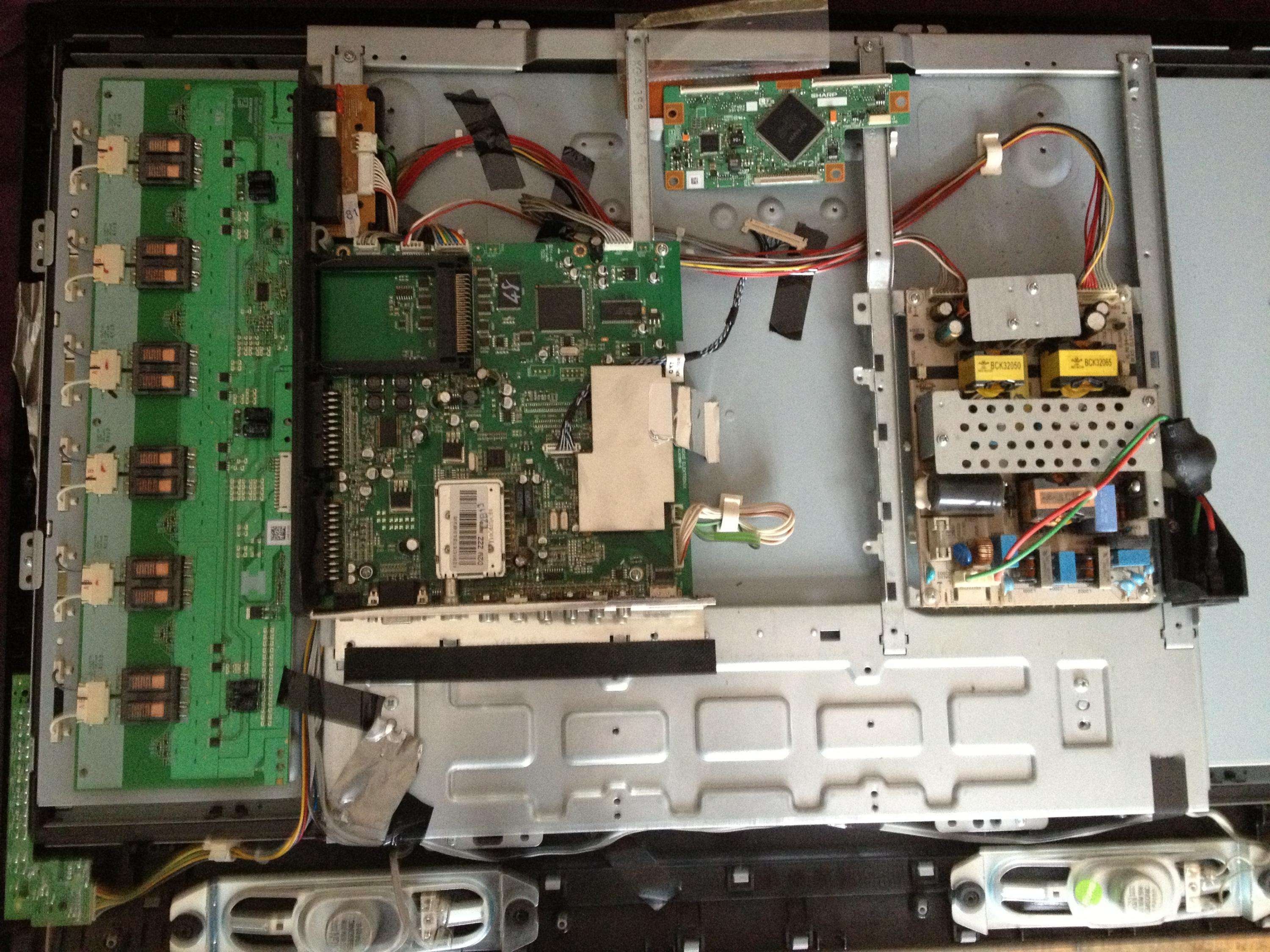

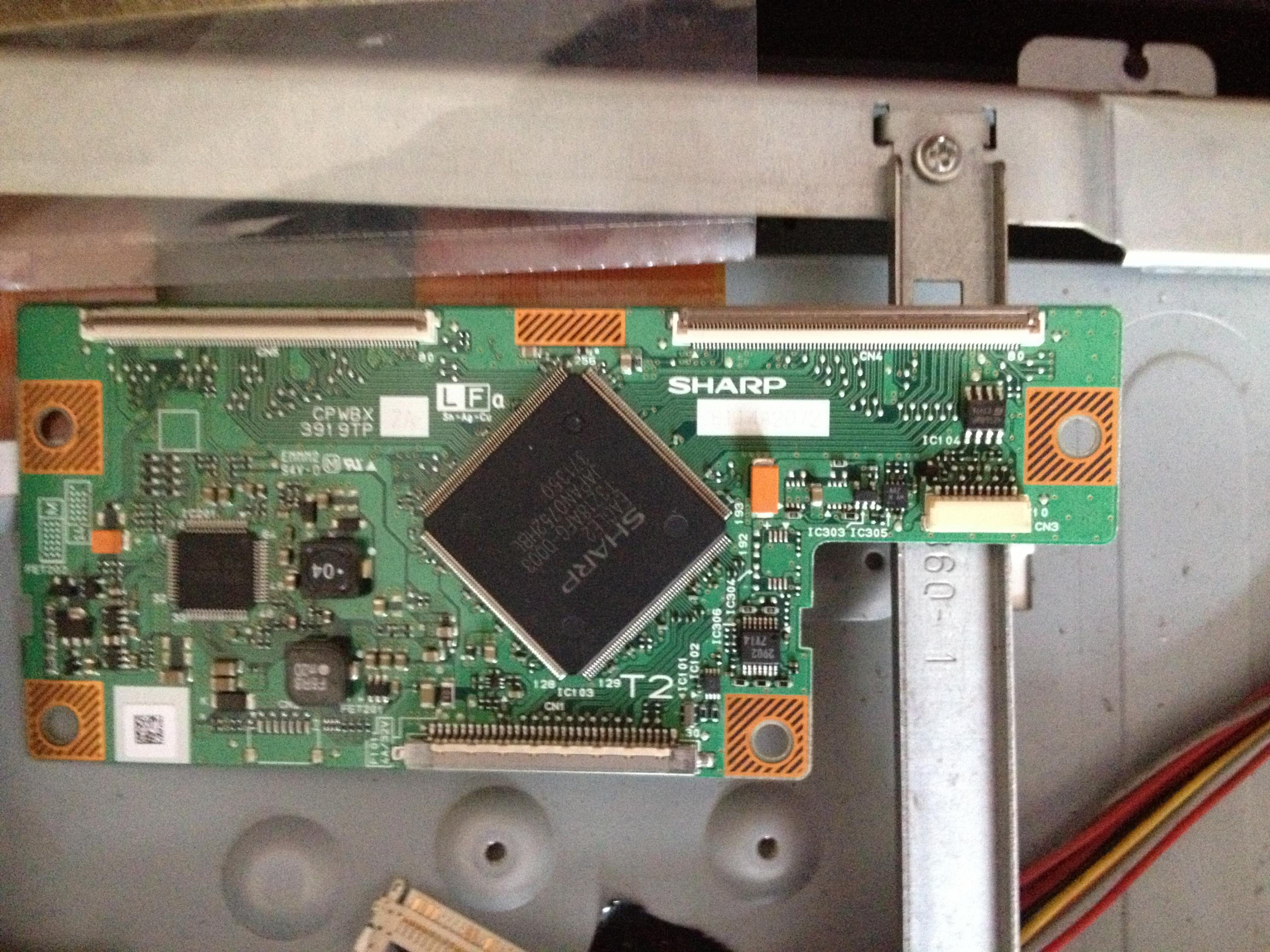

    i got the tcon board on my desk in front of me now
    ive just ordered a new identical one off ebay
    http://s14.postimage.org/6oedtkwi9/tcon.jpg
    just for the hell of it are there any tests i can do on this board to find out what went wrong?
    thanks
    i checked the fuse and its fine ,zero ohm
    i was watching tv and the image slowly started to fade to black
    i can see the backlight and audiio is fine

    Other than measuring the values of resistors, checking diodes for shorts etc., no there is no way to diagnose. I have not seen any panel manufacturer even release schematics of a T-Con board. Even with schematics, you would need to be able to power up the board and supply LVDS data to it to be able to test any of the integrated circuits.

      Why did you think the tcon was the problem?
      Welcome to the forum-

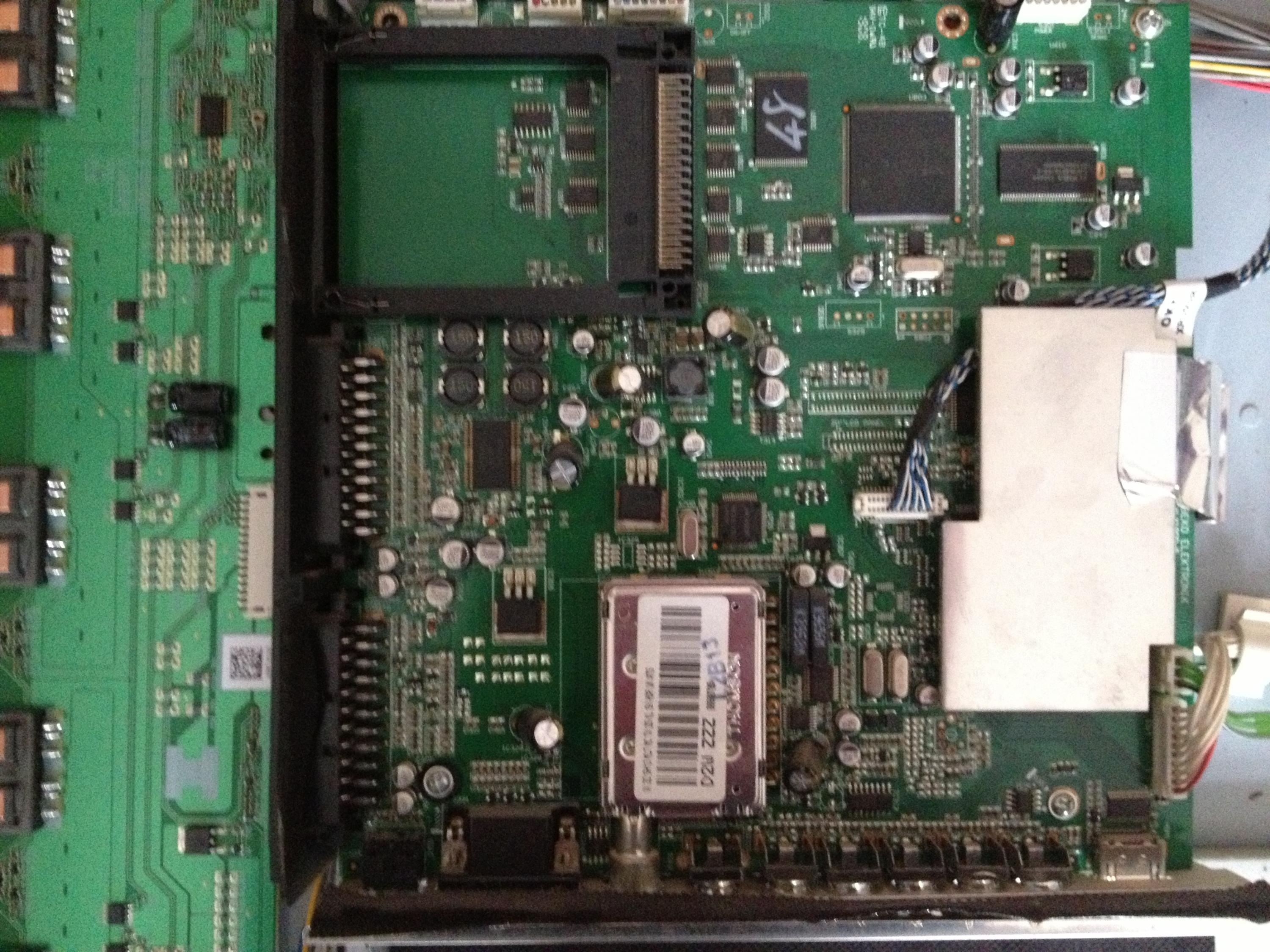

      We can help a lot more if you please post good clear pictures of the whole chassis, and then pictures of each board, front and back (in the same orientation) and close up of connectors, (max resolution 2000x2000 and 2MB) using the manage attachments button, which is found by clicking "go advanced" under quick reply.
      Examples of what is needed
      https://www.badcaps.net/forum/attach...7&d=1280167246
      https://www.badcaps.net/forum/attach...6&d=1280167246
      https://www.badcaps.net/forum/attach...4&d=1280167246
      It will be useful if you can say a bit about yourself - skills tools etc.

        i assumed it was the tcon from what i have read from other forums
        im uploading photos now
        so it could easily be something else?
        i have some tools no scope an hnc in electronics

          Did you check the voltage to the tcon? Could be bad cap on psu.
          Do NOT touch heatsinks when testing for voltages as they may be LIVE!

            As long as the voltages check out going to the TCON this could be a heat related problem and freeze/dust spray could find the faulty component(s) on that board (granted it is that board).

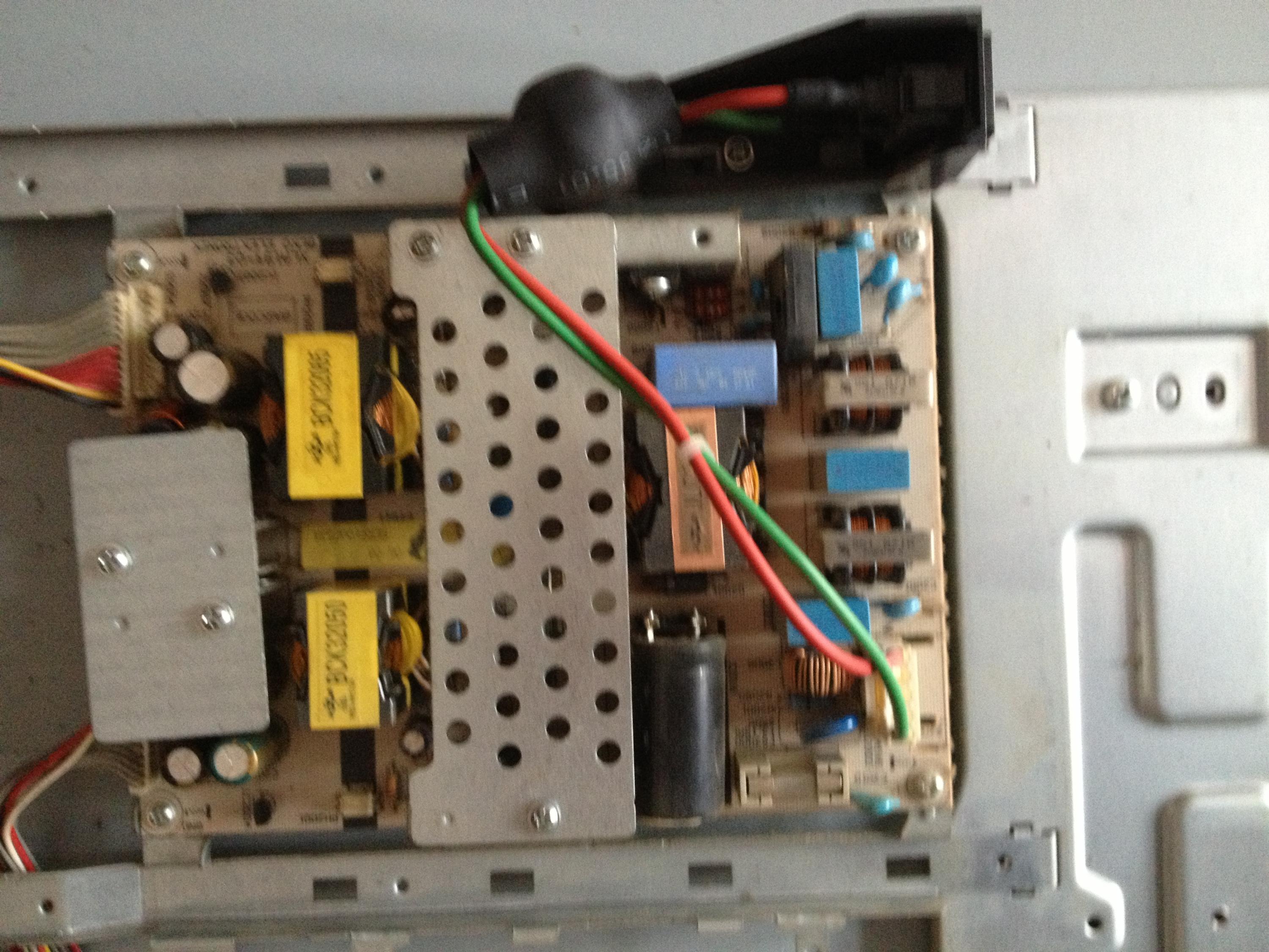

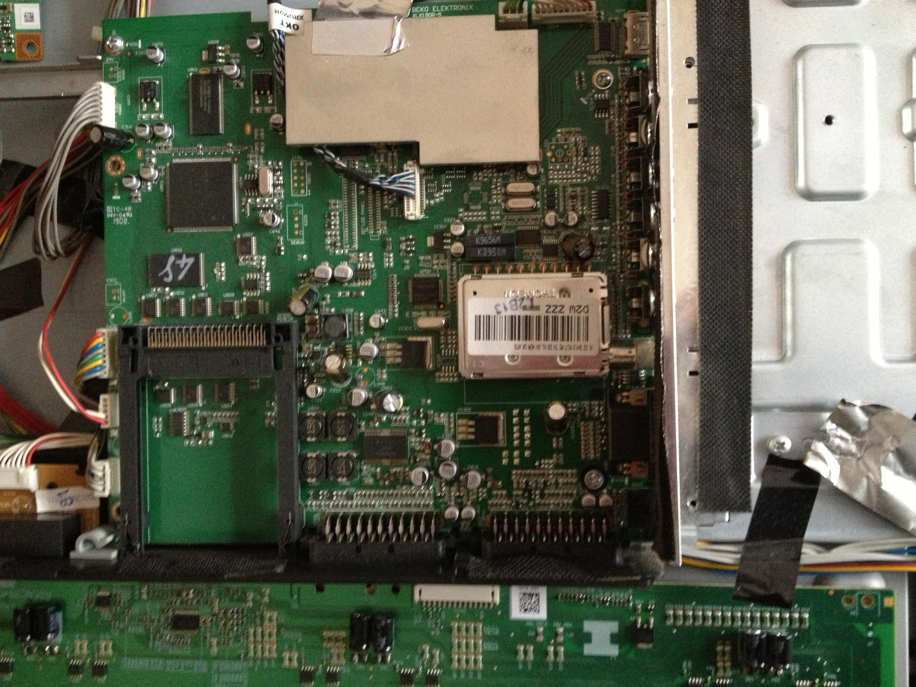

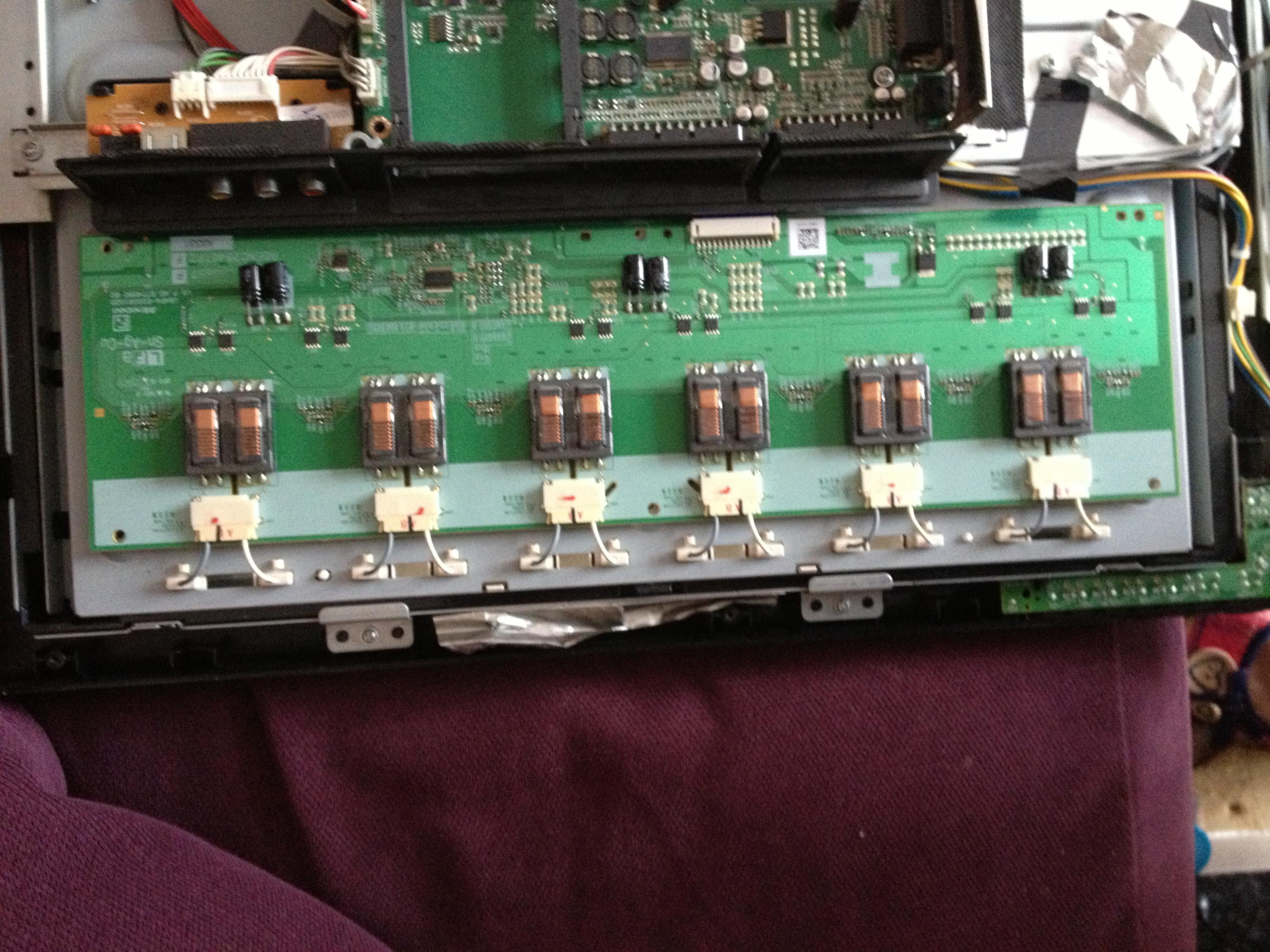

              here are some snaps
              so you think i was rash in ordering the tcon board?

                  Cant quite read is the fuse rated for 32v? Board voltage is usually 12 or 24.
                  set your meter on 200vDC

                    Pictures are too fuzzy for troubleshooting. Probably need to be better lit but without flash.

                      i took 2 measurements of just over 5v from either sides of the fuse and the metal chassis with the tv powered on

                        What is the part number on the Tcon board
                        • attenuator1222
                          • Jan 2013
                          • 12
                          • uk
                          Re: lcd picture faded to black
                          Originally posted by selldoor
                          what is the part number on the tcon board
                          cpwbx3919tp

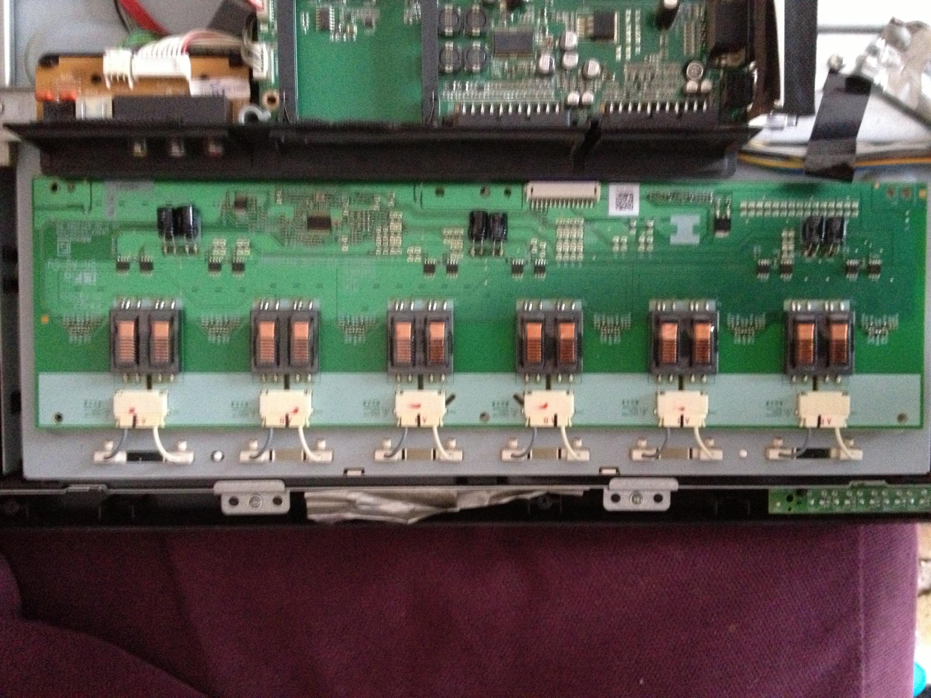

                                sounds like a bad inverter.

                                  its not the backlight is working

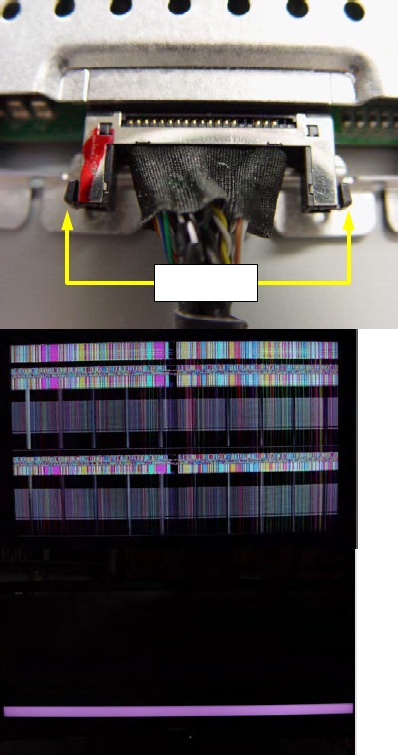

                                    "One trick to check most TCONS for functionality is to loosen the LVDS connector at the TCON (as shown InFigure 3) while the unit is turned on. Handle the LVDS connector with care and be certain to fully release the locktabs. Gently rock the cable in and out of the connector while observing the screen for any response. Dependingon the chassis, the symptoms of the screen may be gentle white flashes, intermittent colored lines, or a screenfull of random patterns. The idea at this point is to provoke some kind of response on the screen. TCON boardsthat have failed will not usually generate any type of response on the screen."
                                    Worth a try.
                                      Worth a try.
                                      hi should of mentioned i tried that as well no change
                                      ive already ordered the replacement now just my luck it wont be the tcon in which case i will skip tv

                                        my bad, read it wrong, I thought it read went completely black, gilly is right if no light reaction when tcon is rocked, then more than likely the tcon or tcon cable.
