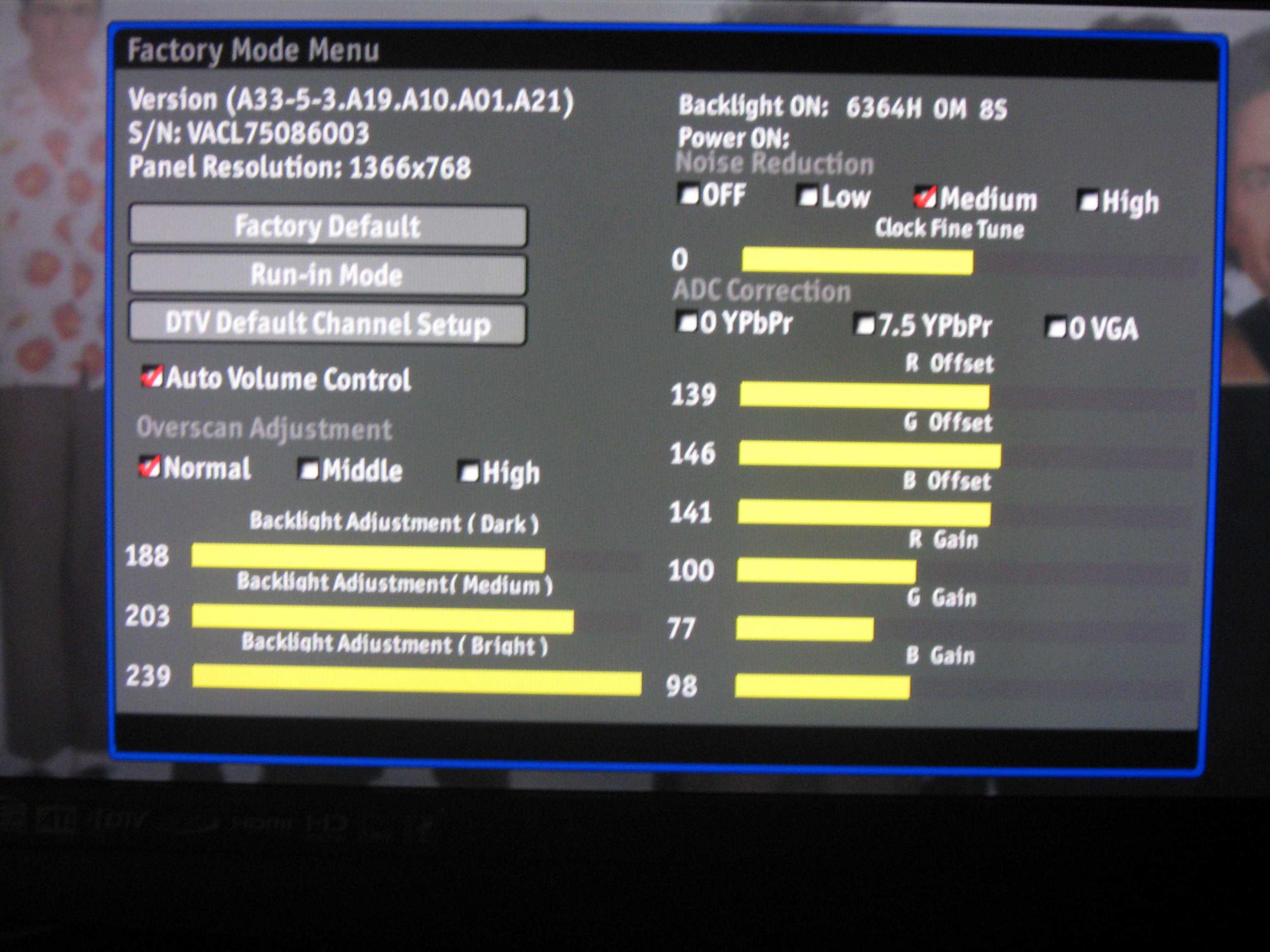

                                    Re: Factory Resets Listing
                                    Olevia 227_s11
                                    This probably won't help most people but just in case it helps someone.
                                    If you have a JP1 Remote control I found that EFC code 034 got me into the
                                    service menu of my olevia tv.
                                    I had no remote that worked for this tv and with the help of
                                    http://www.hifi-remote.com/forums I was able to find a code that partially
                                    worked for it.
                                    I then punched in all EFC's and found out what they did and efc 034 got me
                                    service menu (see pic)
                                    For those that do not know what a jp1 remote is they are the one's with
                                    the six pins in the battery compartment to plug in to computer and program it
                                    Hope this helps someone
