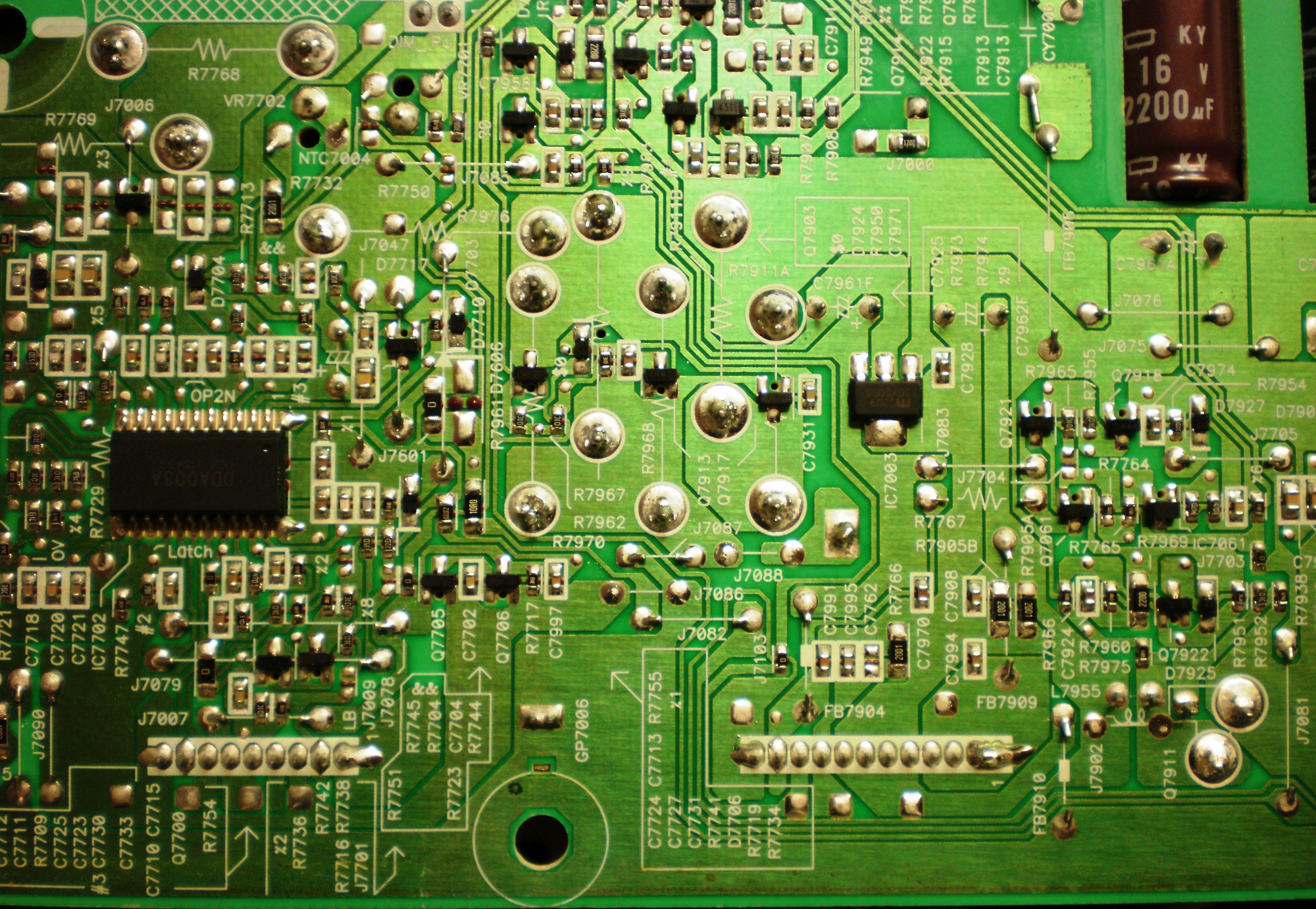

      OK, T-con is not receiving anything.
      Point
      #1= 5.555V
      #2= 13.04V
      #3= 13.04V
      #4= after like 10 sec. becomes 12.17V for a second and then drops toward 0V.
      #5= 0V(alternates between + and -)
      Here are the pictures:

        Hi tibimakai,can you remove all cable from power supply lave only 110v ,apply PS_ON manually and see V on main caps.Post results.
          Re: Sharp LC-40LE810UN question
          Nothing happens.

              Signal (PD-9)AC-det is output signal from Q7061 to detect it they use 3rd optocoupler PC7703

                  OK, to bring back the attention I'm posting the measurements that I have at the PS connector.
                  So it takes a couple of seconds to turn on, as Olegi said like 10 sec.
                  When the TV is turned on, I have the right voltages(not sure about the PWR_POW at pin#12).
                  #1-2= 13.02V
                  #3-4= 13.02V
                  #5-6= 0V(GND)
                  #7-8= 0V(GND)
                  #9= 3.13V(AC_DET)
                  #10= 3.03V(PS_ON)
                  #11= 5.02V(STBY)
                  #12= 0.12V(PWR_POW)
                  When the blinking code comes up, the only voltage is left is the standby.
                  I know that the 400V is missing and that is most likely the problem of this TV.
                  I guess we have to look at the DAC002, am I right?
                  When the TV comes on the 168V drops to 155V and then back up to 168V when tghe code kicks in.

                    You said that you have bought 2nd power supply .Do you have same reading on this connector ?When you have on pin #10= 3.03V(PS_ON) there has to be ~400V on main caps.Can you tell what is the voltage on C7961A ;C7962A for first 10 sec til you get error code?

                          The voltages are 13.04V and 6.38V.
                          Thanks for the schematics, I will have to look at them.

                                  DDA002C is not getting Vcc. I don't know how much it should be this voltage.

                                        The NCP1608 IC(8 pin) "makes" the 400V?
                                        To me it seems that the 400V is not turning on. Everything turns on, then when the code kicks in they are all gone.
