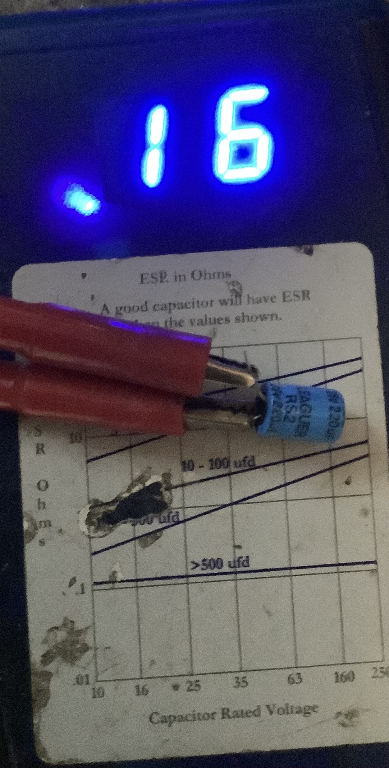

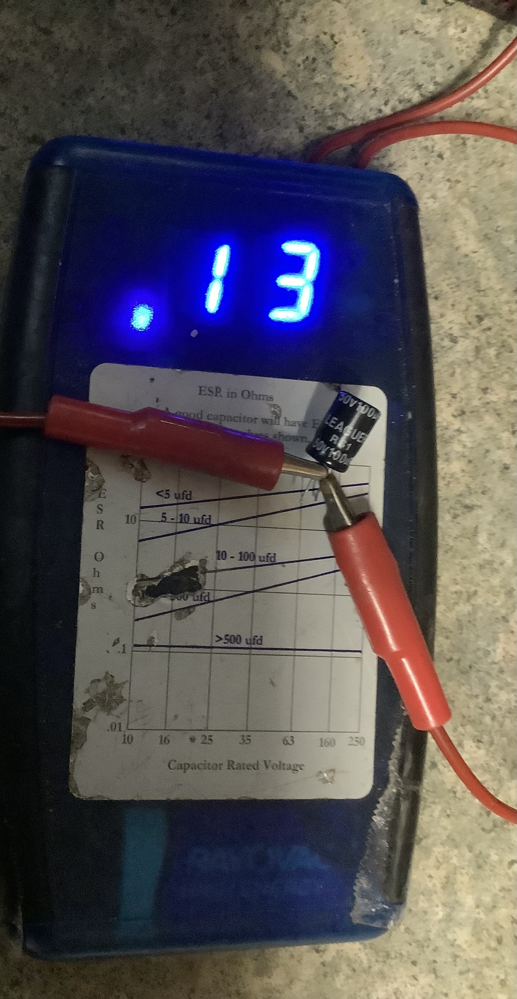

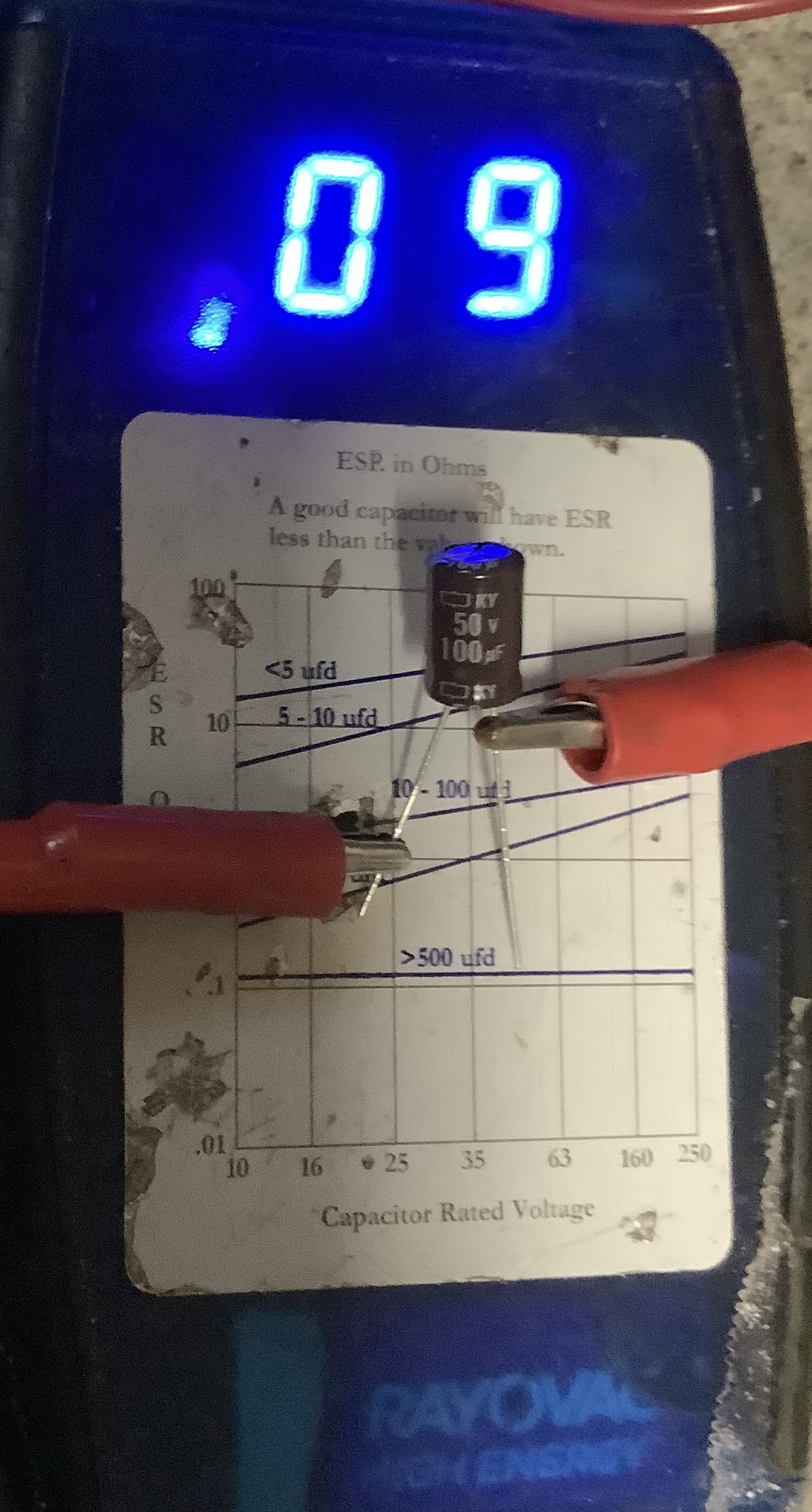

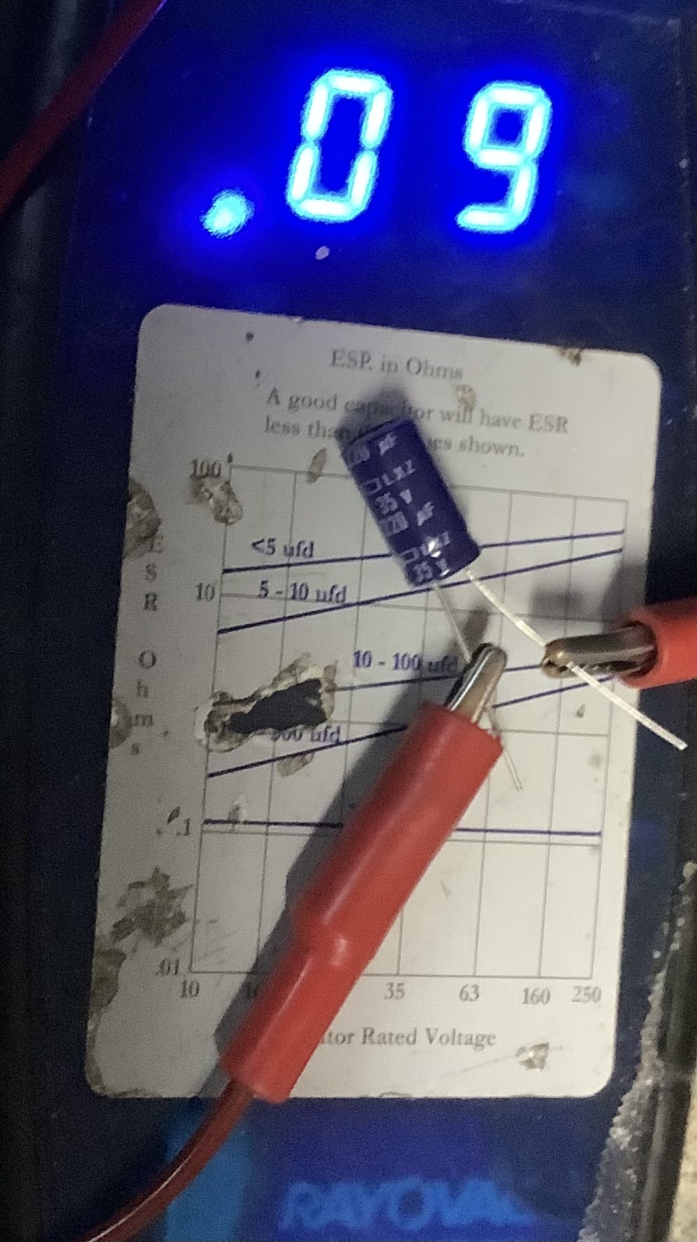

    This happened last Saturday and today I finally had time this morning before I went to work to replace two non brand capacitors
    I will let you be the judge weather or not these are bad or not according to the blue ESR meter that I am using
    I am comparing them to a brand new one that I installed
    The display came back on and the programming was not lost which I was surprised by I would have thought that when the display went blank that so did the memory as well
    I going to let it run for several days before I remount back on the wall next to the side door going into the garage and before I remount I take some pictures of the display controller
    One note before I replaced both capacitors I re-hook the controller board back after about 5 minutes the back light came on only one line came back on and I do not remember exactly what it said but this was not normal so I did not leave it connected I just replaced them when researching about another issue I was having when I first started using this garage door opener I saw some reviews about this particular issue with display either no display but back light or no display and no back light and I had the no backlight and no display and the suggesting were to replace the two capacitors or get a new display controller but apparently thy keep using these off brand capacitors and don't give a shit
    one capacitor is 220uf @ 35 volts 0.16 new one is 0.09 ( this I have my doubts to weather not this good or not )
    second one is 100uf @ 50 volts 0.13 new one is 0.09 ( this one might be alright )
    I am wondering if I should just go ahead and recap the main controller board as well or wait until something else does not work correctly again

    The old caps look OK, I don't see a problem with them besides the unknown brand. Low ESR is only important in a SMPS I think. I will sometimes check leakage current as well.
    What model Liftmaster, is this display on the two-wire bus they use? I ask because the opener supplies power to both the obstacle sensors and this display and if there is a short with the sensors or the wall display, it might cause a no or low power situation. You can measure DCV on the two-wire or try disconnecting the obstacle sensors to see if they are loading down things.
    Otherwise I would look inside the opener and see how the capacitors look. I recapped a garage door opener, they are powered 24/7 and see hot weather during summer and after 10-15 years it's time.
