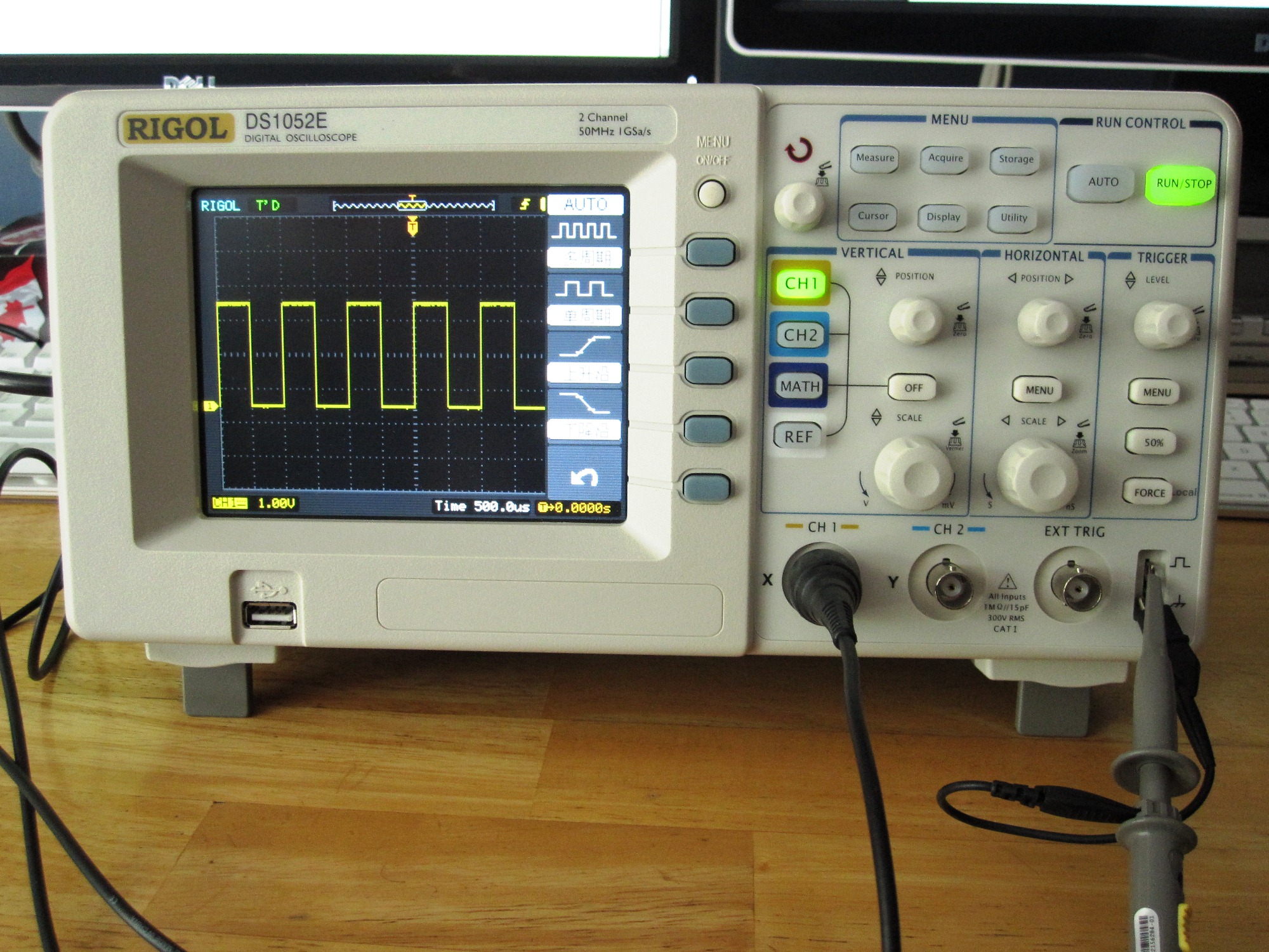

                                        Re: Sharp LC-40LE810UN question
                                        Here is a picture with the Rigol that I have(picture is from the web). I have upgraded it to 100Mhz. It doesn't mean anything if I can't use it
                                          I have a Rigol DS1102E, the 100MHz version, which costs only a little bit more than the 50MHz.
                                          Why did you buy a scope if you don't know how to use one? It's only good if you know what you are looking for...
