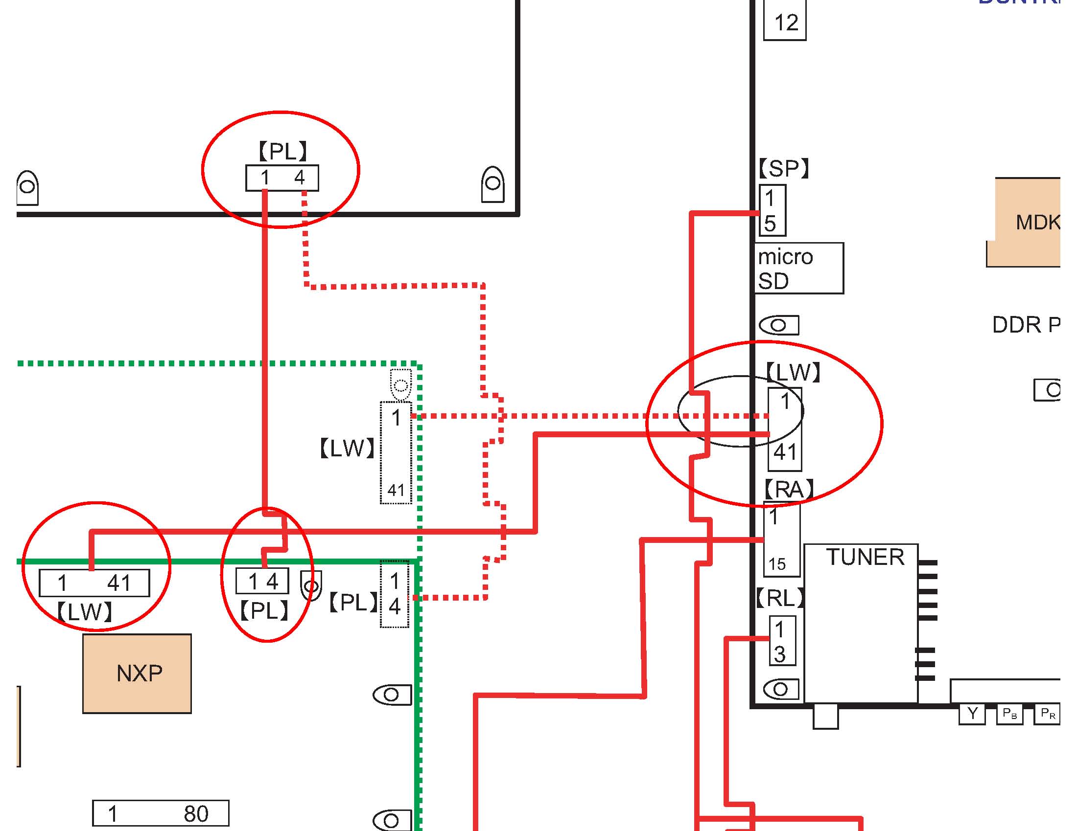

              #206
              Re: Sharp LC-40LE810UN question
              Ok, so it looks like it is not getting 12v feedback from the T-CON to tell the processor that it is not receiving the 12V. So I would suggest to look at the PL connector P4804 4-PIN to see what voltage he has on those 4pins. I can see that the power applied to this connector is supplied to the switching supplies on this T-CON board.

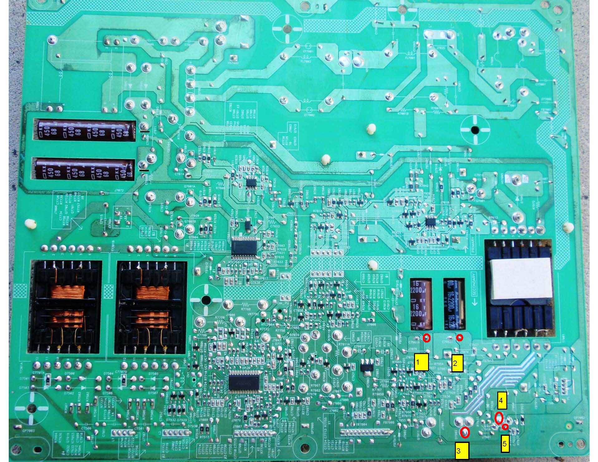

                #207
                So 2-slow, 5fast = PL 12V ERROR CODE.
                OK, please tell me the voltage readings at those red circles, black probe to the chassis. We need to find out if we are getting 12v at the PL connector or not. I also need good pictures of that section.

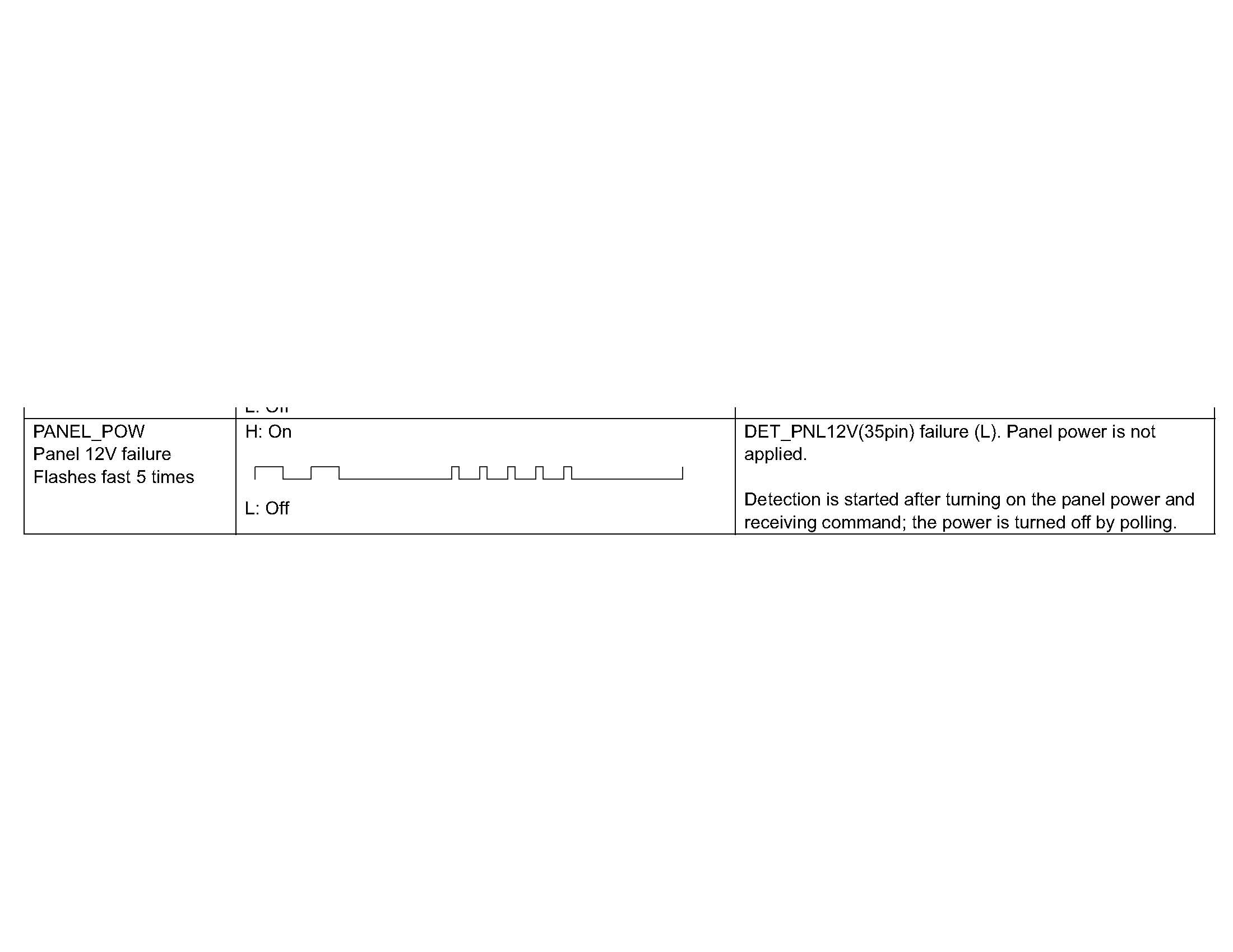

                  #208
                  There is not 12v because ( Panel power is not applied)
                  Detection is started after turning on the panel power and
                  receiving command; the power is turned off by polling
                  First needed working power 168v=OFF ~395v =ON on main caps,and working LEDs power supply.

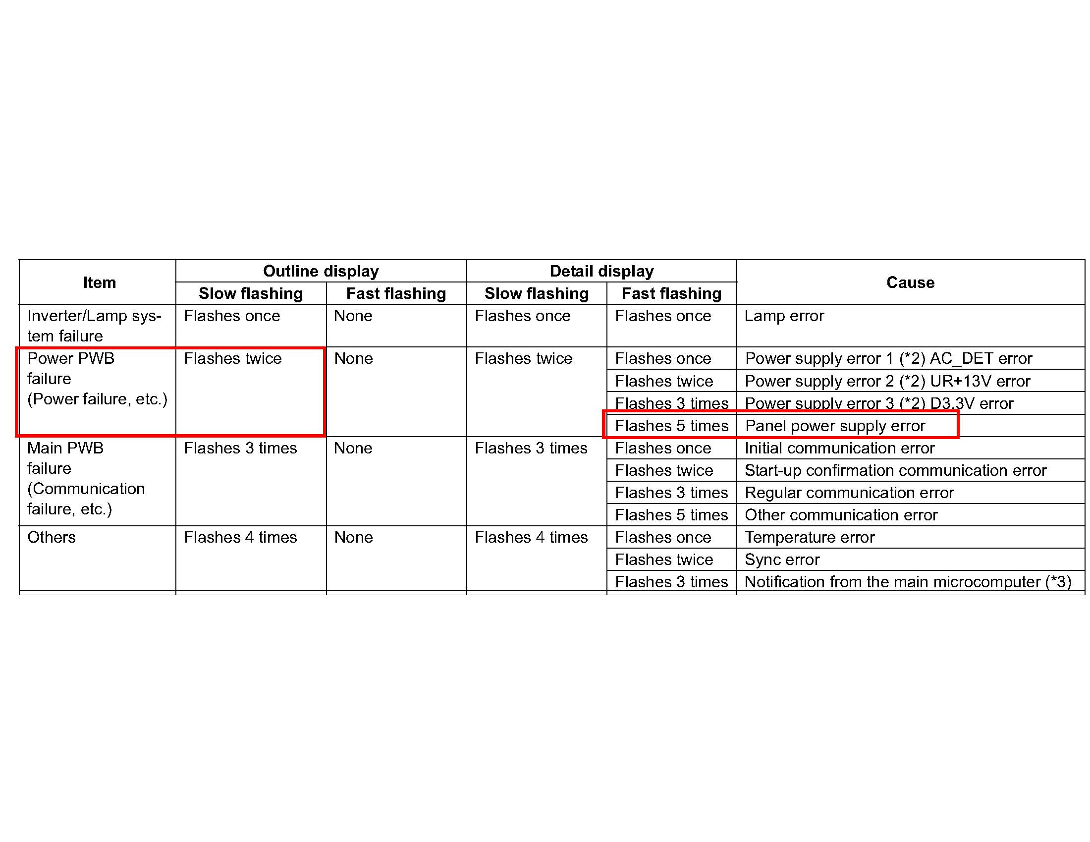

                    #209
                    Originally posted by olegi
                    I don't know from where Post 197 take assumption ,please check post 164.I attached service manual for SHARP 40 to 60 " Please check page 6-16
                    Where did I get that? Right on the page you referenced.
                    Section 2 on that page says one slow flash and one fast flash is a lamp (backlight) error.
                    Fourth item down in sections 3 says that 2 slow blinks and 5 fast blinks is 12V panel power. (12V panel power is the t-con and LCD power, nothing to do with the backlight)
                      #210
                      As I stated in 204, I do not believe he is getting the PS_ON signal from the main board to turn on the PFC and the backlights and the PL on 12V transistor Q7908??? at the bottom right of the board close to the PL connector. He may have to apply PS_ON signal manually.
                      Aloha, please see post 206, which is what the error code he had indicated.

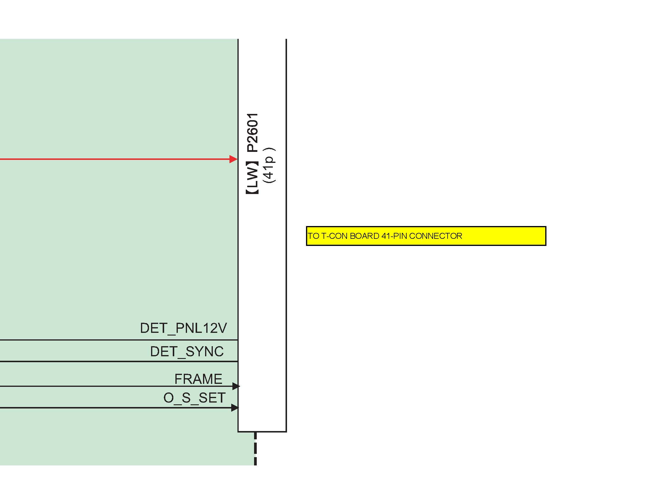

                              #214
                              PD pin 5-6 are labeled as SOUND. Where is this pin #6? Pin 10 is PS_ON.
                              Are you talking about pin6 of LB connector?
                              OK, the LAMP ERROR signal, he will just have to use pull-down or pull-up, not clear in the manual (HI FAILURE? on page 6-16) resistor to fool it.

                                #215
                                Yes it is pin 6 of LB connector ,To fool it ,he has to check what he has now .To put power ON he has to pull-up pin10 PS_ON to 5V

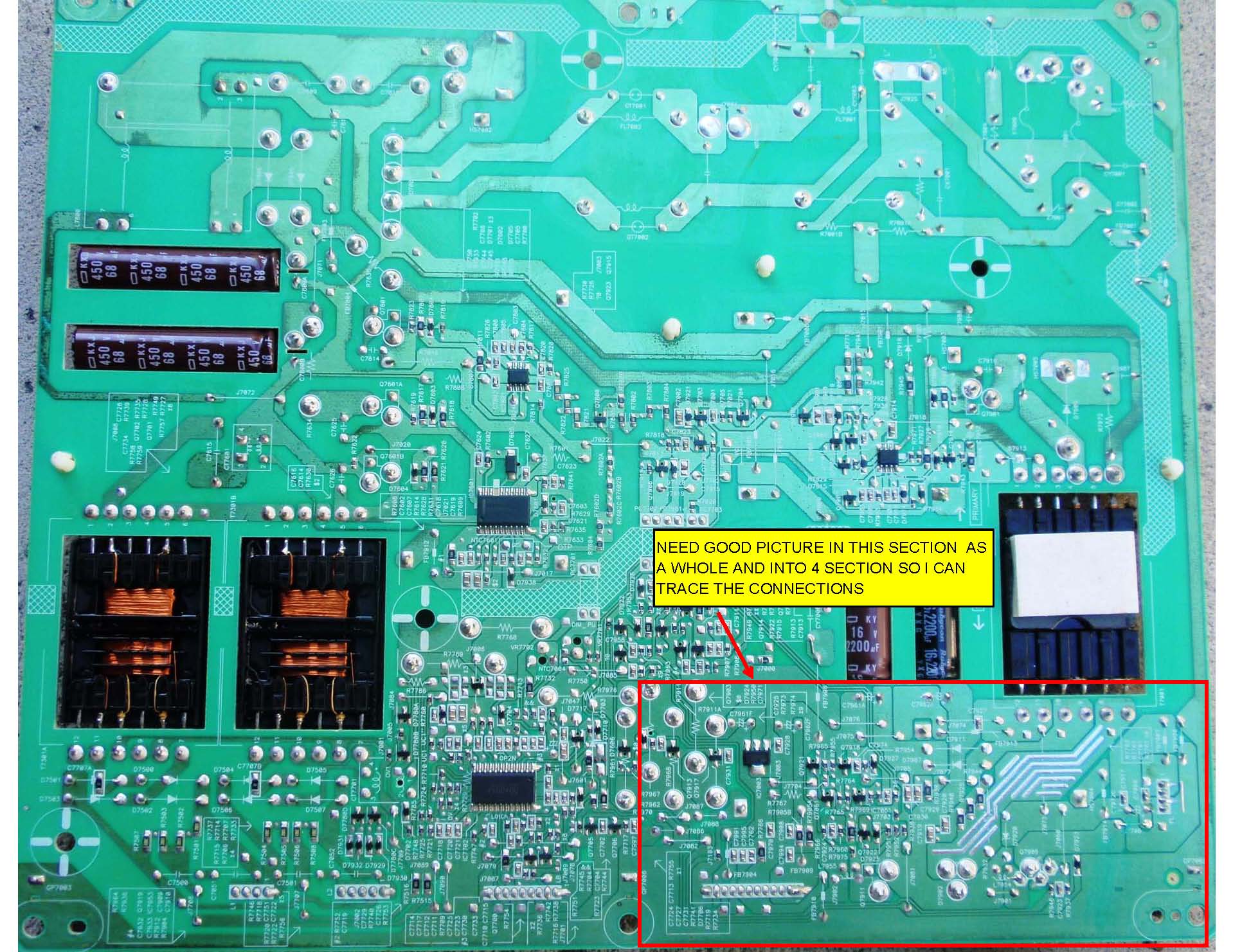

                                  #216
                                  The bad thing is that, it is called service manual, but it does not have any circuit diagrams in it at all.
