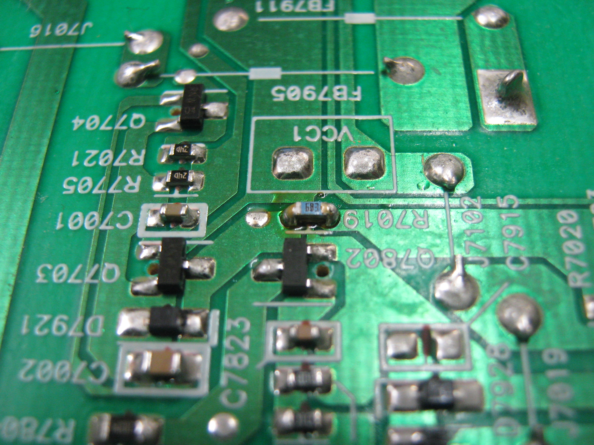

                                  I have also got an AC-Det error (2 slow and 1 fast blinks)
                                  No VCC voltage to PFC IC or Backlight IC.
                                  What exactly did you find?

                                    Originally posted by sda View Post
                                    I have also got a AC-Det error (2 slow and 1 fast blinks)
                                    No VCC voltage on PFC IC and Backlight IC.
                                    PC7703 opto chip was found faulty.
                                    Replaced with a PC817 which was an hand, and all is well.
                                    Cheers
                                      Re: Sharp LC-40LE810UN question
                                      Sorry I missed your post. There is an 82K resistor in series with the LED side, R2019. I soldered a 68K resistor on top of the existing resistor.
                                      I don't blame the optocoupler. The 82K resistor doesn't pass enough current through the LED.
                                        Here is a snap I took, showing R2019's location.
