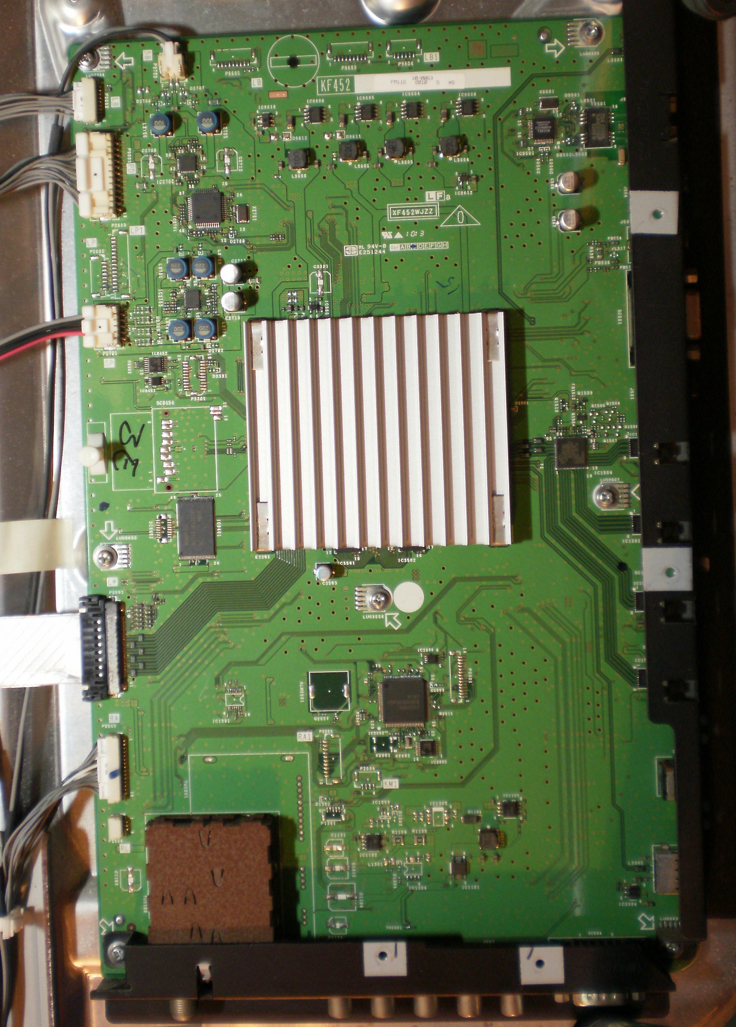

      Do you guys think that I should still check the 18V at the start up, since I have the output voltages?
        #123
        Re: Sharp LC-40LE810UN question
        PSU is fine, for now. Check main board. Maybe TV was hit with a surge.

          #124
          What should I check on the mainboard?
            #125
            Post some pictures of it.

                    #129
                    I have made some pictures, not the greatest ones, specially the bottom one:

                      #130
                      We can't move to the mainboard.
                      I have/had the voltages, but the 13V did not reach the connector.
                      At the connector I had only the 5.5V.
                      After a couple of minutes of measuring, the voltages are gone again.
                      I have tried it again after a while and it was back again for a couple of seconds and then drops to 0.7-0.8V.
                      I'm so pissed on this power supply, that I'm thinking of just buying another board and be over with.
                      I can have a short or something in the secondary and the feedback kills the power source?
                        #131
                        Why is the tuner can rusted? Has this TV been exposed to water?

                          #132
                          I have no idea.
                          I have just purchased the power supply.

                                    #137
                                    I have just noticed that actually the LEDs are on an blinking while I have the voltages. I haven't notice them before, since they were up side down.
                                    The code that flashes is 2 slow and 5 fast blinks which in the manual says that it's:
                                    -Power PWB failure (Power failure, etc.); Panel power supply error.
                                    -PANEL_POW; Panel 12V failure; Flashes fast 5 times; DET_PNL12V(35pin) failure (L). Panel power is not applied.
                                    Detection is started after turning on the panel power and receiving command; the power is turned off by polling.
                                    It would be nice if we could fix this board also. I would have a good board.

                                        #139
                                        I will let you know. I'm using a WDTV Live streaming player now. It's hard to believe that it could be better then that.

                                          #140
                                          Power supply/Inverter board arrived. I have installed it and it's exactly as with the original board. Still blinking a code. Board ordered from partstore.com.
                                          So, it looks like it's the mainboard is the problem. Not receiving any voltages other then the STBY voltage.
