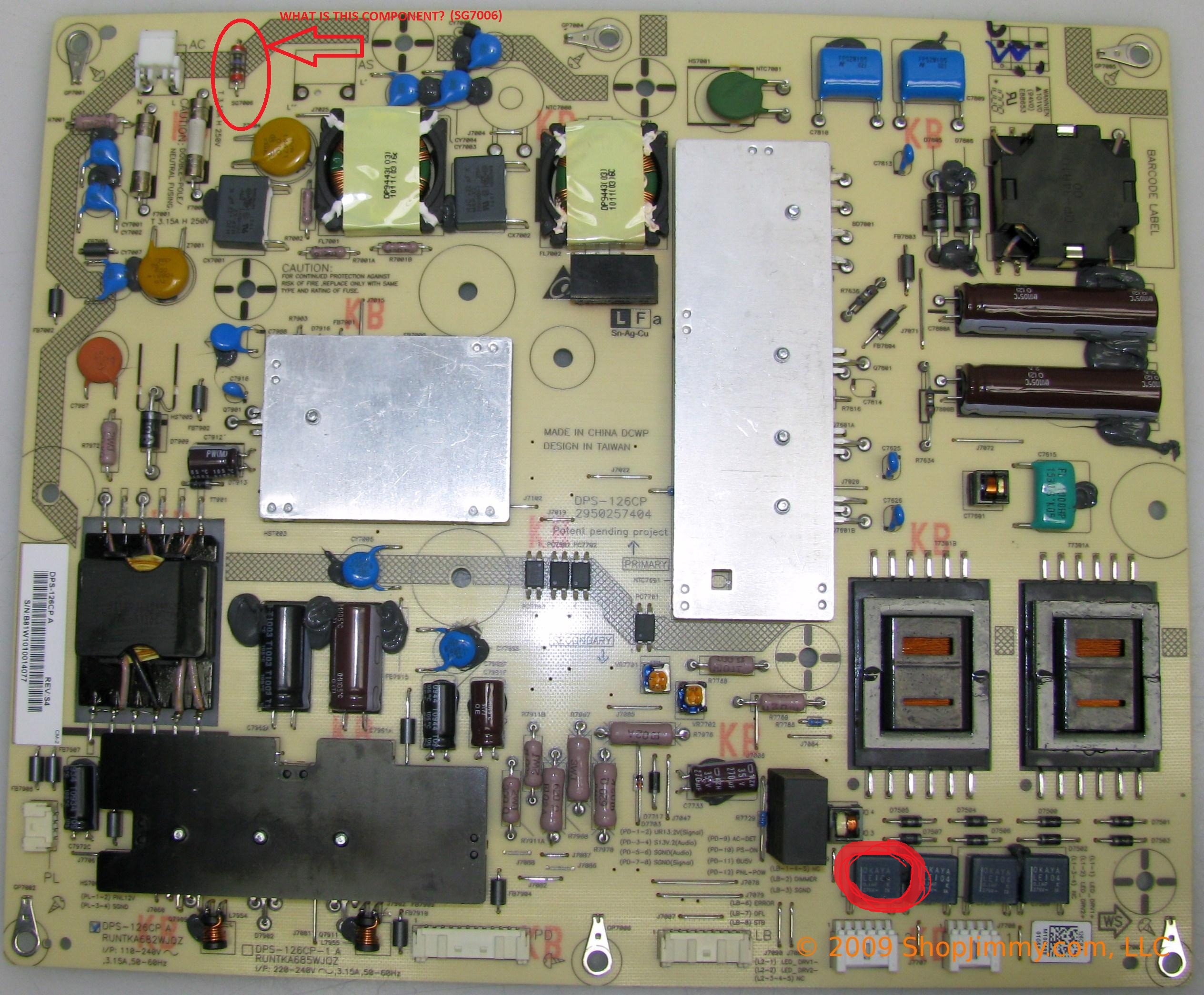

                  Re: Sharp LC-40LE810UN question
                  We went over that - it's a surge protection device, not a problem or the fuse would blow.
                  Interesting if an LED in the backlight is dead. Should be easy enough to replace it or disable it (barely noticeable) - but it seems to be a common fault, seen a few sets like that here with dodgy backlight connections or open LEDs.
                    Just want to get my hands on one .
                    I use the same picture from post 1 and i was refering for second circle bottom .You are right ,it is like open LEDs(backlight)

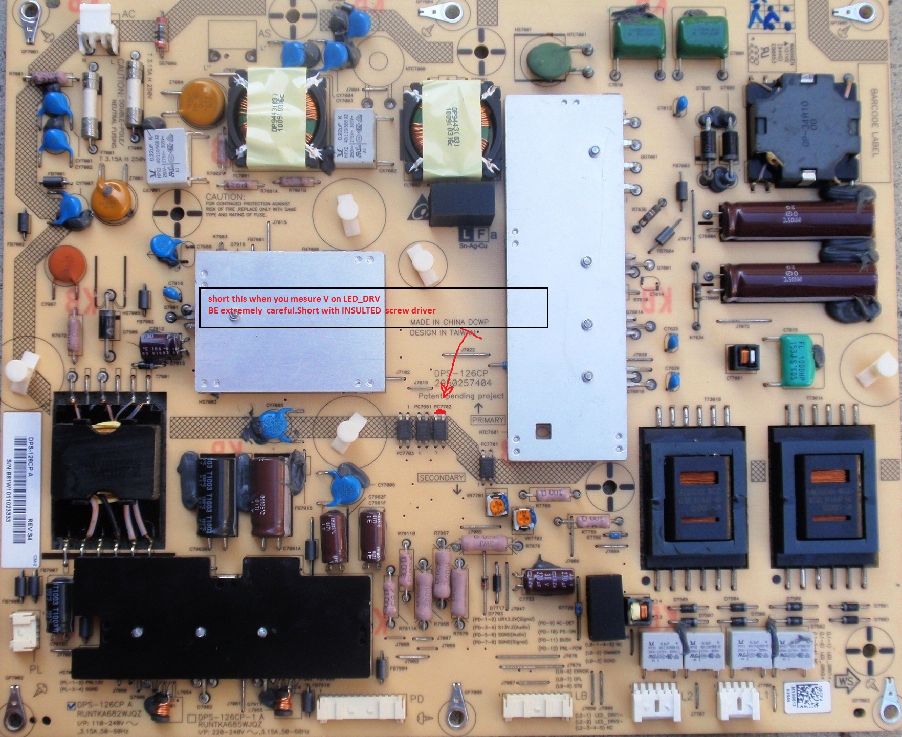

                        I have never repaired an LED TV which required work on the backlight. How do I know which one is bad?
                        • olegi
                          • Jun 2012
                          • 63
                          #172
                          This power should have 2 pair of LEDs divided in 2 section total 4 wires .Can you check with voltmeter what you have on connector LED_DRV1+ and - as well LED_DRV2 + and -.You have to attach voltmeter before you power the tv,then power up and see what is the reading from each pin. Post results.
                          • tibimakai
                            • Jan 2012
                            • 3680
                            #173
                            Thank you for helping me.
                            It's to late now, I will measure it tomorrow.

                                  I have measured the LED voltage, early before I left to work and measured from the secondary ground and I'm getting on all the pins 0.0019V.
                                  From primary ground I'm getting 28.6-28.8V.
                                  But I think that I have to measure from the secondary.
                                  I have tried even without the LEDs and I'm getting the same voltage.
                                  When I will be home, I will try with the replacement board, to see if I'm getting the same voltage.
                                  I guess these voltages should be DC voltages, since the LEDs are diodes.
                                  • olegi
                                    • Jun 2012
                                    • 63
                                    #177
                                    Ok. All cables has to be attached (specially those for LEDs led_drv1 and led_drv2) Power up tv,wait ~ 10 sec. Voltmeter has to be attached (neg to ground) ,with positive probe you have to check each pin on LED_DRV (1 an2 , +and -).DC voltage should be ~ +95v -95v depend of different factors .If you have ~0v,then you have to manually turn ON backlight inverter .By looking on yours particular board optocoupler PC 7702,turn backlight On.You have to short with INSULATED scrwdriver ,PRIMARY side of optocoupler as is shown on the picture (don`t short any of the other optocouplers,do not mesure primary side circuit HI VOLTAGE HIGN FREQ),then measure readings.Post result.
                                    • tibimakai
                                      • Jan 2012
                                      • 3680
                                      #178
                                      I have measured the voltages and there is not much change. On the upper connector I had +0.009V on both pins and on the bottom connector I had -0.009V on both connectors.
                                      I have tried the replacement board also, and it measured exactly the same.
                                      When I shorted the opto, the bulb on the short tester outlet lit up and since then I don't have any voltages and no LED light on the front of the TV.
                                      The only voltage that I have is the 170V on the main caps.
