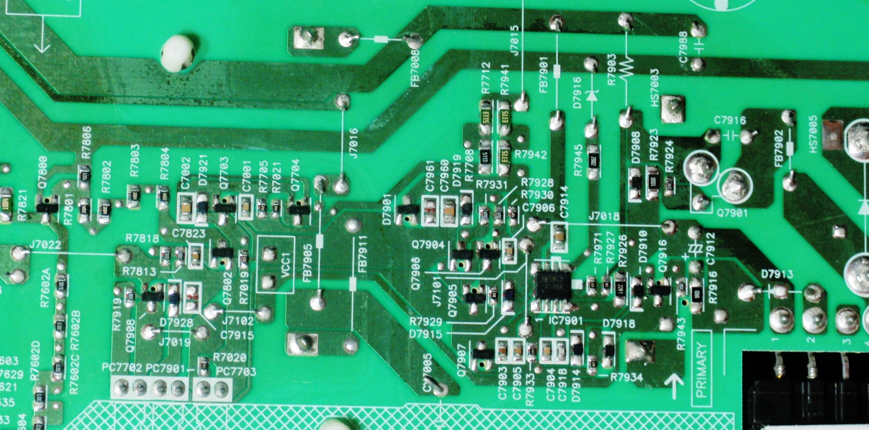

    That small capacitor value is 22uf/100V and I'm measuring E=0.63/25.7uf.
    On the connector of the meter it shows E=0.31.
    I don't have this capacitor with 100V value, only 50V.
      #62
      Re: Sharp LC-40LE810UN question
      Are you talking about the C7912 thay laying side way by the Standby transformer?
        #63
        Yes the C7912.
        D7913 it's OK.
        All the FU resistors(are they fusible resistors?) show a value.
          #64
          I do not expect the DC voltage on that cap to be any higher than 25VDC at the most, but it looks like it tested OK. The spec of the IC indicates that the VCC should rise up to 18V and then the IC will send the drive signal to drive the Gate of the MOSFET which then the DC will be generated by D7913. You should hook up the meter across that cap when the TV is unplugged, then plug in the TV and see if the voltage will rise up to 18V or not. by the way. what is the resistance reading between the VCC pin of the IC and Ground?

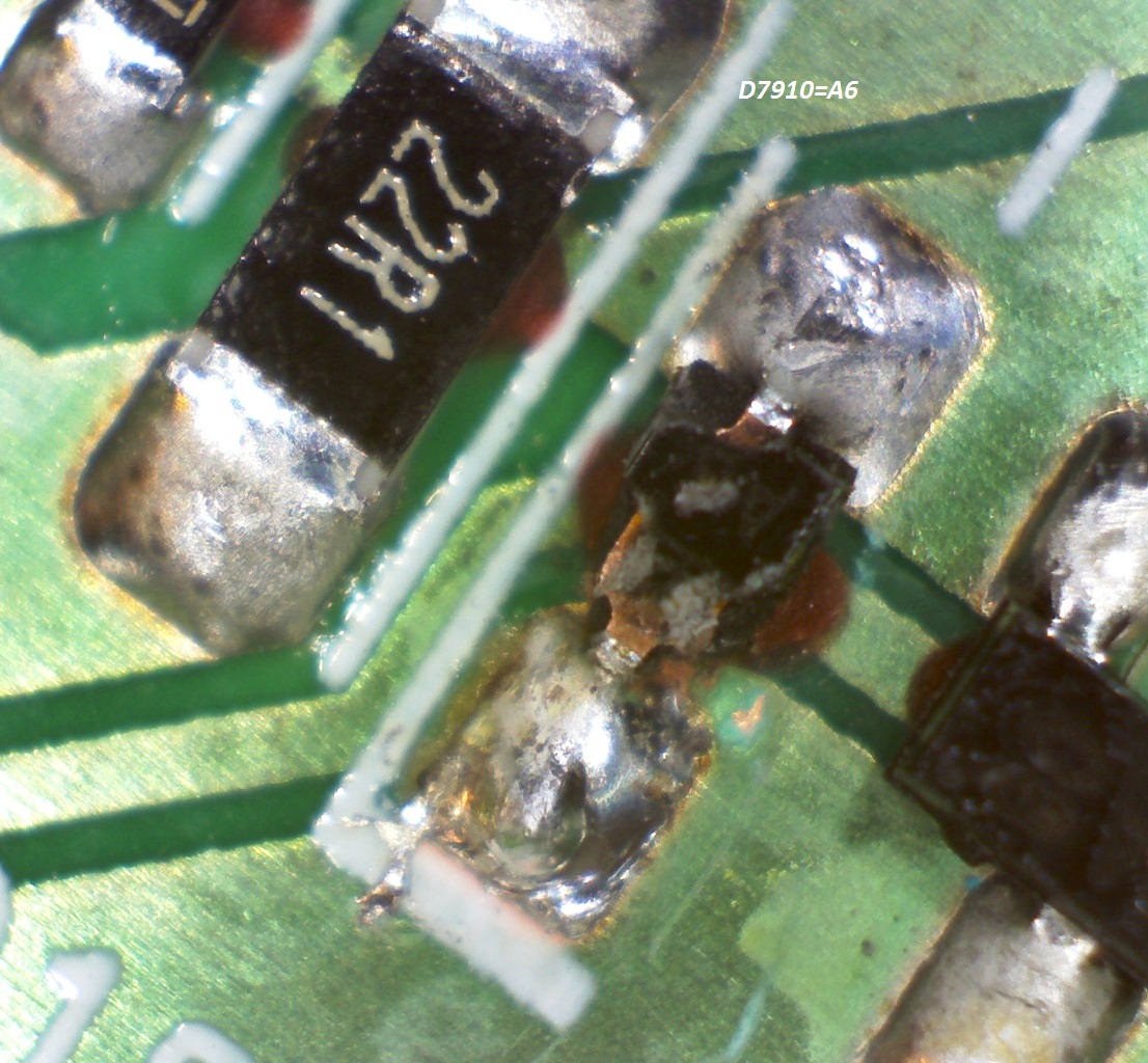

            I have lifted D7910 and I kind of messed it up, crushed the plastic. It still shows a value. I'm scared to lift it again to double check it.
            It checked out OK when it was lifted.
                That diode is now dead if it's sustained that damage... it will likely be something similar to 1N4148W.
                  #68
                  Yes you are right, it's BAS16 or BAW62 which is 1N4148.
                          "The positive leg of the start-up cap should be connected directly to the VCC pin of the SMPS IC" I just want to verify if my drawing is correct that C7912 is hooked up as I traced it.
                            #73
                            The pin#7 goes to R7929. It's on the right side of the IC.
                              #74
                              I see the trace goes under the IC body and then split? to the left and also to the right toward the start-up cap. Please look real close again.
                                #75
                                It's not going directly to the cap, it's going through that transistor on the right side.
                                I have applied the 18V to pin#7, but nothing happened. The 109.5 at pin#5 (now it's lower 106V) became 126V.

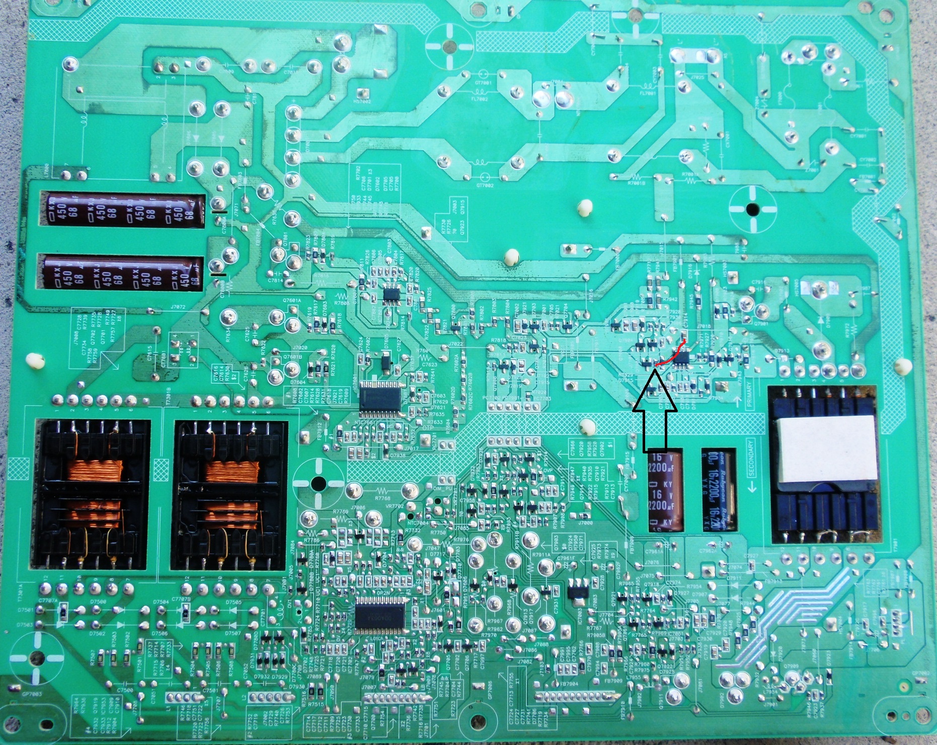

                                          #80
                                          Any voltage on those two 2200uf 16V caps on the secondary side.
