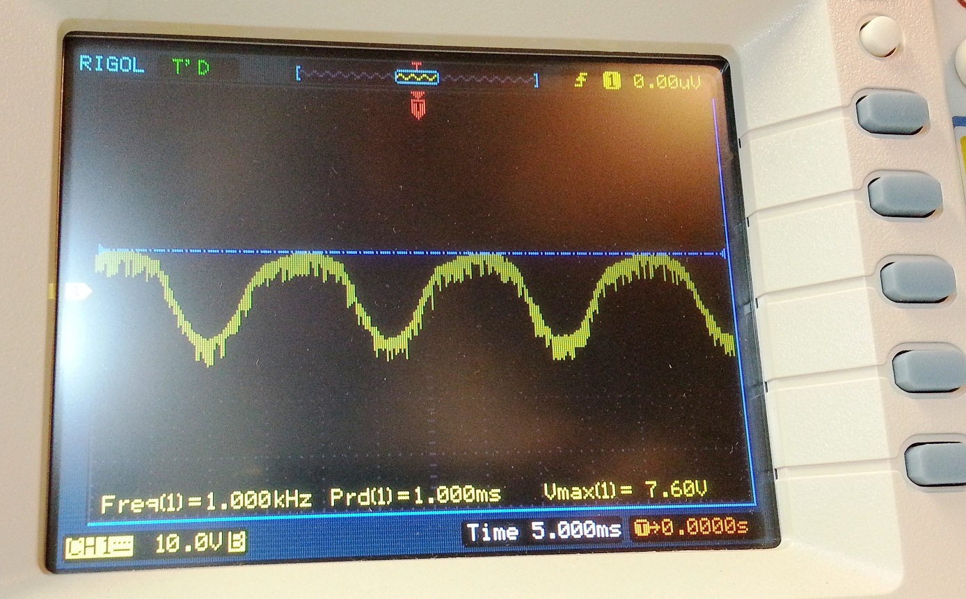

                  I'm measuring with the scope the output of the traf and I'm getting sinus waves.

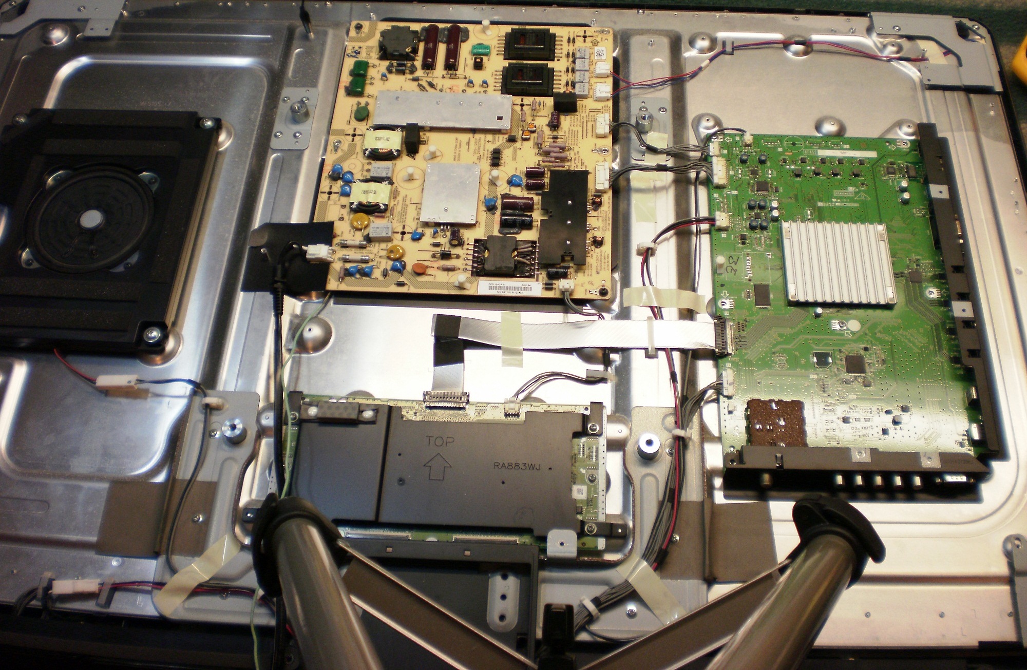

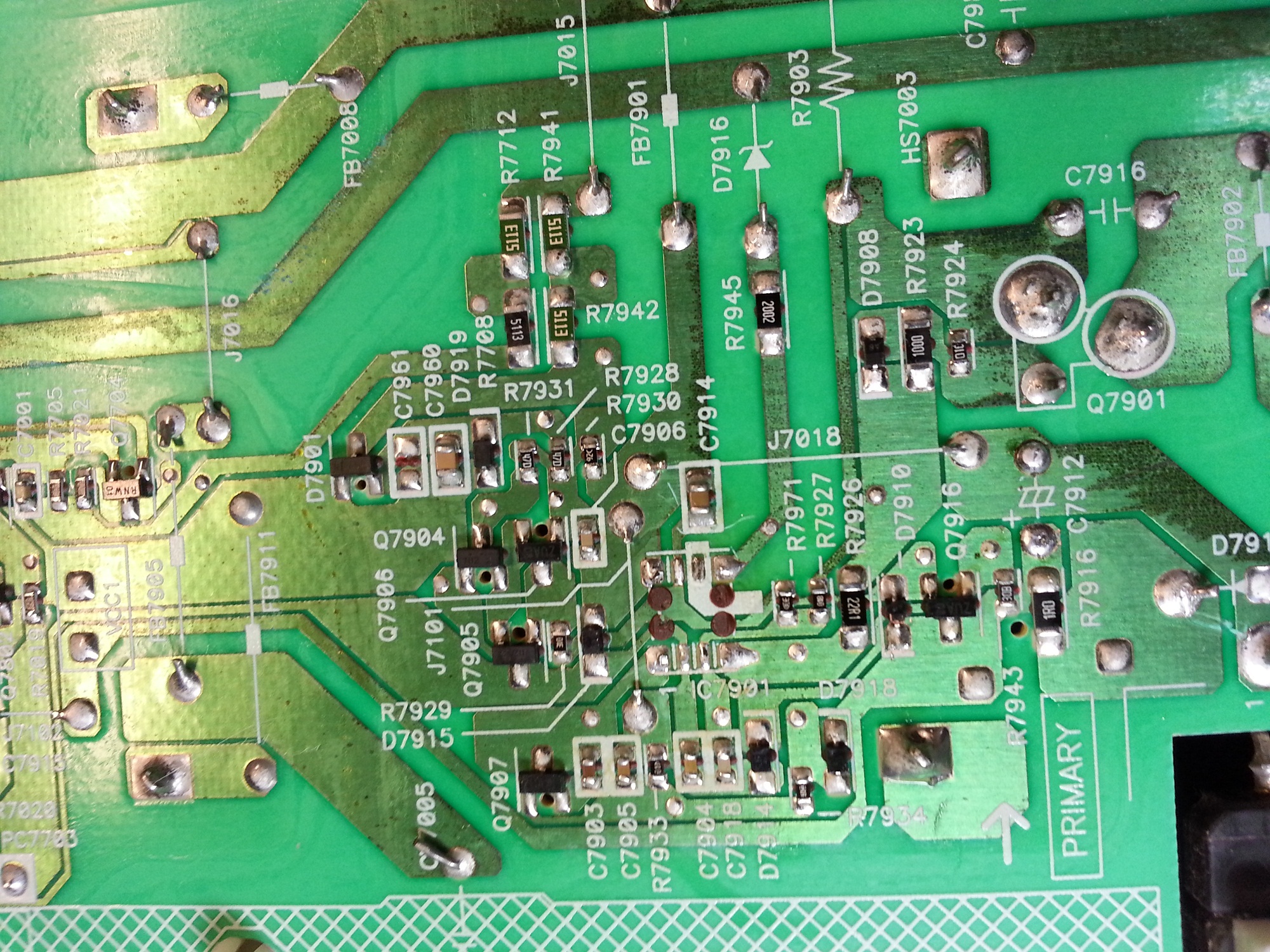

                    Re: Sharp LC-40LE810UN question
                    I ended up replacing the IC and now I have again the 13.7V(not 12V as I said before) and 5,5V, not sure what happened.
                    I'm attaching some pictures with the TV and the scope measurement.
                    One picture is without the IC, for budm to see the traces. I hope it's good enough, it's just a phone picture.
                        You have supply voltages now? Does ON/OFF do anything when you press the power button?
                          I have the 5V STBY and the 13.2V(13.7), but still nothing else happens. No LEDs turning on or anything.
                          I can't detect the PS_ON either.
                          I begin to suspect the mainboard too. I'm thinking of trying to feed 3.3V from my power supply, to see if anything happens.
                          The wave looks good(just to see if I have measured correctly)?
                          The voltage doesn't rise to 18V at the IC as it supposed to.

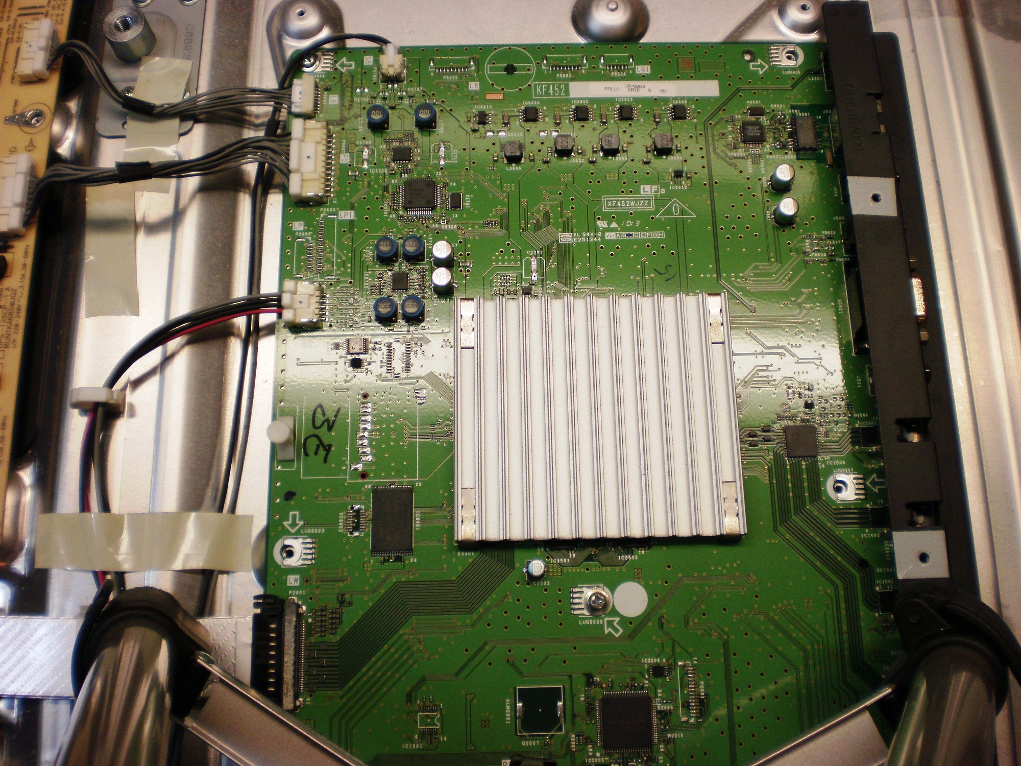

                            Well, as long as you have standby voltages, for now, the PSU is OK. Time to look at the main board. Maybe a surge killed both.
                              Next step I have to take pictures with the mainboard, right?
                                Yes.
