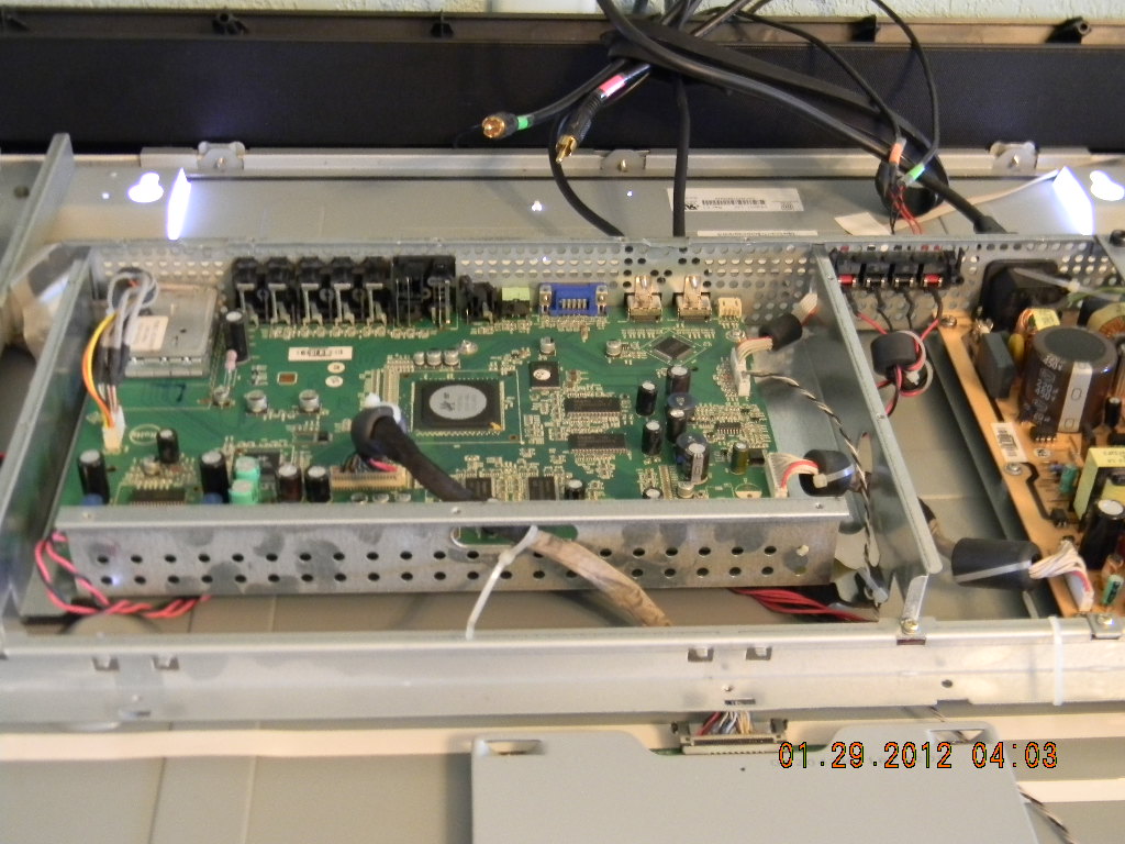

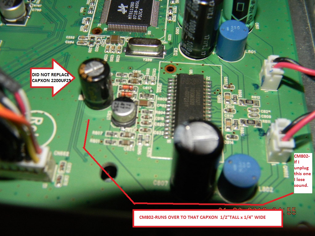

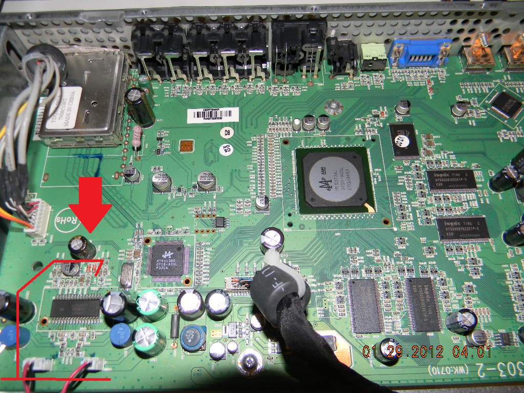

          Getting ready to remove the board to take pics, but have another issue that I wanted your input on. This may or may not be related to the t.v losing picture but you would know better than I.
          I ALWAYS noticed that the sound seemed louder on the RT of the soundbar. Anyway, when we hooked the sound bar up last nite I noticed that there was NO sound on the LEFT side. So, I followed it to the ONLY CapXon left on the board. In the meantime, I hooked up both sides of the sound bar to the CN801 side on the speaker connector and now the soundbar works on both sides. I am attaching pics so you can see what I am talking about. That cap is a CapXon220uf25. I don't have a cap of that size, would a 1000uF25v be acceptable or is that too much ?
          Even if this doesn't pertain to the "losing picture" problem I want to fix it while I've got it tore apart.
          Taking pics of the solder joints next. Thought I'd give you something to chew on till I get back.
            I can't see your pictures though I'll make a quick judgement.
            It depends on the amplifier, but it's quite likely that those handle the audio coupling... essentially they turn (e.g.) a 0V to 12V signal into a -6V to +6V signal (which a speaker wants, otherwise it will burn out.) If they fail open, they could cause a loss of sound. Fortunately, you can replace the capacitor with essentially any size; a bigger value will make it have more bass but that's likely going to be beyond the range of human hearing so you shouldn't hear a difference from the factory configuration.
            • retiredcaps
              • Apr 2010
              • 9271
              Too much. Get the proper value for the replacement. This will do
              http://search.digikey.com/scripts/Dk...ords=P12383-ND
              Hold off ordering because there may be more parts required.

                Okay, from the pics it looks like it's not the audio coupling cap, because there's only one, normally there would be one per channel. I'm guessing the 1000u ones were the ones you replaced. Could be something like the balance setting in the menu? It wouldn't be the first time a bad capacitor has corrupted user settings. (Very common with Samsung LCD TVs.)
                If the original cap was put in backwards it would have conducted a high current which might have damaged the speaker. This would not be immediately audible but can be tested using a multimeter. I do have some speakers from a Philips 32"; no idea if they would fit though.
                Have you tried running one speaker on the output of the other? The connectors are keyed so it may be difficult to do so.
                  Yes, I can hook up either side of the speaker sound bar to the Speaker Connector & get sound so it's not the speakers inside the sound bar. It's the left set side of where you hook up the speakers (top RT side of 1st pic) and I followed the trail to a CapXon cap. BTW, there are lots more CapXons there. That was the first board I fixed and only re-capped 2 from that board that were bloated.

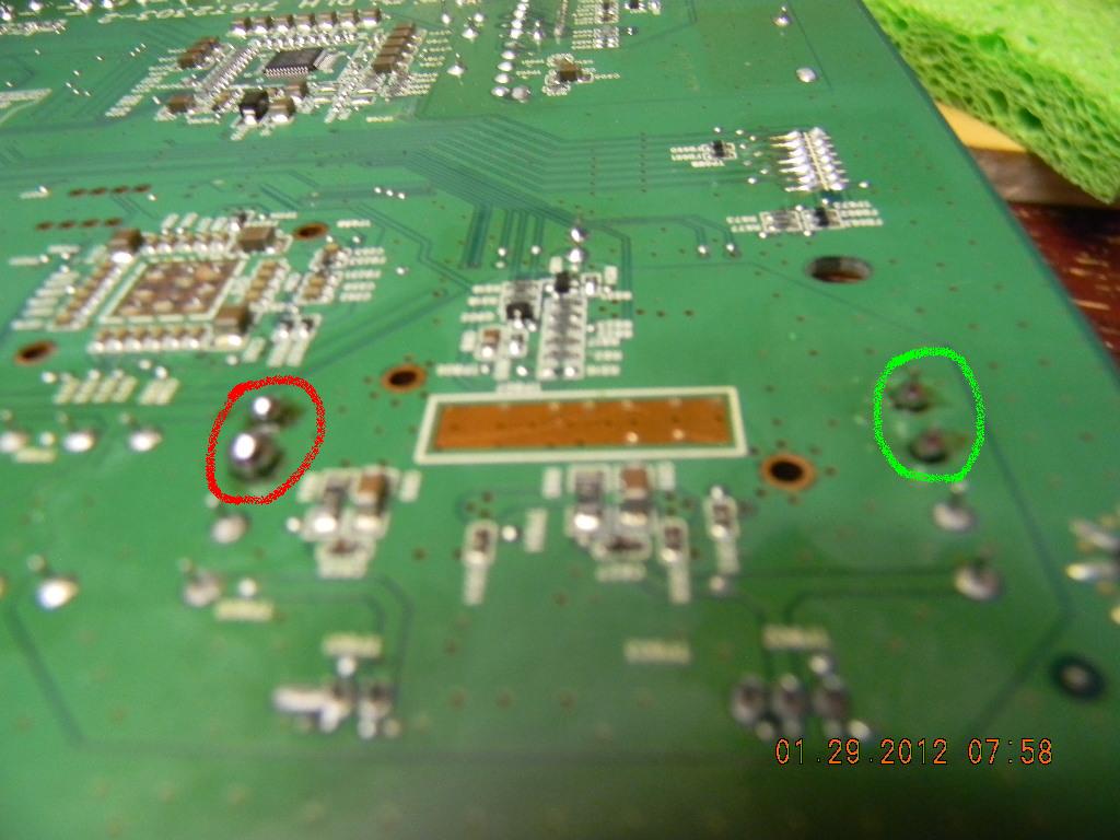

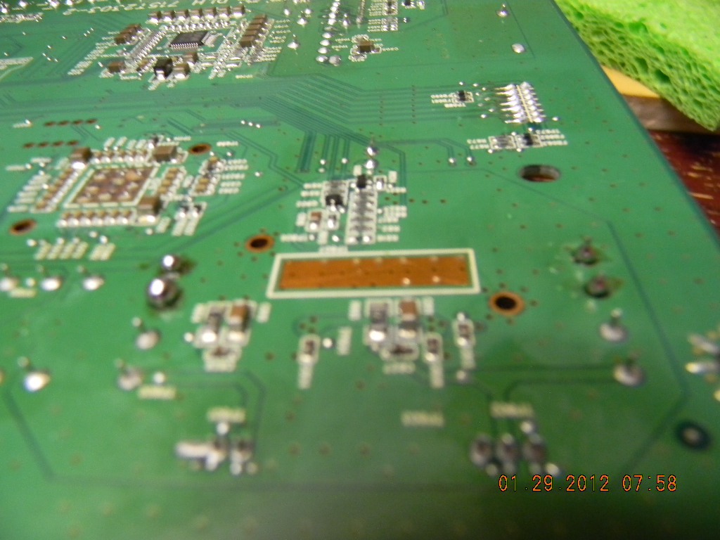

                    Well, I managed to get one decent shot of my soldering. I found out that there are a total of 14 capXons on that board. I have already replaced 3. The others are:
                    100 uf 25v (qty 3)
                    220 uf 16v (qty 6)
                    220 uf 25v (qty2)
                    Does anybody know what those two green caps are? The name starts with a cursive L and I can't make out the rest. Don't know if they are a decent brand or not. Am wondering if I should replace them as well.
                    They are 470 uf 35v
                      The green joints look okay. The red joints definitely have too much solder on them. If you pull gently on that cap, does it move?
                      Lelon probably.

                        On 2nd thought, gently pull on the green ones as well. They fillet shape looks okay, but it is hard to tell from the photo.
                        Let's see what others say.

                          The green ones are cold jointed.
                          However if the joints are too difficult to get right, it is possible using a piece of wire to bridge it over to the inductors to get better contact. That's a last resort.

                            The red one was my first attempt at soldering, remember? I was using thicker solder. I took that one off and re-did it and they are both nice and shiny and don't seem to wiggle.
