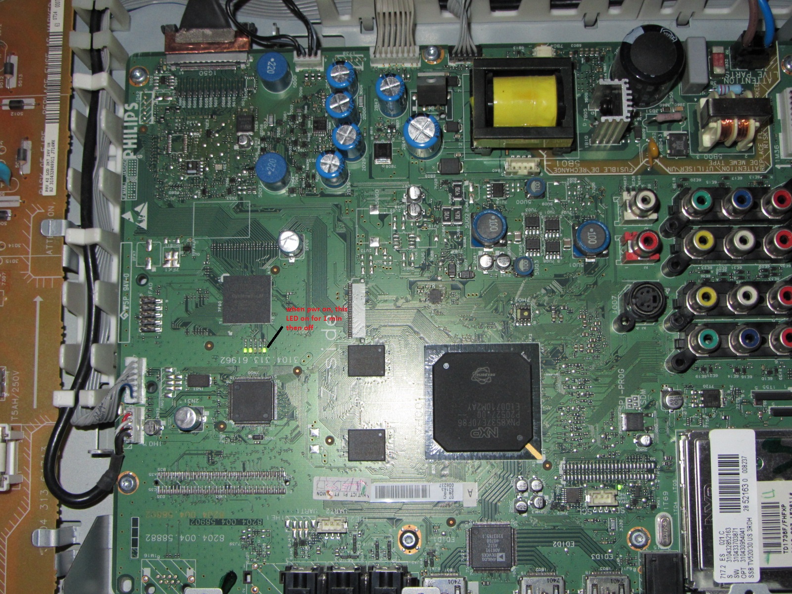

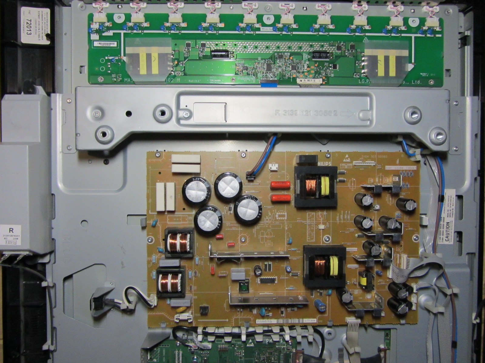

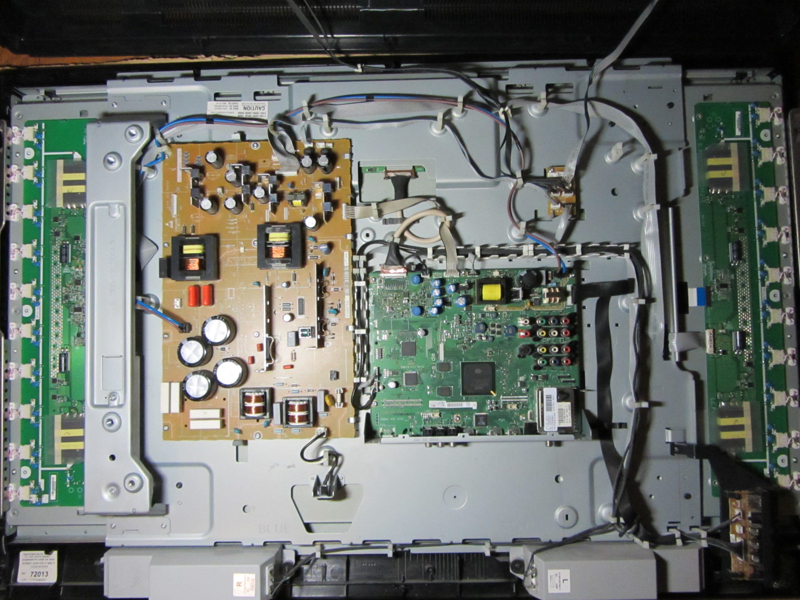

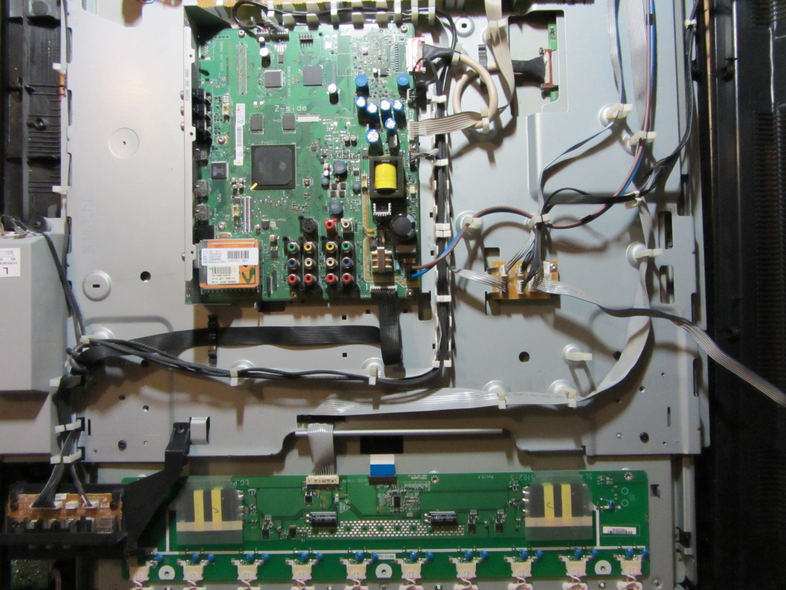

    1) Do you have a source hooked up like a DVD player to see if there is a picture and sound?
    2) Does the power always go off after 1 minute?
    a) If you turn off the TV and turn it back on, does it stay on 1 minute and go off again?
    It can't be turned on. I tried to hold/release the power button on the side of the TV and sometimes, I was able to turn the unit on after hitting the power button few times, then the power button worked and I could turn it on/off as usual until I shut off the main power, then the problem re-occurred.
    3) Can we get a picture of the entire TV backside so all the boards are in view? We want to see the relationship and cabling between boards.
    See attached pictures.
    4) PS. Sharp eyed readers and future people will notice this is why we always INSIST on photos on your own TV. The boards are completely different even though backoi says the models are the same in post #36.
    Yes, I have one. Since TV can't turn on, so the dvd wouldn't do anything.
    Yes, after pluggin in the main power cord, one of the LEDs on main board stayed on 1 min, then it went off at the same time with a blue indicator LED in front of TV. See attached pictures.

      Re: Philips 42PFL5432D/37
      The service manual is available from Elektrotanya. This TV uses a split power supply design that makes troubleshooting a LOT more interesting. I'd suggest downloading the service manual, Philips is excellent about supplying troubleshooting information. I'll be downloading a copy myself and be ready to help.
      The fact that you have 24 volts to the inverter and the blue light goes on and off indicates both power supplies may be working. The first step is to check that. Since it does not appear the connectors are labeled, the manual is going to be a big help.

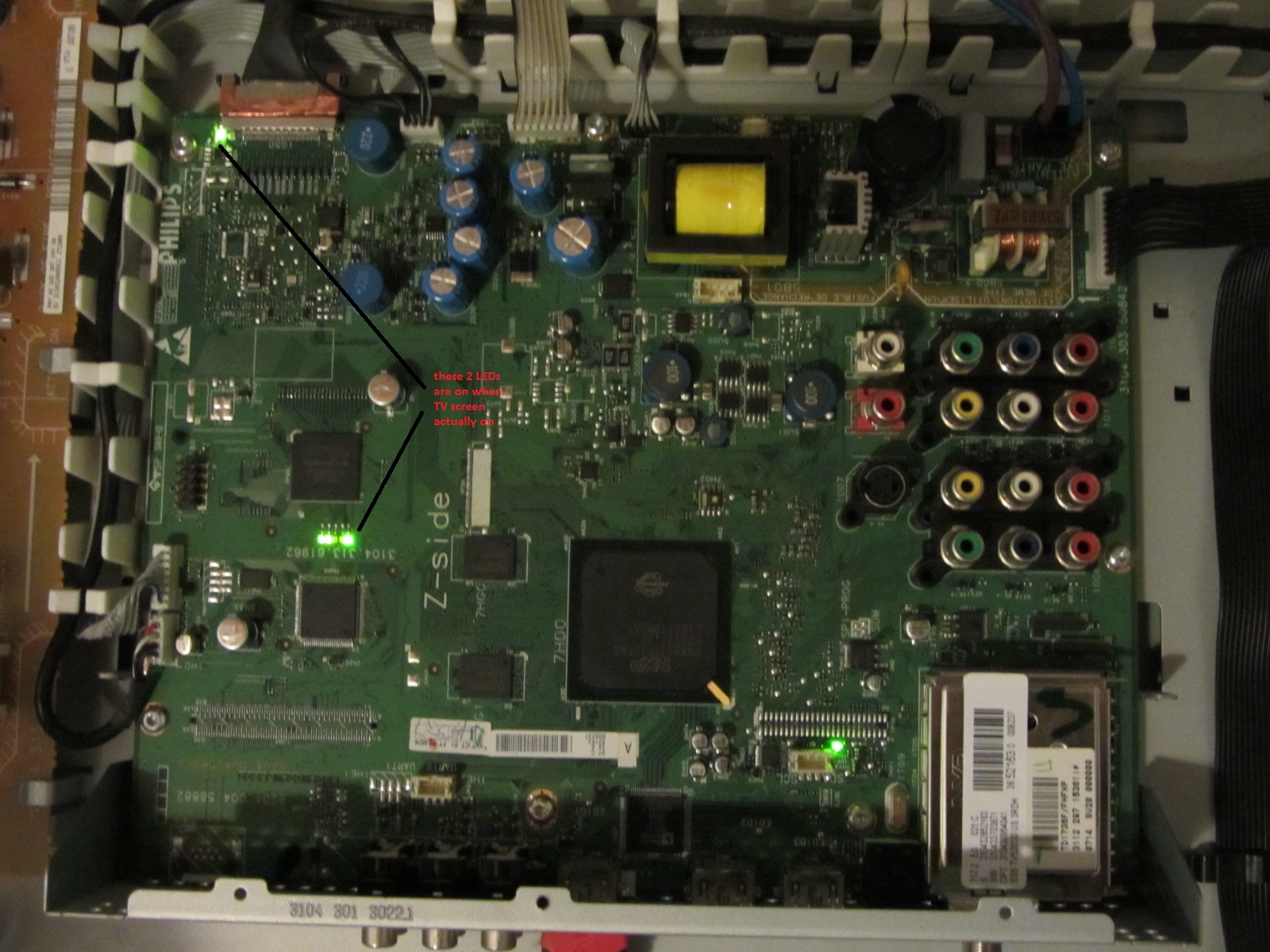

                          If the sound and power light stayed on, that implies the main board is working correctly.
                          Check again when the TV goes off if 24V DC is present on the master and slave inverter board.
                          If not, that implies that the power board has a problem. Since other past owners of this set have posted pictures with bad caps on the power supply, I would suspect you will have to recap the power board given Capxon's poor reputation.
                          Remember caps don't have to bloat in order to be bad.
                          If 24V DC is present when the TV goes off, then that implies a bad t-con as PlainBill mentioned in post #20.
                            I only re-capped the 2 that were bloated. Do you think that's my problem? I didn't want to tempt fate since it was my first time soldering, but now I am regretting it. I will re-check to see that the 24V DC is present on both master and slave, but if it was good before, shouldn't it be good now?
                            About the bad t-con in post #20, I never could see a picture when I shined a light inside, either before or now. But the green power light is staying on now after the recap, before the recap, it turned amber.
