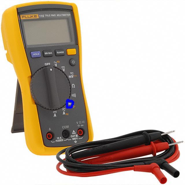

              Originally posted by tbuch
              I don't, but I will have to pick one up tomorrow.
              If you are going to buy one, get one with a symbol that has ->|- on it. Like the symbol circled in blue.
              Same if you are borrowing one.
              PS. If you are buying one, which one do you have in mind? I have a big interest in multimeters.

                I am sending my hubby to walmart after he gets off of work to pick up the one you suggested in a earlier post ... Equus 3300 hands free multimeter.

                              #154
                              Re: Philips 42PFL5432D/37
                              Just got done checking diodes;
                              Diode zd904 reads 034 (both directions)
                              Diode zd902 reads 061 (both directions)
                              These are the two diodes that are on the power board.
                                #155
                                Both are shorted.
