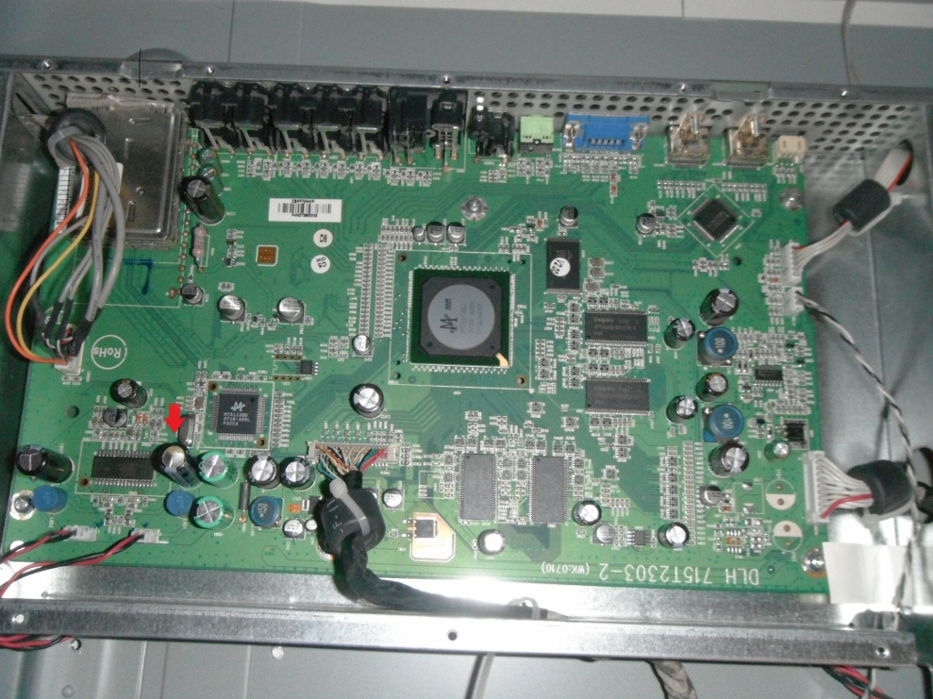

    Originally posted by PoteauPets
    Hey Retired, Just took a look at the two caps I replaced and one has already bloated !!
    What is causing that?
    Let's see a picture of it.

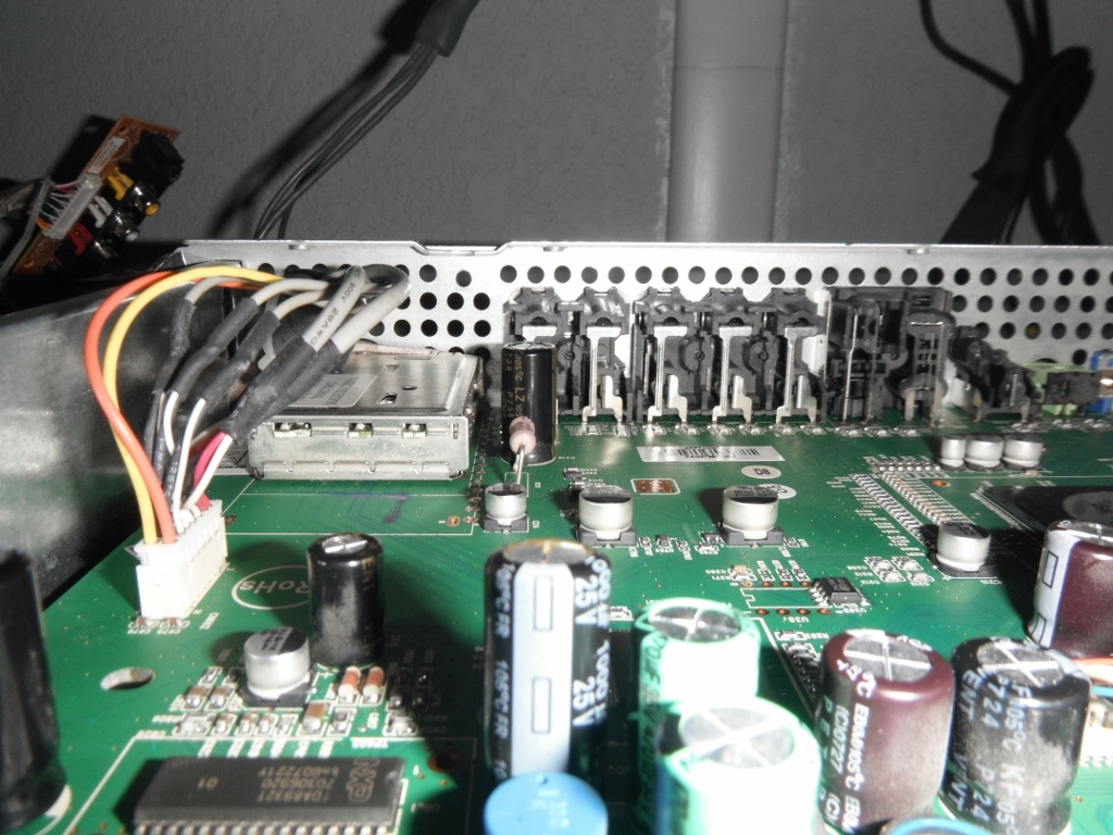

      Re: Philips 42PFL5432D/37
      Here are a few pics. I put a red arrow over the new cap that is now bad.
        #63
        Did you put it in the right way? Negative to negative? Looks like it is reversed.

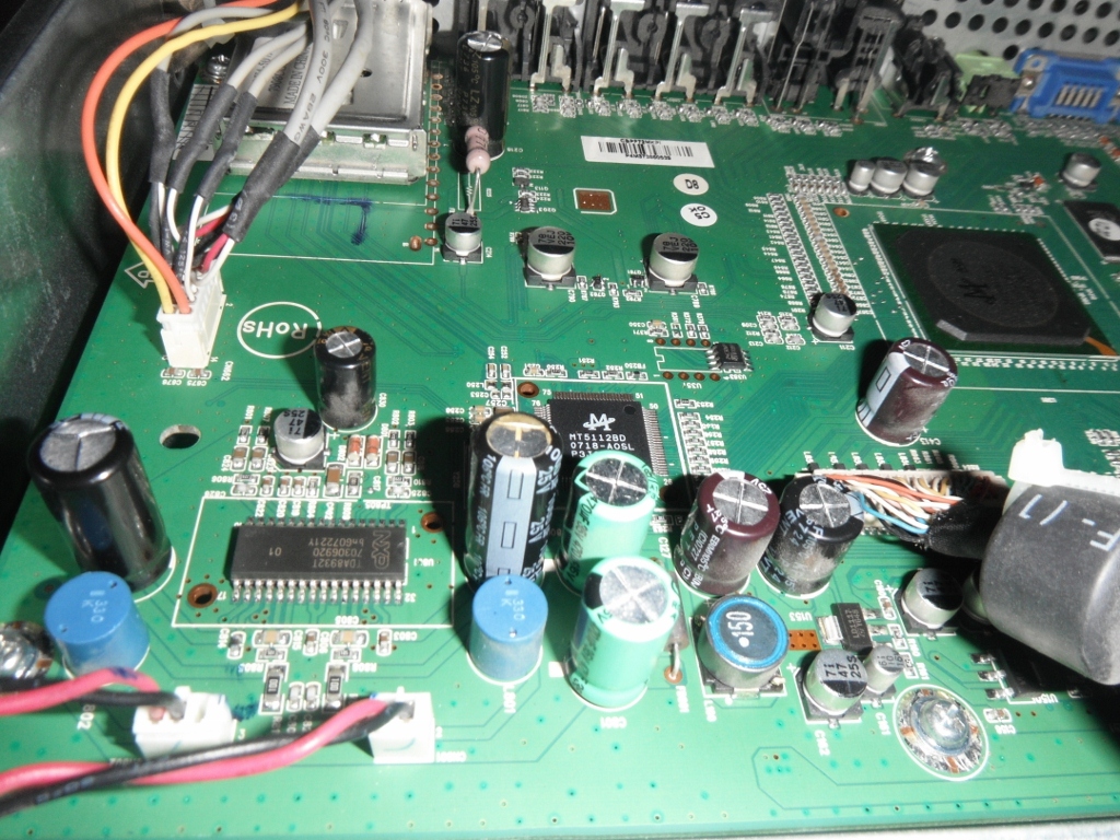

          I suspected that, but wanted to see a picture for confirmation. It is reversed when compared to the original picture at
          https://www.badcaps.net/forum/attach...7&d=1325569041
          Notice how both negative (the one with the stripe) side is facing towards the RoHS label.
          If this cap were put in backwards in the power supply, it would have popped immediately.
          Well, good thing you ordered a spare!
            Either way, it looks like those capacitors are for the audio output. Probably not critical to the operation of the TV. (Might make the audio not sound as good, though.)

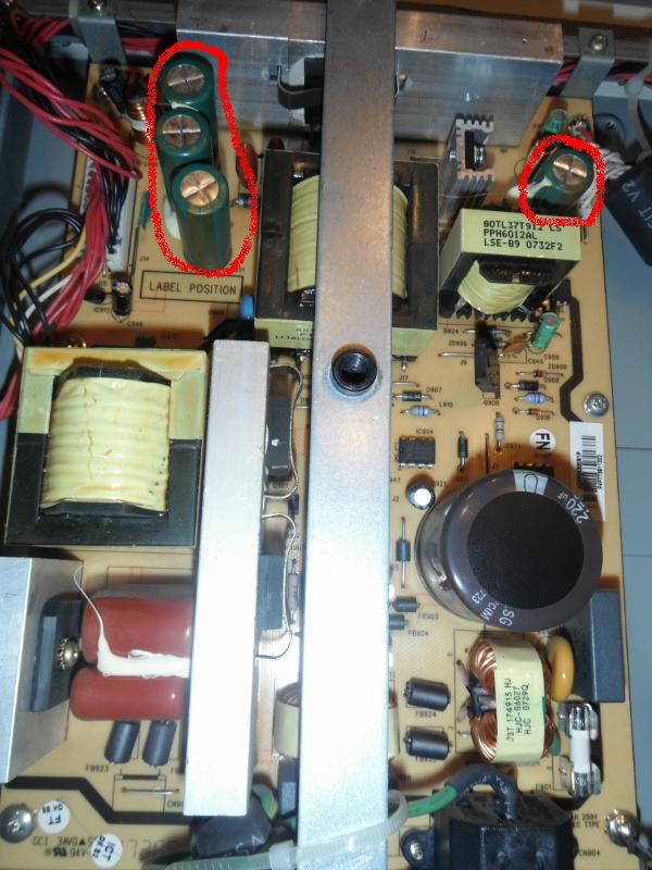

              Agreed. Post #57 advice/recommendation still stands. This is in addition to the newly bloated cap on the main board.
              edit:
              Just so it is clear to the OP, these Capxon caps (circled in red) on the power board are the ones likely to supply power to the master and slave inverter boards (the missing 24V DC). Even though they are not bloated, they could be low on capacitance.
              In lay terms, it is just like you cannot tell if an AA battery is dead or not by looking at it.
              PS. Of course, regulars here will recommend changing all the caps, but we have to consider her inexperience in soldering.

                  #68
                  Notice how both negative (the one with the stripe) side is facing towards the RoHS label........
                  Yep, I see it.......
                  And not only did I order ONE extra, I ordered ONE MORE EXTRA EXTRA...lol
                  So, the green caps on the power board need to be re-capped? That group of 3 measures abt. 1/2" x 1 3/8" tall, or 13x35, but the only thing I can see on them until I take them out is GF 105 P724.
                    Was re-reading our previous posts. The info for the capXons on the power board are for the 1500uv35 (group of 3) 2200uF16v (single)

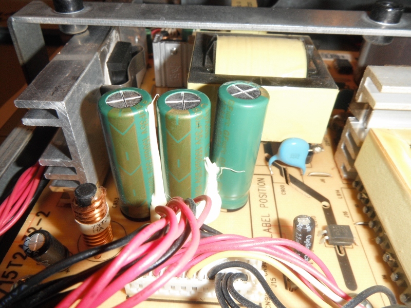

                                    #77
                                    The number @ digikey is P12369-ND

                                      #78
                                      Panasonic FM is fine for the 2200uF 16V.
                                      I would recommend these United Chemi-con KZE for the 1500uF 35V caps.
                                      http://search.digikey.com/us/en/prod...1700-ND/756216
                                      They are almost half the cost of Panasonic FR and they will fit. The FR is 16mm diameter and a whopping $1.74 each. UCC KZE are good caps as well.
                                      BTW, the 2200uF 16V cap is obviously not part of the 24V rail because of the cap rating. The group of 3 are rated at 35V and provide the 24V DC output for the inverters.
