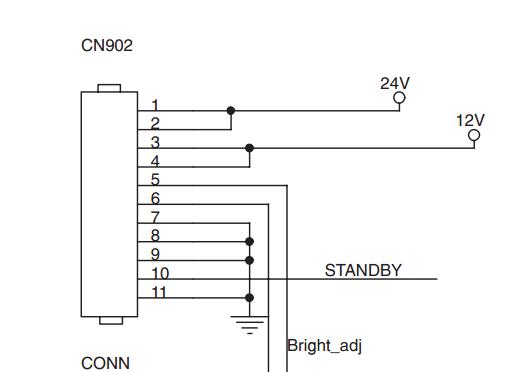

    1) Okay, on CN902 (power board), there is one red wire and a lot of white. Make red wire pin 1 and number the rest in order. It looks like pins 3 and 4 are 12V.
    2) Again, with the TV working, measure all the DC voltages (multimeter set on 20V DC). For the 24V pins, you will need to set it to 200V DC otherwise you will get a "1" on the left hand side. For the other voltages, set it to 20V DC.
    3) Measure them again when the TV picture goes out.

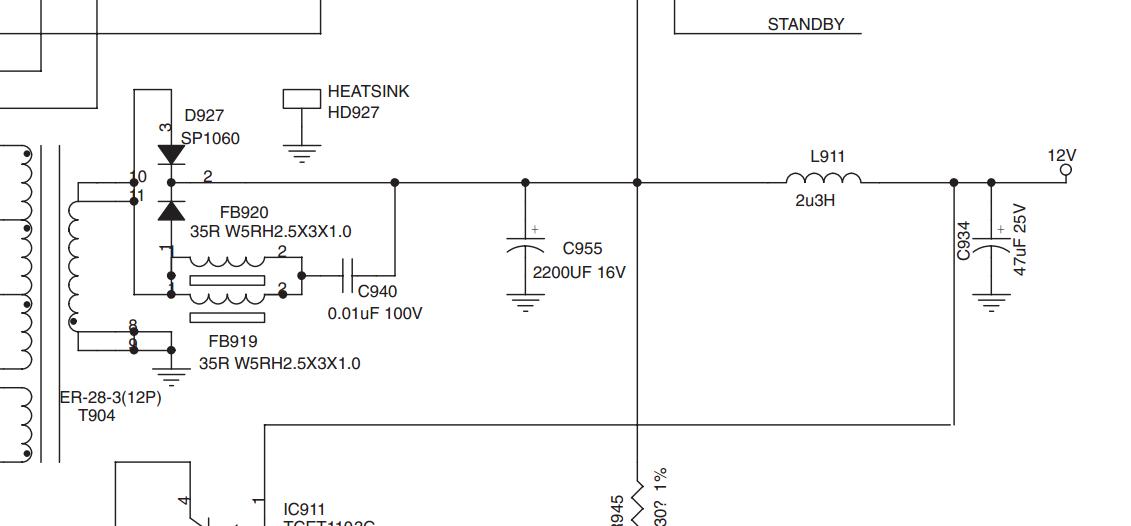

      1) Okay, I'm off to bed soon, but if the CN902 connector shows a missing 12V when the TV goes off, then the prime suspect is that green Lelon cap still remaining.
      2) I snipped out the schematic that shows the board. C955 is the new Panasonic cap. C934 is the 47uF 25V cap just before the 12V test point.
      3) The little caps like C934 usually never bloat when they are bad or going bad. If this cap is bad, the 12V disappears and so does the voltage on the t-con. That is why I had you confirm VIN=12.00 when TV is working and VIN=0.45 when picture disappears in post #178.
      4) If you don't have a 47uF 25V spare, you can use 47uF 50V instead. If you have to order, get this
      http://search.digikey.com/us/en/prod...2923-ND/762833
      5) So if I'm correct, the t-con is fine under heat and it is C934 that dies under hot conditions. This is opposite of what I originally thought, but once I saw the schematic I think this scenario is more likely given the Lelon cap. It will be proven once you do test #1.

        6) I see another Lelon cap C958 (another 47uF 25V). You might as well replace that as well and whatever else is still an original cap.
        7) If changing these two Lelon cap's doesn't help, there is more to troubleshoot.

            Testing in progress:
            With tv powered off this morning: (just for a starting ref)
            1=0
            2=12.10
            3=0
            4=12.1
            5=.4
            6=0
            7=0
            8=0
            9=0
            10=0
            With tv turned on:
            1=0
            2=12.31
            3=12.3
            4=21.4
            5=21.1
            6=24.4
            7=24.4
            8=24.4
            9=21.6
            10=24.4
            When tv lost picture
            1=0
            2=12.06
            3=12.1
            4=.4
            5=0
            6=0
            7=0
            8=0
            9=0
            10=0
            BTW, I have one 47uf35v cap here. Part # P11232-ND
            I have other caps, but not in the 47.

              Is this CN902? I count 11 pins on CN902. This is the connector by the green Lelon cap. It has one red and 10 white.
                Yes, that is CN902, if you put one tester on the red, and then the other on each of the white ones, you get 10 tests. At least that is what I come up with, unless I'm doing it wrong.

                  Put your black probe on a ground screw and leave it there. Red is pin 1, the other white are pins 2-11. You should get 11 results.

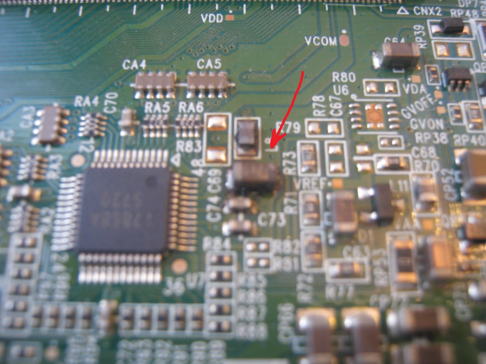

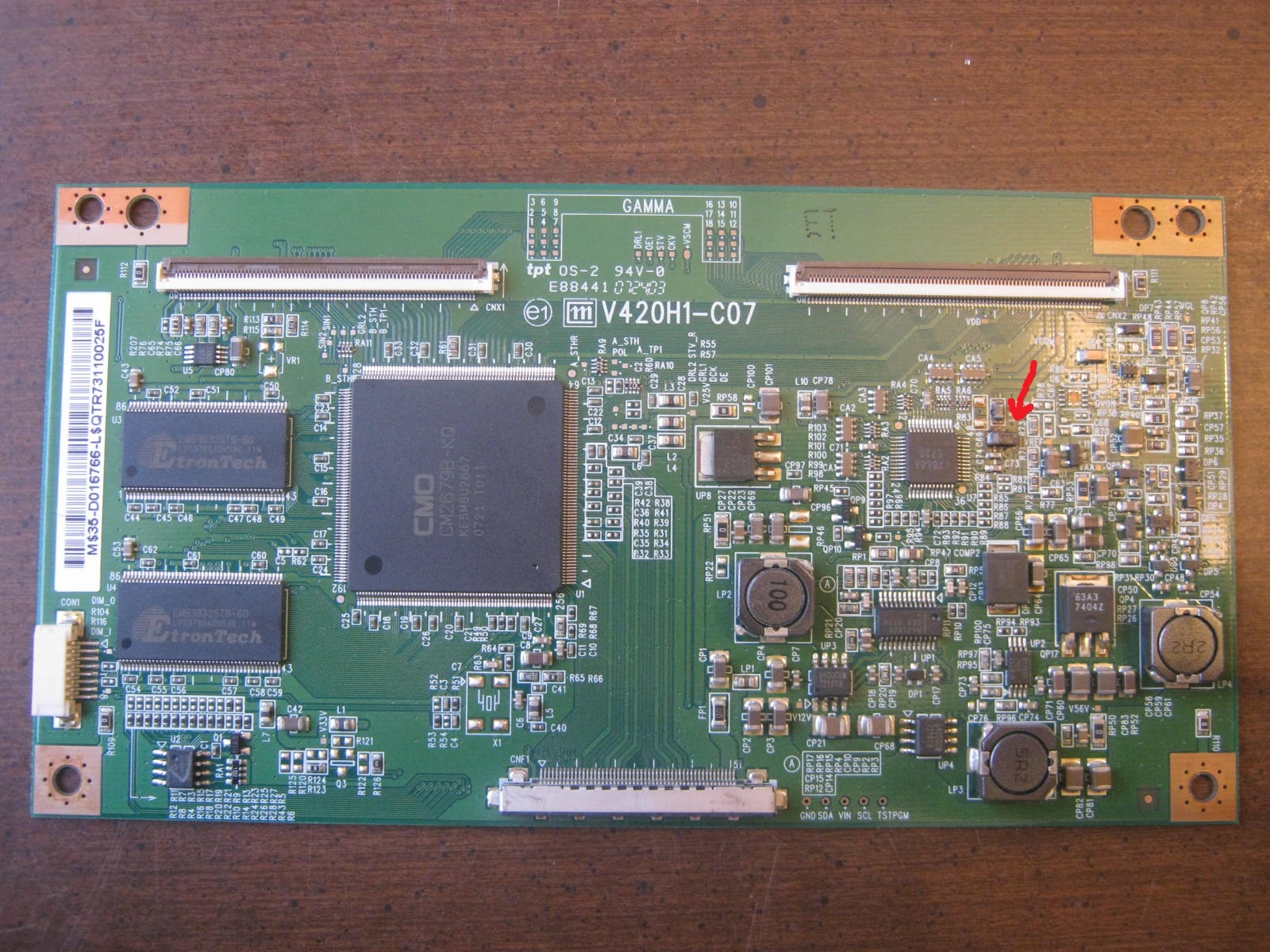

                                        I had some time to take a closer look at the T-con board and I see an SMD with what appears to be some slight burning on the PCB beneath it. I can't tell what it is (maybe a diode) there are no identifying marks on it. On the PCB right next to it is "C69".
                                        My camera really sucks, if I can get a decent pic of it I'll post it. Hopefully someone will know what it is.

                                          Okay, I don't think it's a diode. I'm no expert here. And I hope the pics aren't too big. My camera doesn't really have a macro setting, so I did the best I could...
