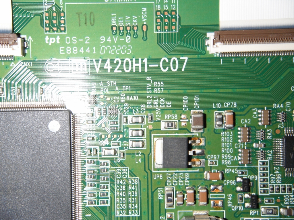

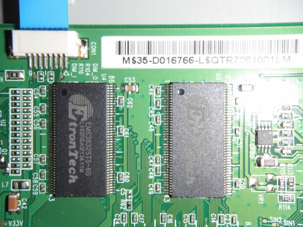

              1) My next best guess, and it is a guess, is that something on the t-con may be overheating.
              2) A replacement is at
              http://www.ebay.com/itm/220939145281
              3) To verify if that is the case or not, try to think of a way just to keep this card cool (instead of the entire backside of the TV). This may involve some "duct" work or portable hair dryer on the cool setting.
              4) There is a voltage regulator on the board (maybe two), but I'm afraid your analog multimeter may not provide enough precision to determine if it is bad or not. A voltage regulator should be within 1% of it specifications.
              Now if the voltage regulator is "obviously" bad, then a 3.3V regulator might read 4.5V or 2.4V which is enough to spot with an analog multimeter.

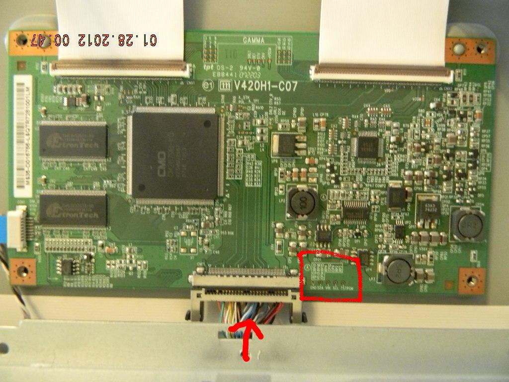

                  #168
                  Re: Philips 42PFL5432D/37
                  Originally posted by PoteauPets
                  Where and what exactly is the T-Con???
                  https://www.badcaps.net/forum/attach...5&d=1327778579
                  PlainBill also mentioned it as a possibility way back in post #20.
                  It stands for timing control.

                      #170

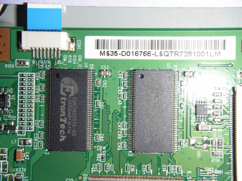

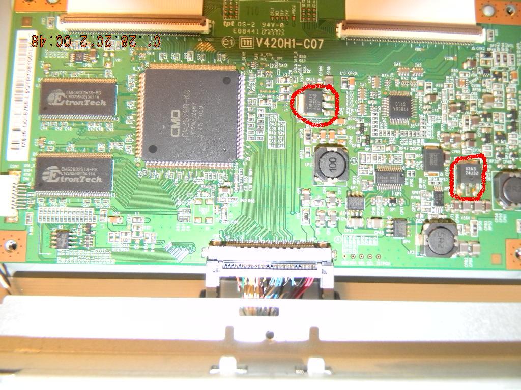

                      1) I marked the two voltage regulators. The pics are almost good enough for me to make out the part numbers, but I can't. So please list the part numbers.
                      2) To measure them, see my bookmarked answer at
                      https://www.badcaps.net/forum/showpo...13&postcount=3
                      Use a ground screw on the t-con for your black probe.
                      3) Obviously, we want comparison readings of these two when the TV is working and when it is not.

                        #171
                        Part numbers
                        ANE 8815
                        AECS 250
                        0719
                        6343
                        74J3Z
                        Will post readings momentarily.
                            Readings with TV ON
                            ANE 8815 AECS 250 0719
                            Pin 1=2.49v
                            Pin 2=0
                            Pin 3=3.27v
                            6343 74J3Z
                            Pin 1=0
                            Pin 2=3.69v
                            Pin 3=2.81v
                            Readings when the TV kicks off=0 across the board.

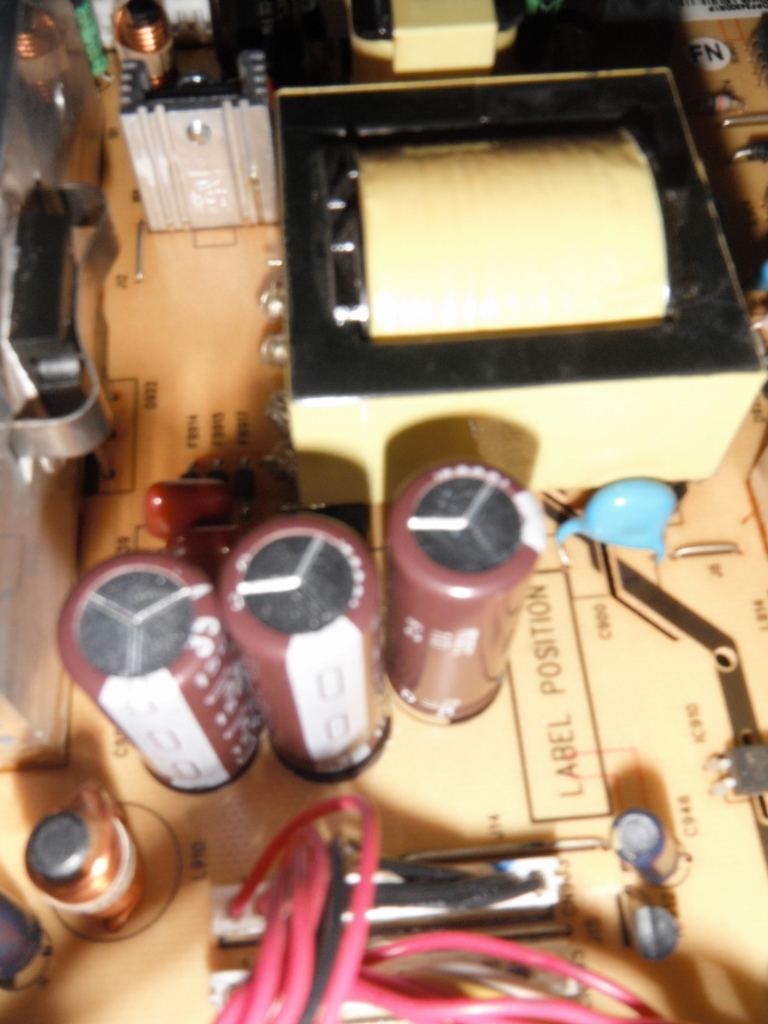

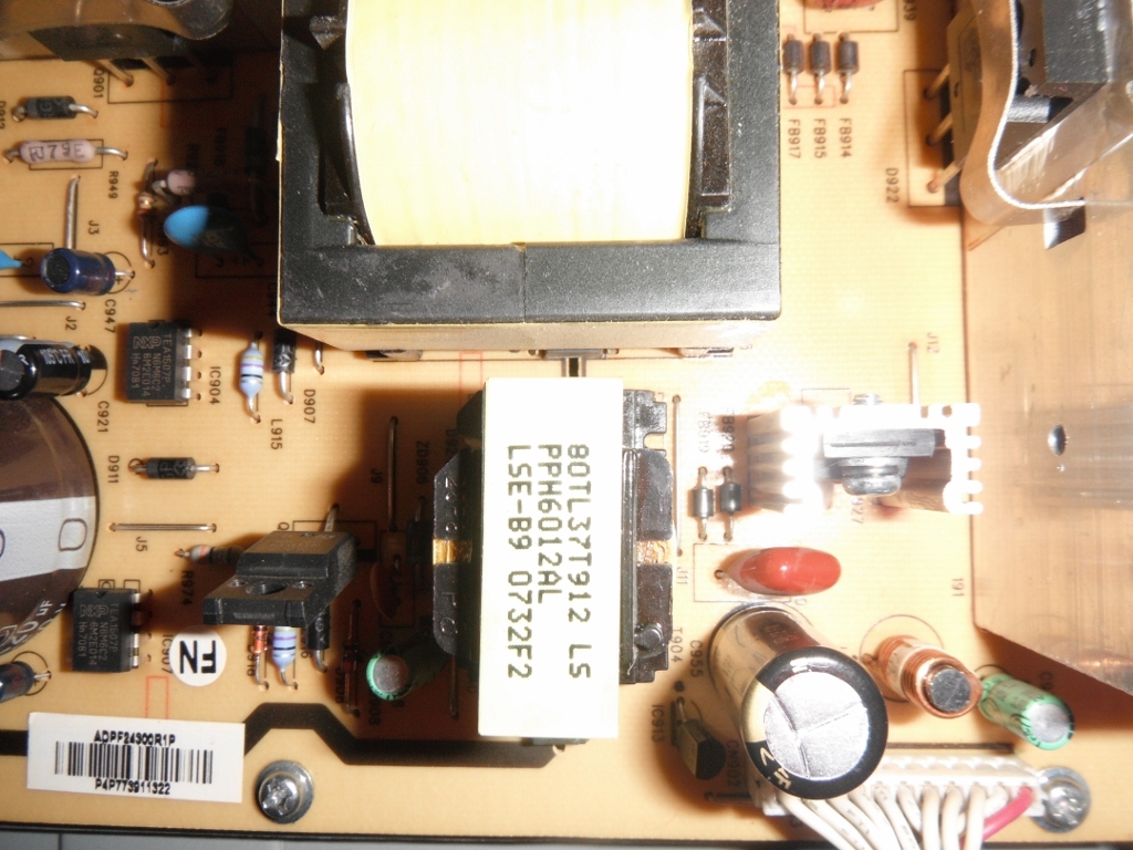

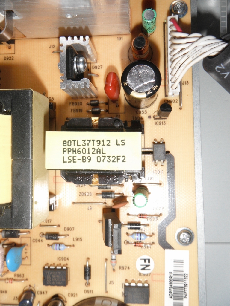

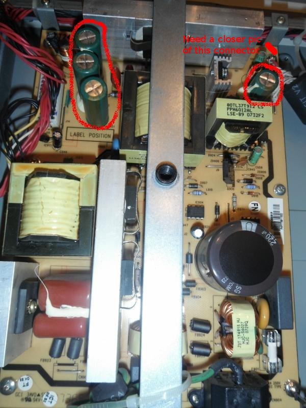

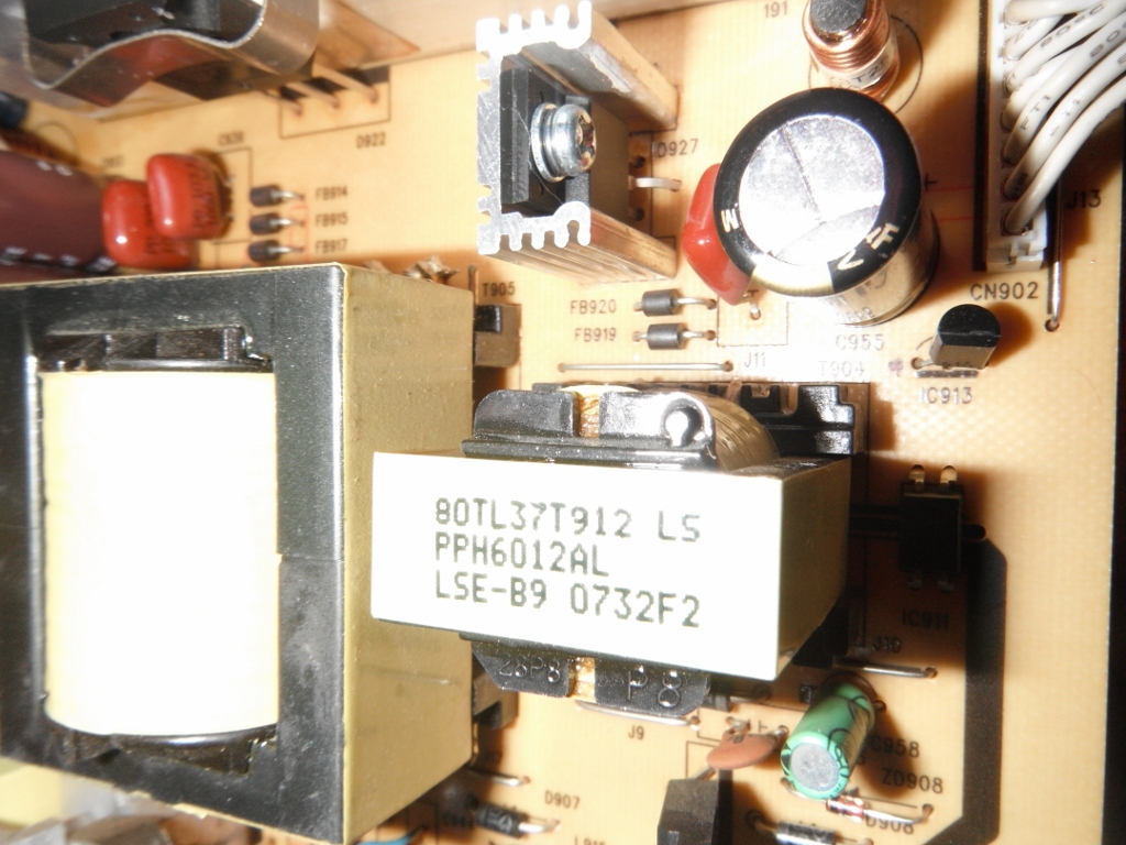

                              #174
                              That indicates that something is cutting power to the boards - suspicions rest on the power supply - as the 24V is shutting off as well.
                              If the power LED stays ON during the failure, the standby voltage is -probably- fine, but we must check that it is at 5V and not at a voltage which is too low.
                              Need a closer pic of this area. If there are any labels next to the connector, report them.

                                #175
                                Here are the latest pictures. By the way, Thank you all for your help !!!!
                                  The white label info is as follows:
                                  ADPF 24300R1P
                                  P4P77 773911322
                                    Readings with TV ON
                                    Pin 1=2.49v
                                    Pin 2=0
                                    Pin 3=3.27v
                                    1) The above is correct. The 250 indicates the output voltage. You have 2.49V.
                                    6343 74J3Z
                                    Pin 1=0
                                    Pin 2=3.69v
                                    Pin 3=2.81v
                                    2) I can't find a datasheet for the above and the readings don't match any of the "common" voltages. Common is 1.8, 2.5, or 3.3V. So this part could be suspect.

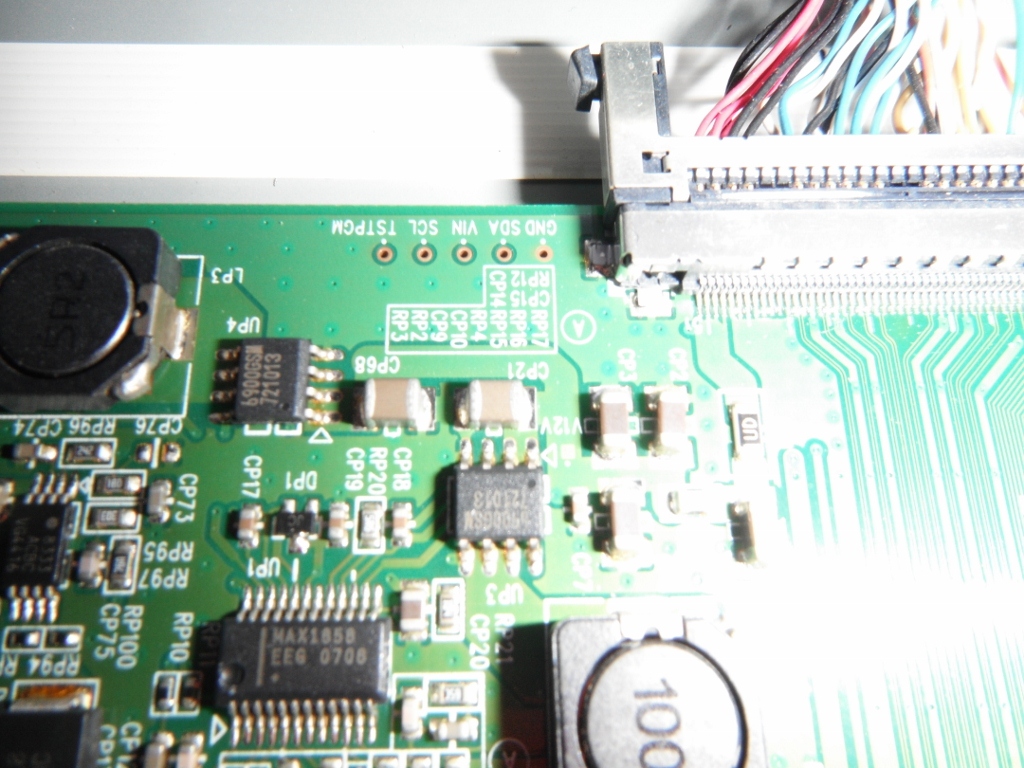

                                    3) Let's try another set of measurements.
                                    Circled in red are the t-con voltage rails. The red multimeter probe should fit into each of one of those small test points. Your black probe goes on a t-con board ground screw.
                                    4) List each legend and its value when the TV is working and not. Also please post a close up photo of just the section in red.
                                    5) Also please clarify the above "kicks off". The last I remember is that when the TV doesn't work, there was sound and backlights were on (white).

                                      #178
                                      Close up of the area in red per your request. And yes, when it kicks off, we still have sound and back lights.
                                      What do I set the meter to to perform the above mentioned test?
                                      Tested with TV Powered On, Meter set @ DcV -20
                                      GND=0
                                      SDA=3.28
                                      VIN=12.00
                                      SCL=3.28
                                      TSTPGM=.01
                                      Tested when the TV Shut off, Meter set @ DcV -20
                                      GND=.01
                                      SDA=.01
                                      VIN=.45
                                      SCL=0
                                      TSTPGM=0

                                          #180
                                          VIN=12.00
                                          VIN=.45
                                          For some reason the t-con loses power when it gets hot, but the main and inverter board are still functioning. I have to think about this.
