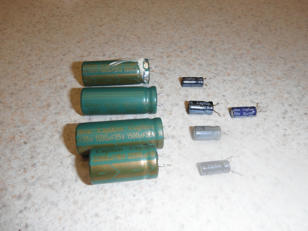

    Shopping List of all the other CrapXon caps on the power board. I already have the set of 3 (1500uV35) & the single (2200uF16V) in my basket at Digi-Key.
    Here are the others needed to totally re-cap all the CrapXons on the power board.......
    47uF35v KM105 (5mmX13mm)
    2.2uF50v NK105 (5mmX13mm)
    6.8uF50v KM (6mmX13mm)
    100uF25v KM105(5mmX13mm)
    10uF25v GS (5mmX13mm)
    Do you think I need them ?

      Re: Philips 42PFL5432D/37
      If this were my TV, I would have replaced them all in the intial go. Check diameter to make sure they fit. Plus all 5 caps below are $1.51 total so a no brainer really.
      Here are the suggested replacements.
      http://search.digikey.com/us/en/prod...1232-ND/356135
      http://search.digikey.com/us/en/prod...0313-ND/266322
      http://search.digikey.com/us/en/prod.../P936-ND/80642
      http://search.digikey.com/us/en/prod...413-ND/2433547
      http://search.digikey.com/us/en/prod...1212-ND/356116

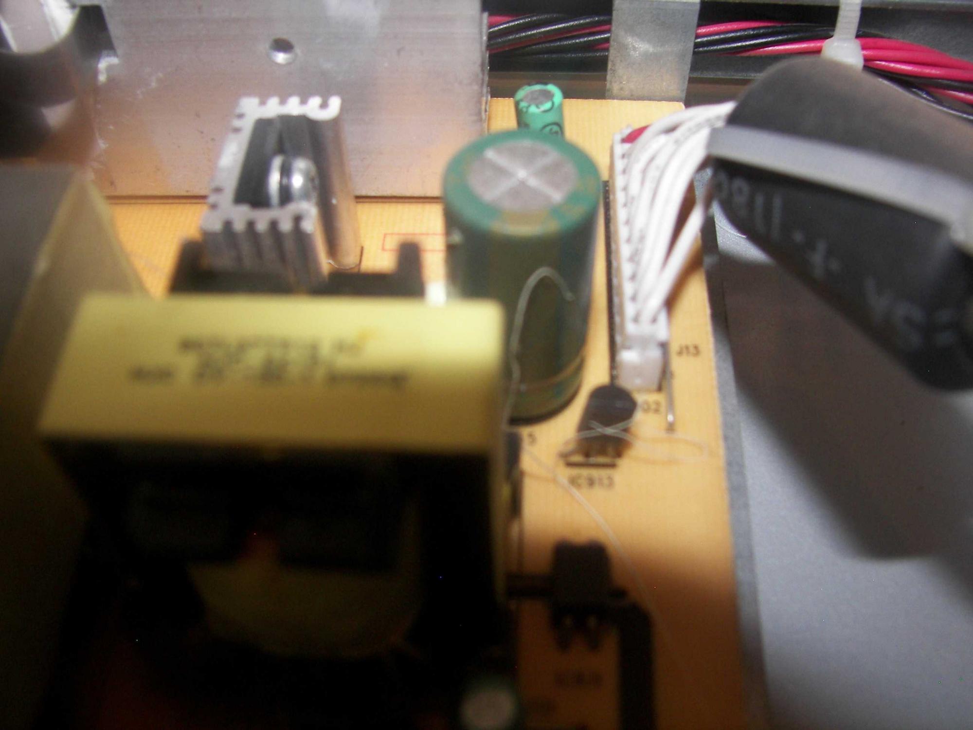

            Hi everyone, I am new here with the same problem with this TV. However, when I go to turn it on I can here something trying to power on, but nothing happens and the led light just stays a steady red.
            PoteauPets... Any news, the suspense is killing me!!!!
              You can start by posting top down view pictures of your boards by following my sig file below exactly.

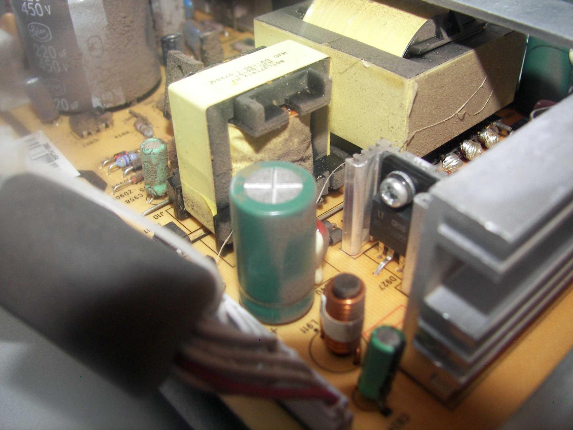

                I haven't got the back cover off yet... Just brought the TV out of the closet But I have been studying all the posts on this subject for two days. I will post pictures as soon as I get the back off~ Thank You
                • tbuch
                  • Jan 2012
                  • 31

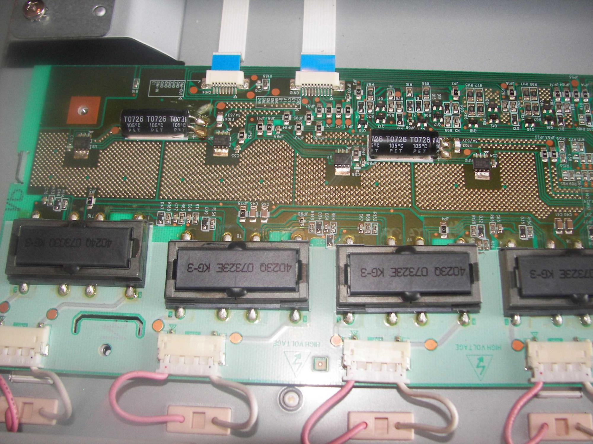

                  #88

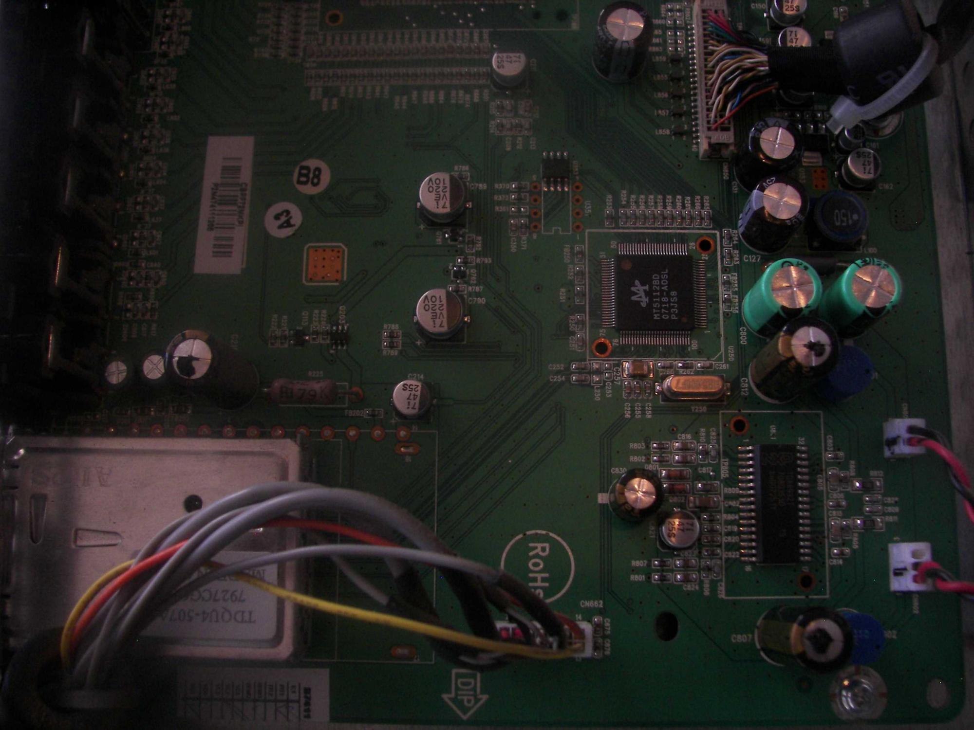

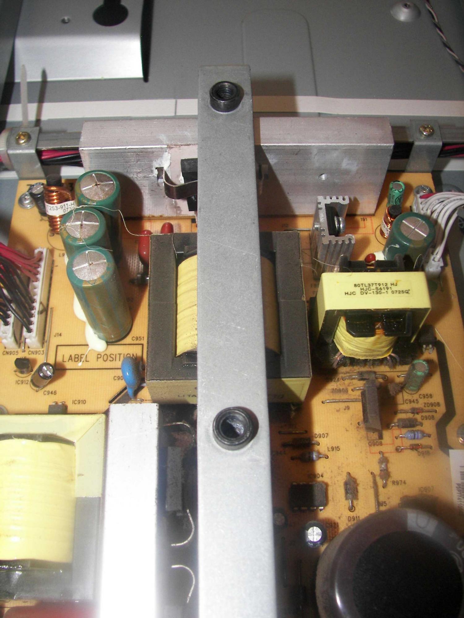

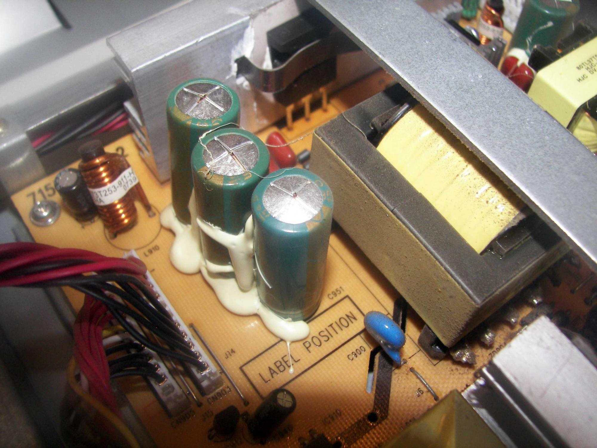

                  Finally, here are my pictures... Hubby has the tools in his car so I had to go on a hunt for spares.
                  I hope I uploaded them right.
                  • retiredcaps
                    • Apr 2010
                    • 9271
                    #89
                    Those group of 3 green caps are bloated. They provide power to the inverter section so the backlights can come on.

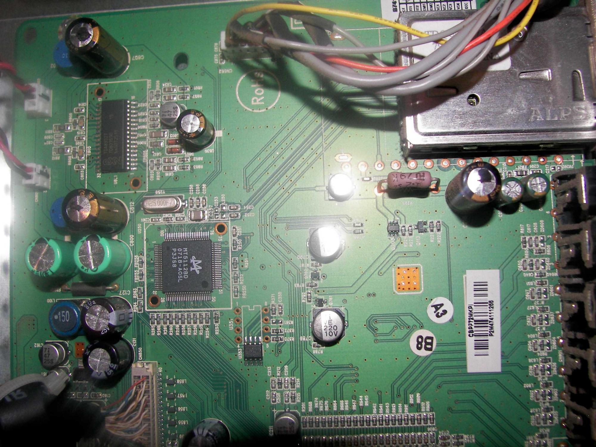

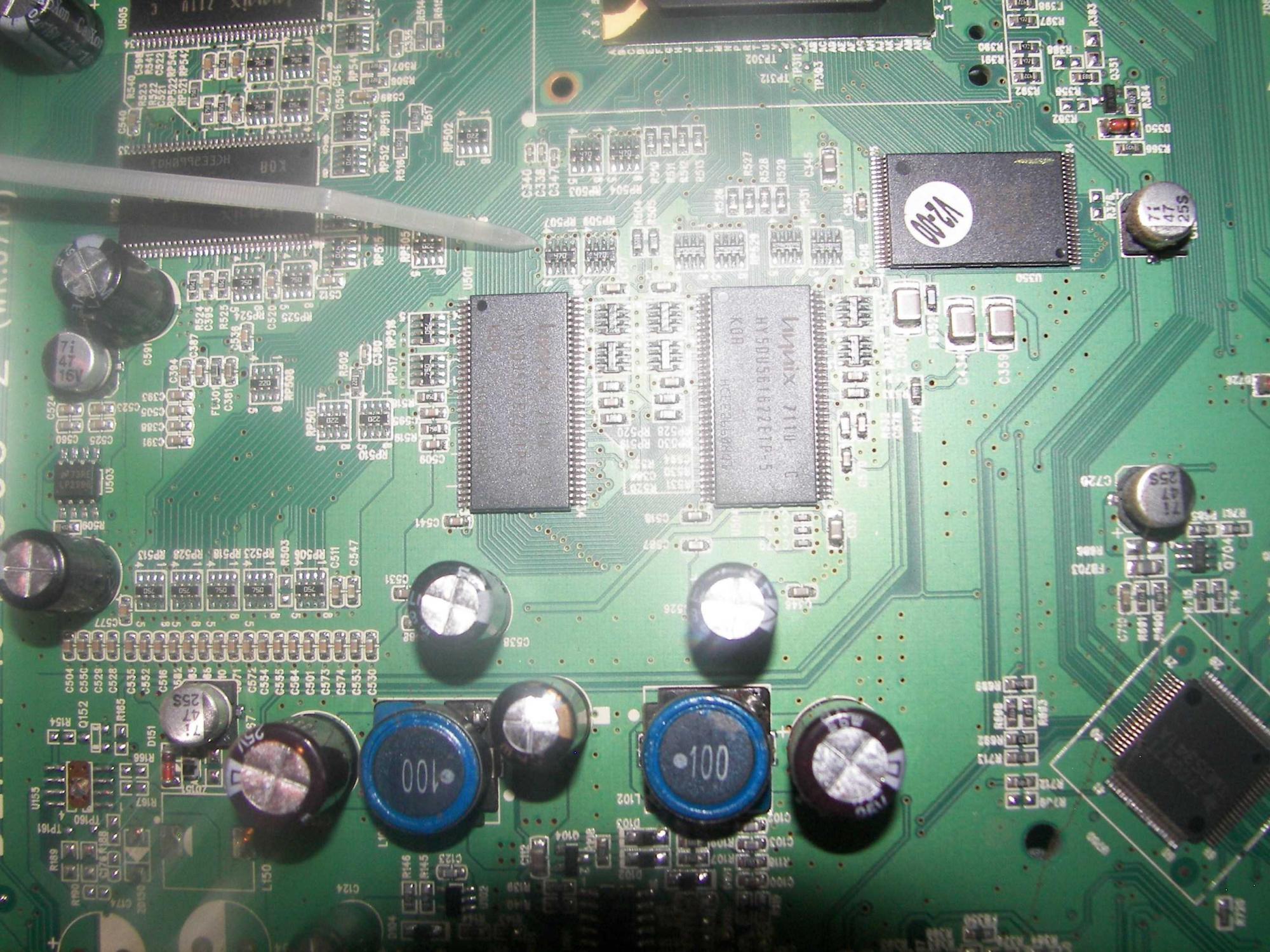

                    If you or your husband are good at soldering, I suggest replacing all the caps on the power board.
                    You should also post a picture of the main/logic board. This is the board that holds the HDMI, RCA, component connectors.
                    edit: It seems the same 3 keep dying as evidence from other posters who have the same TV.

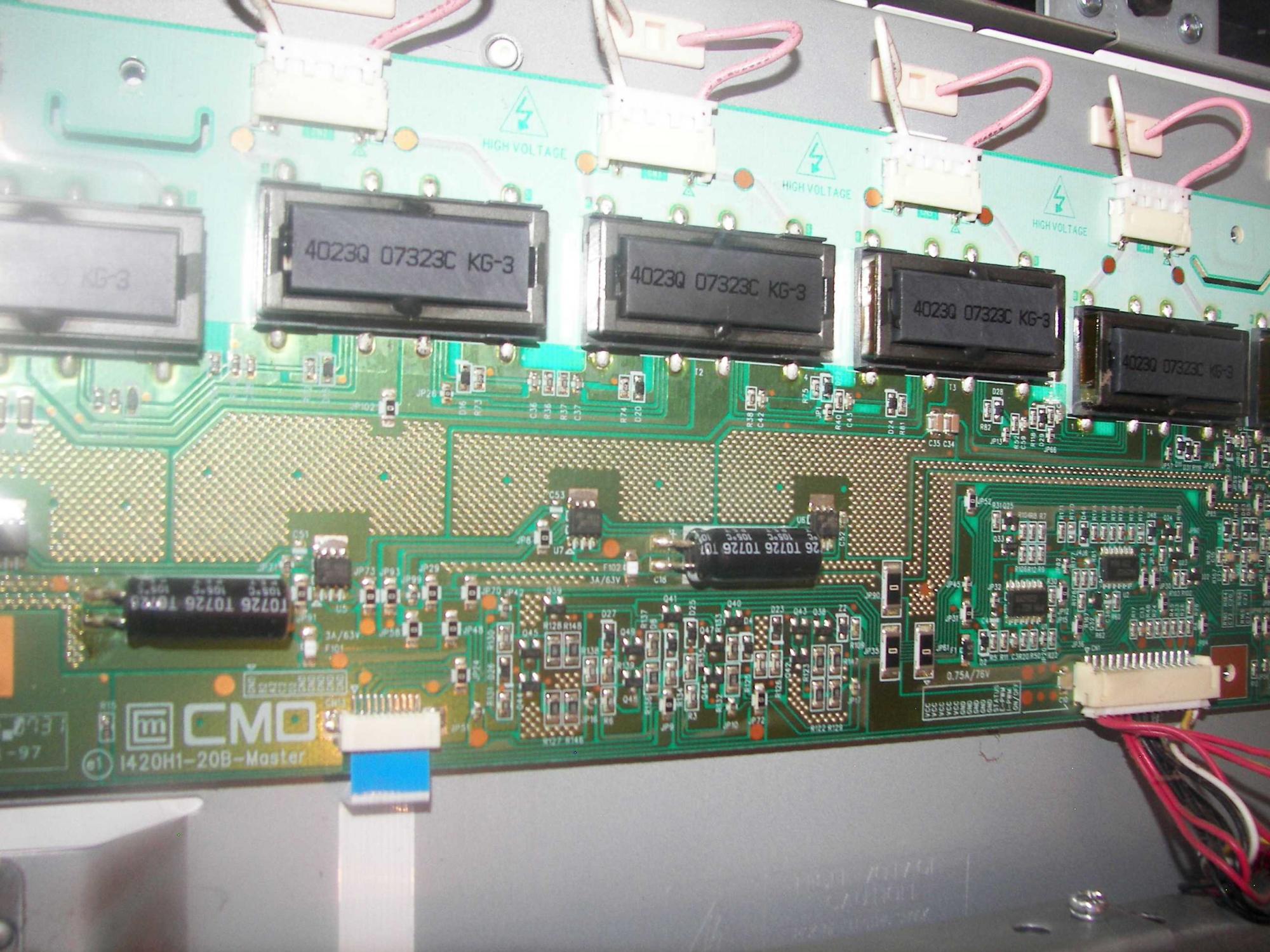

                        #91

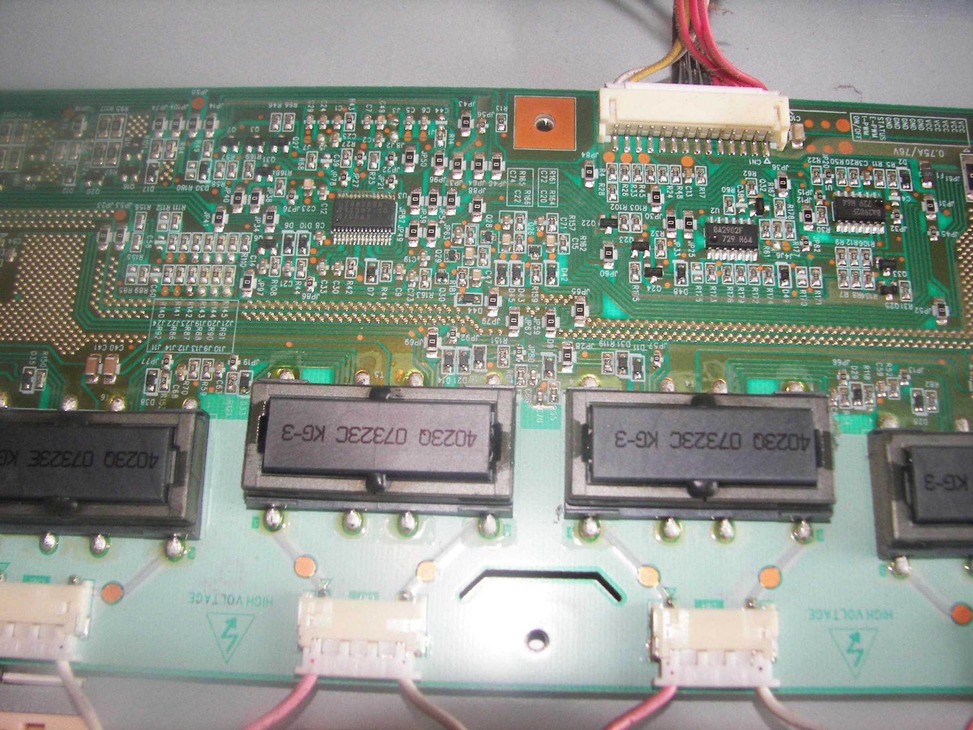

                        Here are three more images of the next board... With 3 more obvious bad caps.
                        • retiredcaps
                          • Apr 2010
                          • 9271
                          #92
                          I see 4.
                          --- begin sig file ---
                          --- end sig file ---
                          • tbuch
                            • Jan 2012
                            • 31
                            #93
                            Is the 4th the gold colored cap on the opposite side as the three?
                            • retiredcaps
                              • Apr 2010
                              • 9271
                              #94
                              Since I can't see the complete board and its relationship, it is the one circled in red. I think it is bloated, but it could also be a lighting trick?
                              • tbuch
                                • Jan 2012
                                • 31
                                #95
                                Yep, that is the one I was referring to, after closer inspection i did notice that it is bloated.

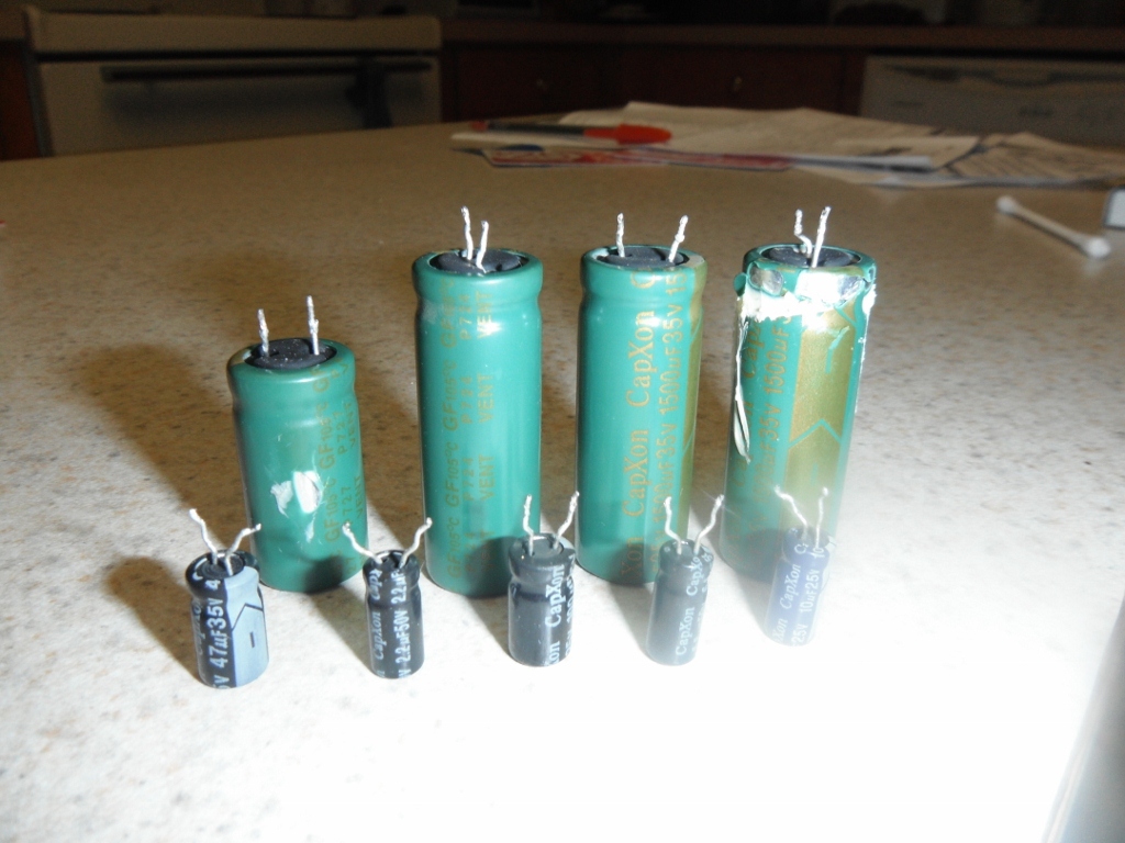

                                        #99
                                        Hi Guys,
                                        The caps finally made their arrival this afternoon. I removed and replaced all 9 of the CrapXon caps. Put the board back in, powered it on, and it's stayed on for a little over 2 hours now. I am sooooo soooo excited. Remember, I could barely get an hour before it would shut itself off. I think it's fixed !!!! Thank you guys for all your help. I couldn't have done it without you, that's for sure My 10 year old daughter is so excited to be able to watch her morning cartoons again before she starts her school day.
                                        Oh, and one more thing....when I started this whole adventure, I was a little nervous about soldering. I had to replace one cap, then re-do it because I put it in backwards, but after doing all 9 today, I think my solder joints are the prettiest ones on the board......lol
                                        I'm uploading some pics for your perusal. Thanks again guys, WE DID IT !!!!
