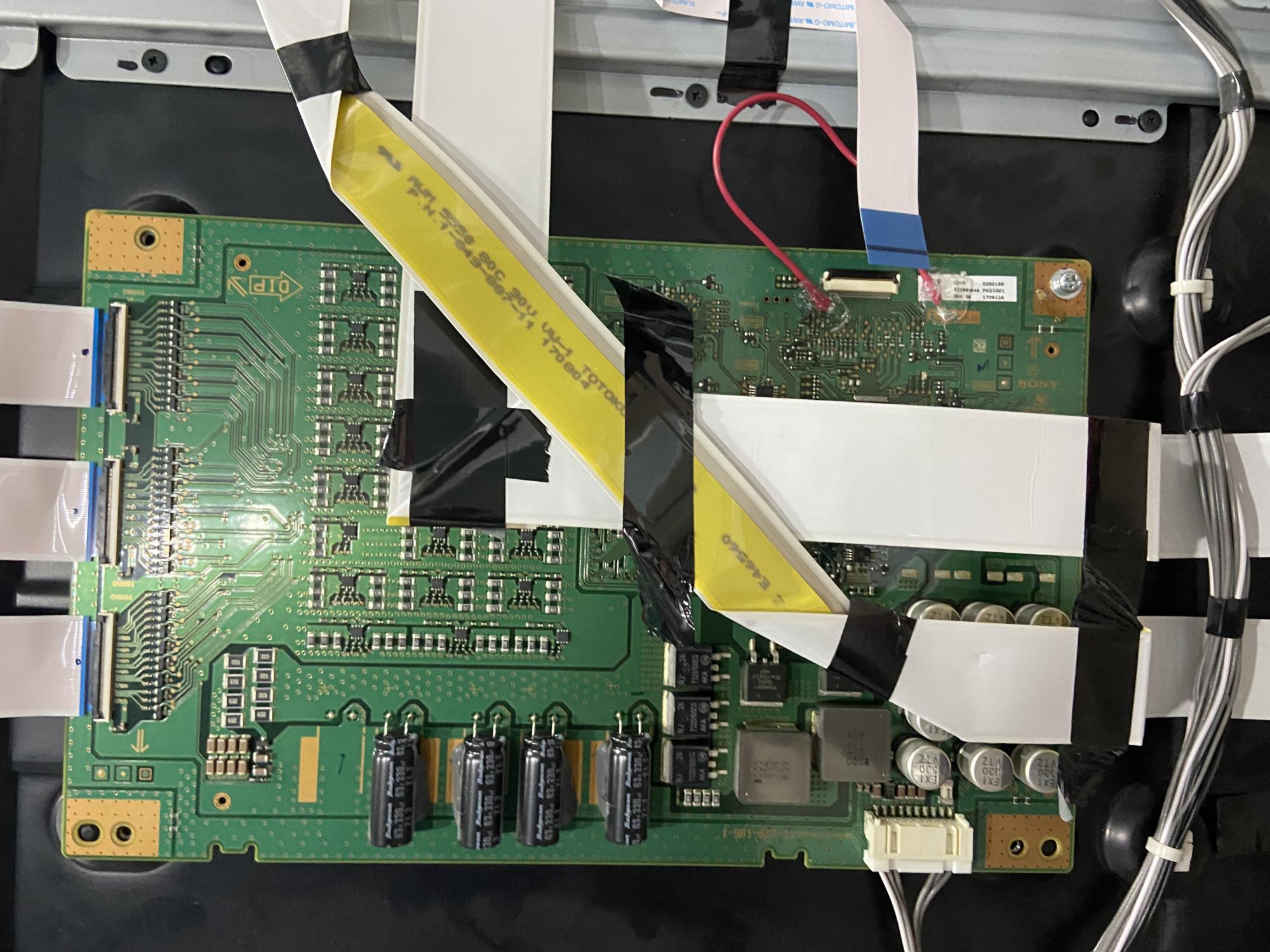

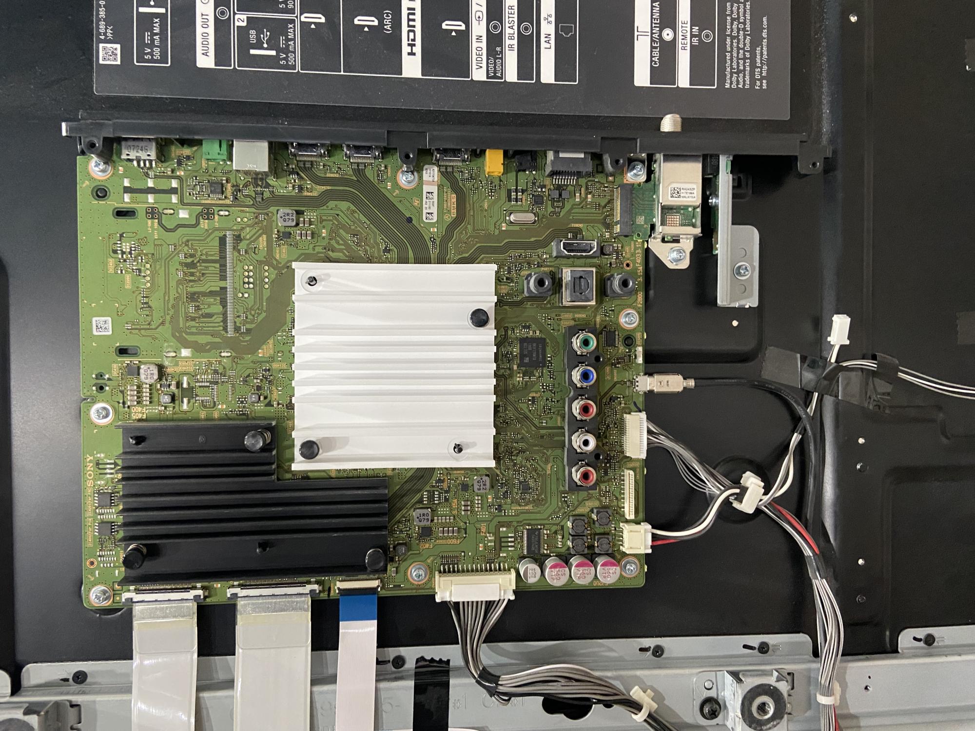

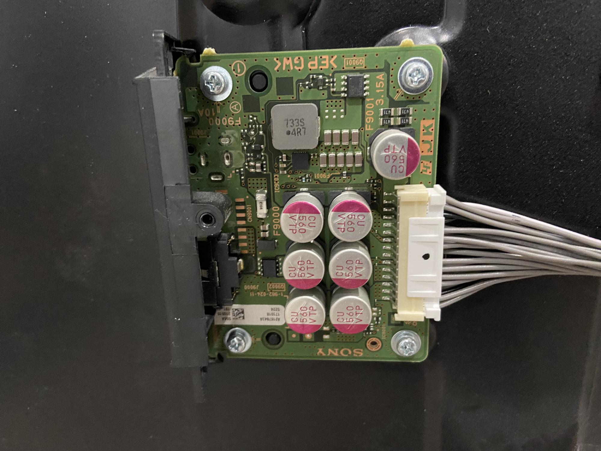

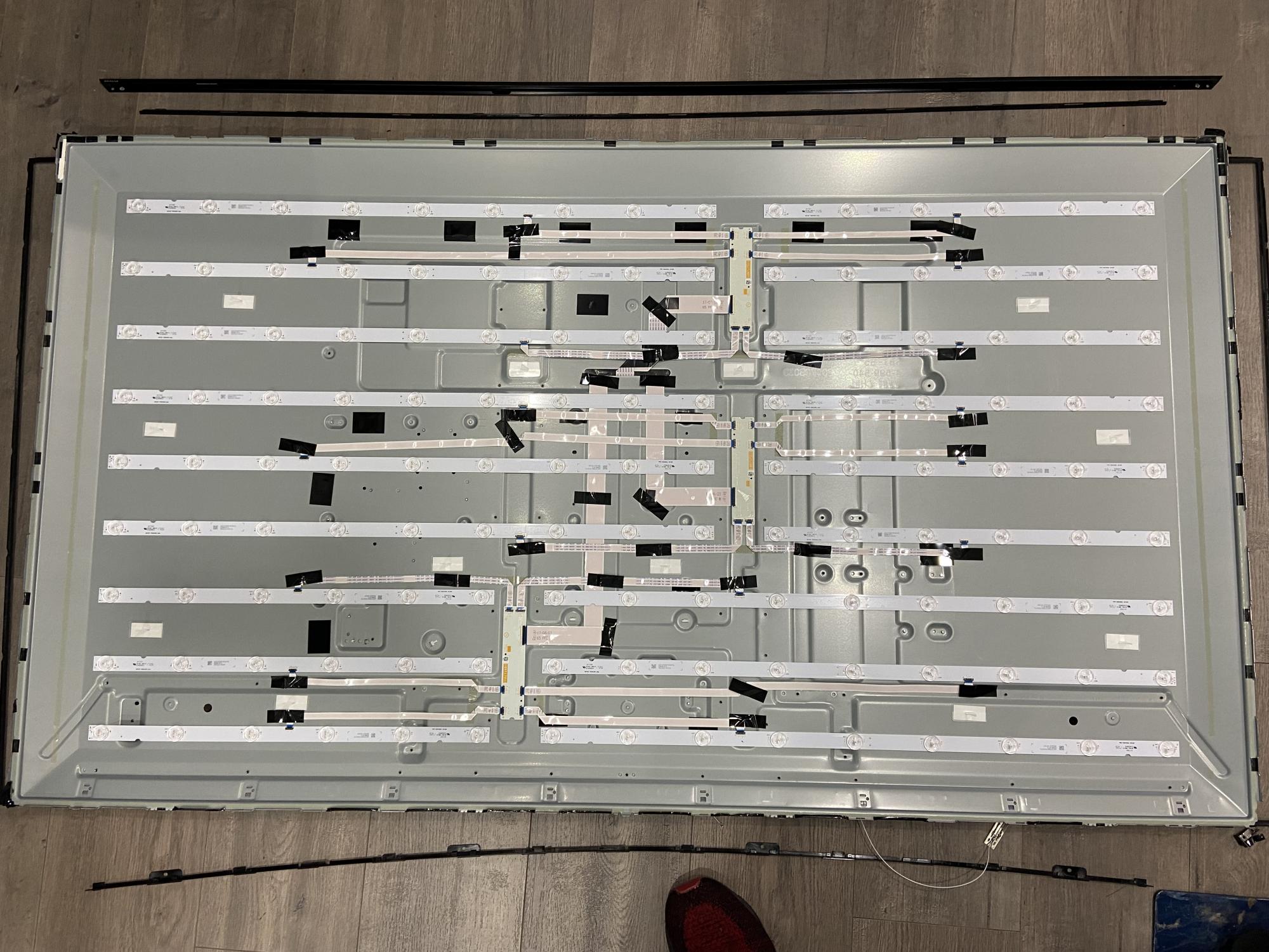

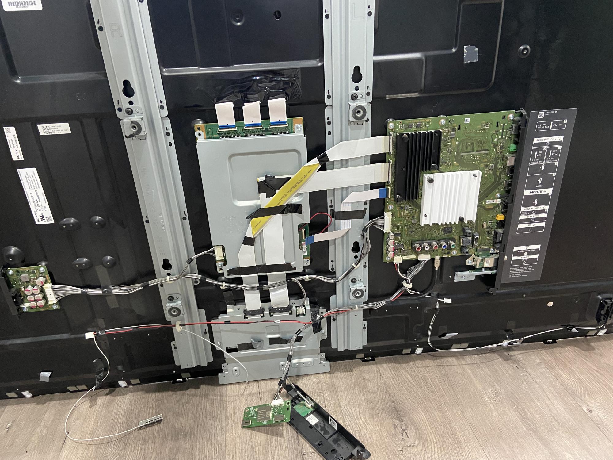

                    Sorry for the delay. Life got in the way.
                    Here are pics of the led array and back of the tv with the boards.
                    Also I made some progress and found to e bad leds as mentioned above.
                    If you unplug the LV board I think it is. Then plug the tv in it does a test pattern with the leds.
                    I found 3 out under load.
                    These leds measure 11.9v, Essentially 12v.
                    Where to buy single 12v led to replace just the bad ones?

                      Nice work, I see you have 9 rows, my XBR-65X900C is edge lit from the bottom, only one edge too, wouldn't think there would be that much difference with only the last letter in the model different.

                        Yes, it’s a if difference between the 2. But whatever engineer designed this thing should be fired.

                            Why do you tell this? It's not a normal back light is a local dimming , it's for a better lighting.. how it works the test pattern? it is tested each led at a time and 3 doesn't light up? since the capacitors for the output are 63v i guess not only a led is fed at a time.. 12v per led means them are chip leds with 4 leds inside.. this is strange.. no idea why..

                              The test pattern lights up a few rows vertically and then alternate the other rows. I’m guessing to verify the local dimming feature works, then Lights up all leds. If they all work it stays lit.
                              Update I wired in 4 leds (3v each for total of 12v) to fix the backlight issue as a temp solution and the lights now work and stay lit during test. Sadly It still cuts off and blinks 4 red lights after reconnecting the LD board to the main board.
                              I’m beginning to think it may be main board issue now.

                                maybe also make sure the proper voltage is leaving the dps board like Nick here on this 930D, not same model but same concept: https://www.youtube.com/watch?v=kaCl8J1pPd8

                                  Update. Tv is fixed. Had to replace all the led strips.
                                  I installed temporary leds where the bad ones were to test and it lit up and passed Sonys test mode but it still didn’t work when powered on. Very strange but Sonys backlights are very sensitive and need exact volt/amps to work properly it appears.
