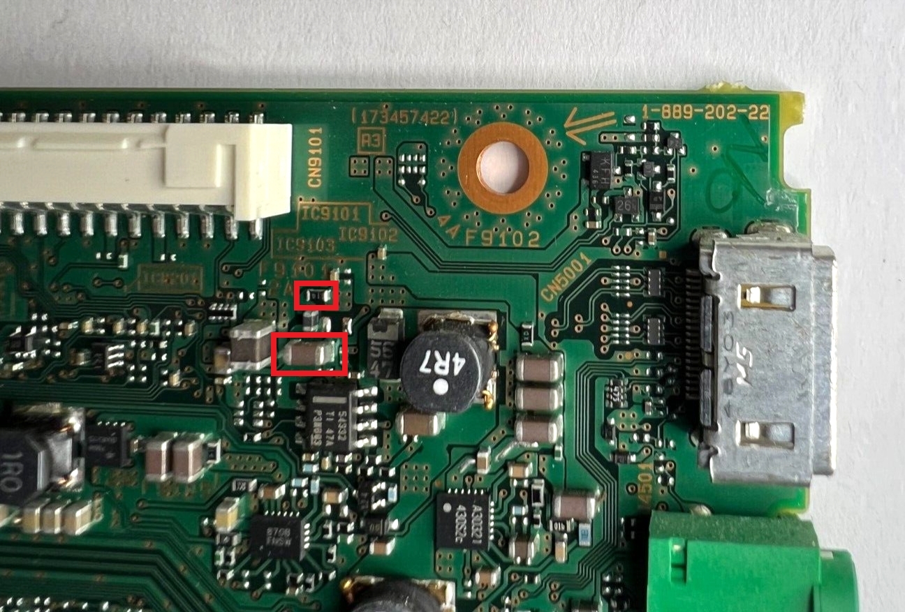

    Sony RB2G Chassis KDL-55W815B MAIN BOARD 2 Blink Error issue resolved! Happy days :)
    For anyone interested just repaired this Sony Main board TV that had a 2 blink error code, the chassis is a RB2G which is common to quite a few different Sony models. The Ceramic 10uF 25V X7R 1206 capacitor C9114 was shorted which took the smd 2A 0603 fuse out F9101. This was powering the Buck converter TPS54332 which caused no 5V output from it.
    See the attached picture of the locations of both components. I also attach the best service manual I found for this board for anyone else in a similar position of trying to repair this main board. It's not specific to the TV model however it gives far more schematics compared to all the others I found.
    Happy New Year
    Good luck with your repairs
