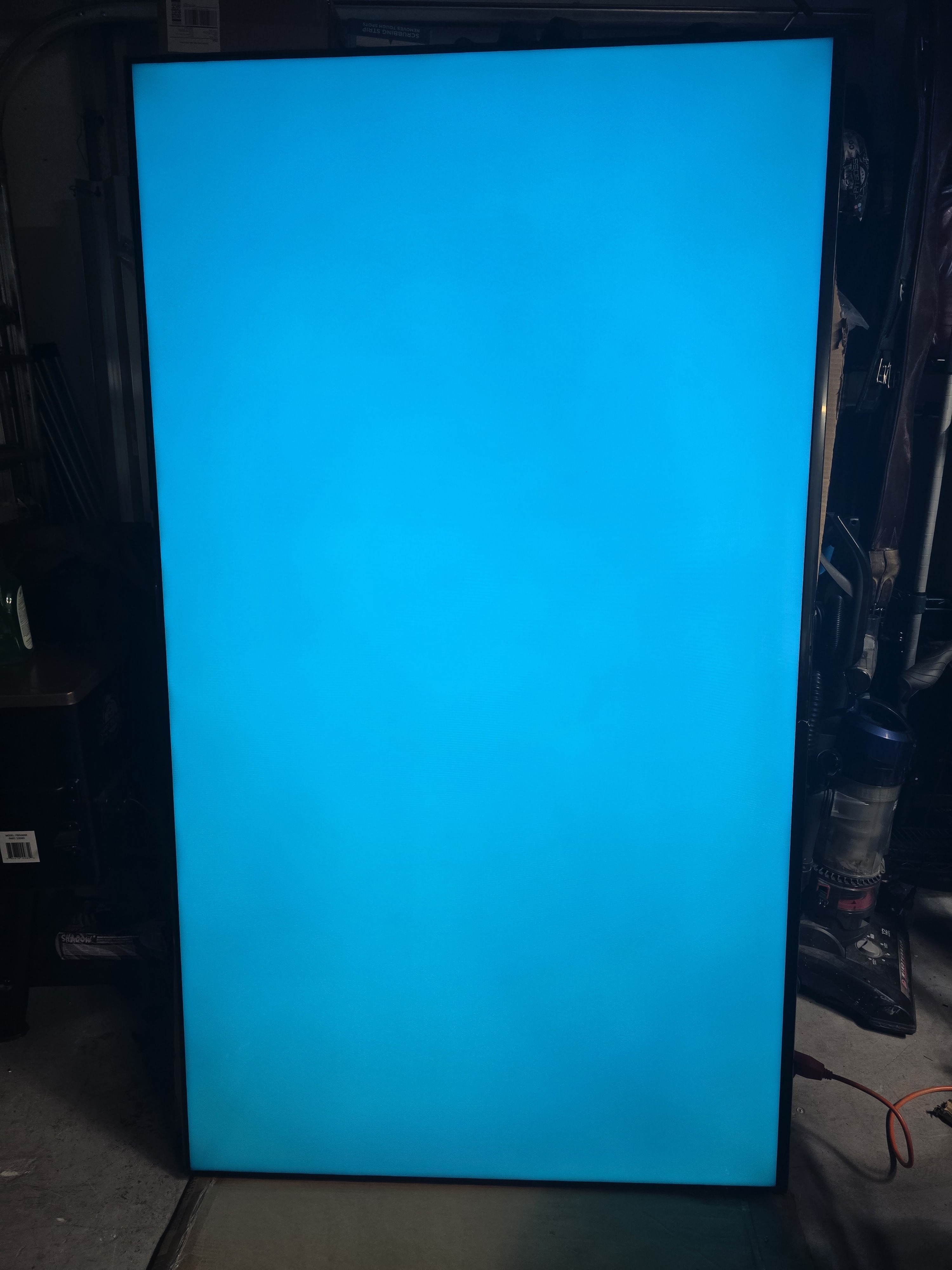

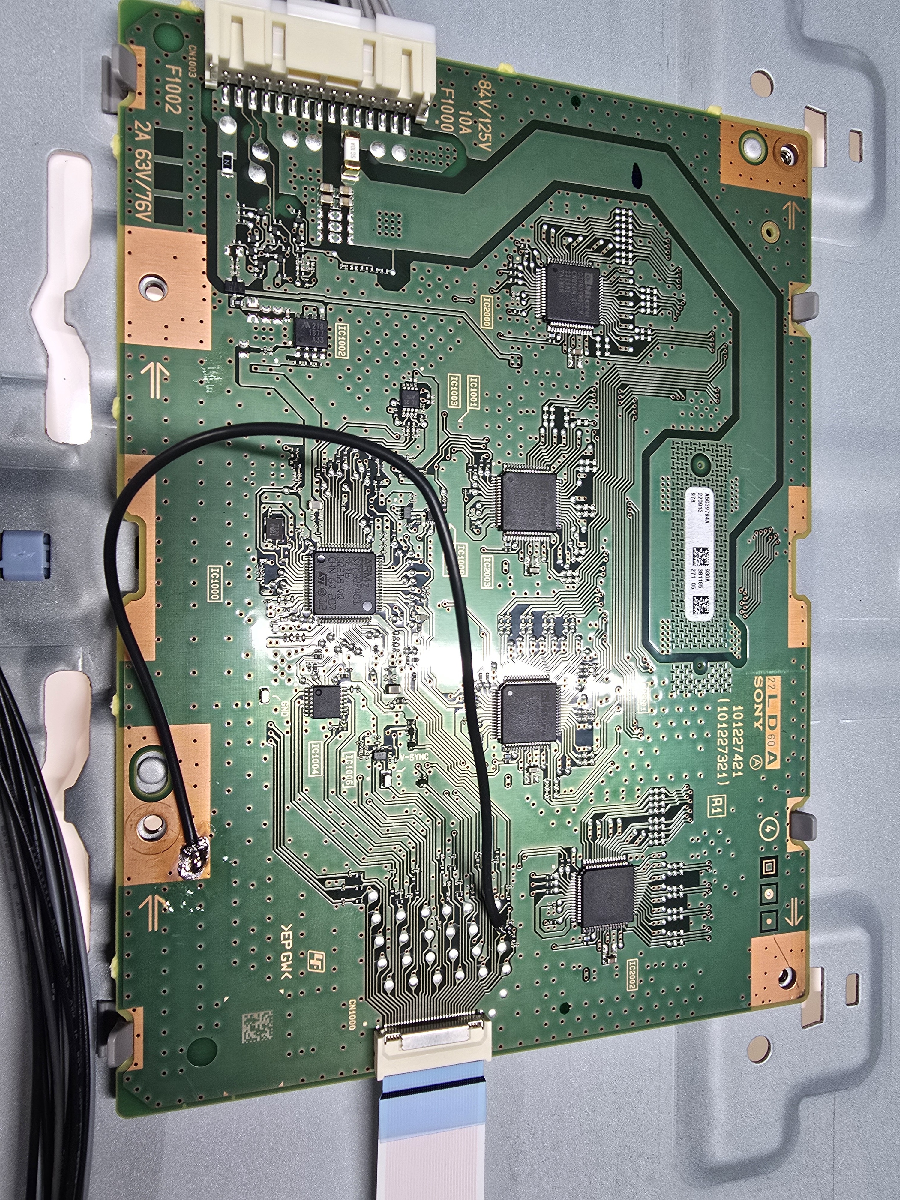

    Sony 85x90CK 4 red blink
    So I got this Sony and purchased it working.. got it home and it was 4 blinks red. Seller actually refunded me thankfully. Now it's massive to take apart and I know 4 blink can be the panel sometimes but not always..
    But I found a method through other ways with grounding out the bl error pin on the LD driver board. Now the tv turns on and works.
    Pin is number 27. It was either remove the resistor right next to the solder pad or solder the pad to ground. I soldered the pad.
    Now what is this going to do to the tv? Is it just going to die shortly down the road? Would it be ethical to sell this? Anyone have a clue.

    No, I wouldn't resell it, not really even sure if it's going to be safe to operate being that the bypass is eliminating a safety feature. Most of the time when the ground-out bypass works, it's bad backlights or backlight circuit. But I've also read and suspect that the protection circuits are way too sensitive in a lot of sonys.

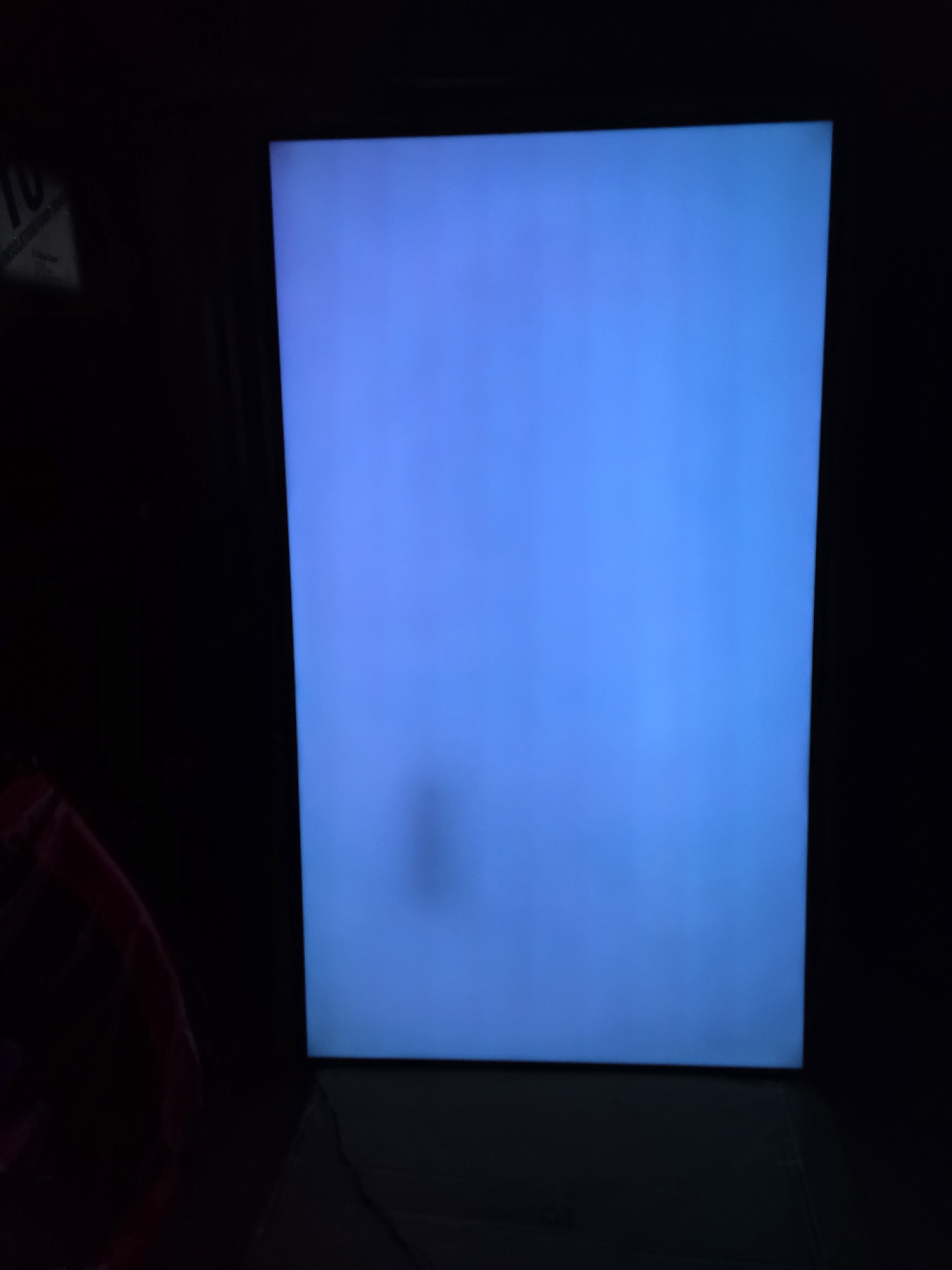

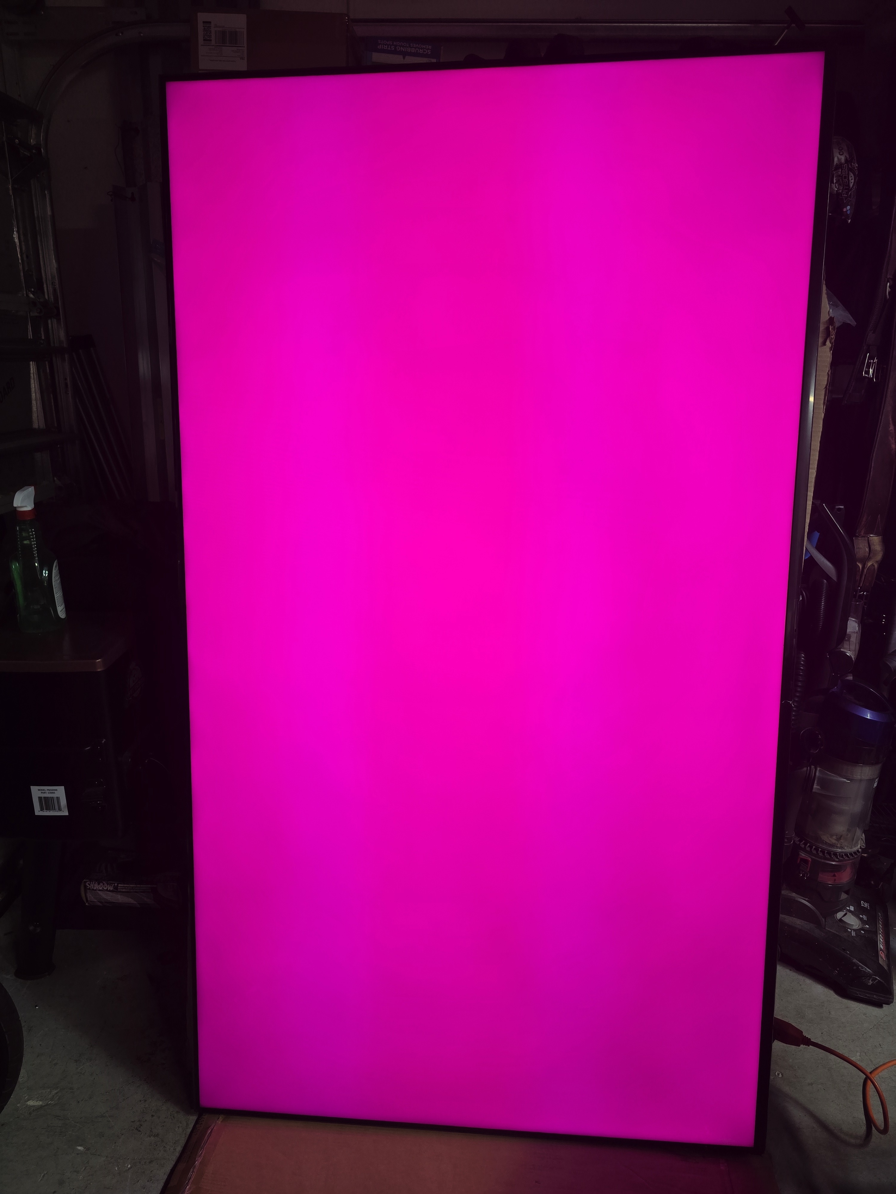

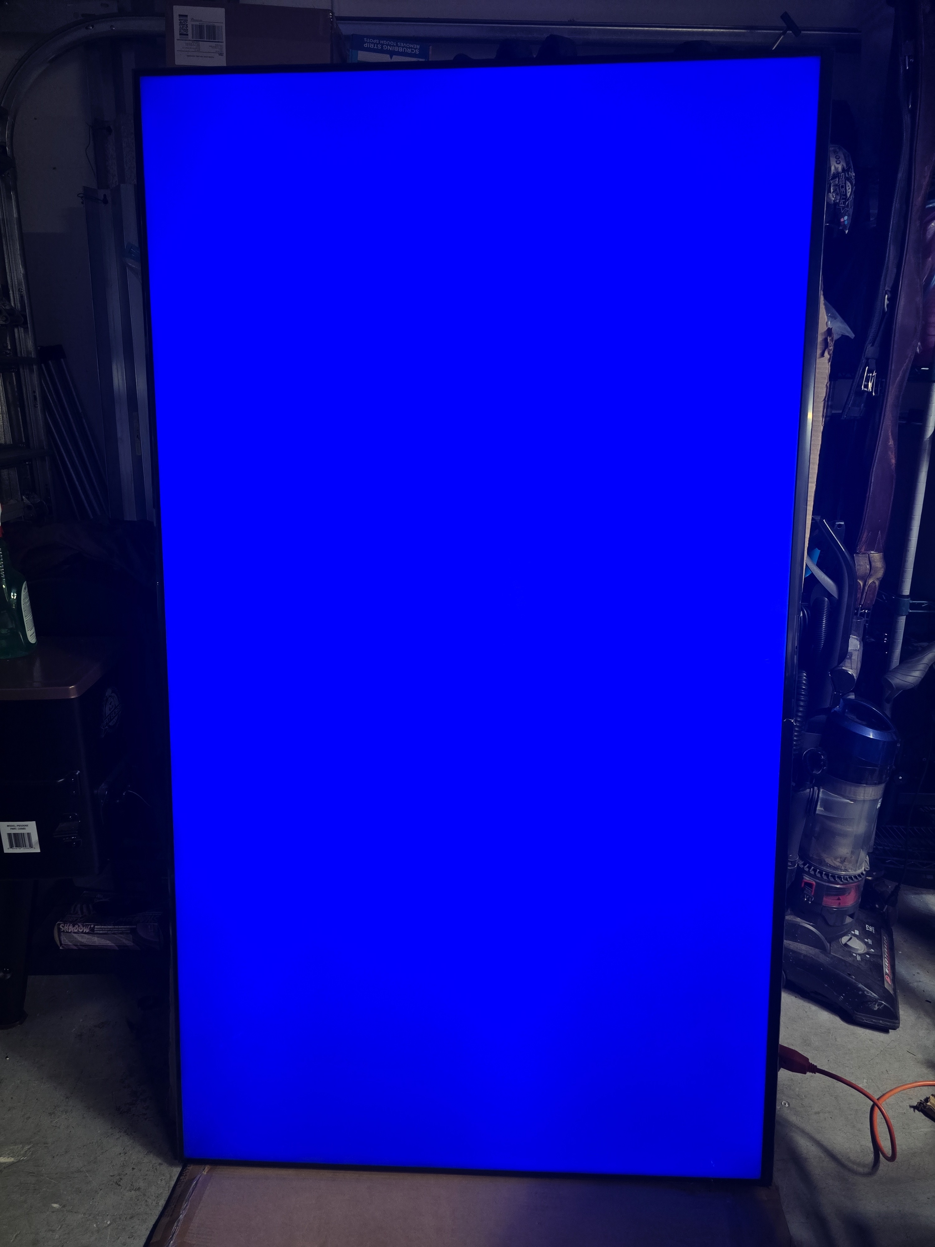

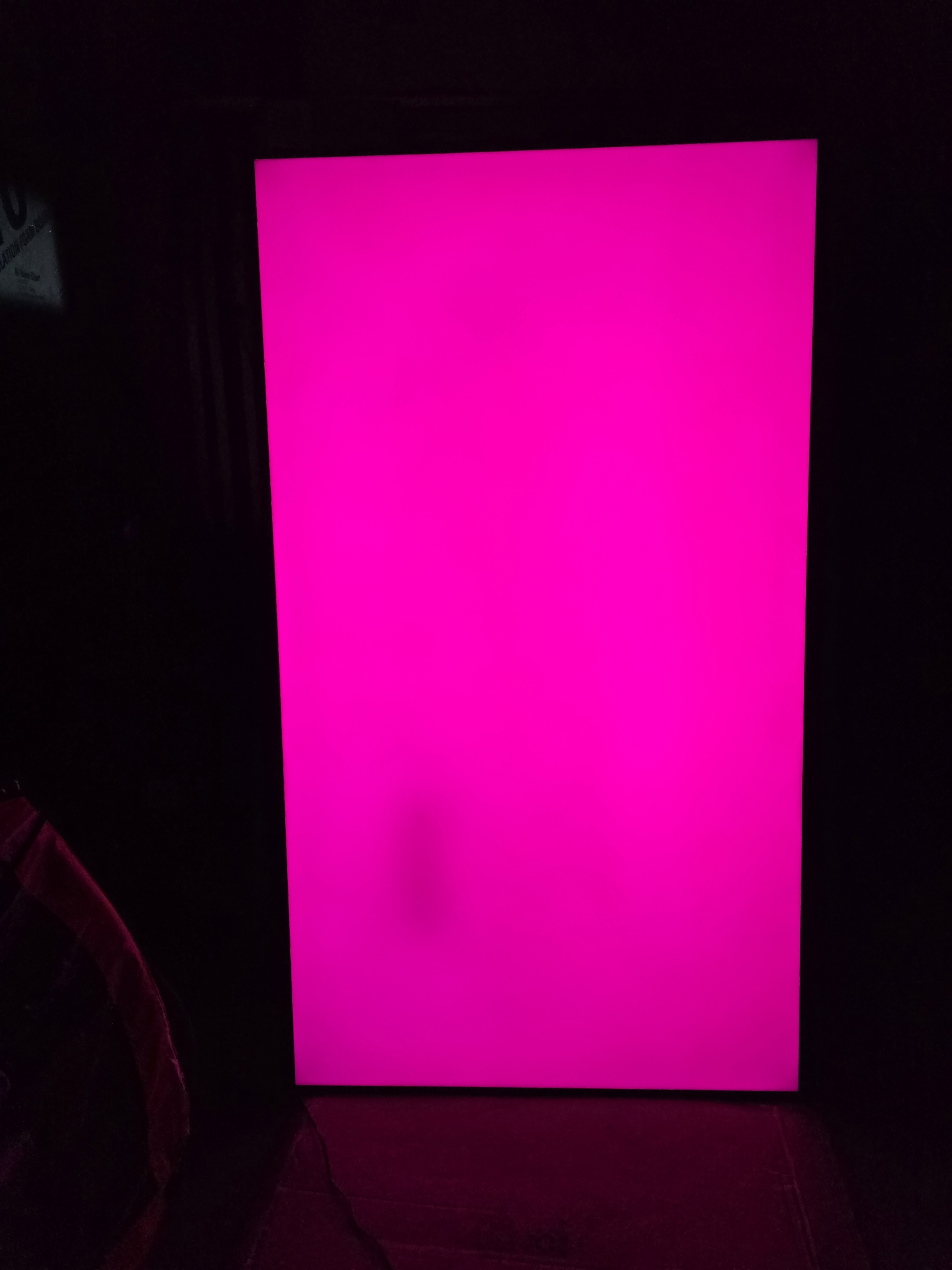

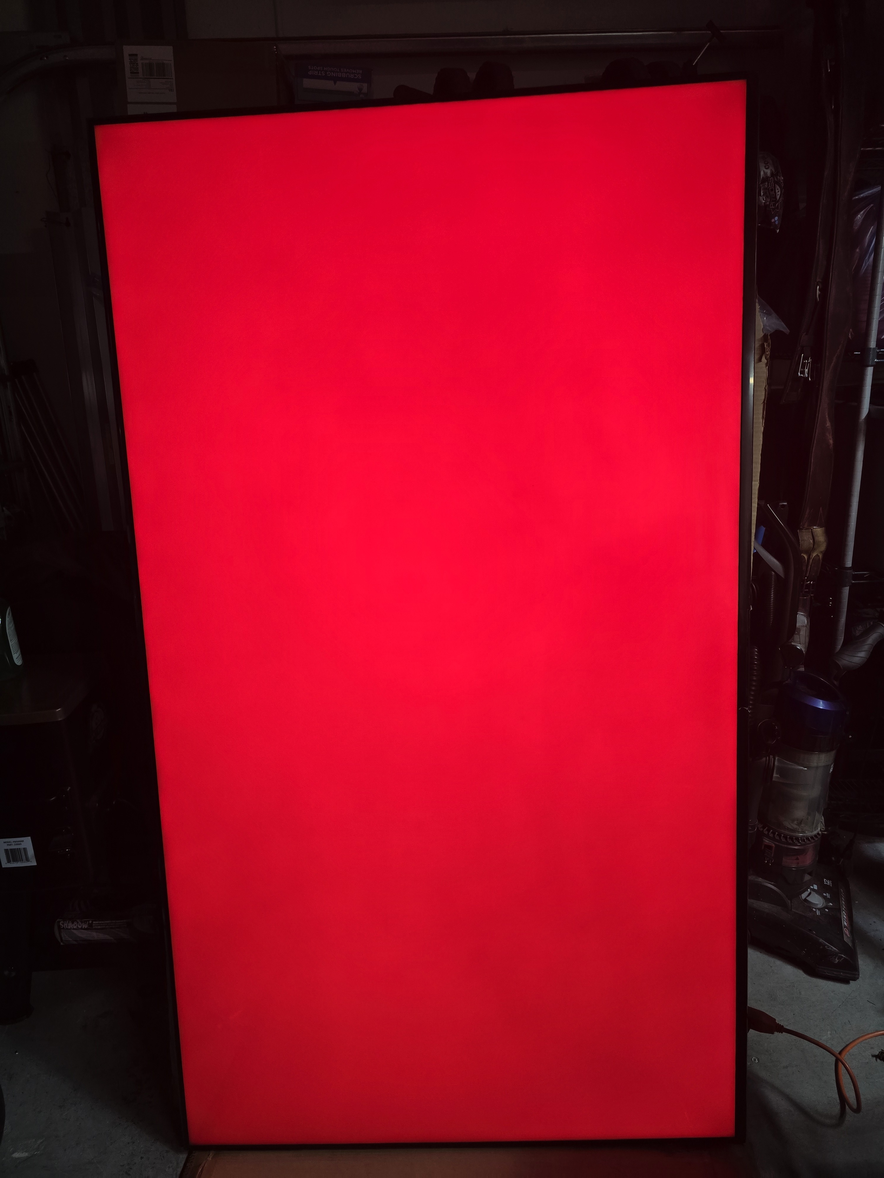

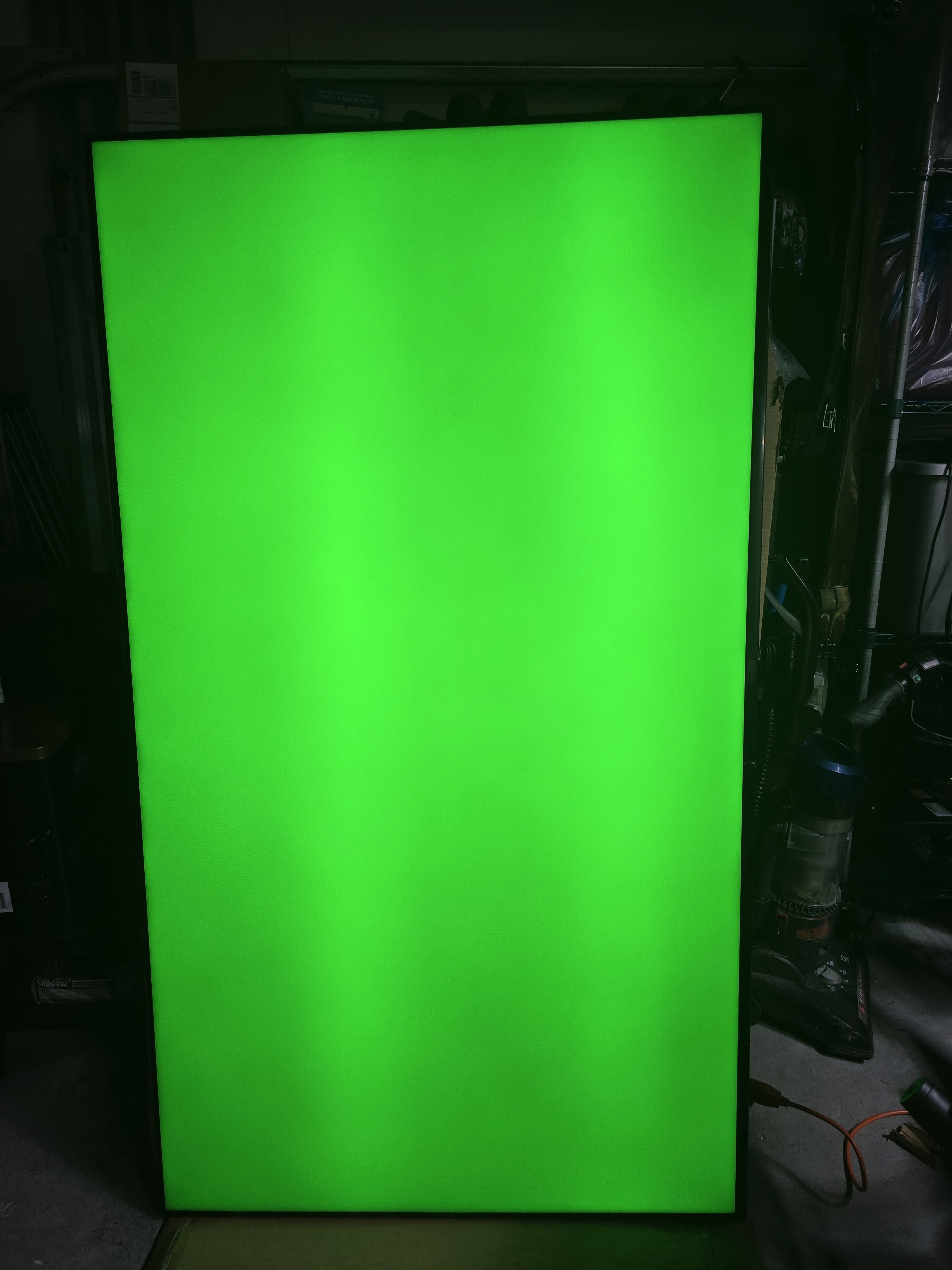

      So it at least helped me to know that the backlights are out. The TV now stays on longer then 15-20 seconds now. And because I couldn't really test the LEDs without taking it apart and .. let's face it this things 85 inches and expensive LEDs .
      So turned on screen test and can see visable black spot where LED or LEDs are out. Looks like I need some new leds to fix it.
      I'm sure someone who doesn't need to replace the LEDs can get some more life out of it doing what I did for personal use but I can't sell this until it's fixed now that I know the definite issue.
      Good tool to diagnose though.

                  It's a FALD tv so normal rule "if one LED failed, probably other ones will fail soon too" isn't correct. Since it dims, turns on and off different segments regarding to picture on tv, other leds are probably fine. This segment could have died just because one LED was fault. Or because it was at 100% backlight all the time and at that part of the screen there was something that needed to be bright. Or maybe it was demo set and was working 12 hours a day on vivid mode again with 100% backlight.
                  Sony uses high quality parts, so there is small chance for another failure. At least not so soon. That's just my opinion.
                  I've grounded alot of BL_ERR like that and it's been a few years and people still don't complain. Heck, even I use one KD-65XG9505 like that.
                  I wouldn't call it a safety feature either since LD board turns on/off each segmets invidually, so LEDs are not connected in series and there is no voltage or current rising on other LEDs.
                  I'd continue to use it like that, it could last for years, and that is too big of a screen to risk breaking it

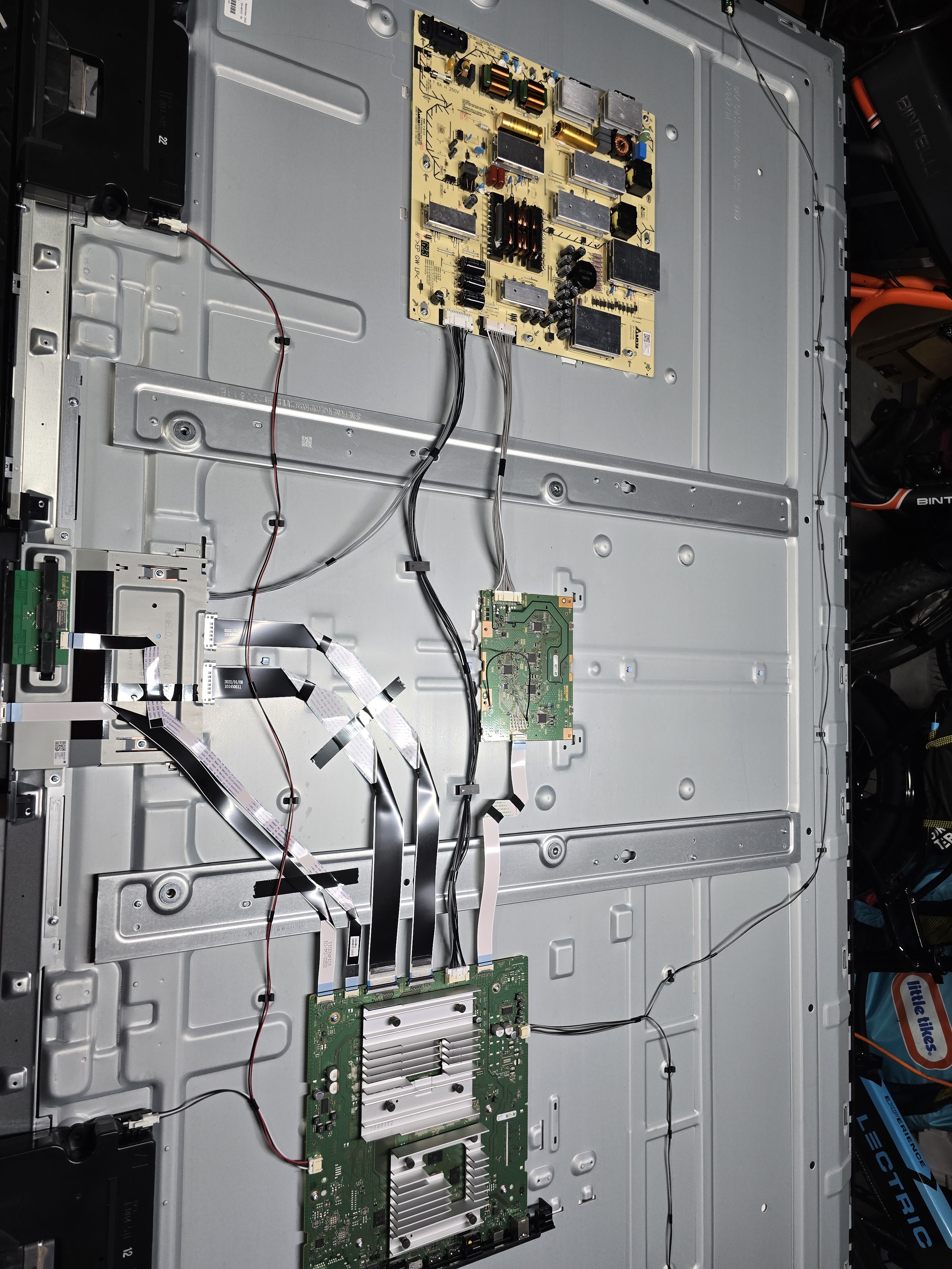

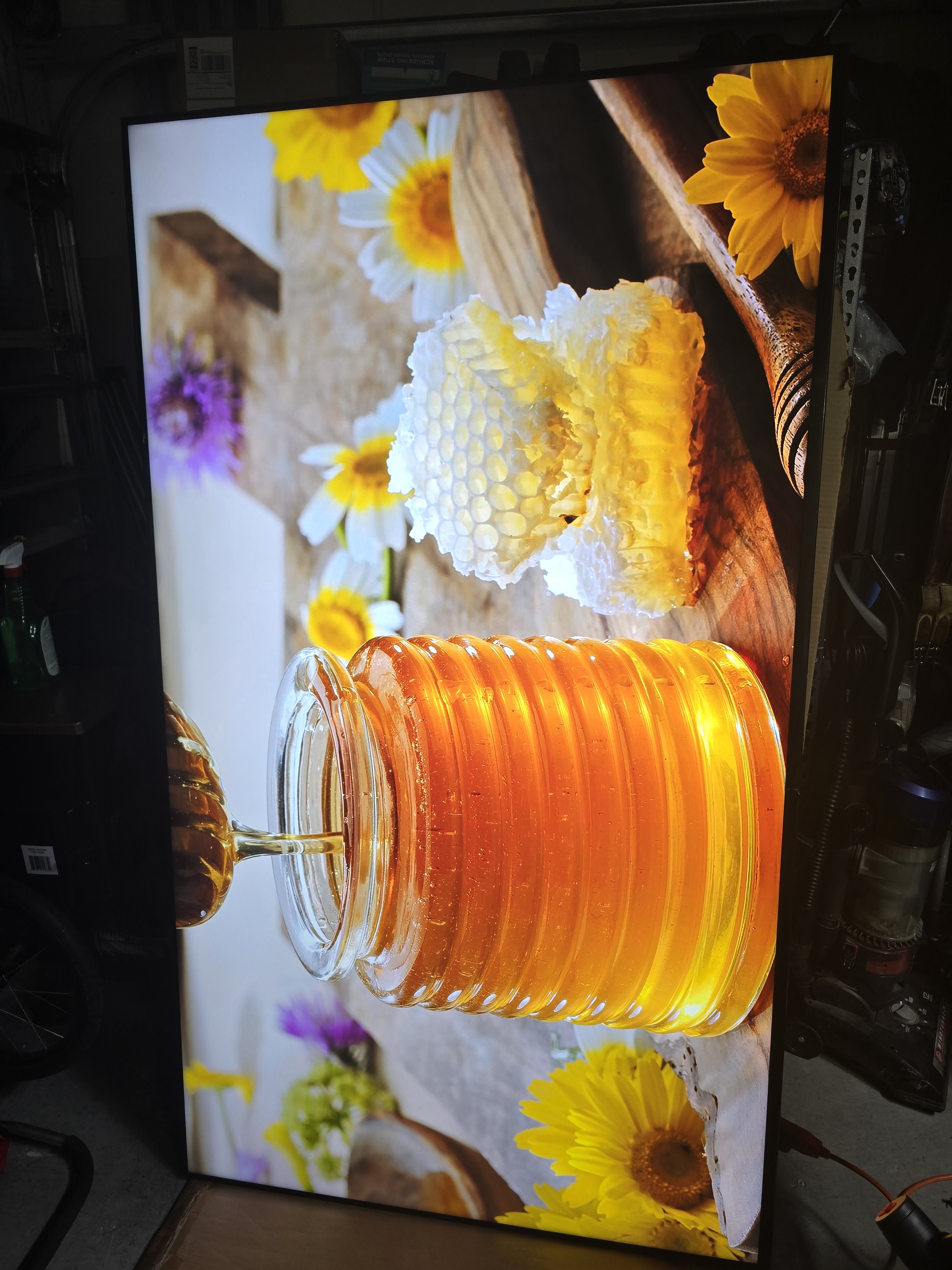

                                    TV really is pretty nice. Good brightness and color.
                                    All fixed up. Serious pain in the butt to get the frame/panel off but it came off
