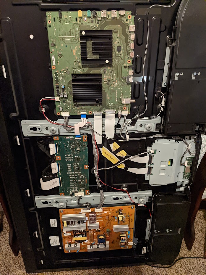

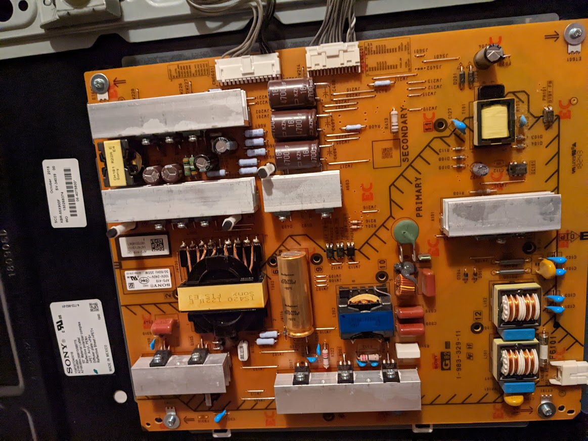

    if you have a multimeter and want to test it, test voltages at cn6401, what is the voltage of bl-error and list any others that do not match the map/legend next to it.
    • nomoresonys
      • Jan 2013
      • 12306
      • U.S.
      Re: Sony XBR-65X900E 4 Blink Code
      testing procedure there if needed, as always be very careful what you touch on the powerboard, there is some potentially DEADLY voltage on the hot/primary side: https://www.youtube.com/watch?v=XH9GfkGQX1I
      • my2k2zx2
        • Jan 2023
        • 20
        I unhooked the boards and do not see any failed capacitors or burn marks anywhere. Plugging the boards back in did not change anything, still 4 red flashes.
        CN6401 voltage all seem to match the legend when the tv is powering on.
        bl_err is at 0.028v when the tv is powering on, but then goes to 0.003v when the red light flashing 4 times.

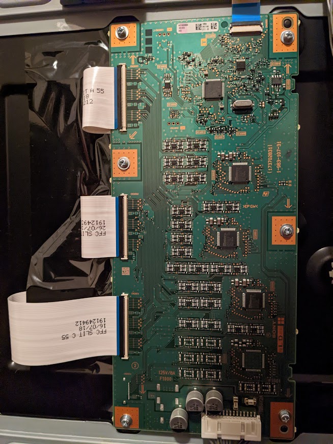

            can also test those little mlc caps on the ld/led driver board, see if any test short, can put a probe on each end or put neg. probe on chassis ground and pos. probe on each end, one side will have continuity, beep if you have a meter that beeps and the other side will show a reading or not beep if ok.
            • my2k2zx2
              • Jan 2023
              • 20
              Where would I check for the led driver voltage? I only see a flat ribbon connecting it to the main board.
              No shorts on the capacitors on the led board.

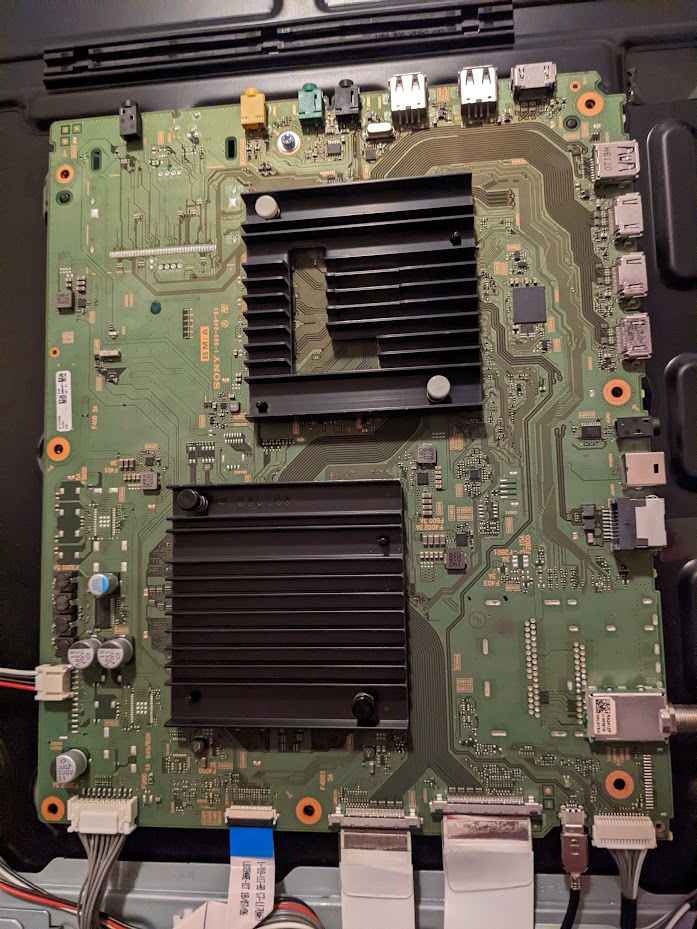

                          check all the little mlc capacitors on the mainboard, none should read short.
                          • my2k2zx2
                            • Jan 2023
                            • 20
                            #33

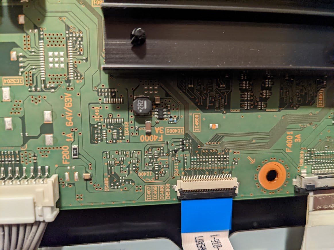

                            The part 2R2 and the cap to the right of it beep to ground on both sides on my multimeter.
                            Everything else on the mainboard only beeps on one side.
                            • nomoresonys
                              • Jan 2013
                              • 12306
                              • U.S.
                              #34
                              ok, I think you have found the problem, I'm no expert, some may have better advice, I think I would take the cap off and see if it reads short out of circuit.

                                You have a short circuit on this capacitor or just a low resistance (how many Om?) And if it were short, the F4000 (3A) fuse would blow.

                                  forgot to mention to have the other boards disconnected from mainboard while testing those caps so its isolated and no potential errors are coming from the other boards.
                                  • my2k2zx2
                                    • Jan 2023
                                    • 20
                                    #37
                                    2R2 is 4 ohm on one side, OL on the other.
                                    the little cap is 4 ohm on one side and 0.4 ohm on the other.
                                    The main board is not connected to anything.
                                    • nomoresonys
                                      • Jan 2013
                                      • 12306
                                      • U.S.
                                      #38
                                      yep, that 4 ohms seems way low, probably something making it read that way, is that fuse ok? the fuses are tiny on my board, there's probably a few on the board, check it for continuity, a fuse that reads short is a good fuse.
                                      • lotas
                                        • Jan 2016
                                        • 4802
                                        • Russia
                                        #39
                                        2R2 is a coil (inductor) it should show the same resistance on both sides.
                                        • my2k2zx2
                                          • Jan 2023
                                          • 20
                                          #40
                                          the part by the F4000 wording does not beep when I put the probes on both sides of it.
