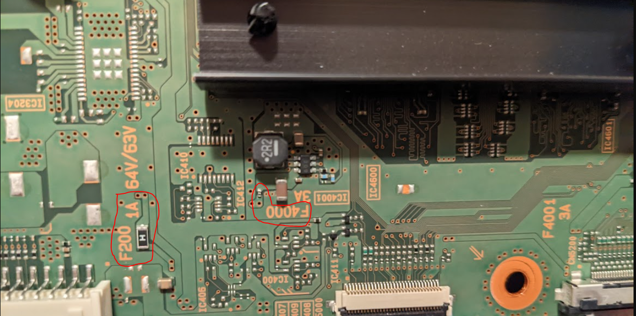

      I looked at a similar board over and I see several places that are labeled fuses but I'll be damned if I can tell where they are, I know some will have a label but just not be included in a particular design.

                #47
                Re: Sony XBR-65X900E 4 Blink Code
                The fuses are in the photo, the motherboard has nothing to do with error 4 associated with the LCD Panel ...

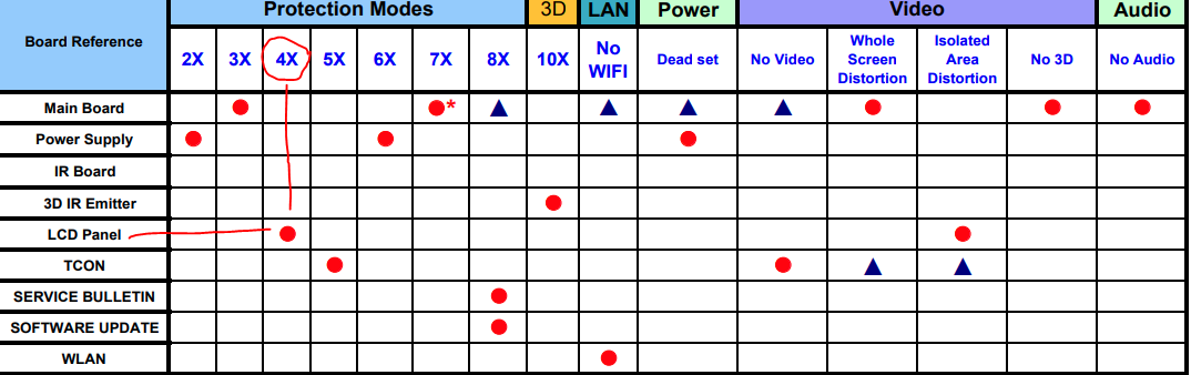

                  The circled fuses are not blown.
                  So the above chart is showing 4 red flashes means the panel itself is the issue?

                    #49
                    This is everything related to the panel, backlight (leds), led driver, power led driver...
                    There is a problem with the panel or with the T-con, then the error would be "5".
                      I think it’s backlight related. Unplug the blue tabbed cable from the main board and plug the tv in. It will do a backlight test and if it the leds are good the leds will stay lit

                                      #58
                                      Well whats the answer then, storyteller just said if the backlights stay on they are ok and they stayed on.
                                      The answer is this - the protection of the led backlight is turned off and the processor thinks that everything is in order with the backlight.
