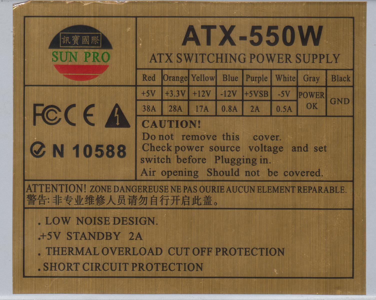

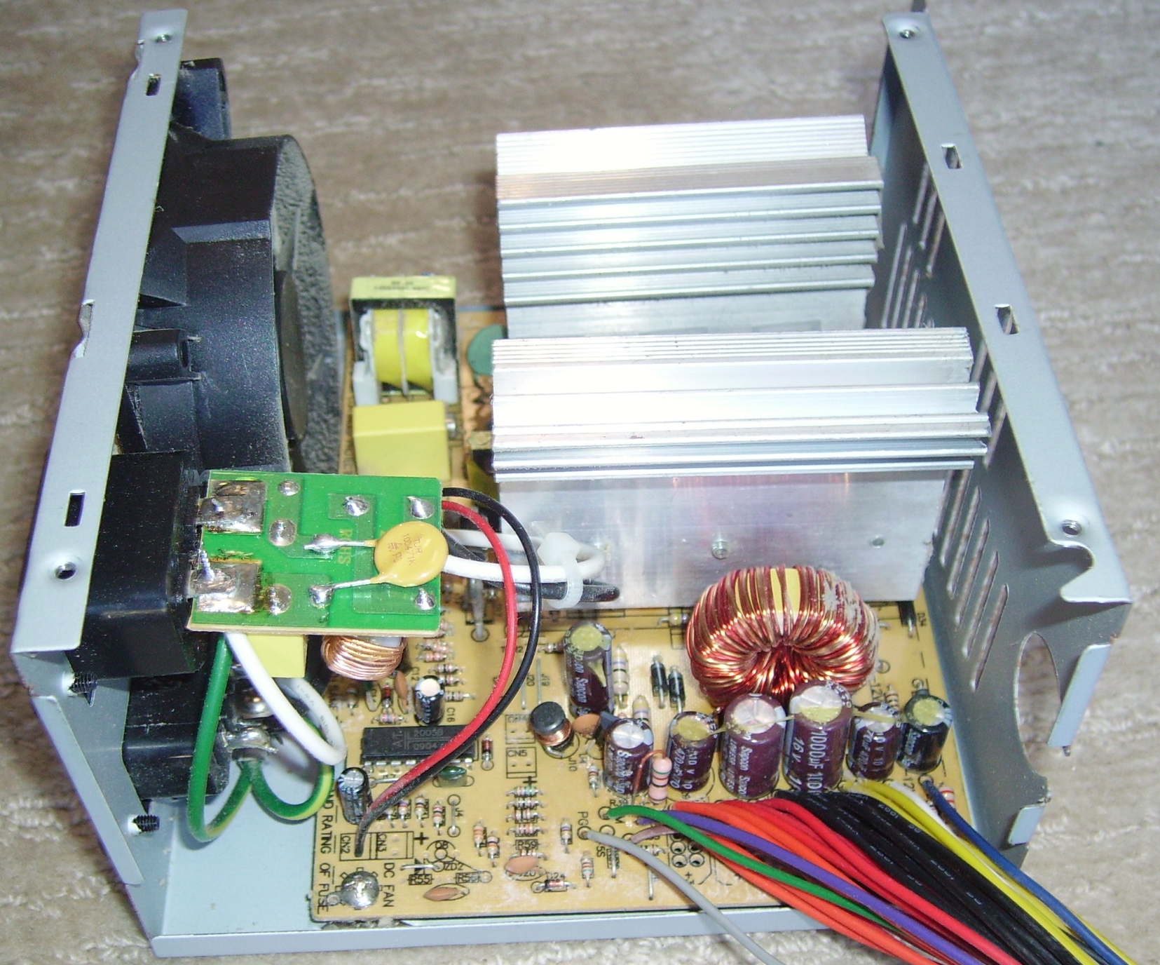

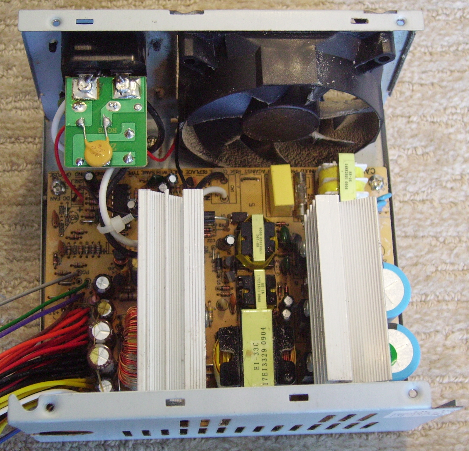

          #164
          Re: the gutless, bloated, and fried power supply hall of shame
          Another cheap Sun Pro. At lest thios one does use DC-DC conversion from the 5V rail to generate the 3.3V. However, it still never managed more than about 73% efficiency on 230V at about 250W Load. I doubt it would even manage 70% in the US. At 350W, the efficiency was about 68% and it exploded after a few minutes.

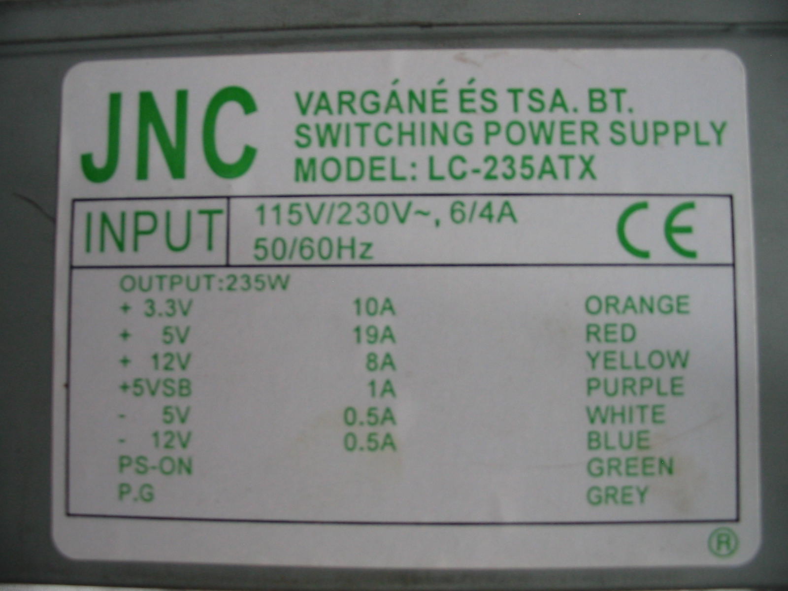

                      #170
                      Originally posted by momaka
                      How is this for gutless and fried?
                      https://www.badcaps.net/forum/attach...1&d=1334112631
                      Okay, I'll come clean - the PSU didn't come that stripped down (obviously ). This used to power my family's 400MHz Pentium II PC back in 1999-2001. The model number on the label will fool you that this in an L&C, but it's not (most likely J&C just labeled it as such). It actually used to look exactly like these (save for the different cap brands on mine)
                      https://www.badcaps.net/forum/showth...ighlight=m-tec
                      https://www.badcaps.net/forum/showthread.php?t=1178 (see post #1)
                      Seems to go also by the names of M-tec, Meico, and Frontier.
                      As you can see, even without me removing the components, it's a very crappy power supply. Fortunately, it was pretty good desoldering practice for me a few years back. Also, the components I took out of it helped me save a 17" CRT monitor, a 250W HiPro PSU, and a few other things. Will soon be using one of the schottky diodes from it to make the 12V rail of a 250W Bestec 12Z a little beefier.
                      Oh my... How did I miss this. The famous "Mrs. Varga and Co." psu. I just gutted one today to get the fuse and mag-amp choke.
