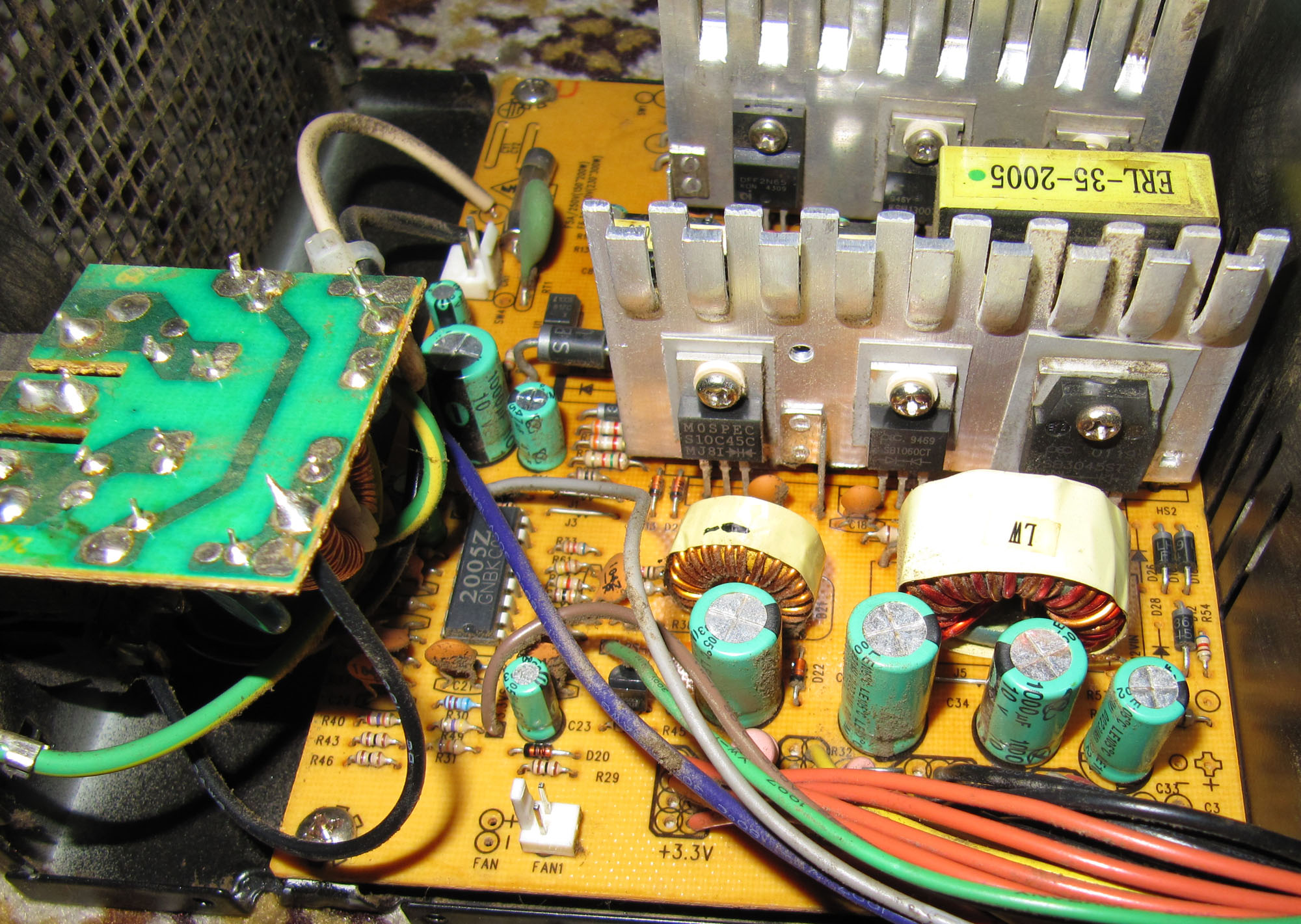

              Re: the gutless, bloated, and fried power supply hall of shame
              Premier DR-8460BTX
              SB3045ST @ 5V
              SB1060CT @ 12V
              S10C45C @ 3.3V
              2x 13007 transistors
              33 sized transformer
              2x 330uF 200V ANODIA caps
              2N65 for 5vsb
              4 diode treatment for AC rectification
              Incomplete EMI input filter
              Tiny heatsinks
              1x1000uF for every important output
              Not a single coil for ripple filtering
              Tiny toroid coils
              Tiny parts everywhere
              But it works and none of the caps are bulging... The fan is moving at full speed. This thing was buried in dust and tobacco residue...

                ... And yet the label says the "dual" 12V rail can handle 14 + 16 Amps . Where the fuck do they see that at with a 10 Amp rectifier?
                At least they put a nice big label with bright red letters. Probably to warn users: "Warning! This PSU is dangerous!".
                2N65 for 5vsb
                Tiny heatsinks
                Typical Deer/L&C.
                Don't forget those big, low-resistance dummy load resistors on the output. I see the one for the 5V rail is 20 Ohms. Should keep the output caps nice and toasty.

                But it works...
                Typical Deer/L&C. x2
                I guess they are dependable PSUs - that is, you can always depend on them to kill your hardware.
                The case looks nice, though. Could be used to house the guts from another PSU if needed.

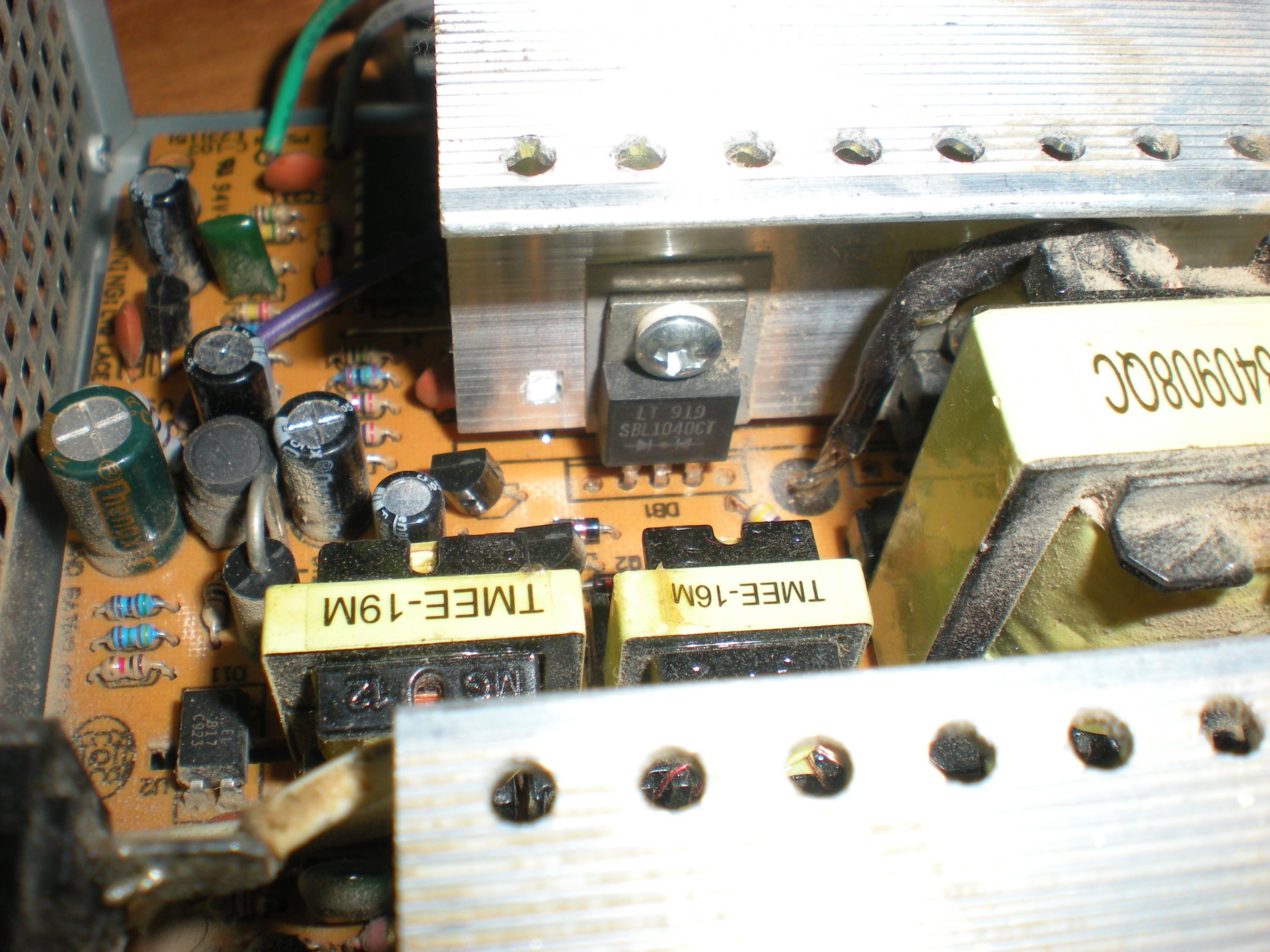

                      And here is a Micro ATX (SFX) 1.3 which came with a Deluxe case so im guessing the PSU is also made by them because there is no UL code.
                      All caps seem to be Chengx but at least they are rated 105degrees.
                      No heatshrink anywhere, a probably underpowered 10A schottky, the fuse is soldered directly to the board, but at least there seems to be a PWM IC CG8010DX16 supporting UVP/OVP

                        450W? For how many milliseconds?
                        PeteS in CA
                          Actually,that might be another 0W PSU,as there are absolutely no PI coils (or ANY SPACE printed on the PCB for them,let alone holes),thus it won't do a watt in spec. Good only for smashing.

                            I tried for the fun of it to hook up an 80W/12V bulb and the +12v rail showed 10.1V
                              It's +5V heavy, you should load the rail as well. At least couple amps.

                                  Well the same 80W bulb takes the 5V line down to 4.8v which is actually in the +/- 5% specs but i would not trust it hooked to a PC.
                                    Ay, that PSU is no good then - not for powering a computer anyways. Maybe okay for playing with LEDs or small motors that don't care about smooth voltage. After all, those caps on the output are indeed too small, as Dan81 pointed out.

                                        Well the point is to load both rails *at the same time*. Loading only one at a time is called crossload and group-designs don't like that. Group regulated units are even worse.

                                          Speaking more seriously, I've worked in power electronics for over 35 years. Those semiconductors, heatsinks, and magnetics are probably good for 200W continuous. The output noise would probably have horrible noise spikes (due to the lack of what you called "Pi coils"), and the conducted noise would probably be horrible, due to the lack of input inductors.
                                          But if loaded to 450W, its life would be minutes or even seconds. Those input rectifiers are probably not good for that much current; the MJE13007-clone transistors are not good for that much current (and their beta would probably be less than 5!); the heatsinks aren't adequate for that much heat dissipation, the transformer core might saturate, and the output rectifiers probably aren't good for that much current.
