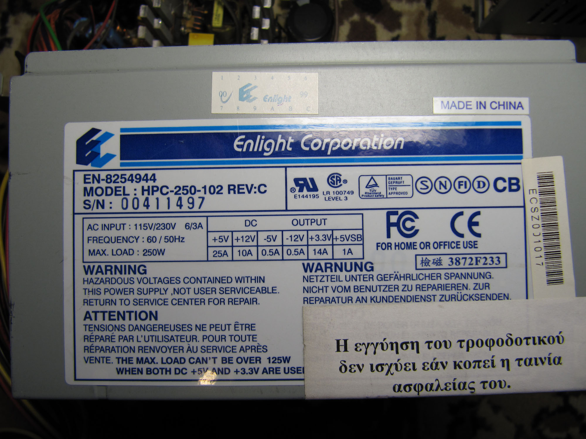

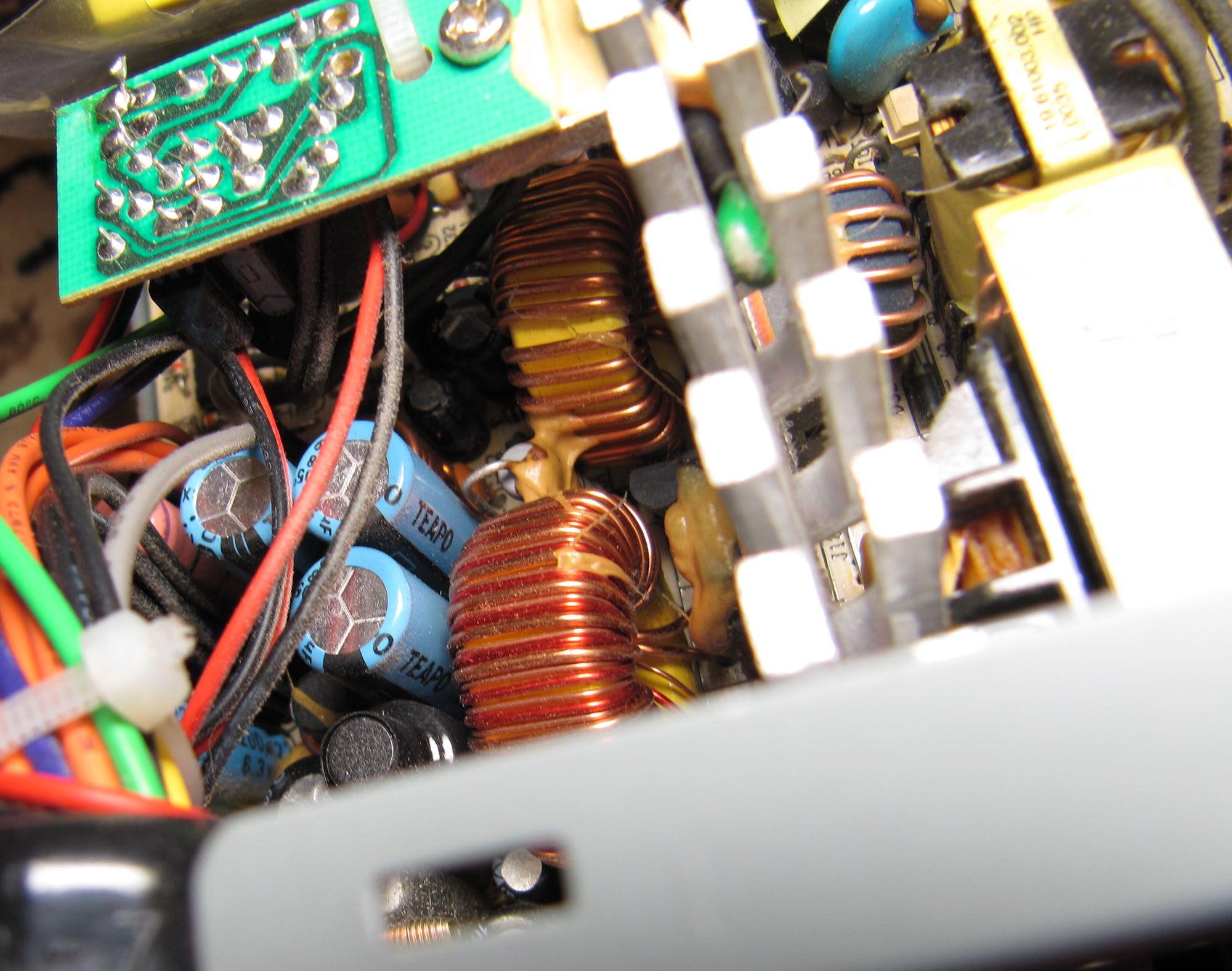

    Today I got 2 not working 250 watt enlight psus from the stuff to de thrown away at uni.
    The reason I got them is they have teapo primary caps and teapo secondary caps, so I was thinking I could use them as replacement caps since they are not bulging and teapo is known as a quite good capacitor brand for power supplies..
    Btw the 2 psus don't boot up but they provide 5vsb voltage normally.

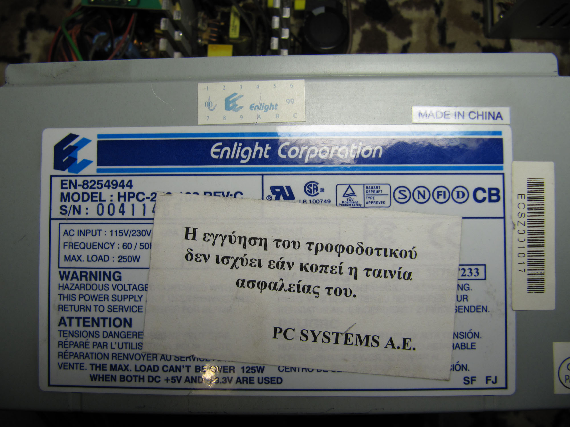

    Can you tell who is the manufacturer of these units?
    • 370forlife
      Large Marge
      • Aug 2008
      • 3113
      #122
      Sirtec (Sirfa)

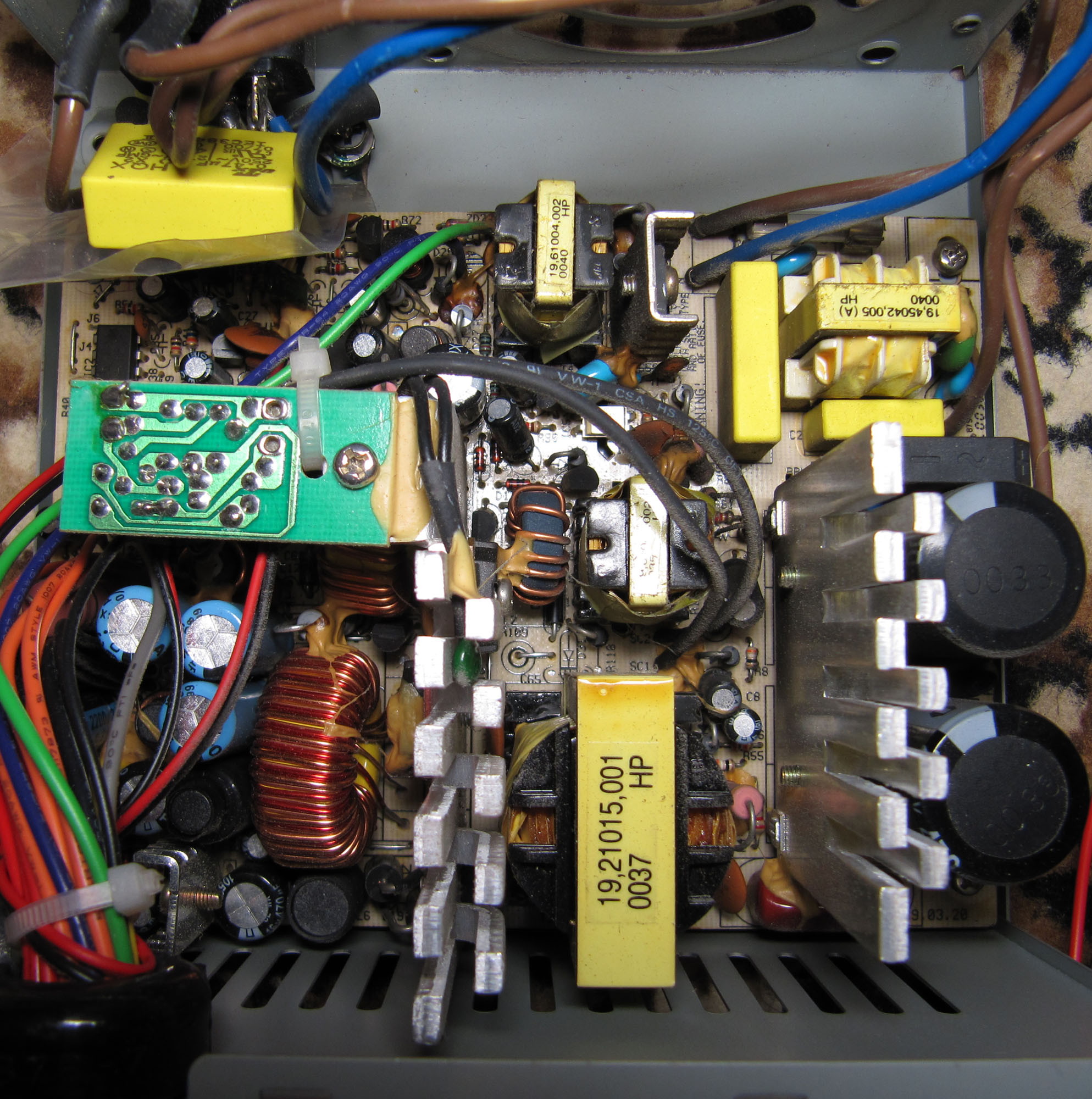

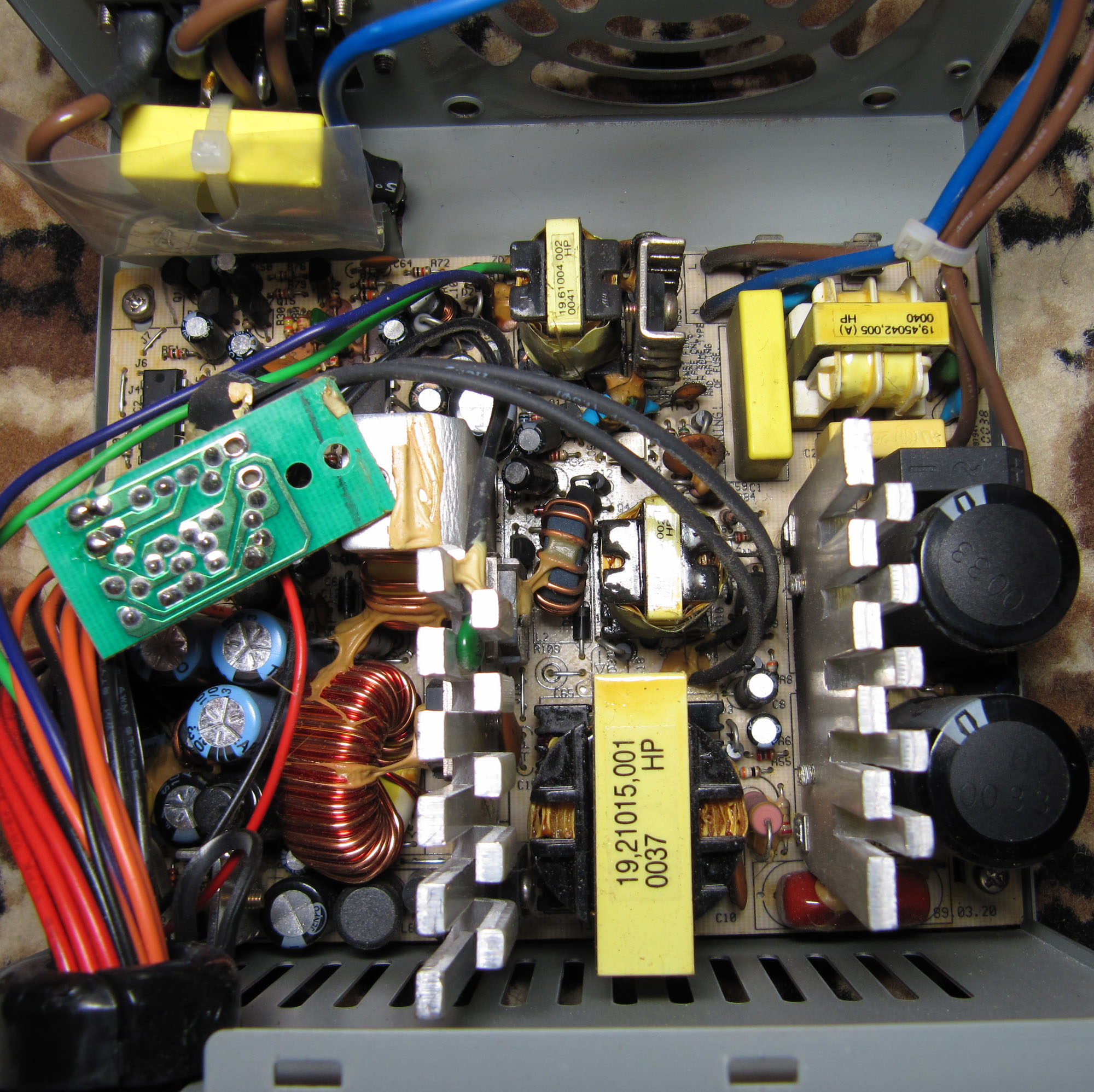

        #123

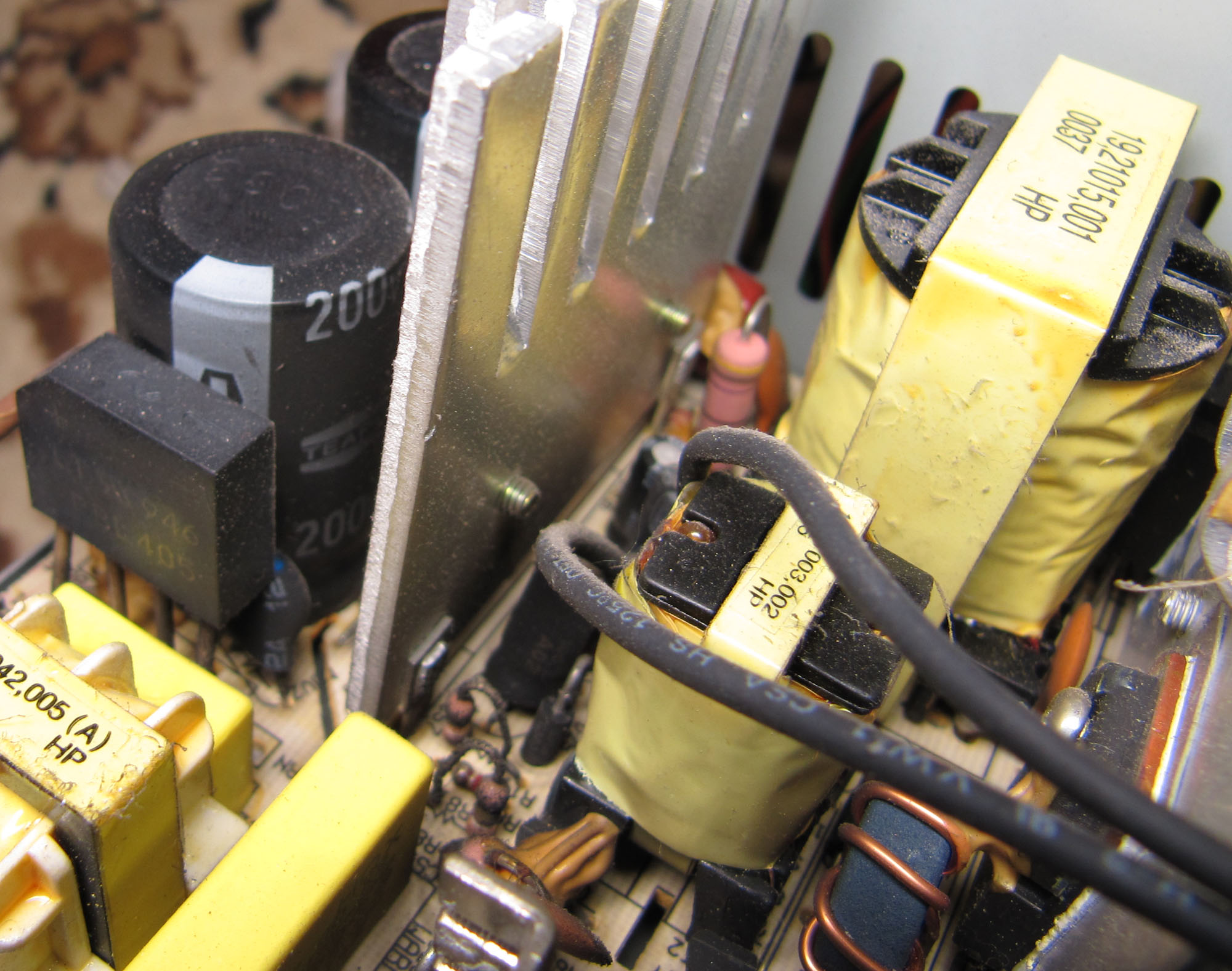

        They look well made...
        Is this the reason of failure (photo)?
        • i4004
          • Oct 2006
          • 2029
          #124
          doesn't the image show 5vstby section, the only portion that's actually working?
          you should see if 5v reaches the smps controller (ic) and if protection ic is latched into protecton, if it exists.
          ie find chips datasheets and check voltages...

            #125
            only thing wrong in that pic is that dammed brown glue all over it.

              #126
              yes, worker(with the glue) at the factory got some weird commands from superiors...hehe...
              result: messy psu.

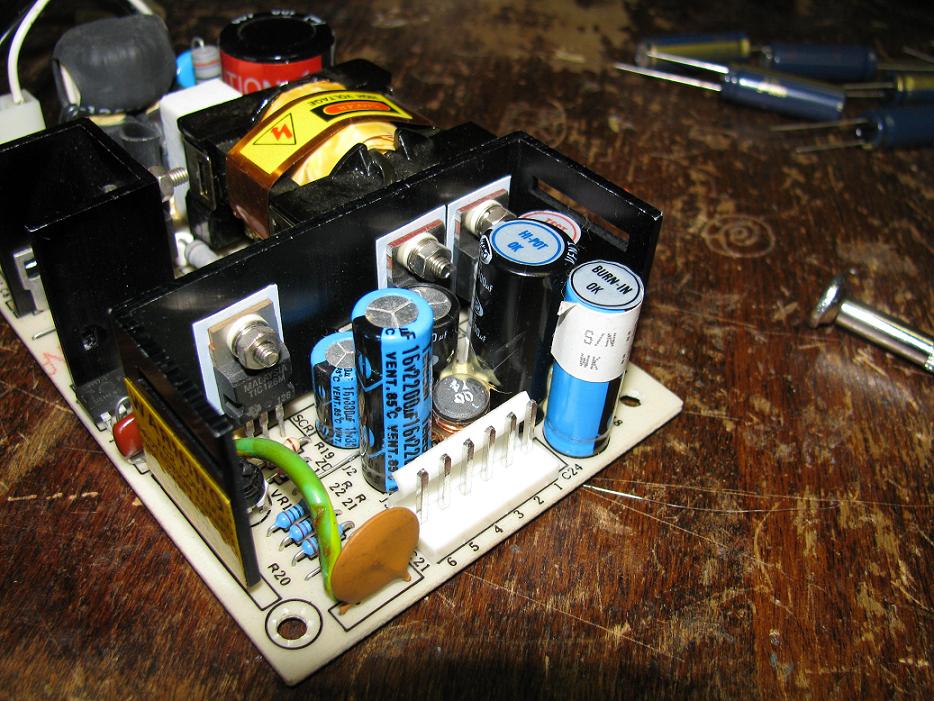

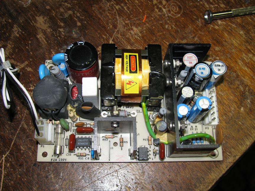

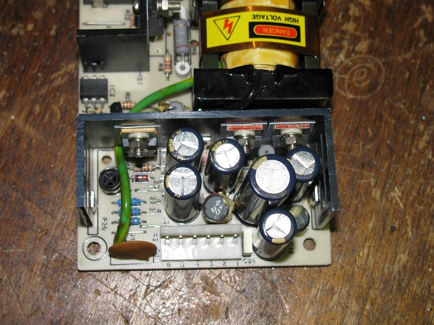

                                      FORTRON/SOURCE SU40P31
                                      out of an old tape drive, a sticker said it was made in week 22 of 1992...right about when my little brother was born
                                      here are the ratings:
                                      +5v - 3.0A
                                      +12v - 2.0A
                                      -12v - 0.3A
                                      Here's an overall shot before I recapped it. Input filter consists of a coil, 2 X caps and 2 Y caps, pretty good for a little 40W PSU:

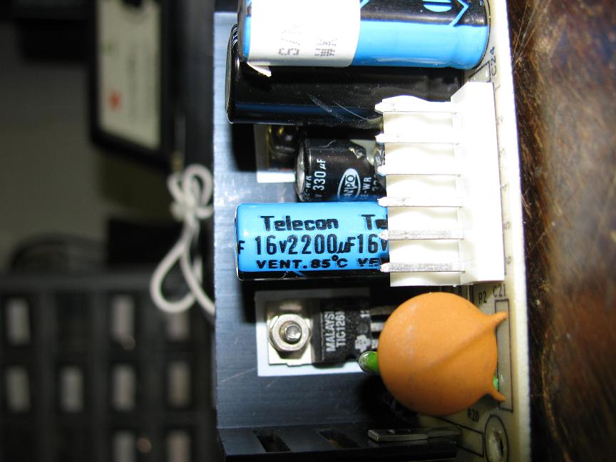

                                      Here's the secondary filtering side, caps are Telecon and Jenpo:
                                      Here's a picture of the Telecon logo...anybody ever heard of them?
                                      Here's the secondary side after I took all the caps out:
                                      Here's the output diodes - looks like 10A each for the +5 and +12 rails, the -12 has a regular little axial diode, and the thing on the left is an SCR for...something. I don't know why it's there:
                                      All the caps got replaced with Panny FC. 5v got a 2700uF @ 6.3v and a huge 6800uF @ 6.3v, other rails each got 2 1500uF @ 16v. A weird thing though, one of the 12v caps isn't connected to ground, but the 5v line. So, some of the ripple is passed from the 12v to the 5v, which then has to pass it to ground. I guess that's why the 5v gets a giant 12.5mm cap. I also stuck a little 100nF film cap for the 12v line into C24, which was empty. Anyway, here's the lovely new Pannys:
                                      And here they are from the top:
                                      And here's the whole thing. You can see the little cap on the input side I replaced. It was a Telecon 47uF @ 35v and I put in a Panny FC 47uF @ 50v:
                                      So my plans for this are to mount it on a board or plexiglass or something and use it as a low power bench top power supply for use with my projects. The -12v would be perfect for a single fan, and that leaves me plenty of power for playing with motors and stuff It has much better output filtering than many "400W+" computer power supplies, and has a bigger main transformer than the "480W" Powmax I have...

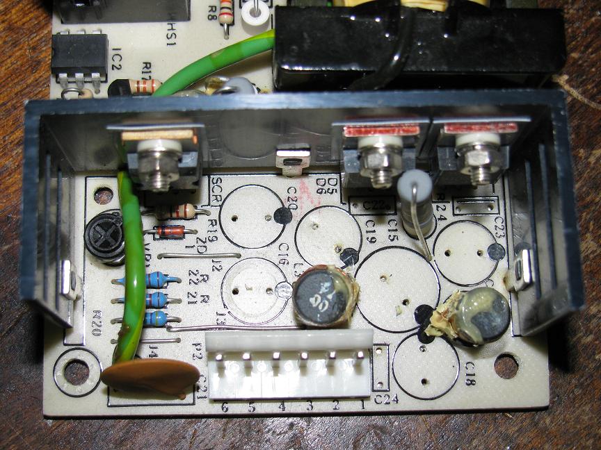

                                        • 31289

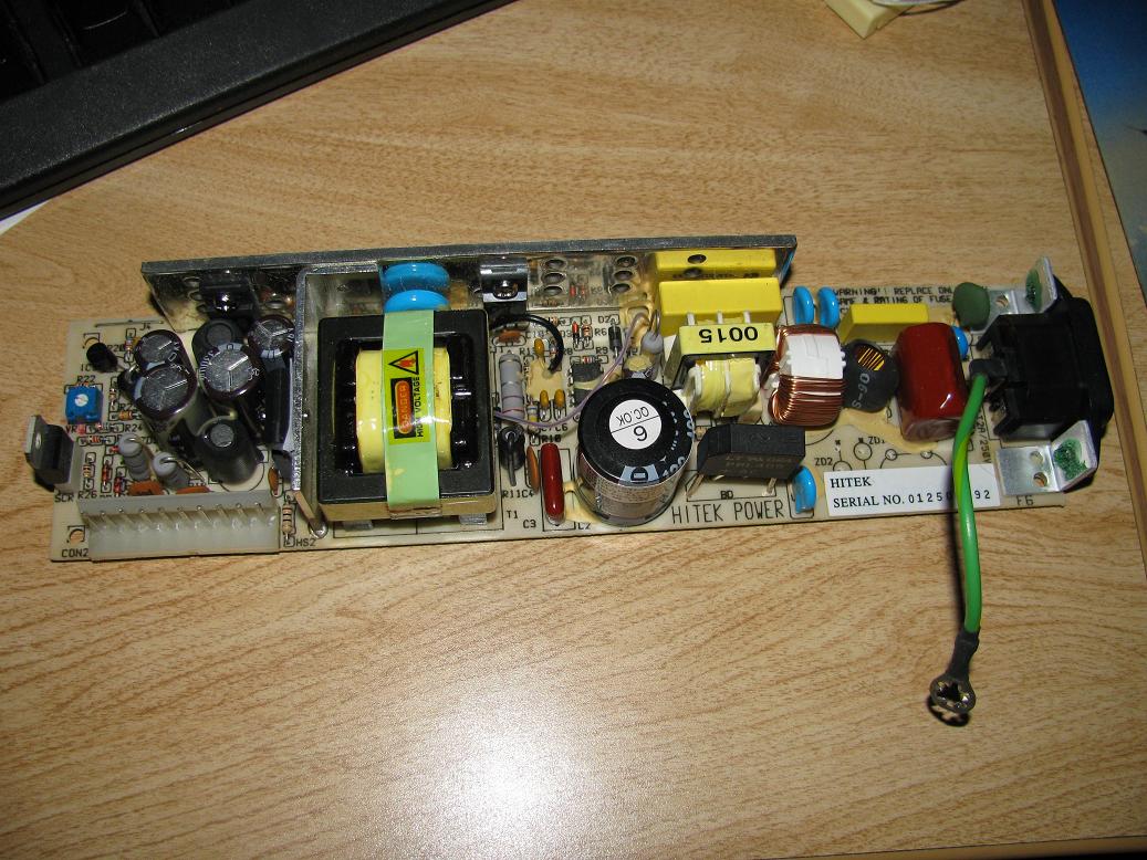

                                          Well this thread has been inactive for a while - I think I'll awaken it with a new find of mine
                                          I got 20 of these on ebay for 19 dollars. Not a bad deal, eh?
                                          Hitek T6000PSU-540
                                          5v - 10A
                                          12v - 1.5A
                                          60W max
                                          Seems to me to be pretty good quality (especially since each one only cost a dollar!) The primary cap is a Hitachi HP3, and all the other electrolytics are NCC KY. Here's an overall shot:
                                          It has an extremely complete input filter (better than the ones on quite a few ATX power supplies I've seen...) consisting of 2 X caps (and a spot for a third), 2 Y caps, 2 dual coils, another coil on the Hot line, a current inrush limiter, a fuse, and an MOV. One X cap is 0.1uF, and I can't read anything on the other, but it's probably 0.33uF or 0.47uF. The Y caps are 4700pF. It has a real bridge rectifier, too, which is rated for 4A @ 600v. The primary cap is 120uF @ 400v. Main switcher is a NEC 2SK2141, N channel MOSFET rated at 6A continuous, 24A pulsed, 600v. Here's a shot of the primary side:
                                          It has 2 outputs: 5v and 12v. Makes it perfect for something that has both 5v logic and a 12v motor or something. Anyways, each output has a dual-diode pack. The 5v has a TO-247 package S30SC4M schottky, rated for 30A @ 40v (the rail is rated at 10A), and the 12v has a TO-220 package STPR1020CTP super fast, rated for 10A @ 200v (the rail is rated at 1.5A). Talk about overbuilding! Wow! Each rail also has a full PI filter. The 5v rail gets 2x NCC KY 3300uF @ 10v 12.5mm caps, and the 12v rail gets 2x NCC KY 1000uF @ 16v 10mm caps. Each also has a 100nF ceramic cap right up against the connector. Here's a picture of the secondary side:
                                          I didn't take a picture of the bottom, but the soldering is nearly flawless. There's one part where it looks like there's a little bit too much solder, but it's not causing any problems. It has a 10 pin output connector - 2 12v's, 4 GNDs, 3 5v's, and one that's not connected. Overall, it looks like a very well made unit to me! And it comes with the IEC C14 power connector attached! Definitely good for all sorts of projects What do you guys think?
