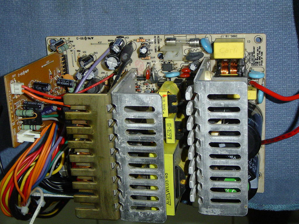

      I got it for free from a pile of old stuff meant to be thrown away at my university. I oiled its fan that was nearly running and noisy. 4 bulging caps were changed with caps from psus that got fully recapped. I don't intend to use it in a pc, just wanted to make it work. And it did!
      Judging from the parts used in it, 470uF input caps, 4A bridge rectifier, big power transistors, 35 size transformer, 30A schottky for 5V, 16A for 3.3V and 12A for 12V ,I think it could output its label ratings, maybe more?
      What do you think?

        WOW, full of crap caps, CS and Fuhjyyu :O. It could be a good PSU after recaps all, I think.

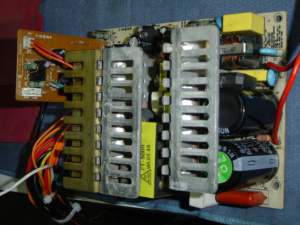

          #144
          Seventeam ST-302HLP 300W ActivePFC
          Copper heat sink with Aluminum fin, strange one.

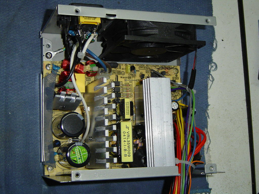

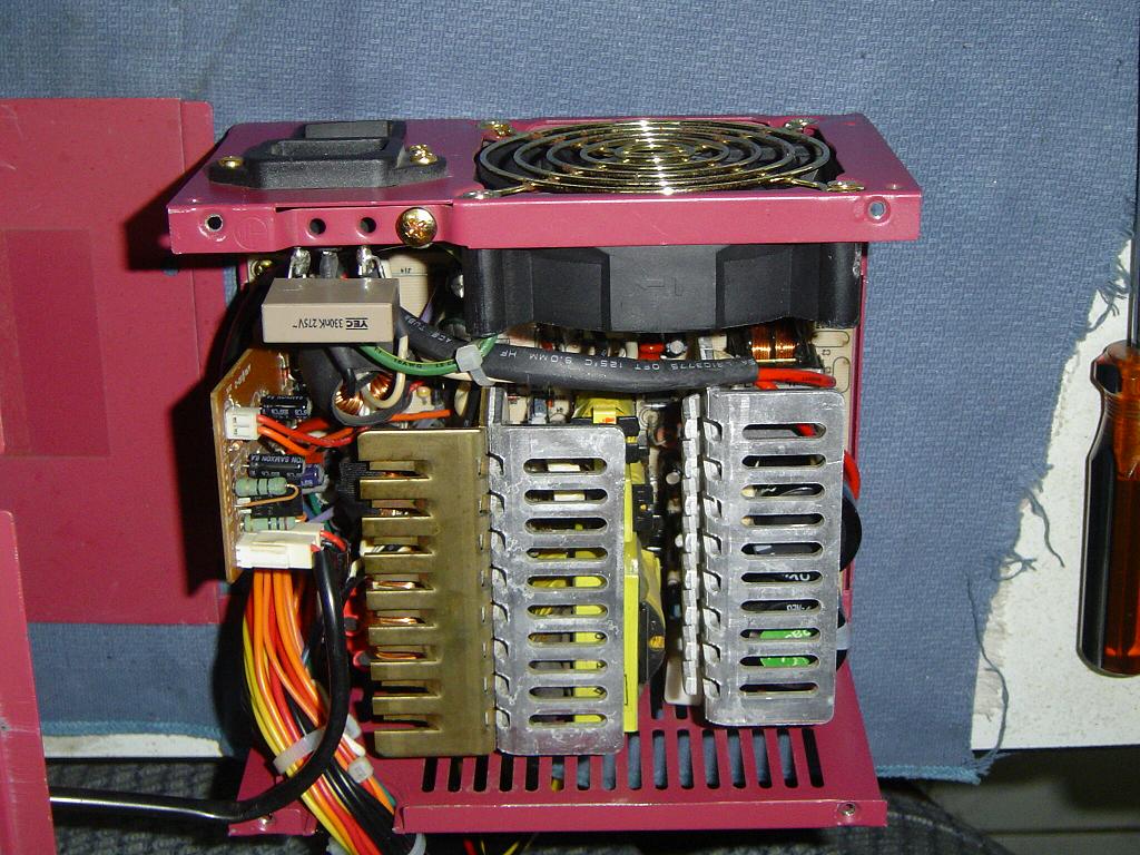

            #145
            POWEREX SPC-500-12VW
            SAMXON anywhere, KM on secondary, LP on primary.
            (I've recaps 5VSB to SAMXON.GF series)
            5VSB used FAIRCHILD's KA5H0165R Power Switch
            This one had strange heat sink on secondary side too, combined brass and aluminum.

              • Aug 2009

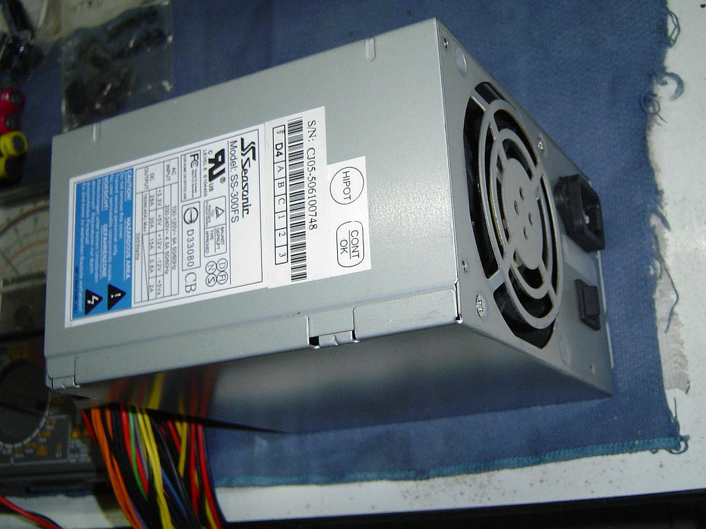

              #146
              Seasonic SS-300FS
              Panasonic on primary side. OST,JPCE-TUR on secondary side with one Rubycon.
              PWM used FAN7554, 5VSB used ICE2A0565Z

                #147
                Sorry, most SAMXON on secondary side, some are Su'scon.

                  #148
                  I think powerex uses CWT for the most part. Looks like it from those red sleeves over the pi filters. Though I don't know about the transformer markings, but a lot of cwt's don't use the transformers with CWT written on them. CWT is also the only company I have seen use samxon from the factory.

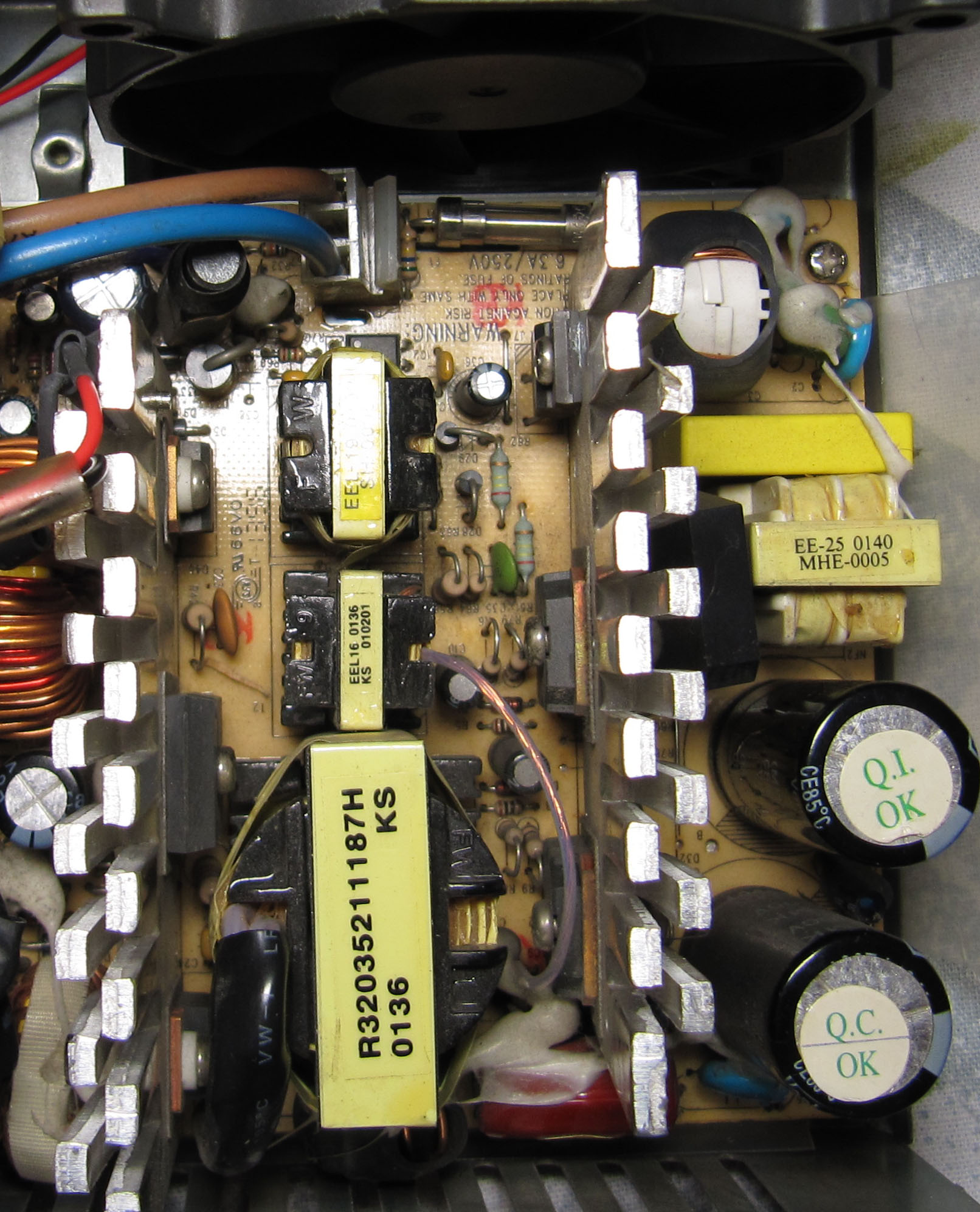

                    #149

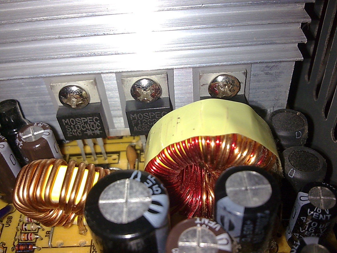

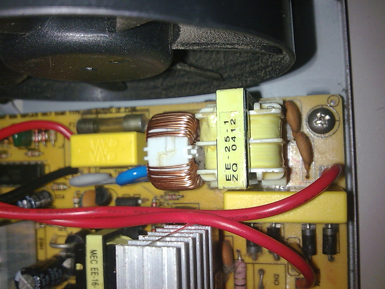

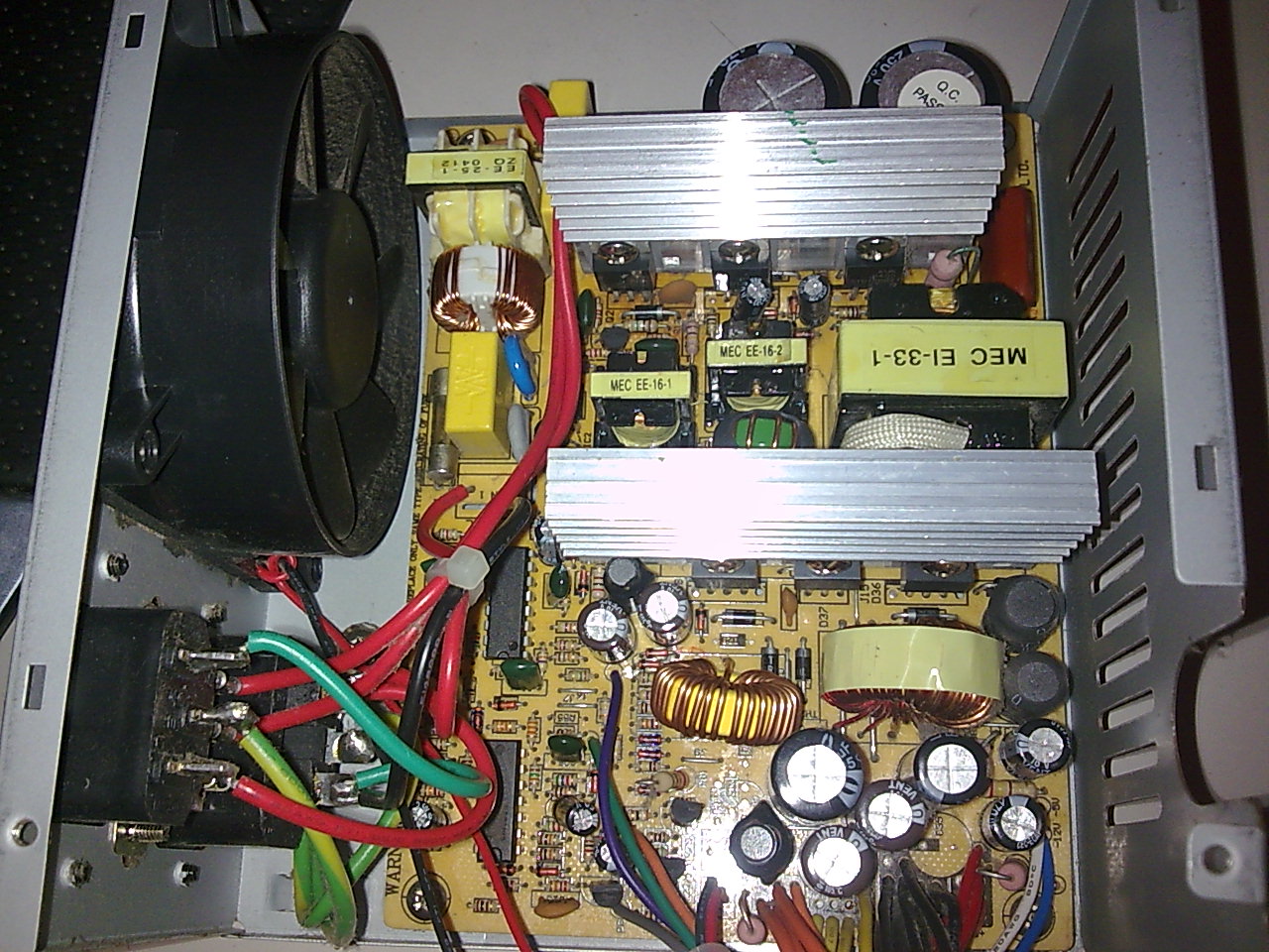

                    I've got a couple of megapax PSUs. Like JG test of the hairong, mine are named after the brands of some cheap PC cases, PLE and MEC.
                    I have the '450W' PLE (20A 5V, 20A 3.3V, 10A 12V) and the '400W' MEC (14A 3.3V, 23A 5V, 14A 12V)
                    The only difference between the two are the s. recitfiers, the PLE has mospec s16c40c, f12c20c, s16c40c on the secondaries. The MEC hass10c40c, f12c20c, s20c40c.
                    Worth beefing anything up and keeping them as a spare 250W psu for testing etc (just as a learning experience too) BTW both have run for years powering celerons/p3s/skt a systems, and everything still looks good on them.
                    Anyway I bring images
                    • etnietering
                      • Apr 2009
                      • 379
                      #150
                      Looks pretty decent to me. Definitely not 450W though! But it looks like it has PI filters on the output rails, a good input filter, decent heatsinks for 250-300W. Here's what I would do to upgrade it:
                      Replace the 4 diodes with a real bridge rectifier IC rated at 4A or more.
                      Replace the primary capacitors.
                      Replace the secondary capacitors.
                      Replace the secondary diode packs so it can handle the ratings (10A diode on a 20A rail won't last long).
                      Replace the cheap Y caps with ones rated Y2 class or better.
                      If you're going to have lots of details of your work you should start a new thread for it, too. Good luck

                          Correct me if I am wrong but the transformer is El-33, that means it's not capable of doing more than 300 watts max...
                          • 370forlife
                            Large Marge
                            • Aug 2008
                            • 3112
                            #153
                            There's not exactly a limit on the amount a 33 sized transformer can make. They are basically like any other part on a psu, will do as much as it can until it overheats or explodes. 35 sized transformers are used in psu's up to 700-800W, real 800W's too. I assume 33 sized could put out 350, maybe 400 if well cooled.
                            But yes, you really only see 33 sized transformers in 300W psu's (even if they are labeled as 450 or 500W) the same way you see 16v caps on the 12v rail. A bit of room to work with capacity wise.

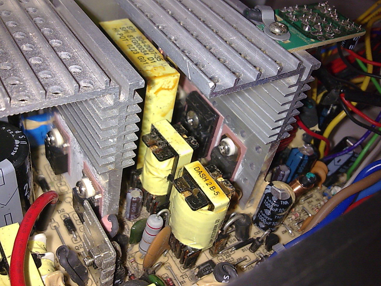

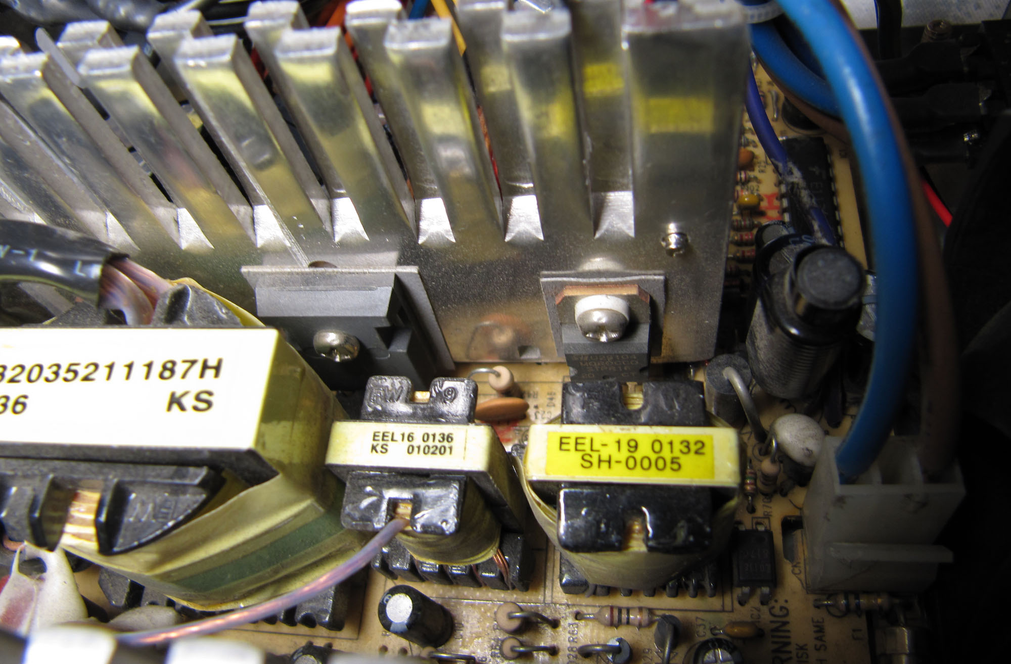

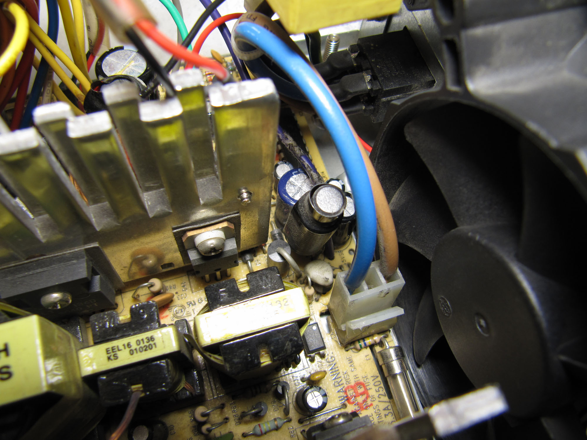

                                Speaking of larger transformers, I do have this old PSU that I think is an Aopen 300W. I stopped using it because it was noisy.
                                It has rubycon primary caps, did have 6A bridge rectifier I removed to repair something else, the rest of the caps are fuhjju, teapo and jamicon though.
                                Primary shotts are"F" "152" ""13009" x2 on the large heatsink, "sss4n660as" on it's own little heastink.
                                secondary are SBL2040CT, SBL3040 PT, STPR10.
                                OEM is FSP.
                                edit: I have a bunch of PSUs, one of them is so bad it's funny. A 400W ritmo with the tiniest transformers I've seen, lots of jumpers and missing stuff.

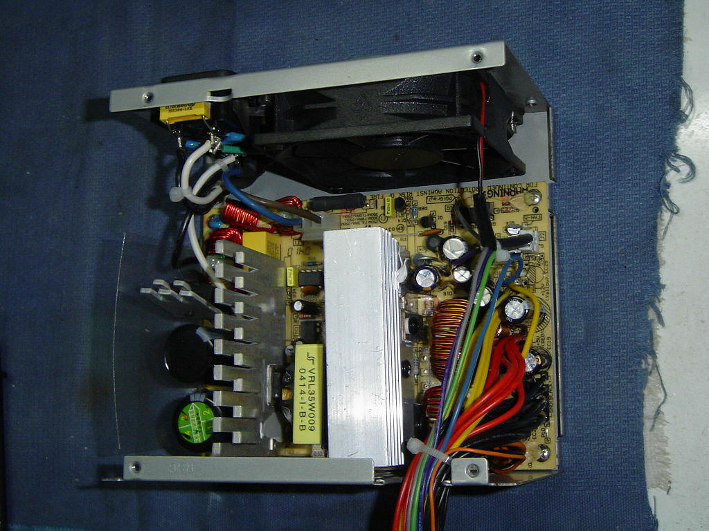

                                          #160
                                          Did they cram everything onto one heatsink on that?
