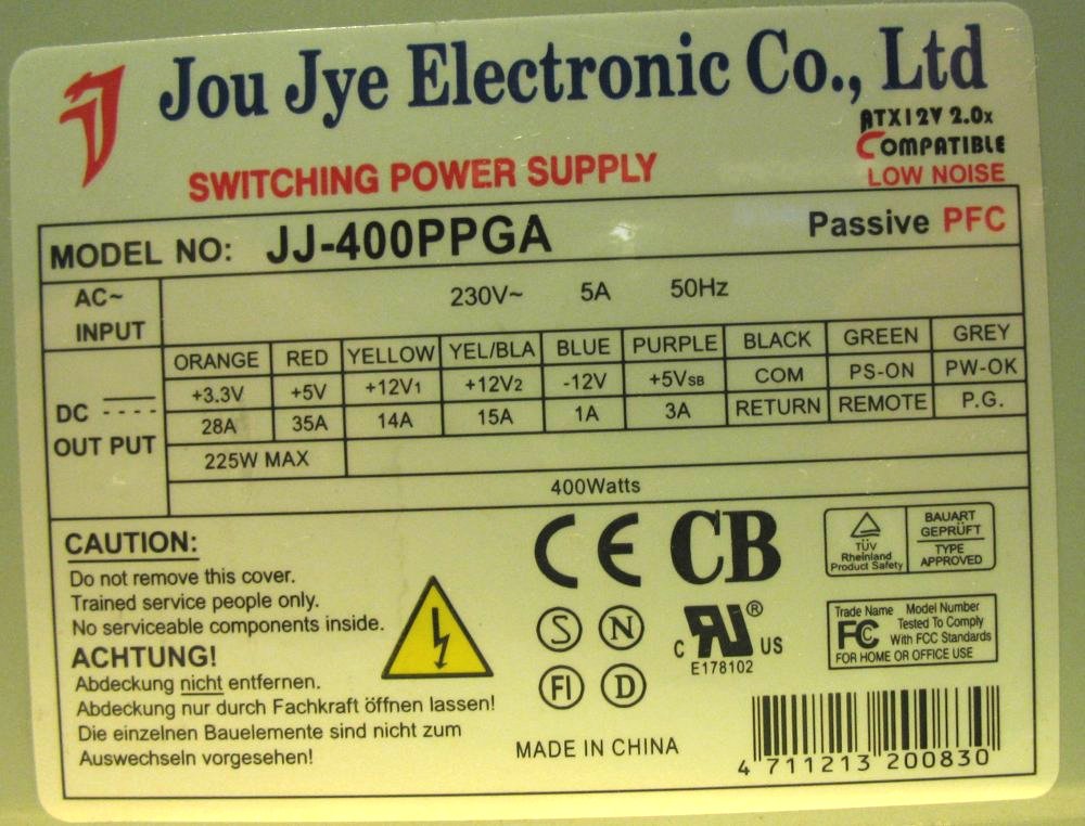

JJ-400ppga
Here a 400W PSU made by Jou Jye Electronic.
I have recapped it because it looks well built, it has a passive PFC, a complete input filter, I forgot to take a pic of the case where another small PCB has another part of the input filter.

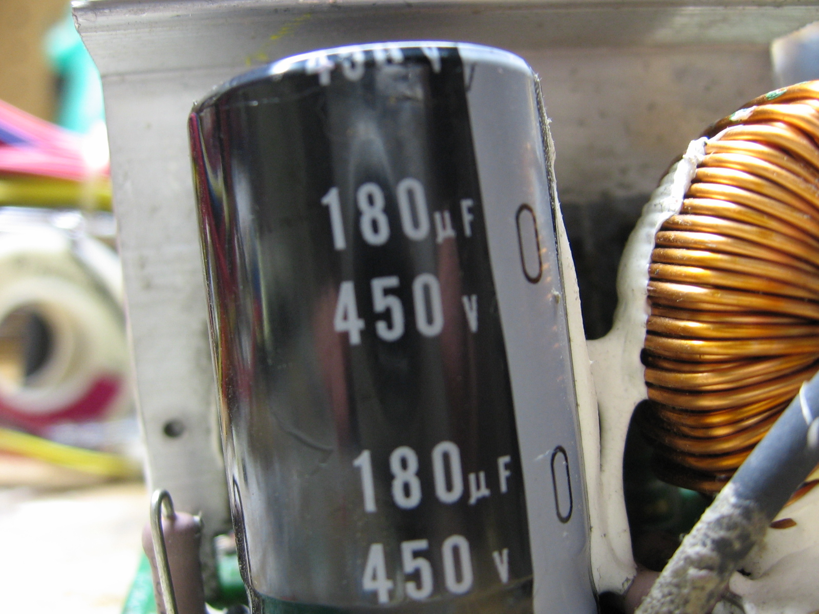

I replaced all Capxon with Samxon, Rubycon and 2 Teapo, I left the 2 Jun Fu on the input.
I checked the replaced caps: most of all were good, only 2 small caps 2,2uF 400V were completely ruined, I replaced them with Teapo... I had no other caps with such values.
To be honest I didn't understood why there are those 2 caps: they are connected at the input bridge, between + and -, with 2 diodes and one 2 resistors and the common point is connected on one AC input pin of the bridge. It looks like a kind of "input filter".
Here some pics.

I am familiar with these power supplies. In fact I can have as many as I want for free, thanks to the 5vsb Capxon caps that always fail and make the psus not work anymore.
The circuit you mention seems to be a voltage booster.
Here is a schematic I made:
https://www.badcaps.net/forum/attach...9&d=1268165068
https://www.badcaps.net/forum/attach...0&d=1268166583
I think that the best thing to do is remove completely those 2.2uF 400V caps. They get really hot because of the resistors and it is a matter of time to fail, regardless what brand they are.
By removing them, you disable that circuit and the power supply gets noticeably cooler.

goodpsusearch the circuit is identical!!!
I thought it was a kind of filter due to the passive PFC.
It will be very interesting to know the right reason why they put this circuit, I can't see any good reason.

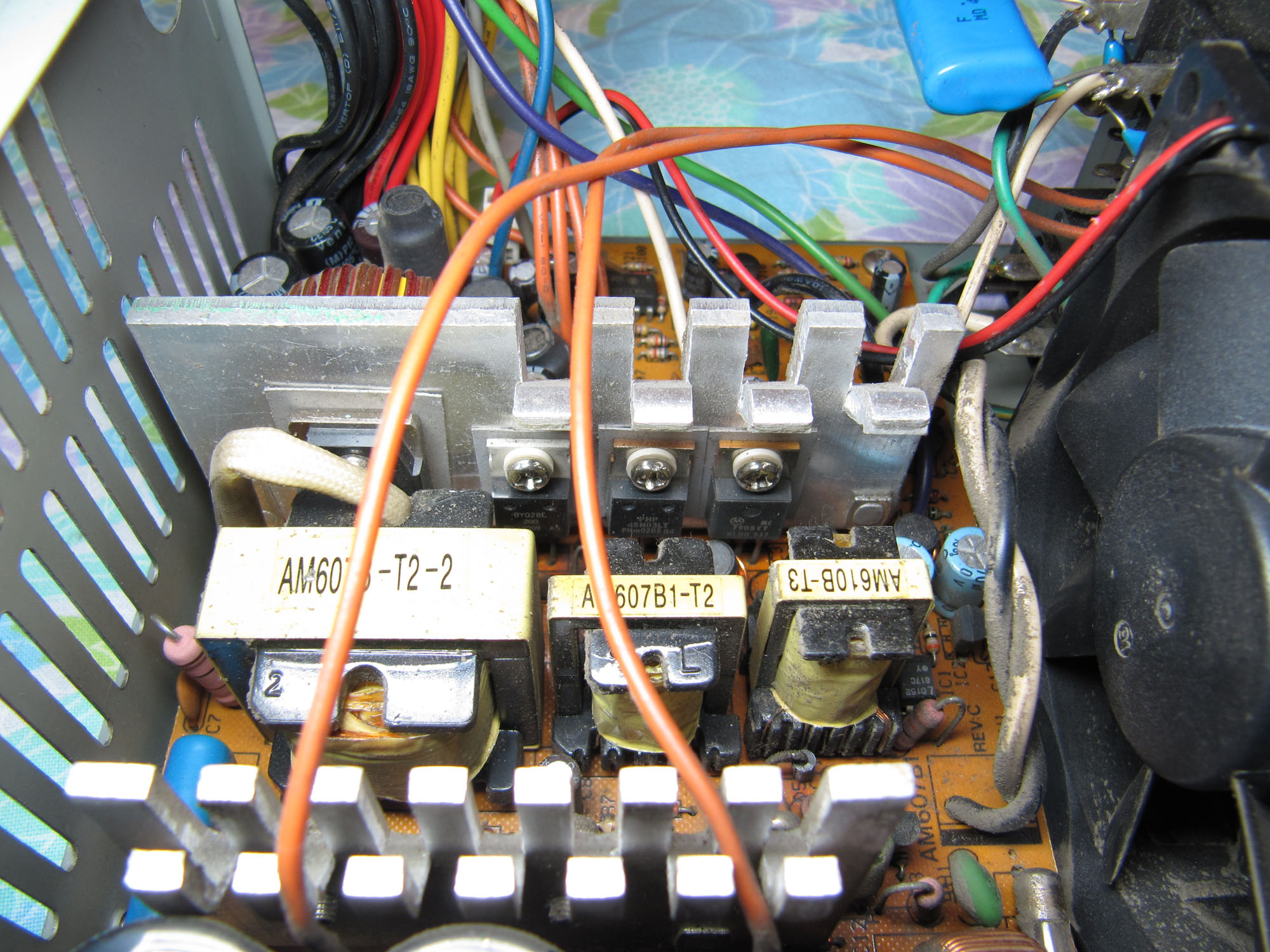

AM607B1 250W
I got that psu without its metal cover so I don't know anything about it except that it is 250W and "AM607B1" is written on pcb.
It has an ADDA fan that is very noisy, every cap on it is fuhjyyu and Teapo, none bulged and there are only 2 holes on metal case for the fan screws...
It works.Comment
