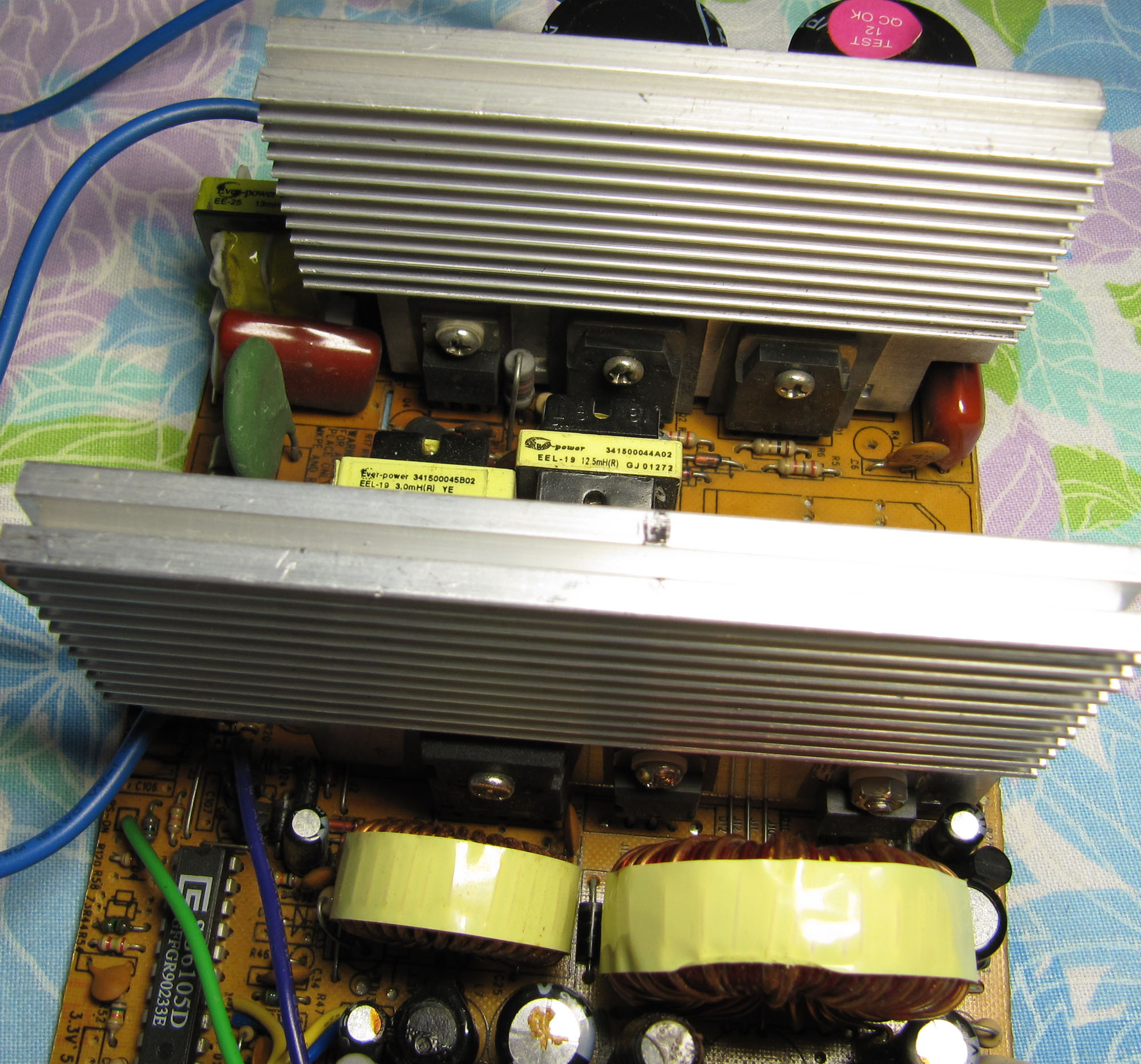

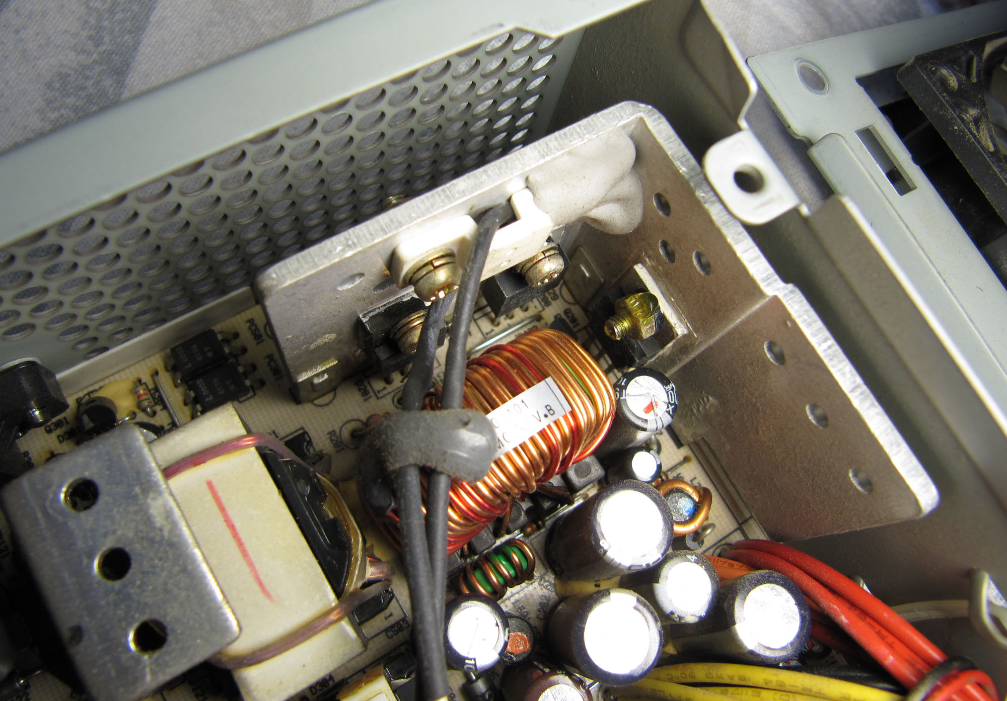

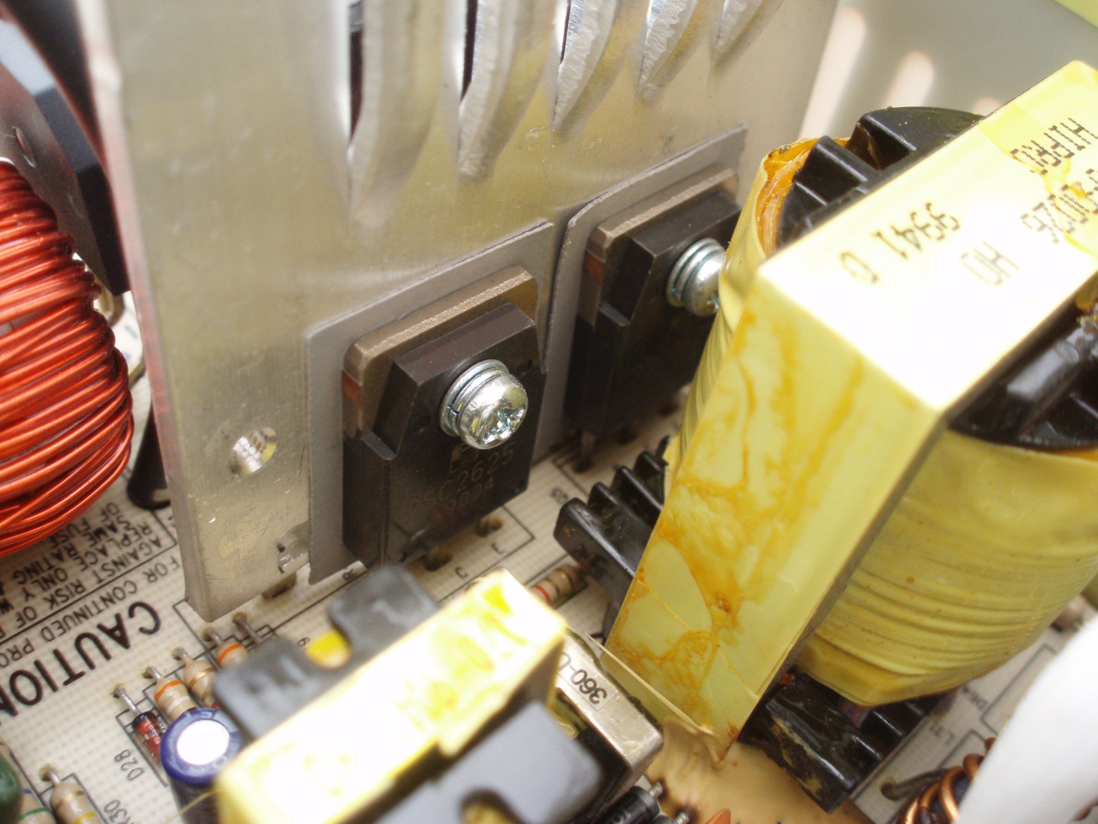

    Did they cram everything onto one heatsink on that?
    I hope not, though it sure does look like it. If so, heatsink better be grounded, otherwise there could be lots of potential for overclocking. Literally! Just one jump from primary to secondary will give you 340V DC (or 170V DC if heatsnik is connected to one side of the bridge rectifier). Awesome !

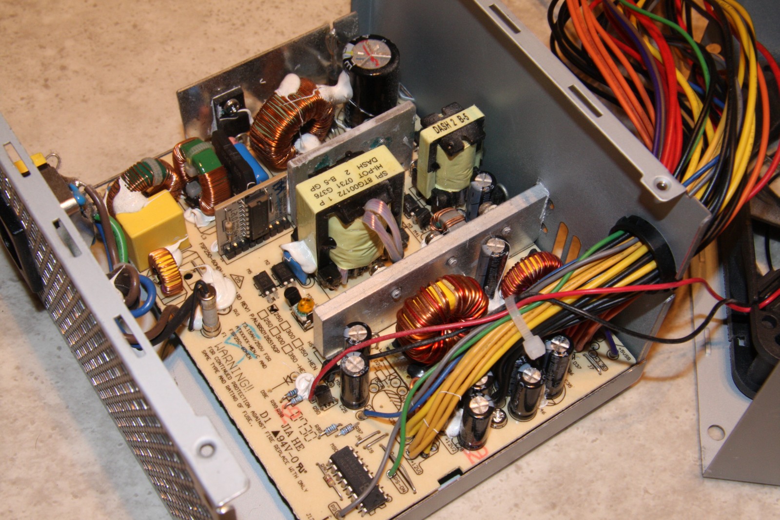

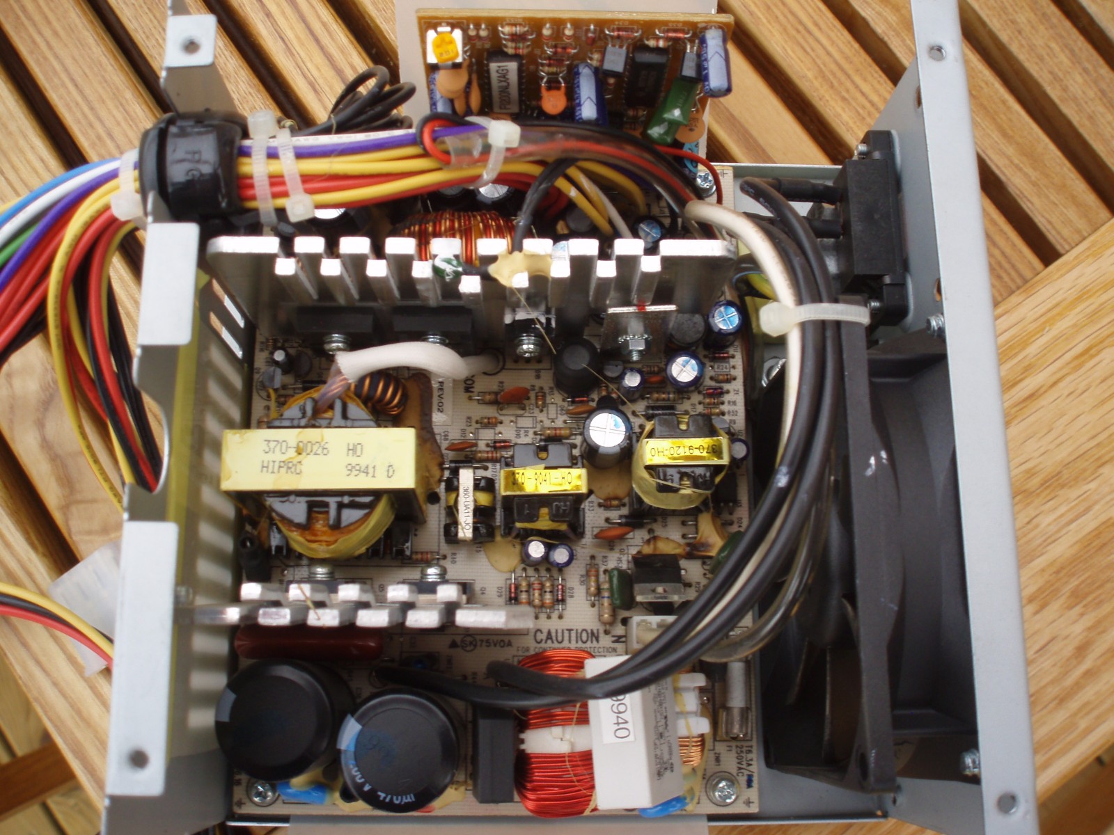

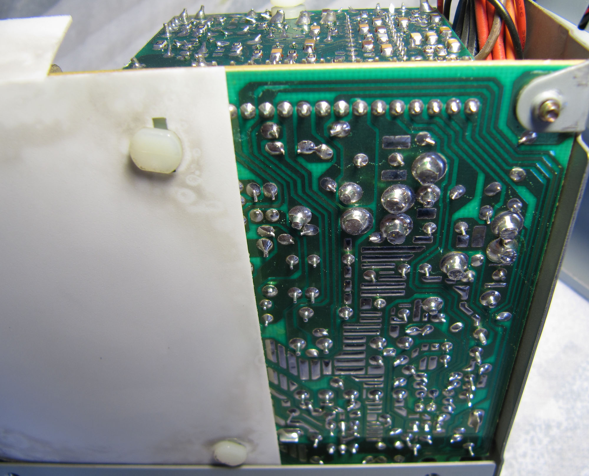

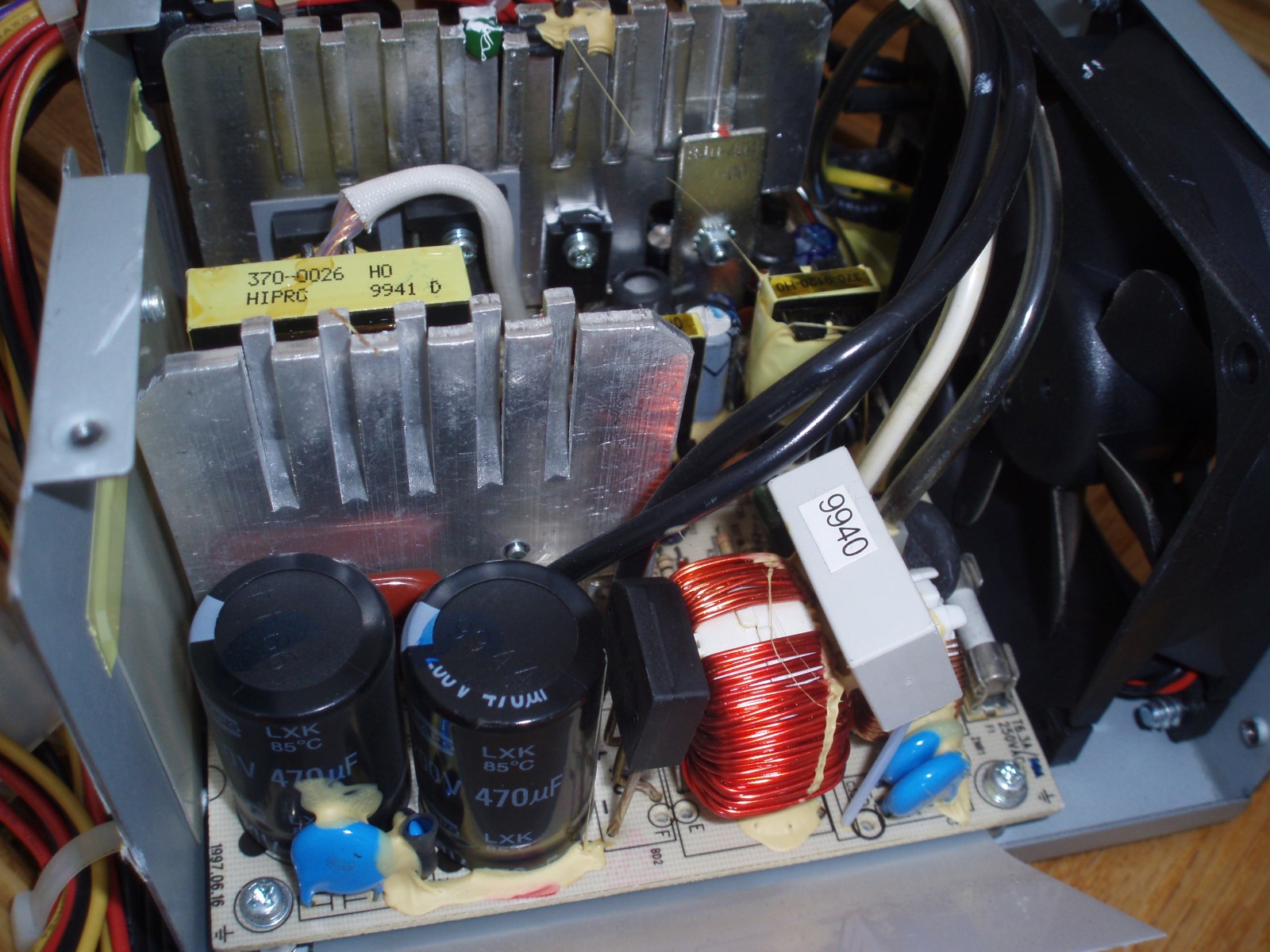

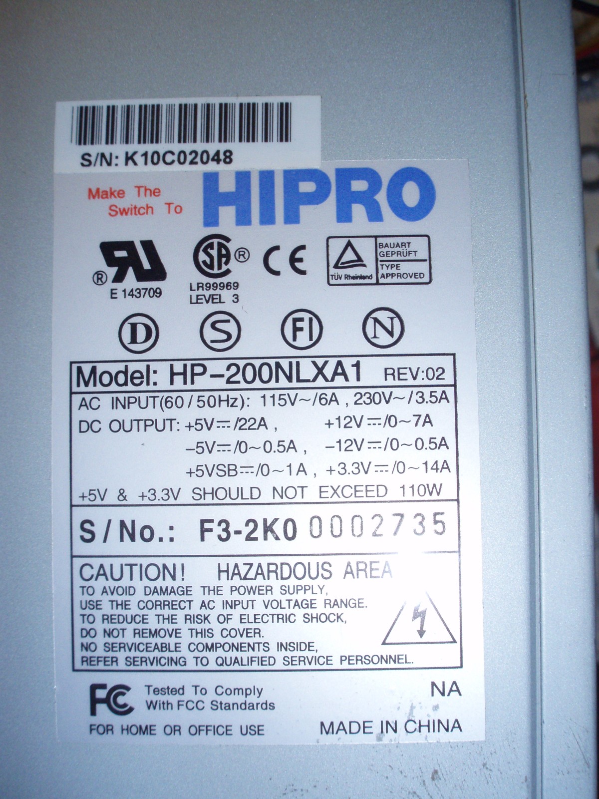

      Hipro HP-200NLXA1 200w, +5v 22A, +12v 7A, +3.3v 14A. +5v & +3.3v 110w max. 470uf Teapo primary caps, secondary side Su Scon caps
      This PSU really suprised me, it came in a small crappy case for a customers Socket 370 mainboard, I was expecting bulging caps and poor build quality but this unit is the exact opposite of that, a really good PSU for an old 5v system IMO!

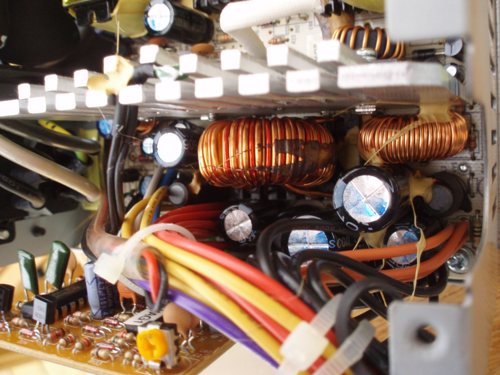

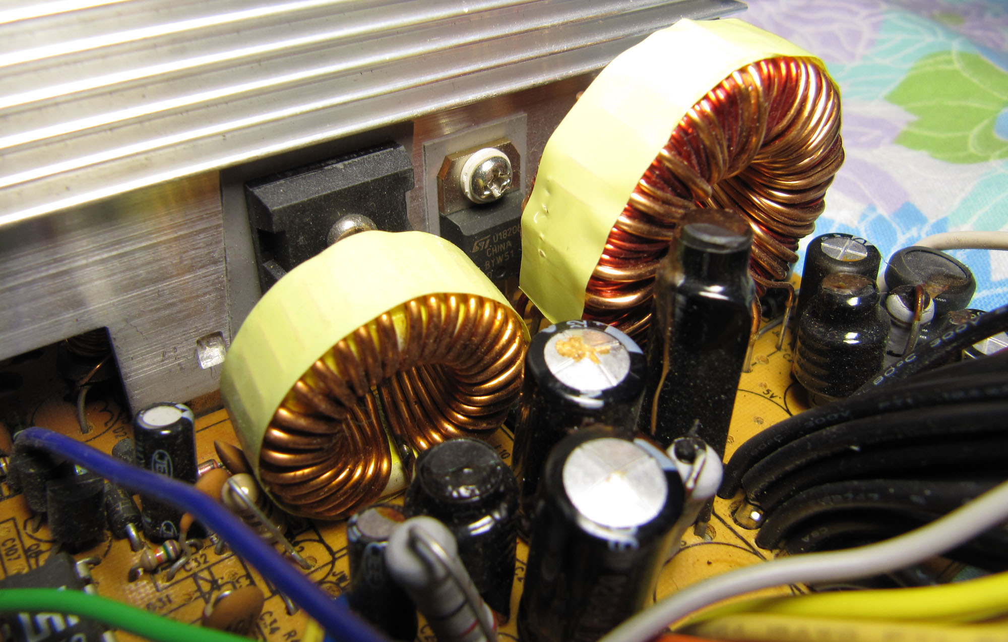

        Another nice PSU, a Seasonic SS-401HT 400w, +5v 30A, +12v 14+15A, +3.3v 30A. +5v & +3.3v 150w max, 12v 348w max. Hitachi primary cap, secondary side had bulging OST caps which I replaced with Samxons (Ost's visible in picture PICT4462.JPG, rest show Samxons...)

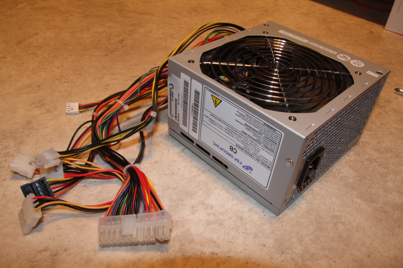

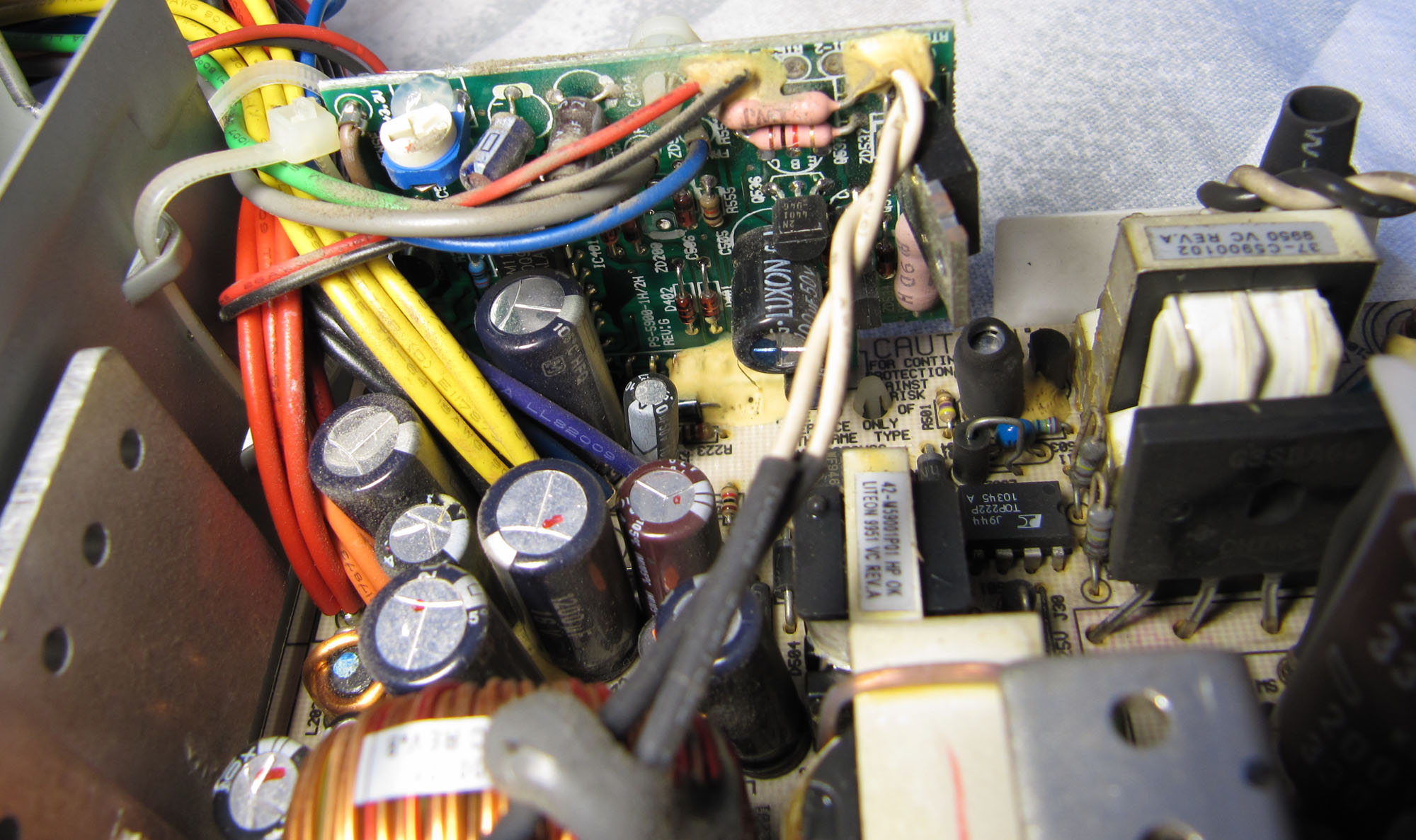

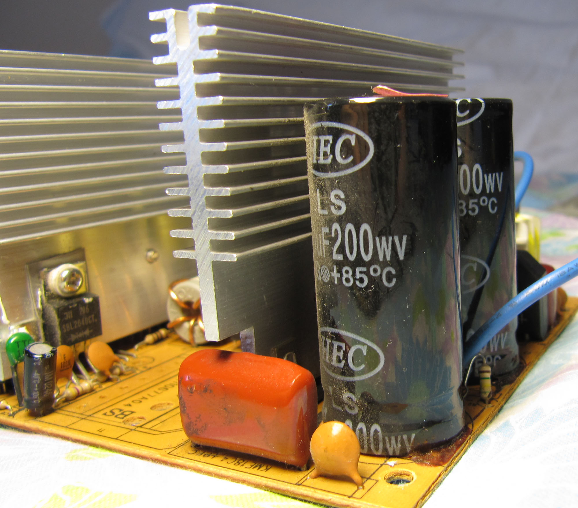

          #164

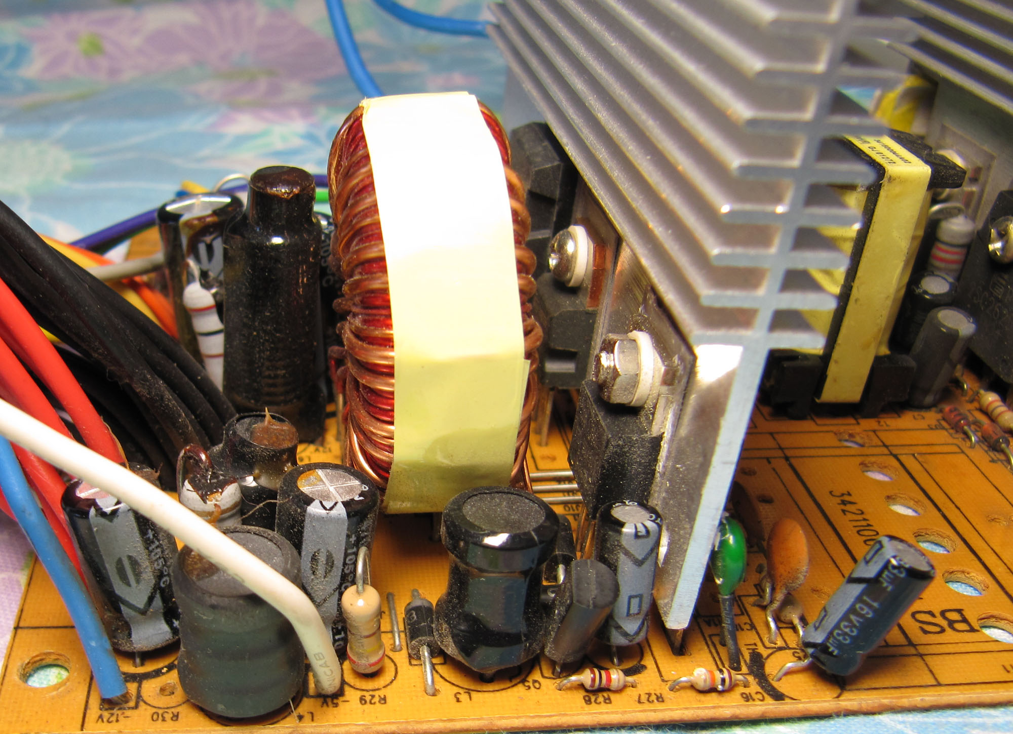

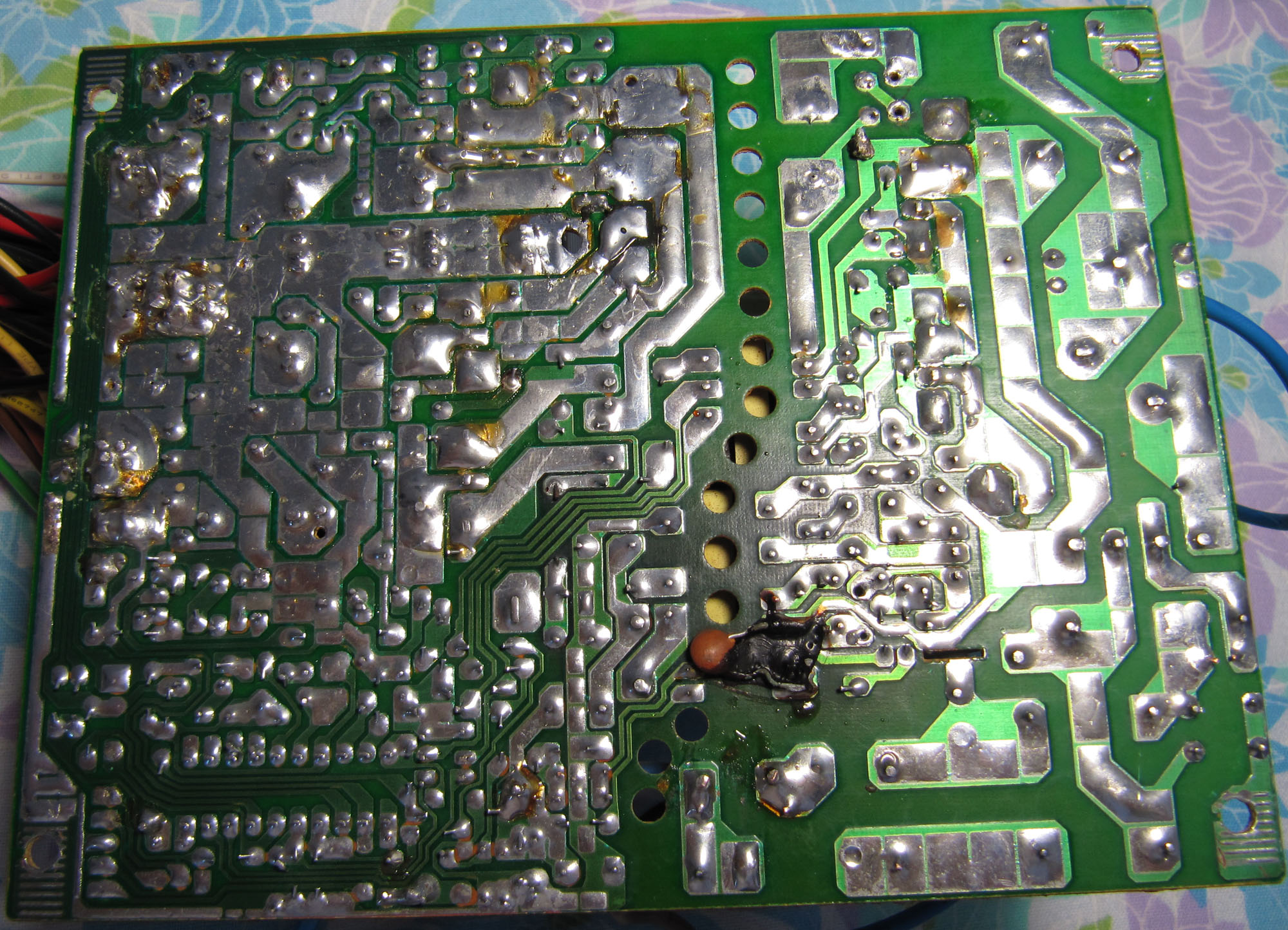

          Third times the charm? No, not this time!
          FSP 250-60HEN 250w, +5v 18A, +12v 8+14A, +3.3v 17A. +5v & +3.3v 115w max.
          TEAPO primary cap rated 100uF 400v, secondary side has CapXon
          As you can see there are many missing components but the biggest problem is that the components that are actually there are rated like 1/3 of what they should be!
          This PSU is a hard drive killer, it has no visibly leaking caps but it does not need to with such inadequate component selections!
            Watch out. We have had a string of failures of these exact psu's in our donated computers at computer tech. They squeal but don't power on. Of coarse, I can't really open my mouth about fixing psu's there as psu's are classified next to plutonium to tech's who don't know better (like my teacher)
            Ya, FSP has kind of gone downhill. Those heatsinks are pretty sorry looking. a 100uf primary cap is what I would expect to see in a monitor. Should be along the lines of a 220uf.

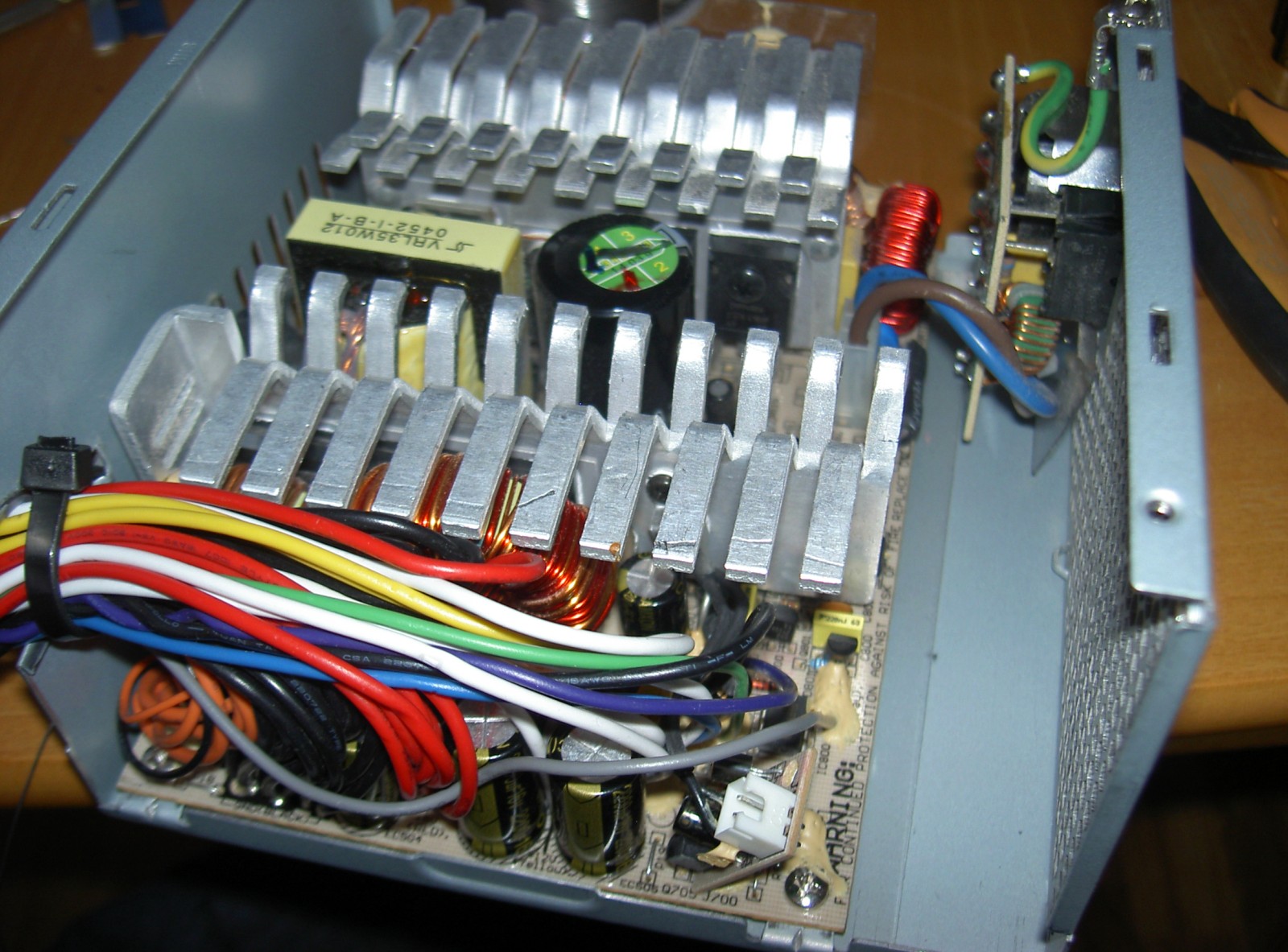

              Maxpower / Rexpower PL-400 / PL-450
              This used to be a not so bad psu sometime. Now it is a source of parts to mod/fix other power supplies.

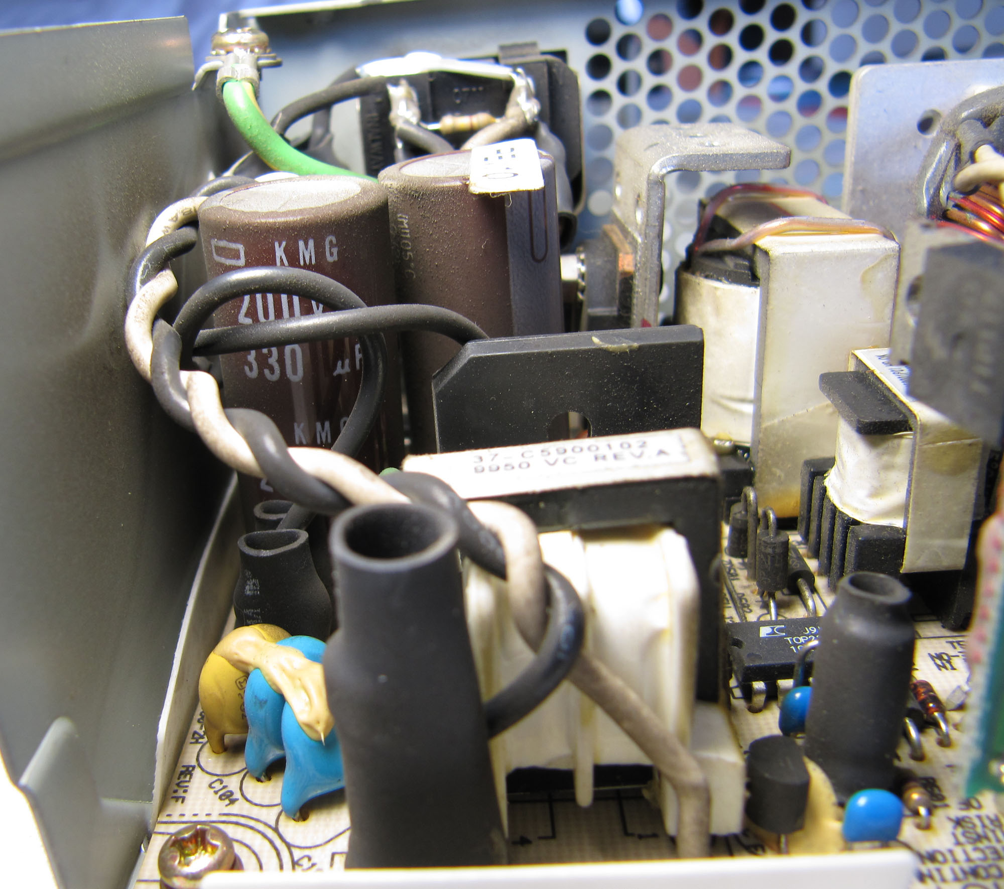

                        LiteOn PS-5900-2H 90W
                        I took it out from that PC.
                        Every cap in it is Rubycon, Nippon Chemicon and Panasonic. Only the small ones are G-Luxon.
                        Is it possible that the label is correct? Is that psu only 90W?
                        It loooks much more watt capable.
                        It has been tested and seems to be working without any problems.
                        What do you think?

                          sure it's possible. a Pentium II/3 with onboard graphics doesn't use much power.
                          70W combined on 3,3/5V .. but 1,5A on 12V seems very very low. one HDD and one optical drive and its loaded up already.. o.O
                          a slightly more beefy PSU in the same miniature formfactor would be the Fortron FSP145-50NI
                          3,3V -> 10A
                          5V -> 10A
                          12V -> 4,5A
                          the only problem it has (as you can see) is the dreaded f... word.. other than that, solid as a rock.

                            Ithink they can do more than the label says.. Maybe 150W for the lite on?
                            And the fortron 200W...?

                              Usually OEM models from companies like delta and lite-on have really strict OCP. Whats on the label is what it can do, you may be able to squeeze a few more watts out by mixing around the load on each rails.
                              That FSP though may not even have OCP.

                                    If there's overcurrent protection like 370forlife said, then you probably won't be able to pull more than 90W. But looking at this PSU, it probably doesn't. The label says it will do 90W at 50C temperature so I'm willing to bet it will do at least 100W at normal room temperature.
                                    I like how Lite-ON also added Japanese caps and a topswitch IC for the 5vsb. This is how you build a solid PSU. Shouldn't give a problem for the next 10 years (or even more).
