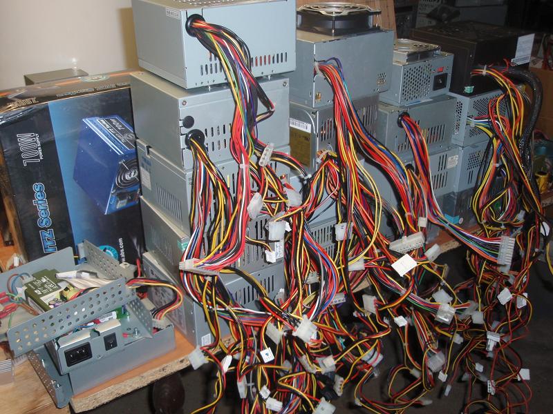

            Most, if not all, of these PSUs should be working. Sooo... they belong in this thread, not the gutless PSU thread.
            Basically, I've caught the "bad cap" bug--11 mobos, 3 PSUs, 3 LCD PSUs of mine, ALL with bad caps! 8 mobos, 1 PSU, and 2 LCD PSUs were a success so far, thankfully! I haven't attempted the remaining. Instead, I'm finding myself doing pre-emptive repairs on motherboards that I care about... so why not just do all the PSUs as well, if they're worth anything at least!
            The main purpose is to investigate the quality of each, all things considered. I figure many here will have something to say about them, and if anything, we'll end up with a list of caps for each that could possibly help someone else out in the future.
            I have over 30 PSUs ready for viewing, ought to be fun...
            Have a few 750W 220V Dell server power supplies. Those are just too awesome, saving those beasts for last!

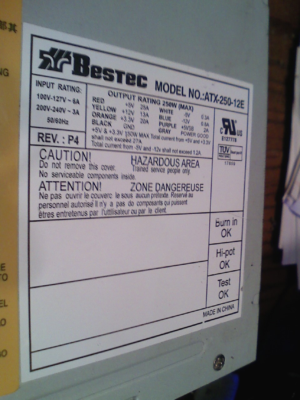

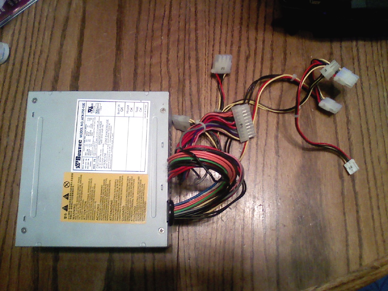

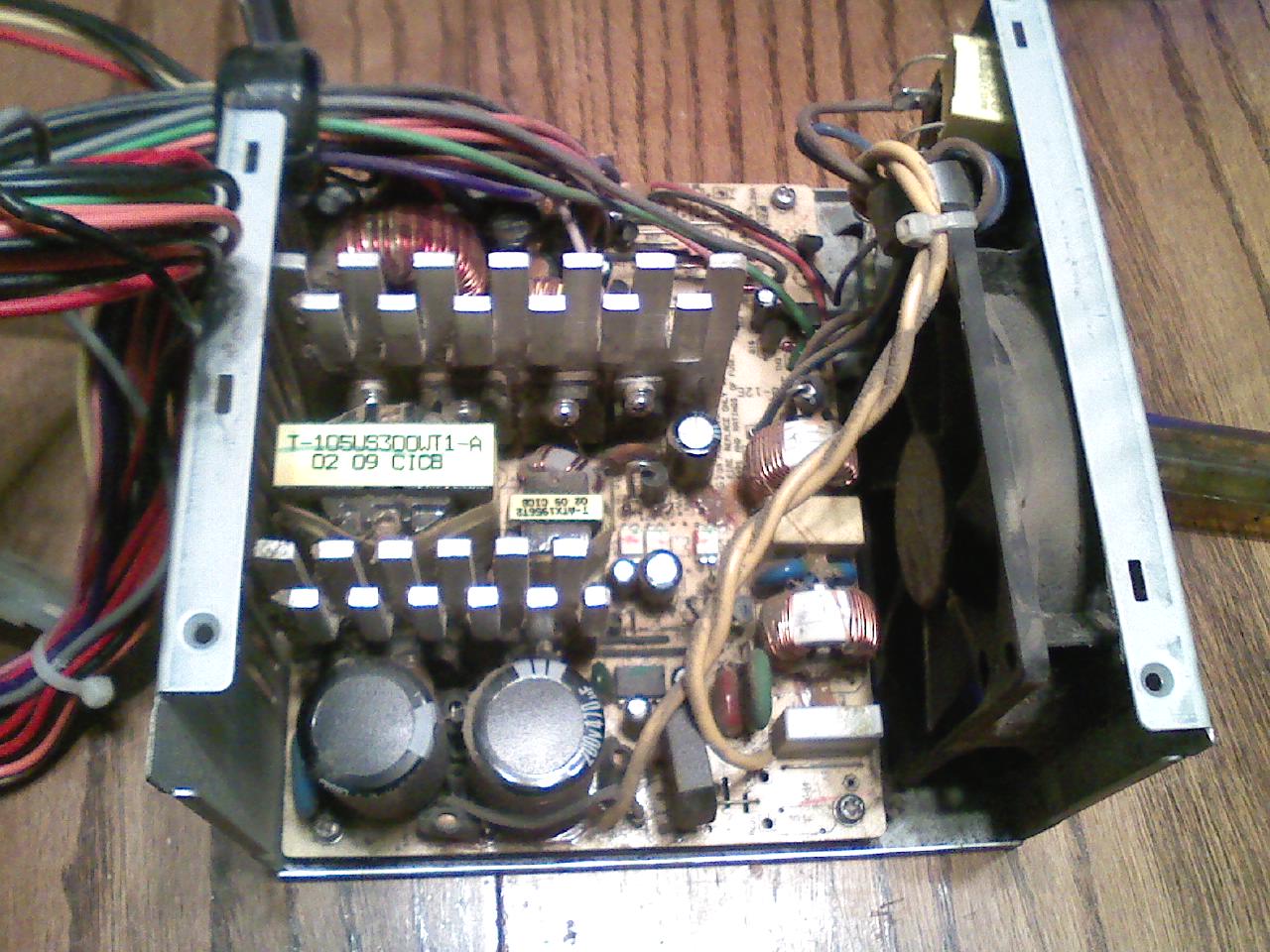

                                        Bestec ATX-250-12E Rev. P4 power supply
                                        It was originally installed in a refurbished eMachines T1360 tower desktop computer my Dad bought for me and my sister in May 2003. [That computer is my home web server as of this post.] This PSU has had some very heavy use over the years until 2007, when it was installed in Mom's old Dell Dimension 8200 as a temporary replacement for a dead Dell PSU. That was for three years. It was then set aside for three months. It is now in a Pentium II computer whose motherboard had been partially recapped recently.
                                        *Used my LG Vu CU920 phone for this, so picture quality is somewhat shot.*

                                          better at least replace the killer cap.
                                          its the smaller of the 2 to the left of the opto's in the last pic.
                                          i use a 22@50 fc.
