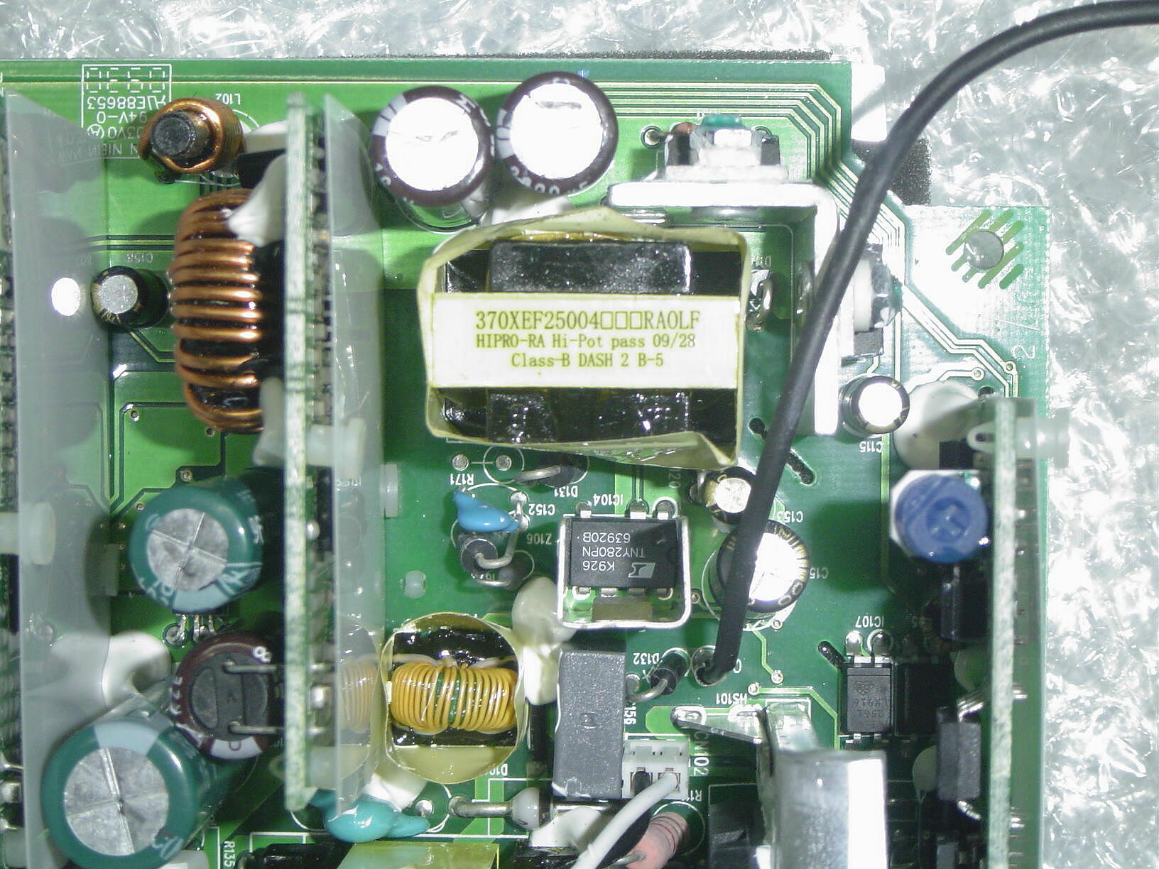

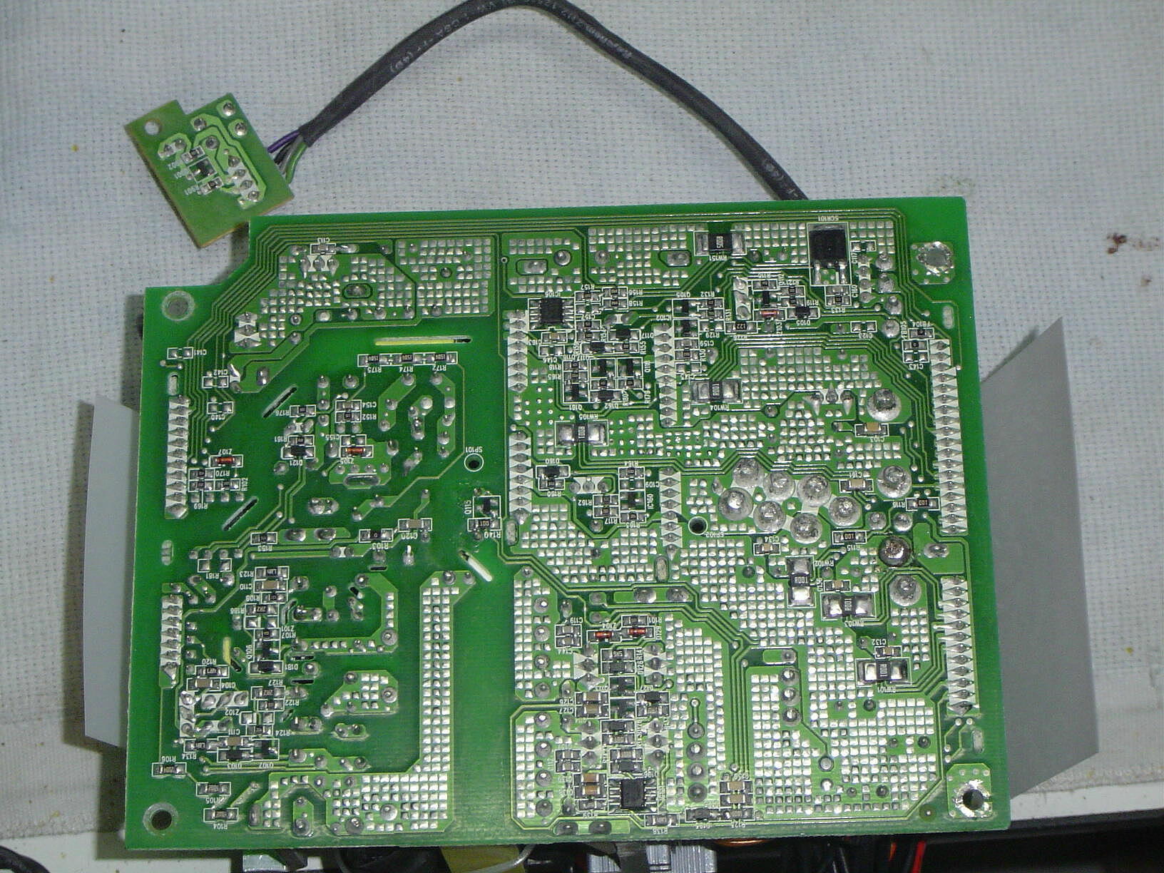

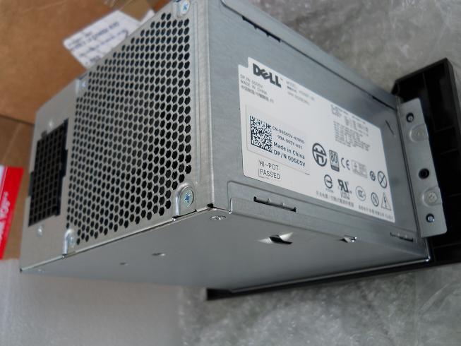

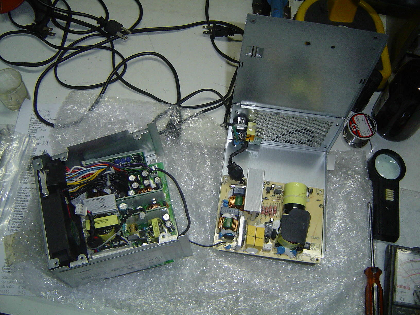

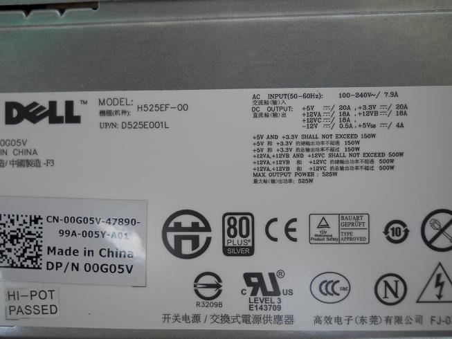

                                  DELL MODEL: H525EF-00 (HIPRO) UP/N: D525E001L DP/N: 00G05V
                                  525W PSU for T3500 WorkStation
                                  80PLUS SILVER
                                  ActivePFC uses two SPW20N60C3
                                  Two-Transistor Forward uses SPW15N60C3
                                  5VSB use TNY280PN
                                  IR1166S Synchronous Recitifier for 12V (cannot see MOSFET)
                                  5V and 3.3V uses Voltage Regulator Module from 12V
                                  Capacitors on Secondary are UCC KZE/KZH, Ltec LXY (cannot see primary cap)

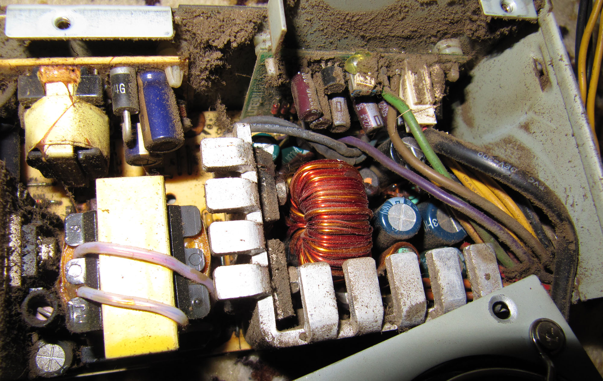

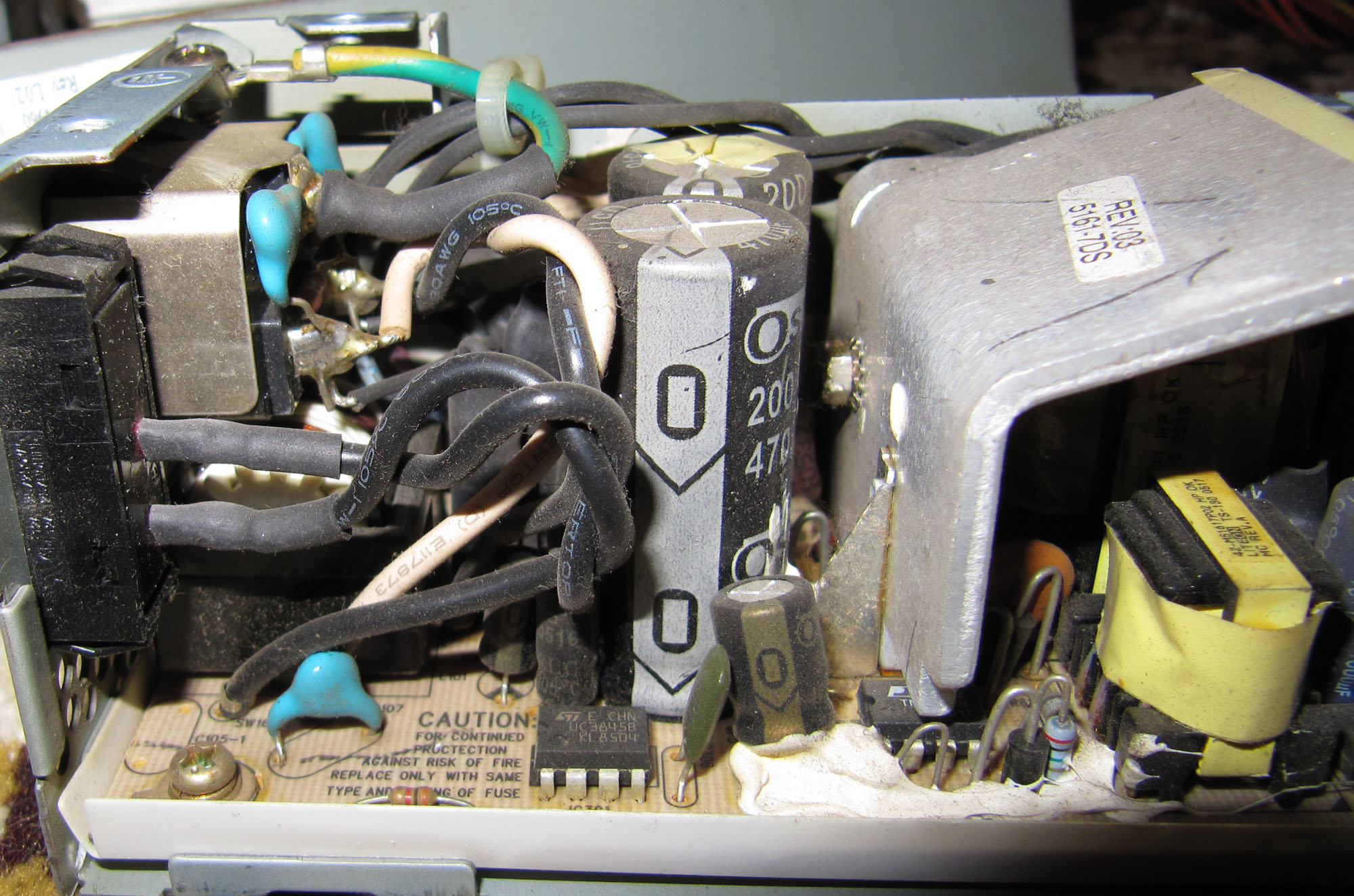

                                    Has Seasonic always been good? Because I found a 150W one from the 1980s that seems cheaply built (was UL approved), although almost all the caps are Japanese:
                                    OTOH here's an Astec-made 130W PSU from the same era that IBM used in its PCs:
                                    Both PSUs have transformers work at about 30 KHz, but the Astec's is 2-3 times the volume, and it has four 440uF high voltage capacitors, compared to two 330uF ones for the Seasonic.

                                      Astec SMPS are the best

                                        Astec is just heavily overbuilt. 150W doesn't require much guts. Even the cheapest leadman units do 150W ok.
