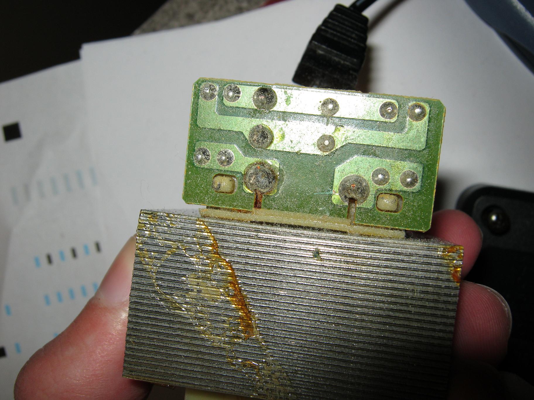

      Why does it have a diode on the rear side too then?

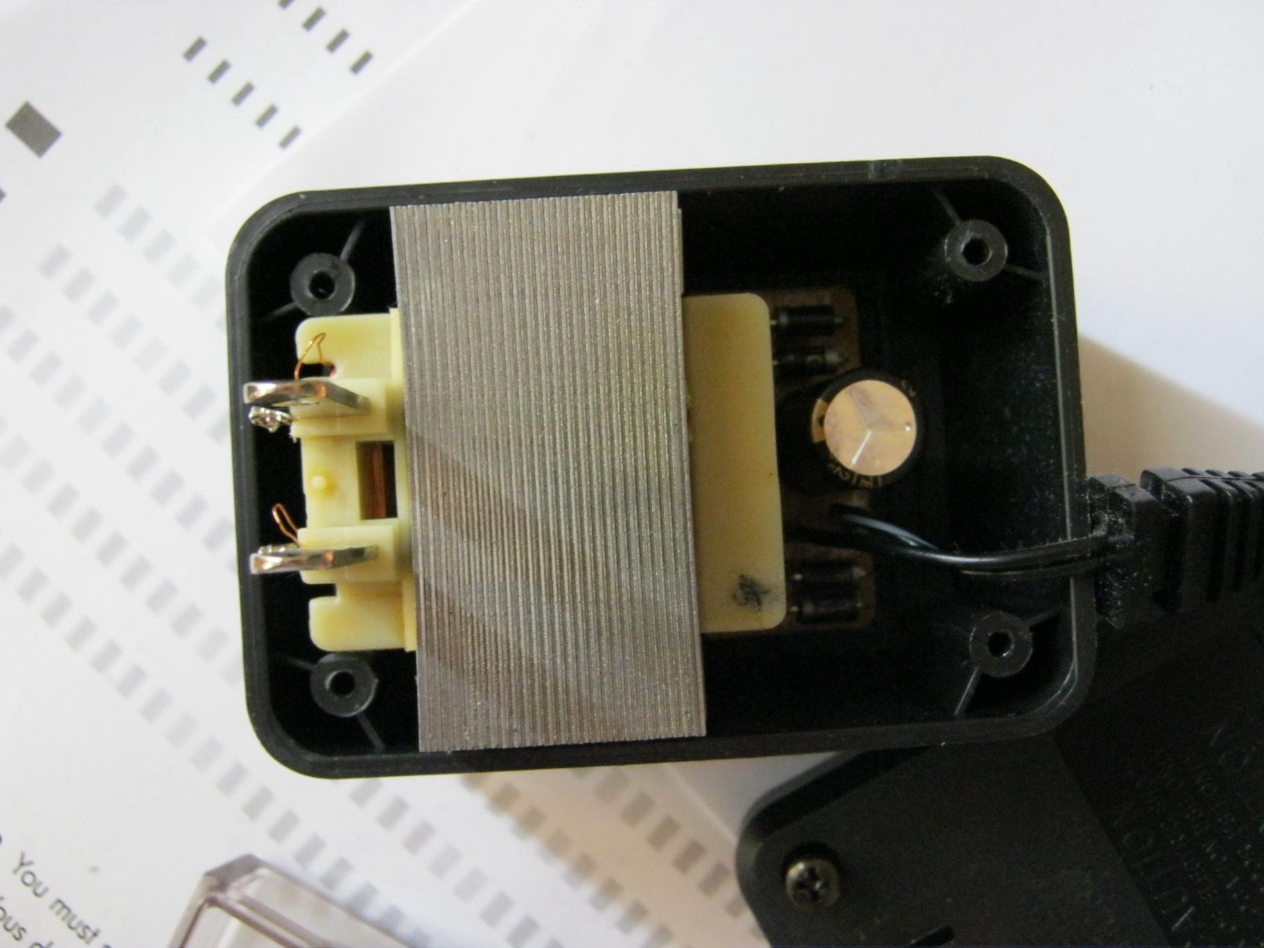

        You're right - I opened it up again and it has 4 legs.. so it's the rectifier. I initially counted only 3 legs, that's why I assumed it's a transistor.
        Now I'm not so sure about the point of the IN4001 diode on the other side connecting two of the legs of the rectifier...
        Yeah... I don't think the transformer is able to do more than 200-300mA....

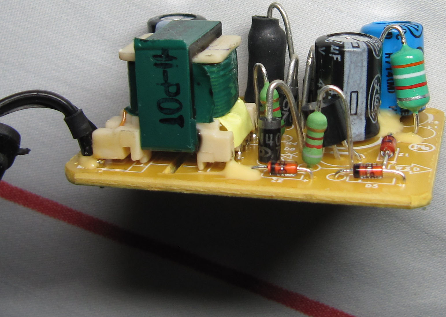

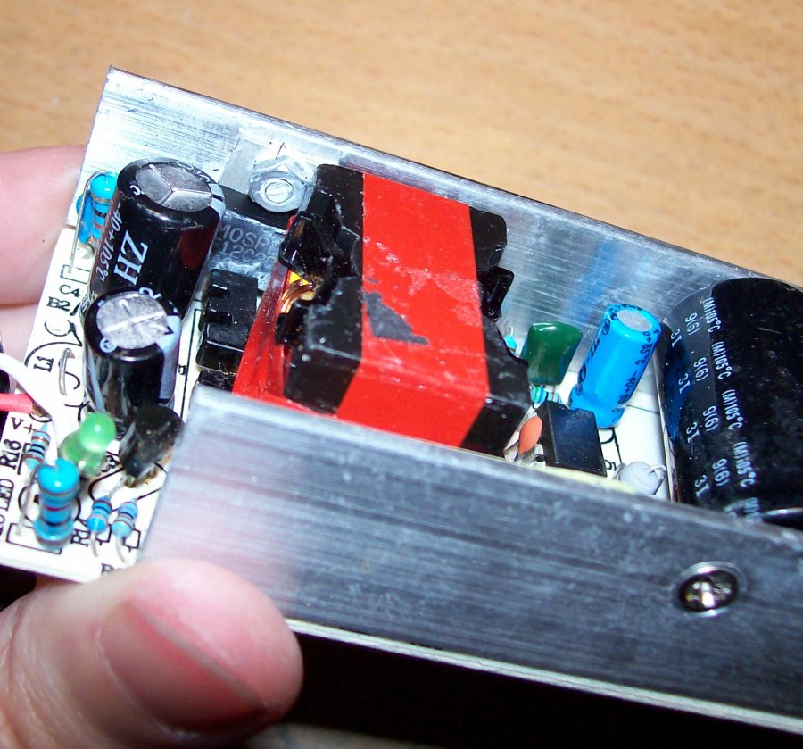

          Here it is!
          Notice that there are no Nichicons here... Only Lelon and Ltec and some are 85C.

            Originally posted by goodpsusearch
            Here it is!
            Heh, is it me or are the primary caps slightly bulged?
            -Ben
            Edit: the one I took apart must have been a different version, it has a defferent layout, etc.. may be able to post a pic or two tomorrow!
                -Ben
                No, it's due to the macro and the flash
                This is the cheapest nokia charger available. It takes forever to charge big capacity batteries!

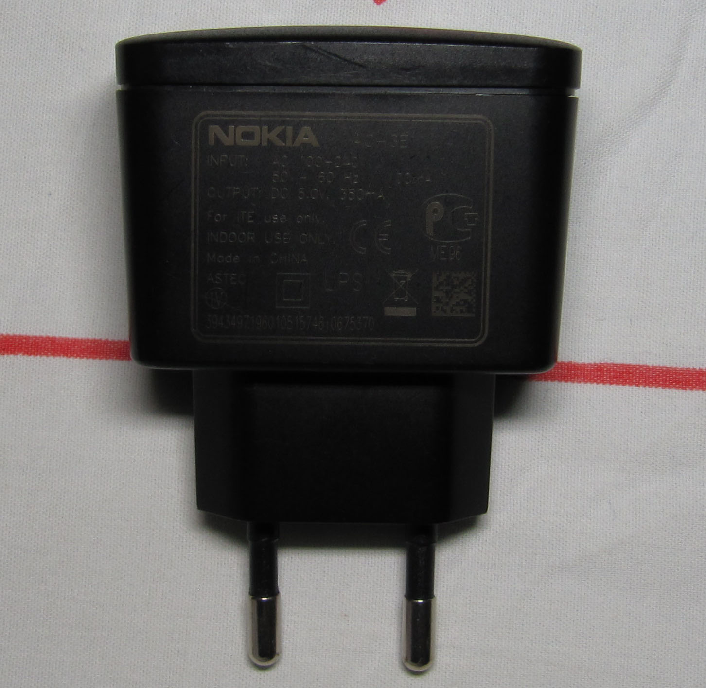

                  I had a Nokia ACP-12E (E for europe) made by Astec. Had a break in the cable somewhere.
                  Caps were Nichicon and Elna.
                  5.7V 800mA output
                  The Salcomp (Finland) made ACP-8E had Elna everywhere.
                  5.3V 500mA output
                  Most newer ones use LTec and Lelon exclusively.. bye bye quality..

                    Btw the one in the photo had a break in the cable too and that's the reason I opened it.

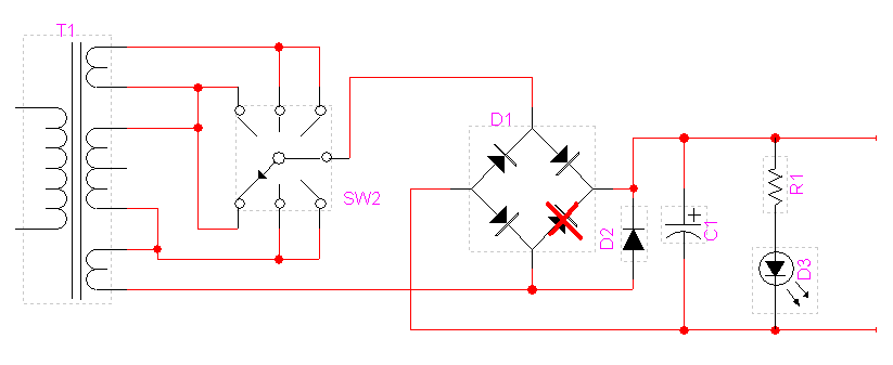

                        Probably because the bridge rectifier has an open diode (or shorted, but they "fixed" that with a short burst of high current ) so it's cheaper to add another diode around it.
                        Notice the current through the LED changes with the voltage selector switch position
                          Ok, I also think there was a bit of confusion there, I cant see any extra diode on the circut board, just the bridge rectifier, LED, resistor, and capacitor( & switches).

                            Check his 2nd photo where it shows the back side of the board.
                              Haha, getting myself all confused! Yes, there is a diode there!
                              But its in a very strange setup :S
                              -Ben
                              EDIT:
                              HAHA WTF! the circuit b700029 drew is correct too, they added an extra diode for some reason.
                              I am surprised that they will do stuff like this to save money! :O

                                For the quality of the rest of the thing, I'm surprised it's even got a full-wave rectifier!
                                  Haha, yeah, some just use one diode

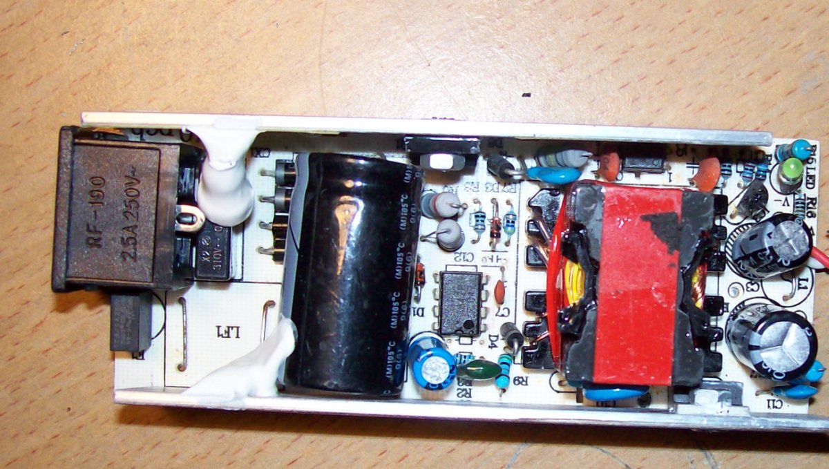

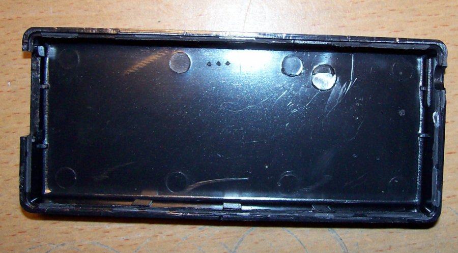

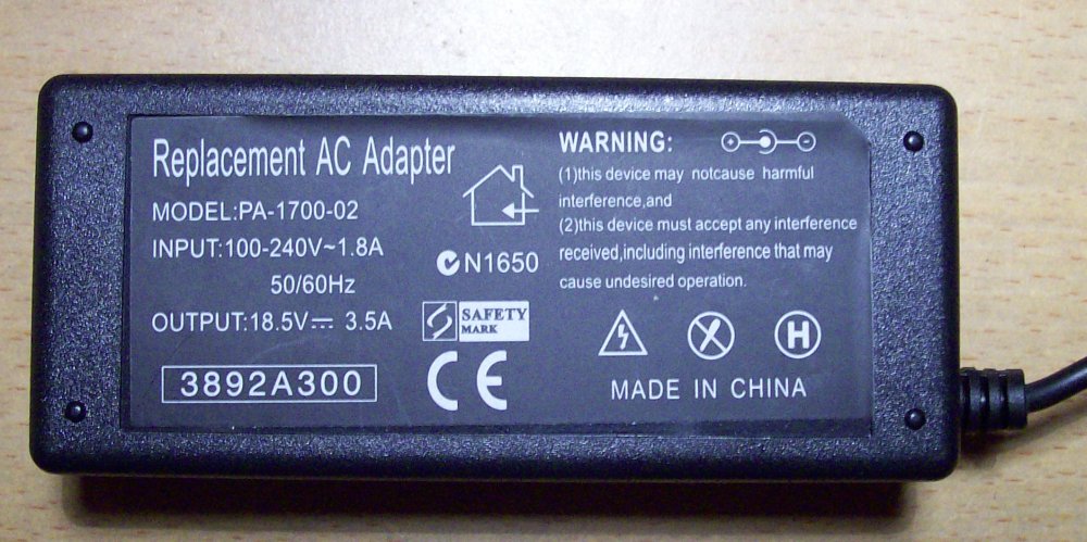

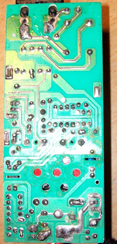

                                    I had to take a look inside these "replacement" chargers for some Hp laptops... This one is probalby the cheapest out there. I expected much worse.

                                      Has Astec gone downhill? They used to have good caps in their power supplies...

                                        Originally posted by semenov_av
                                        which transistors are on the reverse side pa-3241-02a ?
                                        Did you find out the issue about the transisors? I've got the same question.
