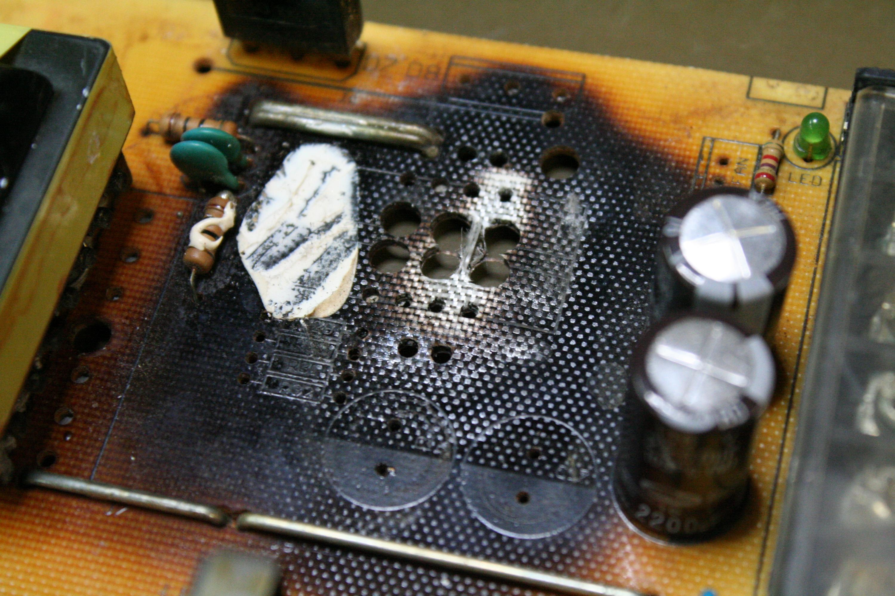

Rewinding burnt choke coil
    Re: Rewinding burnt choke coil
    It is switching power supply so low ESR, 105c caps should be used, get one with the highest ripple currrent rating you can get.
      Hahaha, that PSU is so baked even the solder melted on the underside, wow!
      The PCB topside needs to be fixed first, if it's too bad it's not worth it IMO.
      And you can throw the coil away: the core is toast and needs to be replaced.
      But just jerry rigging it would work, it requires s scope for testing though.
      I would recommend you get a analog scope on eBay instead of some crap digital thing as you mentioned.
      It will allow you to learn allot more, and get a deeper understanding.
      P.S: This PSU failed because of the use of general purpose caps, the switching converter UC38458 it uses supports operation at 500Khz!

        The area underneath the coil which sustained the most damage is just a whisker away from poking all the way through, so there's no repairing it since there IS no trace left. This thing will never go past the "Frankenstein" state as it stands, but it's not like I'm investing time and money to repair it, which is why I'm trying to patch it rather than buy stuff to fix it
        Going without a coil sounds like an idea for using this thing in low-precision applications like I dunno, powering a fan or light something

          The caps adjacent to that inductor are rated for 16V. It's an output inductor. The input common mode inductor is that E-core inductor near the input fuse.
          Output inductors are typically powdered iron, not ferrite. Powdered iron cores lose their magnetic properties permanently if they are too hot for too long. Micrometals, the major manufacturer of powdered iron cores, has information about this on their website. That the paint peeled off the core is a good indicator that the core is probably no good. Also. unless you saw what color paints were where on the core, you could only guess what material type it was (I'd guess Micrometals -26 or -52, but that is nothing but a decent guess).
          All in all, that power supply is probably good for spare parts and trash can filler.

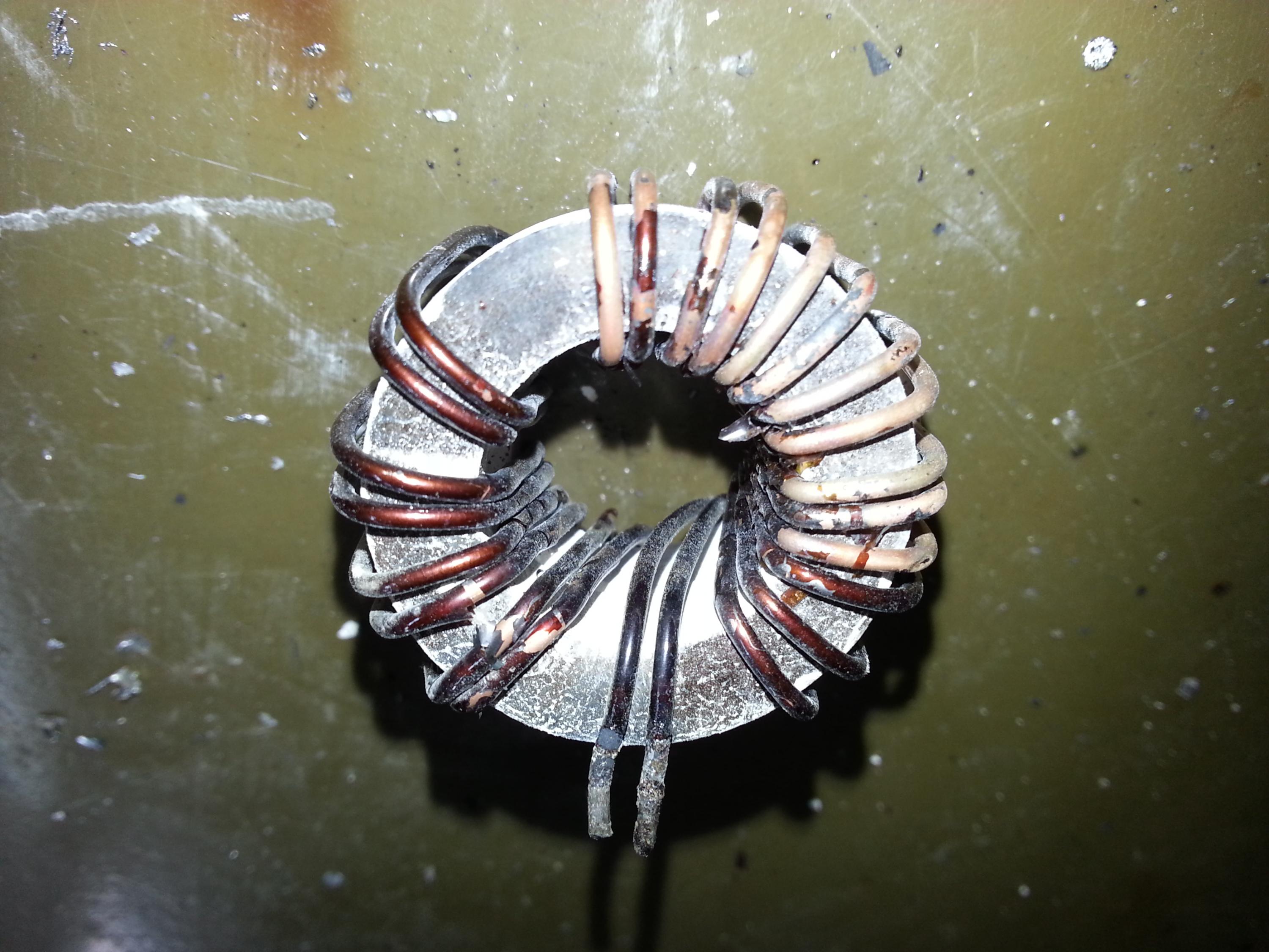

            I BELIEVE the coil was yellow, though it had already started to peel off when I first got it, so that's just a hunch....doesn't matter anyway.

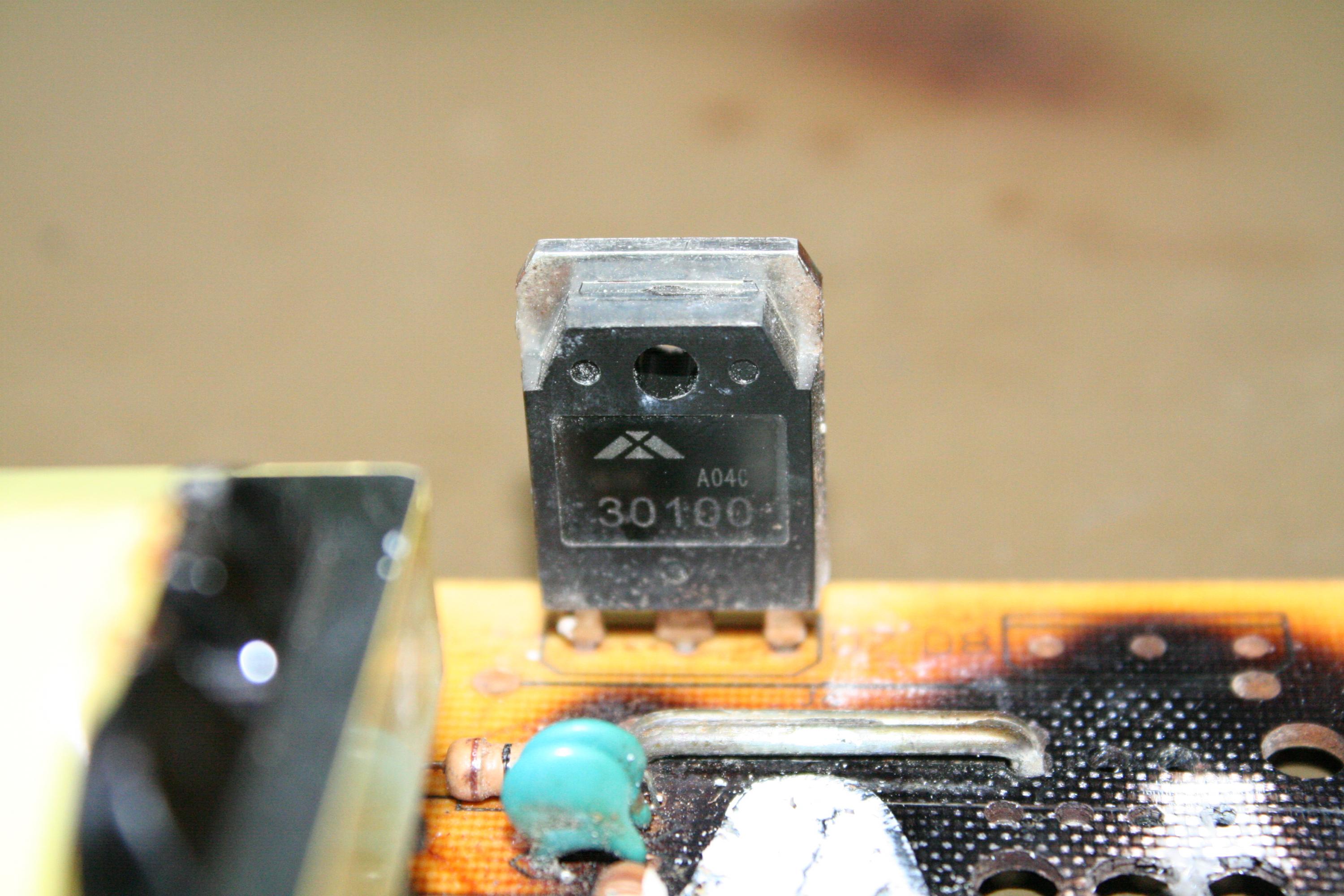

              Just for fun, here's some more photos of the board, the rectifier and the switching device...I don't know how good this thing was even when new, Dave of EEV would probably call it trash straight away, obviously but it was apparently just fine for powering CCTV cameras

                    #29
                    Mostly yellow with one face being white would be Micrometals -26 material. -52 is the same permeability but lower core loss above about 50KHz. The two materials can be used interchangeably at 20-30KHz though -52 is a bit higher in cost. I think -52 was introduced in the late 80s or early 90s; -26 has been around since at least the late 70s.

                                    I'm going to guess that the two stacked cores in that inductor are -52 material, based on this Micrometals chart. This chart compares core losses for the various materials.
                                    The inductor in that second link is a common mode inductor, a very different function, and it has a ferrite core.

                                      I've heard the same, but I am not entirely convinced myself. Ferrite cores are often painted and then baked in an oven to cure the paint. As for the coating that has peeled on Dannyx's core, that's probably plain varnish insulation, painted on after the coil was wound with wire (to help prevent vibrations of the wire and audible oscillations).
                                      I've successfully rewound two small buck-regulator toroid cores from eVGA GeForce 7600 GT video cards that got burned due to bad Sacon FZ caps (which caused the RAM to short-circuit and pull a massive surge through the coil in the buck regulator until it overheated).
                                      After rewinding the coil (and changing the RAM chips!), I got the buck regulator to at least output the right voltage without the coil or anything else overheating. Unfortunately, the GPU core must have been damaged too, as I get artifacts with the new RAM chips. But hey, at least I have video output now!
                                      Can I take some 0.3mm enamel copper wire and just rewind the thing ?
                                      Yes.
                                      Just unwind the old wire and measure its length. Then rewind with new wire. As long as the core hasn't gotten an internal crack from all the heat, it should work fine again with the new wire. However, if it is cracked, you will likely get an overheating core again. So it's worth giving this a shot, if you want to do it just for an experiment.
                                      Otherwise, if you really need to fix the PSU professionally, then you find the same core size and type online, and wind it with your own wire (as finding an already wound core with the same number of turns and thickness of wire is unlikely).
                                      Also, no need to coat the wire in varnish - at least not for testing. But if you find the PSU is making nasty whining noises, you might have to do that. Wood varnish isn't the most ideal substitute, but it should do the trick.
                                      The DC output caps failed and that caused too much stress on the choke.
                                      Yes. But they likely failed only because the fan seized.
                                      The only time I've seen a burned coil without the fan getting seized and the caps cooked (or showing bad ESR) was in a really cheap PSU, where the output toroid core was just too small, along with the wire wound on it was too thin.

                                        For curiosity's sake, here's the choke in question off the board. I hadn't unwound it at that point. True, it's hard to get a sense of scale since there's no ruler beside it, but what I know for sure is the wire is 0.3mm in diameter and you can kinda get an idea by comparing it to other components on the board...can't remember the other dimensions of the rings right now, though I DID measure them. May post those too at some point.

                                          I believe we are discussing an output inductor, which would have a powdered iron core, not a ferrite core. That powdered iron cores can lose their magnetic properties over time by being run too hot is not news. Here's Micrometals' webpage on the topic.
