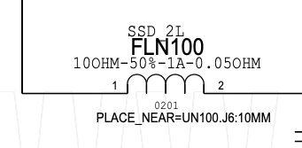

    What part is this coil from a MacBook A2681 ?
    Hi everyone
    I'm struggling to point out what part is this? It is a coil, but the parameters say: 10OHM - 50% - 1A - 0.05Ohm
    So it is a coil with 0201 dimensions, 1A max current, 0.05ohm resistance but what is 10ohm? For a coil we need specs like 1uH or so.
    IAny ideas? It is from a MacBook A2681
    Thank you
  • Answer selected by waterchill at 08-08-2024, 03:52 AM.
    mon2
    • Dec 2019
    • 14761
    https://canada.newark.com/tdk/mmz060...hs/dp/30AJ5232
    Ferrite bead that applies a resistance at 100 MHz. Much like an electronic resistor that is passive till the part reaches 100Mhz and then applies the noted resistance. IMHO, useless if 10ohms, should be higher resistance to filter out noise but use what they have in place already.

        Thank you very much sir!
