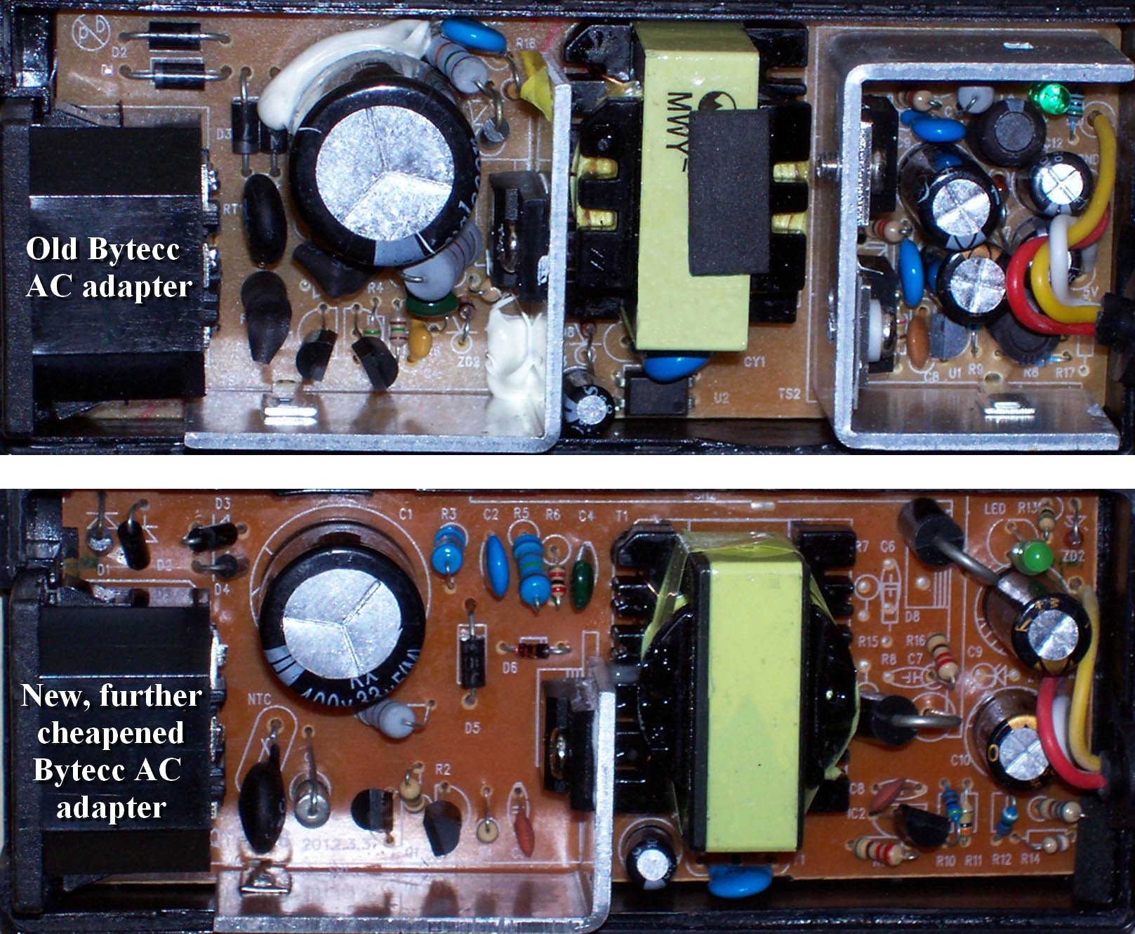

    Here is an amateur examination of two different Chinese adapters. First we have the "GX26W-5-12", a very common model that comes with the aforementioned kits:
    Next is the "Yu Feng" JYCC-168:
    Both very similar in advertised spec, aside from the slight difference in the amperes rating.
    On the right we have the Yu Feng, on the left, the GX26W. This picture speaks for itself (Sorry about the lighting, I really ought to get a decent lamp for this sort of thing instead of trying to aim a flashlight while taking the photo). The Yu Feng has excellent input protection (X cap, Y-Cap, choke, high quality fuse). The secondary is a world ahead of the no name brand adapter. Compare the following: Tiny transformer, cost cutting 4 diode rectification, cheap glass fuse, and lack of coils for the filtering caps.
    Correct me if I'm wrong, but I think the two diodes in its secondary are being used to inexpensively step down the voltage to 12V and 5V, whereas the Yu Feng has two actual full fledged seperate transistors on the secondary heatsink (One is YG902, other's markings are obstructed by caps). The transistor attached to the side heatsink says "STK" on it, which I assume is a Sanken part (Can't make out the rest, which is blocked by the transformer).
    In case you're wondering, the lone transistor attached partially to the tiny "heatsink" on the GX26W is a Fairchild 2N60.
    The cheap adapter's wires are much flimsier and skinnier than the Yu Feng, and its cord lacks a ferrite core. When it's plugged in the wall, the AM radio gets a lot of static.
    The only complaints I have with the Yu Feng are the quality of the caps (Nicon for the primary, and "SWCON" for the rest), and the fact that since this came from an old USB2 external enclosure, it's not a molex connector (Which means I'll have to do some splicing).
    Lesson learned: Don't blindly use cheap Chinese adapters, the can destroy your equipment, but at the same time, don't discount all Chinese products as junk, the manufacturers can produce high quality products if they want to, but even then, crack it open and change the caps to make sure it lasts forever.

    The two rectifier diodes in TO-220 case mounted on the U shape heat sink of the Yu Feng are Common Cathode rectifier diodes for 5V winding and 12V winding of the transformer, sure looks like better built.

              I wouldn't consider the one on the right a quality product.
              The capacitors are practically glued to the to220 rectifiers, the heatsink is barely adequate, transistor/mosfet on the primary side is screwed in the corner of the metal sheet, as if the heat will spread all the way to the other side efficiently . Both have that horrible pcb that has copper on only one side, all through hole. They could have put the bridge rectifier on the heatsink with the transistor/mosfet on the primary side, flip the common mode chock 90 degrees, put the capacitor vertically, and voila.. plenty of space available.
              Old designs, low frequency stuff, bad layout...
              Sigh.. you can get a VIPER50A for less than 2$ in quantity and put it on a trip of metal on one side and configure it to do 12v 3A or something like that.
              Put the schottky diode and a 5.2v (to account for voltage loss on cable) 2A dc-dc converter on the other side on a long strip of metal. Done.
              5-6$ for everything but the transformer, which in chine can't be more than 1-2$.
              But I guess the parts costs less than 1$ in these shitty power supplies, probably all overstock or parts barely meeting specs.
                                I suppose I should have posted a pic of the underside of the Yu Feng as well. That SOIC in the top right corner is a Chinese branded 3843A.
                                The capacitors are practically glued to the to220 rectifiers<snip>
                                This is meant to power a single HDD at a time, strictly for retrieving data, a task that would take an hour at the most. If I were doing a ghost, I would open up the case and attach the HDD to the PSU because I need native access. There's no reason to base a suppy for such a simple task on a 'doctorate design'. This is more than adequate for its intended use.
                                  There is no need to heatsink a rectifier handling less than 1/10th of an amp. Similarly with the rest of the design, all it has to do is supply a couple amps peak output at HDD spin-up, with the cheap caps being the likely early failure point.
                                  It might even be overbuilt for the application except that the size of the transformer limits it. Consider it may average 7W output, then contrast a consumer grade PSU capable of 500W output. Is the latter built with 70X more heatsinking and current capability? In the transformer yes but not the rest.
