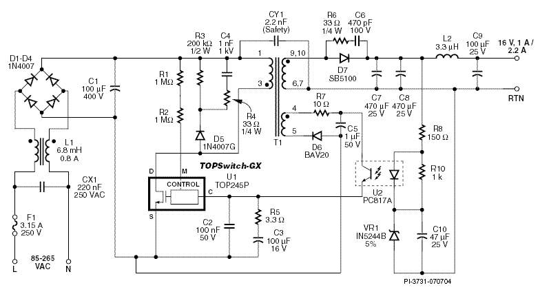

    ^what looks like the primary switcher has 6 legs. is that the SMP ic?

      Yep. Common in certain DVD/BD players too.
      It's sort of like a giant TOPswitch. Can't give a more specific example w/o the P/N of that IC...
      There should be a large resistor from B+ to one of those small caps on the pri side. That same cap will have a diode, possibly thru a low-value resistor, from a transformer pin- the aux voltage for the PWM IC.
      This one charges that cap via internal bypass until supply "kickstarts." Yours might do the same if you can't find that resistor.
      Also notice that D5 is a 1N4007. They don't want the snubber diode to be too fast, since it could lead to excess RFI.

        ^fixed the startup, but now the tranny makes a chattering sound.

          #44
          Re: Hard Drive Power Supplies
          What did you replace?

            a diode that has "er106" written on it. in between the the opto-isolators and that larger of the two caps on the primary.
            actually, it still pulses on startup.

              Did the old diode test bad?
                ^ no.
                  What is that PWM IC?
                  I'm assuming (again, lol) that it still pulses with heavy loads on the outputs.
                    ^ pulses on startup with load.
                    makes a Thunking/chattering/fast tick noise out of the trafo with no load when running.
                    TOP247YN
                      DOH! i changed the 220uF cap next to the opto-couplers with a 330uF. no wonder its oscillating.
