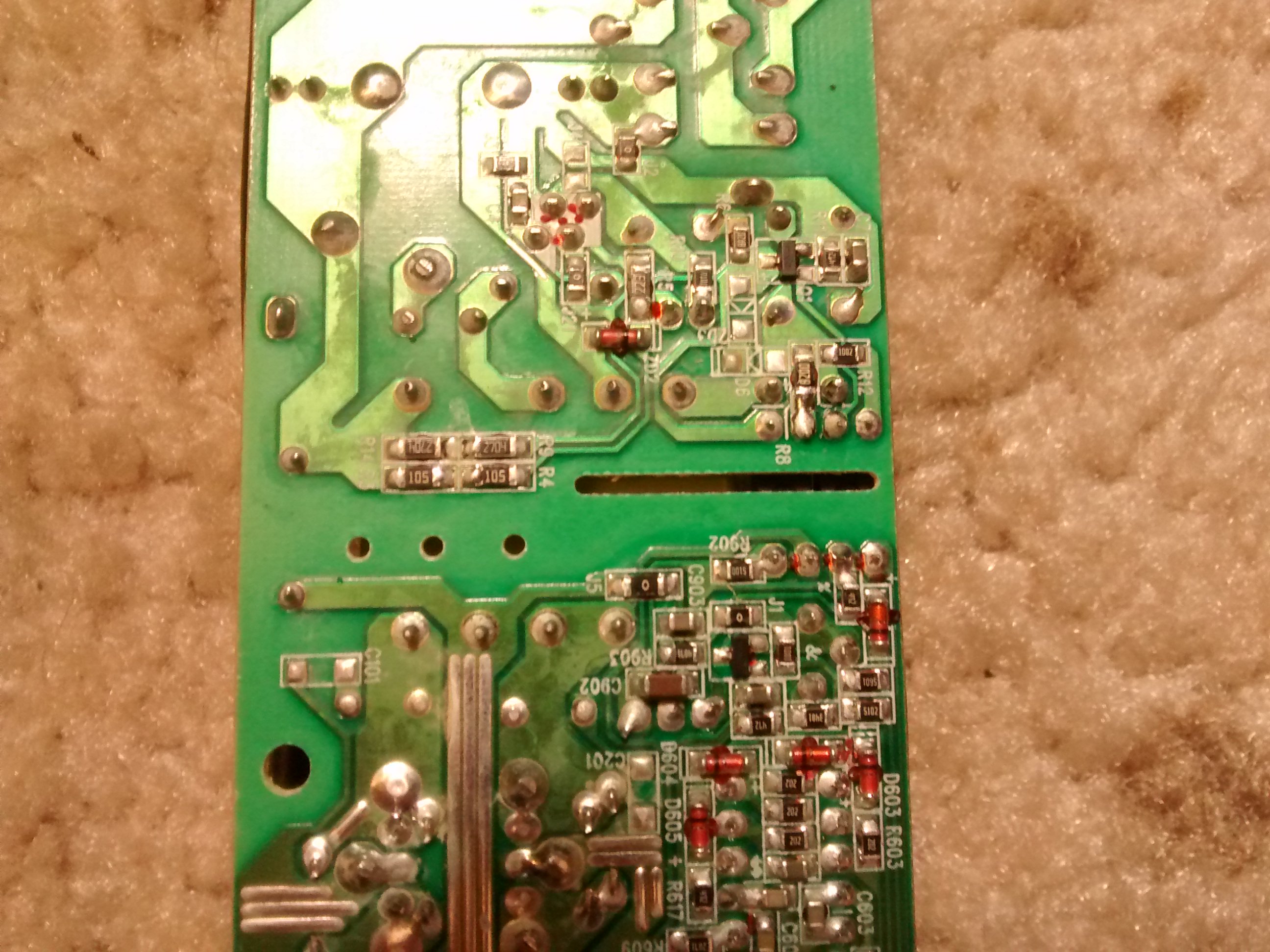

          Sorry to bump an old thread, but I came across another variant of the Yu Feng, and it is almost completely identical to it except that this one has a brown PCB and all Capxon caps (KM and KF).
          The soldering of the underside of this one is a lot cleaner, and this one has "23-11056-00 REV. A" written on it.
          The datecodes on the caps indicate this was made in the beginning of 2005.

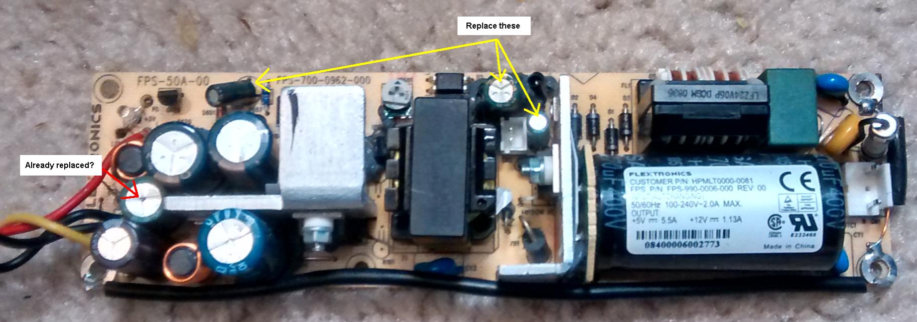

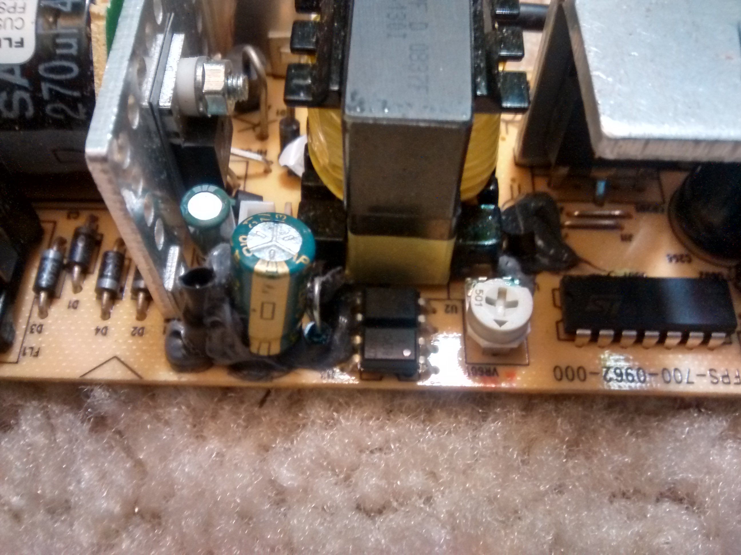

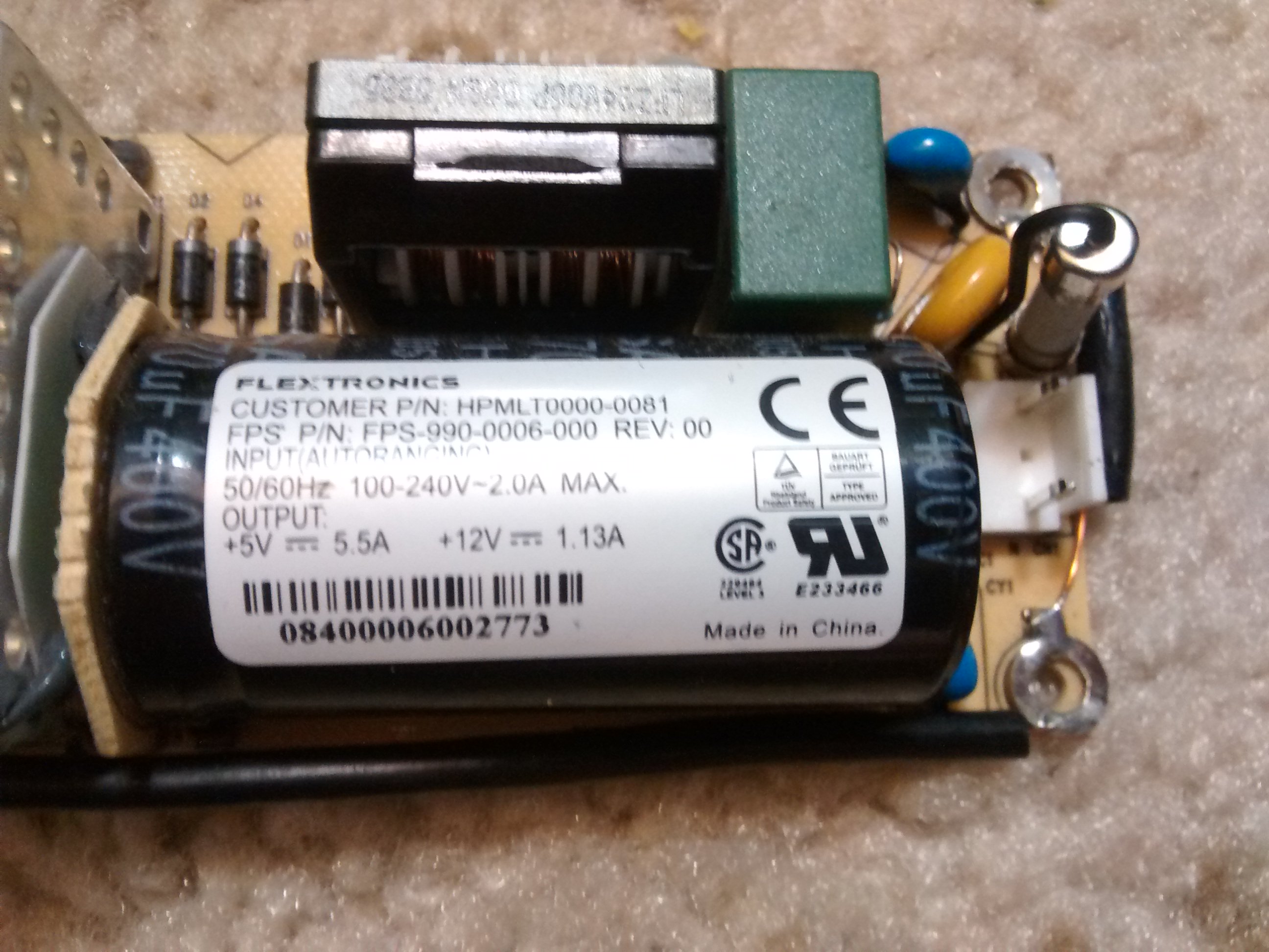

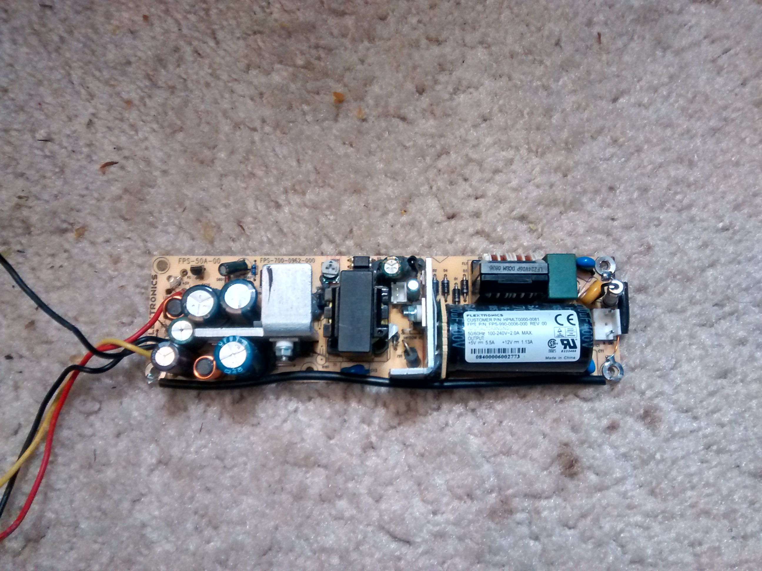

              well, since the thread was dug up...
              This is the Unit i use now to power drives externally. It came out of a well built HP tape drive.
              Notice the proper isolation and air-gaps, duely optocouplers, thick secondary traces, and good filtering all around. It doesn't disconnect the primary to shut off, it just kills the primary switchers, so that heatsink on the primary switcher is always live. (i learned that the hard way) No brown gorilla snot here! Only issue i have with it is crap caps, but its not enclosed and doesnt run hot, so im not too worried..... HP drove the tape motor from 5V, can you tell?
                5.5A on +5, maybe...

                  ahh, better for running laptop drives!

                          Re: Hard Drive Power Supplies
                          ok, mine developed an issue. it pulses on switch one then eventually starts. Thats a startup cap issue right?
                          Follow the white rabbit.
                          • kaboom
                            "Oh, Grouchy!"
                            • Jan 2011
                            • 2507
                            #33
                            10-22u, 50V, near the SMPS IC, likely a cheep submini electro. Probably right by the transformer. You can use anything from 10-47u, 50V. It's quite possible that the aux voltage is nowhere near that; a 25 or 35V cap could work, but either measure it or find out what voltage the SMPS IC clamps it at. Some have an interal shunt reg, that limits the voltage across that cap- it's fed thru a resistor after the aux rectifier/winding.
                            And if you're going to change the O/P caps, why not do a before-and-after scope 'n load test?
                            If you have a scope, that is...
                            I'm betting you've got well over a volt of ripple on +12, even at 1A. More if there's no pi-filter.
                            Don't forget to bond common to the EGC and rewire the AC input, putting the fuse in the hot, where it belongs.
                                either a bad starting cap or bad solder joints. Some are really hard to find. Read this thread:https://www.badcaps.net/forum/showthread.php?t=47479
                                I finally found it with my hot air soldering station.
                                  remember, this isnt one of those cheap units. Its an HP tape drives internal PSU. EGC is already bonded, has fuse, pi-filter, etc. i will look for bad soldering and replace that cap.
                                  I have tested the output caps. one was bad, and i replaced it.
                                    That's what I get for ass-u-me-ing..
                                      that light green one has a black marking on the top. i put that there because it wasn't out of tolerance, but it was high, its graphite. It looks like its just doing filtering and with a rating of 1500uF i'm going to replace it with a 2200uF anyway. Lets see how it does with new low value caps!
                                        No dice. still does it.
                                          Resolder the pins on the TX primary side, and also replace the diode feeding the cap for the PWM IC.
                                          Don't check and assume it's good- they can get fussy til they warm up.
                                          Back in the late 90's, I fixed two of those "Packard Bell" Pixie monitors.
                                          +12 was missing for about 20 minutes after a cold start and supply was cycling. Degauss relay was powered by that same +12, so it would click too.
                                          I fed +12 in from a seperate supply and it came to life. First I changed the cap- no change. Then I isolated that feed and checked for shorts. No shorts.
                                          For testing, I replaced the schottkey with two 1N4004s. They got warm (hot?), but unit now worked.
                                          All was well after a new TO-220 schottkey; cap was still OK.
