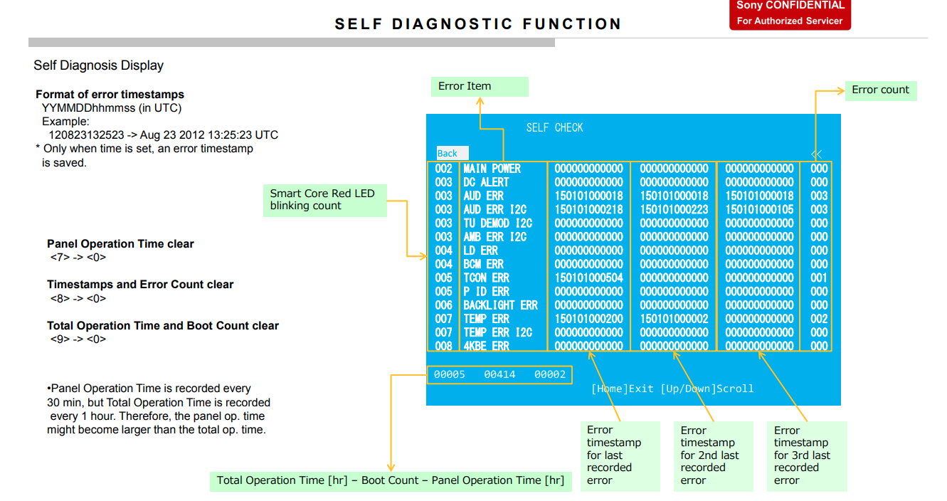

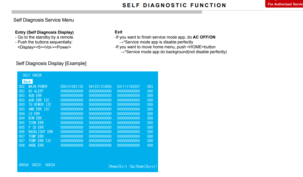

              Look at the errors and their number through the diagnostic menu
              Turn off the TV and use the remote control to successively press [i+] [5] [vol-] [power]​

                That's a good idea, since you can get the screen on. Never knew that existed

                  I’ve only been able to get the TV to power up after a hard reset. Otherwise it has the 5 flashes. I’ll do my best though. (I assume that a hard reset clears the diagnostics, so I’ll try for a while without the hard reset.) One question… the sequence you gave starts with [i+], but I’m not sure what that is. Is this [Display]?
                  • lotas
                    • Jan 2016
                    • 4969
                    • Russia
                    Yes.

                        Regarding lotas' suggestion, I attempted to get to the diagnostic screen by pressing <Display><5><Vol-><Power>, but the best I was able to do was to get the TV to turn on (and go to the setup screen). No diagnostic screen was displayed.

                            at yours case ...regards successful run diagnostic mode..
                            after hard rest and screen come on... before the set go to error put it in stand by mode. then run the code

                              I also tried to get to the diagnostic screen again, but the TV won't turn on again after going into standby. (5 flashes again.)

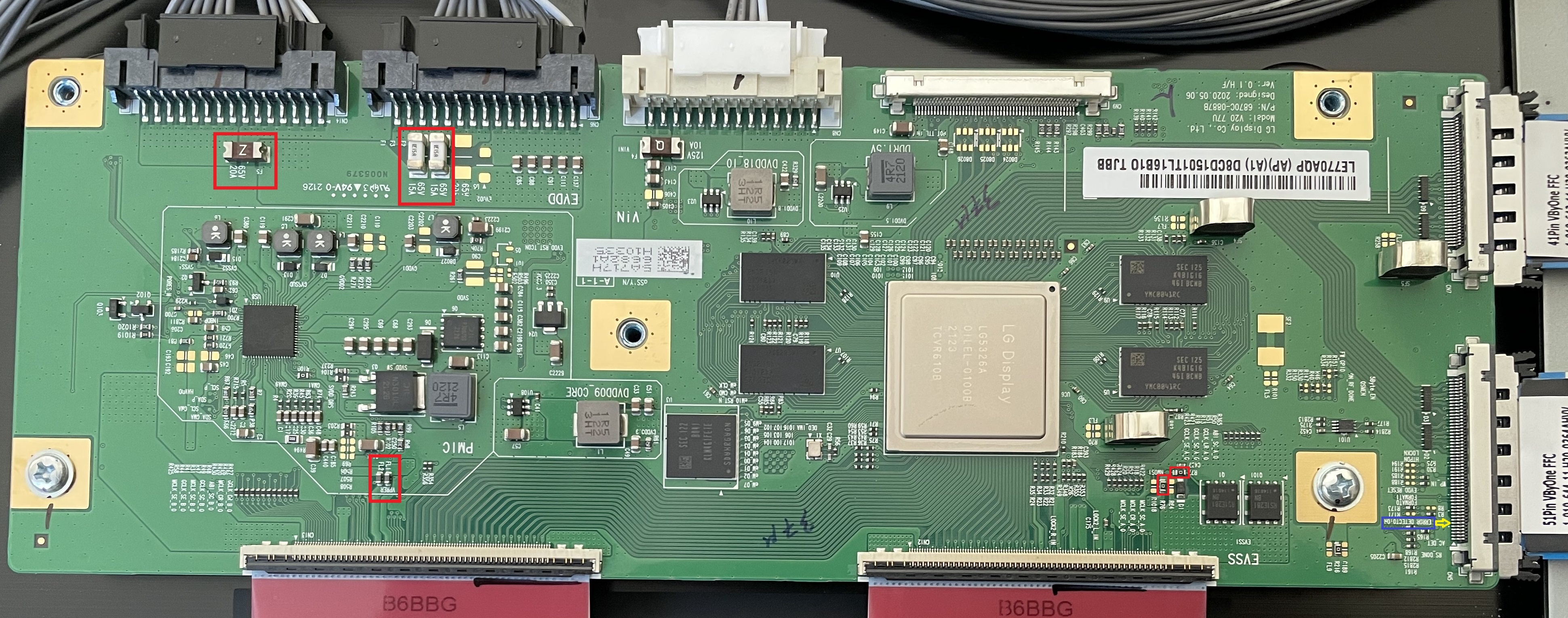

                                  Here’s a photo of the TCON. Am I correct that I should attach a wire from the chassis to the middle of the board where the metal plate was screwed in, run the same test I did last time and measure voltages? If so, can you point me to where I should take the readings? (I see f1-f5, although f2 isn’t installed. Are these the fuses you’re referring to? Also, when you say “R”, are you referring to all resistors? (There are quite a few of them. I don’t mind, but I want to make sure that I’m understanding.)
                                  • Diah
                                    • Feb 2013
                                    • 6647
                                    dont add any wire.... the t-con sitting fine on chassis but...
                                    Man, why the LVDS in yours photo show they are connected.... please disconnect them both and never put them back at the test
                                    all in red color messure them from both side... while the test jumpers in place..
                                    also the yellow mark its the error detect check iz it go high and tell the value..
                                    use the same image i upload here to mark yours reading on it and upload again
                                    again for last time " LVDS NUST VE DISCONNECTED Click image for larger version  Name:	image_328123.jpg Views:	0 Size:	1.85 MB ID:	3219569

                                        any way do the test... however i think all reading will be fine but need to be sure..

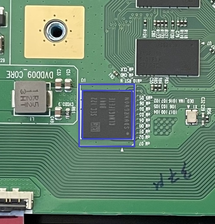

                                        yours T-CON the new design from LG. which it operate with eMMC... this why no color pattern at stand alone test..
                                        after you finish from testing V as above... and all V are fine.... put every things back LVDS MB socket... don't install the shield use freezing air can to freeze the chip while you freezing it do hard ... reset.... keep freezing it and see if the set remain on for long time....
