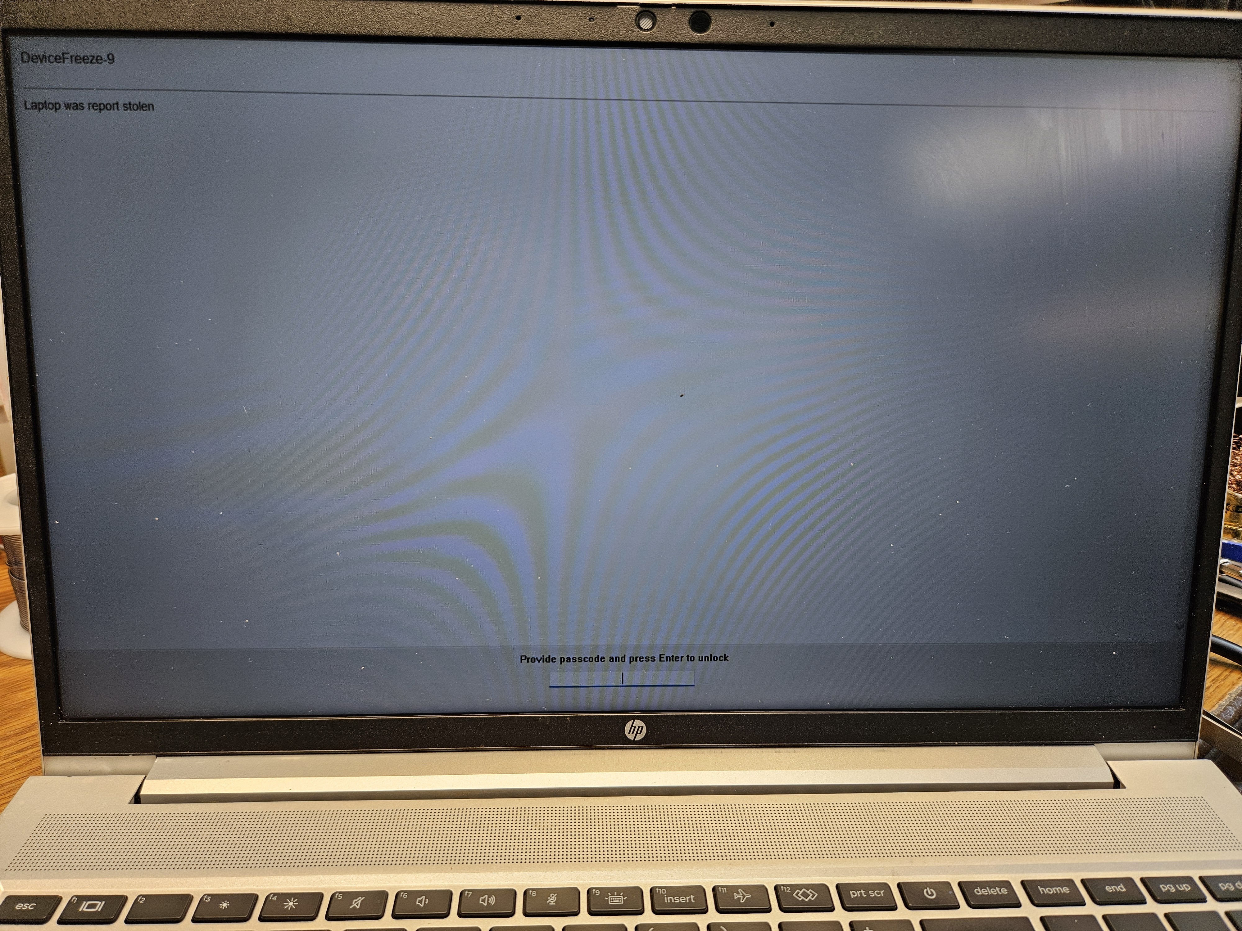

                I have a HP ProBook 650 G8 with a message stating "Devicefreeze-9" and states that it's reported lost/stolen.
                Anyway to remove that? I am attaching EC / SPI ROM in hopes that someone can help me clear it.
                Board: DA0X8QMB8E0 Rev: E
                Serial: 5CD112N2GF

                    #110
                    Originally posted by hoaca388
                    HP ProBook 650 G8 Notebook PC IDS Base Model
                    Thank you, I flashed my SPI ROM with the file you provided and it went through a BIOS update screen and went back to the same lock screen after it was completed.

                      #111
                      hi try spi
                      • kurobaxkaito
                        • Dec 2019
                        • 10
                        #112
                        Originally posted by shiyab
                        hi try spi
                        Thank you, I tried and it is the same results. I am attaching pictures of how it looked. It booted into Windows desktop briefly and then showed the lock again.
